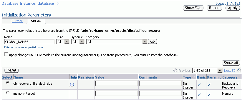

To set the GLOBAL_NAMES initialization parameter to TRUE at a database:
Log in to Enterprise Manager as an administrative user who can change initialization parameters. For example, you can log in as a user with SYSDBA privilege.
Go to the Database Home page for the database instance.
Click Server to open the Server subpage.
Click Initialization Parameters in the Database Configuration section.
If you are using a server parameter file, then click SPFile. Otherwise, proceed to the next step.
On the Initialization Parameters page, enter GLOBAL_NAMES in the search tool.
Click Go.
Set the GLOBAL_NAMES initialization parameter to TRUE.
Click Apply to save your changes.
Ensure that you set the parameter permanently in either the server parameter file or in your initialization parameter file.
Complete Steps 1 through 9 for each database in your distributed environment. By default, the GLOBAL_NAMES initialization parameter is set to FALSE. Therefore, it must be set to TRUE explicitly at each database.

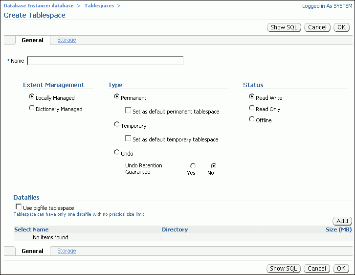

The Oracle Streams administrator should use a dedicated tablespace that is not used by any other user. Queue tables and other Oracle Streams components require disk space, and a dedicated tablespace can meet these space requirements efficiently.
To create a new tablespace for the Oracle Streams administrator:
Log in to Enterprise Manager as an administrative user.
Click Tablespaces in the Storage section.
On the Tablespaces page, click Create.
The Create Tablespace page appears, showing the General subpage.
Enter streams_tbs in the Name field.

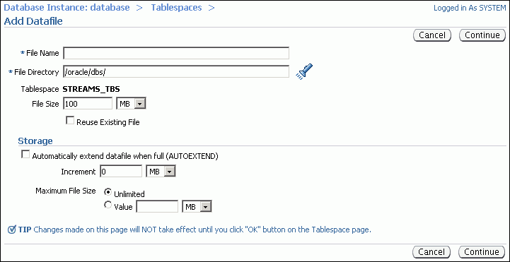

Click Add in the Datafiles section to open the Add Datafile page.
Enter streams_tbs.dbf in the File Name field.
Check the directory in the File Directory field and change it if necessary.
Change the size in the File Size field to 25 and ensure that the list is set to MB.
Select Automatically extend datafile when full (AUTOEXTEND) in the Storage section.
Enter 5 in the Increment field and set the list to MB.
Set the Maximum File Size. Typically, it is best to leave it set to Unlimited.
Click Continue.
On the Create Tablespace page, click OK.

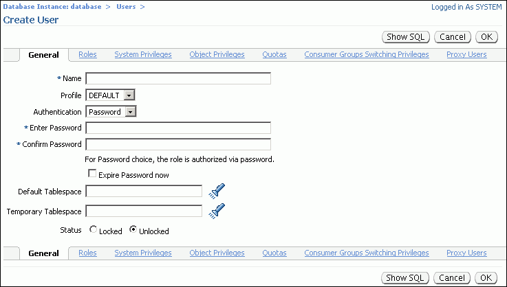

To create a new Oracle Streams administrator named strmadmin:
Click Users in the Security section.
On the Users page, click Create.
The General subpage of the Create User page appears.
Enter strmadmin in the Name field.
Enter a password for the new user in the Enter Password and Confirm Password fields.
Enter an appropriate password for the administrative user. See Oracle Database 2 Day + Security Guide for information about choosing passwords.
Click the flashlight icon for the Default Tablespace field to select the streams_tbs tablespace created in "Tutorial: Creating the Tablespace for the Oracle Streams Administrator".
Click the flashlight icon for the Temporary Tablespace field to select a temporary tablespace for the new user.
Click Roles.
The Roles subpage of the Create User page appears.
Click Edit List.
The Modify Roles page appears.
Move DBA from the Available Roles list to the Selected Roles list.
Click OK.
On the Create User page, click OK to create the user.

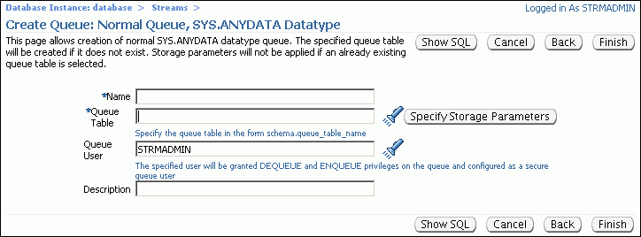

To create an ANYDATA queue and its associated queue table:
In Oracle Enterprise Manager, log in to the database as the Oracle Streams administrator.
Go to the Database Home page.
Click Data Movement to open the Data Movement subpage.
On the Oracle Streams: Setup Options page, click Messaging.
The Streams page appears, showing the Messaging subpage.

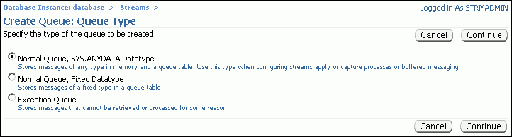

Click Create to open the Create Queue: Queue Type page.
Select Normal Queue, SYS.ANYDATA Datatype.
A queue of the ANYDATA data type enables you to store messages of almost any type in a single queue.
Click Continue to open the Create Queue: Normal Queue, SYS.ANYDATA Datatype page.
Enter the name of the queue in the Name field. A typical queue name used in Oracle Streams environments is streams_queue, but you can enter a different name.
Enter the name of the queue table owner and the queue table name in the Queue Table field. Typically, the Oracle Streams administrator owns Oracle Streams queues, and a typical queue table name is streams_queue_table. Therefore, you can enter strmadmin.streams_queue_table, or you can enter a different owner and name.
Ensure that the name of the Oracle Streams administrator is entered in the Queue User field.
Optionally enter a description for the queue in the Description field.

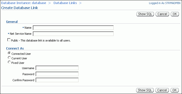

To create a database link from the ii1.example.com database to the ii2.example.com database:
Log in to Enterprise Manager as an administrative user, such as the Oracle Streams administrator strmadmin or SYSTEM. The database link is created in the schema of this user.
Go to the Database Home page for the ii1.example.com database instance.
Click Schema to open the Schema subpage.
Click Database Links in the Database Objects section.
On the Database Links page, click Create to open the Create Database Link page.
Enter the name of the database link in the Name field. The name must be the global name of the database to which you are linking. In this example, the database link name is ii2.example.com.
In the Net Service Name field, enter the net service name of the database to which you are linking. In this example, the net service name is ii2.example.com.
Select Fixed User in the Connect As section.
In the Username field, enter the user name of the user who will own the database link. The database link connects to this user on the remote database. In this example, you can enter an administrative user, such as system SYSTEM, the Oracle Streams administrator strmadmin, or a regular database user, such as oe.
In the Password and Confirm Password fields, enter the password for the specified user on the remote database.
Click OK to create the database link.
You can also use theCREATE DATABASE LINK SQL statement to create a database link.If you were directed to this topic from another topic, then go back to the topic now:
