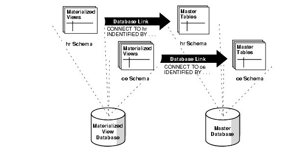

To ensure proper behavior, a materialized view's defining query must use a database link that includes an embedded user name and password in its definition; you cannot use a public database link when creating a materialized view. A database link with an embedded name and password always establishes connections to the remote database using the specified account. Additionally, the remote account that the link uses must have the SELECT privileges necessary to access the data referenced in the materialized view's defining query.
Before creating your materialized views, you need to create several administrative database links. Specifically, you should create a PUBLIC database link from the materialized view site to the master site. Doing so makes defining your private database links easier because you do not need to include the USING clause in each link. You also need private database links from the materialized view administrator to the proxy administrator and from the propagator to the receiver, but, if you use the Advanced Replication interface's Configure Master and Materialized View Sites for Replication Wizard, then these database links are created for you automatically.
See Also:
The information about security options in Oracle Database Advanced Replication Management API Reference for more informationAfter the administrative database links have been created, a private database link must be created connecting each replicated materialized view schema at the materialized view database to the corresponding schema at the master database. Be sure to embed the associated master database account information in each private database link at the materialized view database. For example, the hr schema at a materialized view database should have a private database link to the master database that connects using the hr user name and password.
Figure 6-1 Recommended Schema and Database Link Configuration

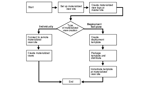

Materialized view environments can be created in several different ways and from several different locations. In most cases, you should use deployment templates at the master site to locally precreate a materialized view environment that will be individually deployed to the target materialized view site.
You can also individually create the materialized view environment by establishing a connection to the materialized view site and building the materialized view environment directly.
See the Advanced Replication interface's online Help in Oracle Enterprise Manager for information about using deployment templates to centrally create a materialized view environment using the Advanced Replication interface.
See the Advanced Replication interface's online Help in Enterprise Manager for information about individually creating the materialized view environment with a direct connection to the remote materialized view site using the Advanced Replication interface.
Figure 6-2 Flowchart for Creating Materialized Views
The instructions for creating a deployment template in the Oracle Database Advanced Replication Management API Reference manual for information about using deployment templates to centrally precreate a materialized view environment using the replication management API.
The instructions for creating a materialized view group the Oracle Database Advanced Replication Management API Reference manual for information about individually creating the materialized view environment with a direct connection to the remote materialized view site using the replication management API.

If you plan to include materialized view sites in your replication environment, then consider using deployment templates to create the replicated objects at the materialized view sites.
See Also:
Chapter 4, "Deployment Templates Concepts and Architecture" for information about deployment templatesIf you decide to use deployment templates, then you need to prepare your materialized view sites for instantiation. If a deployment template has been designed well, then little preparation is necessary at the remote materialized view site. This section describes the most common preparations that must be performed at the remote materialized view site. After any required preparations have been completed, you are ready to perform either an online or offline instantiation.
Use the following questions to assess which actions are necessary to prepare the remote materialized view site for instantiation:
Does the remote materialized view site have network connectivity to the target master site?
Does the materialized view site have an Oracle9i Release 2 (9.2) or later database?
Has the remote materialized view site been set up to support materialized view replication?
Do the schemas required by the deployment template exist at the materialized view site?
If required database links are not part of the deployment template, then do the required database links from the materialized view site to the master site exist?
Will you use online instantiation or offline instantiation to instantiate the deployment template at the materialized view sites?
Do the rollback segments that might be required by the deployment template exist at the materialized view site and are they online?
The following sections provide guidance for the issues raised by each of these questions.

Each materialized view site needs several users that have special privileges to support a materialized view site. In addition to having the administrative privileges, these users also participate in the propagation and refreshing of data.
Materialized view site setup also includes scheduling several automated jobs to handle the automatic refreshing of the materialized view (optional) and the purging of the deferred transaction queue.
You can set up your materialized view site with:
Advanced Replication Interface: You can connect to the remote materialized view site with the Advanced Replication interface and use the Configure Master and Materialized View Sites for Replication Wizard.

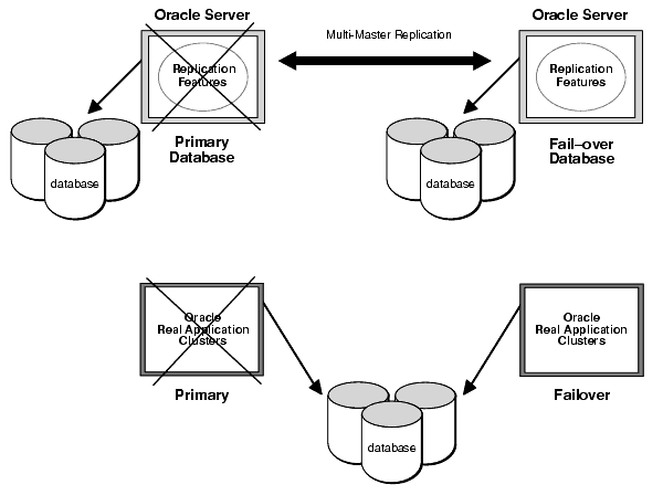

Figure 6-3 Survivability Methods: Replication Or Oracle Real Application Clusters
Oracle Real Application Clusters (Oracle RAC) supports fail over to surviving systems when a system supporting an instance of the Oracle server fails. Oracle RAC requires a cluster or massively parallel hardware platform, and thus is applicable for protection against processor system failures in the local environment where the cluster or massively parallel system is running.
In these environments, Oracle RAC is a good solution for survivability — supporting high transaction volumes with no lost transactions or data inconsistencies in the event of an instance failure. If an instance fails in an Oracle RAC environment, then a surviving instance automatically recovers any incomplete transactions. Applications running on the failed system can execute on the fail over system, accessing all data in the database.
Oracle RAC does not, however, provide survivability for site failures (such as power outages, flood, fire, or sabotage) that render an entire site, and thus the entire cluster or massively parallel system, inoperable. To provide survivability for site failures, you can use the multimaster replication to maintain a replica of a database at a geographically remote location. In addition, you can use multimaster replication to replicate data between sites running different operating systems or different releases of Oracle or both.
Should the local system fail, the application can continue to execute at the remote site. Using multimaster replication, some administrative procedures might be necessary to recover transactions at the failed site and to prevent data inconsistencies when restarting the failed site.
You can also configure standby database to protect an Oracle database from site failures.See Also:

Advanced Replication provides survivability against site failures by using multiple replicated master sites. You must configure your system using one of the following methods, which are listed in order of increasing implementation difficulty:
The failover site is used for read access only. That is, no updates are allowed at the failover site, even when the primary site fails.
After a failure, the primary site is restored from the fail over site using export/import, or through full backup.
