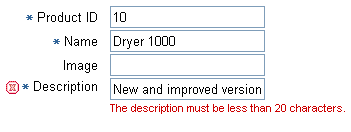

To create a simple input form for products in the SRDemo application, for example, you might drop a collection similar to the ProductList collection from the Data Control Palette as a creation form. Example 20-2 shows the JSF code created by JDeveloper if such a collection were dropped.
Example 20-2 JSF Code for a Create Product Page
<afh:body> <af:messages/> <h:form> <af:panelForm> <af:inputText value="#{bindings.ProdId.inputValue}" label="#{bindings.ProdId.label}" required="#{bindings.ProdId.mandatory}" columns="#{bindings.ProdId.displayWidth}"> <af:validator binding="#{bindings.ProdId.validator}"/> <f:convertNumber groupingUsed="false" pattern="#{bindings.ProdId.format}"/> </af:inputText> <af:inputText value="#{bindings.Name.inputValue}" label="#{bindings.Name.label}" required="#{bindings.Name.mandatory}" columns="#{bindings.Name.displayWidth}"> <af:validator binding="#{bindings.Name.validator}"/> </af:inputText> <af:inputText value="#{bindings.Image.inputValue}" label="#{bindings.Image.label}" required="#{bindings.Image.mandatory}" columns="#{bindings.Image.displayWidth}"> <af:validator binding="#{bindings.Image.validator}"/> </af:inputText> <af:inputText value="#{bindings.Description.inputValue}" label="#{bindings.Description.label}" required="#{bindings.Description.mandatory}" columns="#{bindings.Description.displayWidth}"> <af:validator binding="#{bindings.Description.validator}"/> </af:inputText> <f:facet name="footer"> <af:commandButton text="Submit"/> </f:facet> </af:panelForm> </h:form> </afh:body>
Note that each inputText component's required attribute is bound to the mandatory property of its associated binding. The EL expression evaluates to whether or not the attribute on the object to which it is bound can be null.

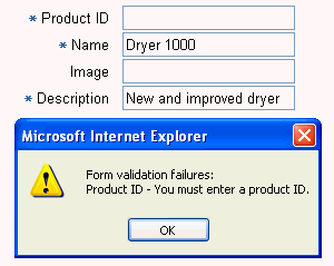

When the user submits the page, the ADF Faces validate() method first checks for a submitted value if the required attribute of a component is true. If the value is null or a zero-length string, the component is invalidated. At this point, what happens depends on whether or not client-side validation is enabled.
If client-side validation is enabled, an error message is placed in the queue. If there are other validators registered on the component, they are not called at all, and the current page is redisplayed with a dialog displaying the error message.

In Example 20-2, a value for the image attribute is not required. However, all other values are required, as set by the mandatory property. This is denoted in the web page by asterisks next to the input text fields, as shown in Figure 20-2. Figure 20-2 also shows the alert dialog that is displayed if no data is entered for the product ID, and if client-side validation is enabled. If no data is entered for all three required fields, then the alert would show three error messages.
If the submitted value is a non-null value or a string value of at least one character, the validation process continues and all validators on the component are called one at a time. Because the af:validator tag on the component is bound to the validator property on the binding, any validation routines set on the model are also accessed and executed at this time.
The process then continues to the next component. If all validations are successful, the Update Model Values phase starts and a local value is used to update the model. If any validation fails, the current page is redisplayed along with the error dialog.
When client-side validation is disabled, all validations are done on the server. First, the ADF Faces validation is performed during the Process Validations phase. If any errors are encountered, the values are invalidated and the associated messages are added to the queue in FacesContext. Once all validation is run on the components, control passes to the model layer, which runs the Validate Model Updates phase. As with the Process Validations phase, if any errors are encountered, the values are invalidated and the associated messages are added to the queue in FacesContext (for information on how errors other than validation or conversion are handled, see Section 20.8, "Handling and Displaying Exceptions in an ADF Application"). The lifecycle then jumps to the Render Response phase and redisplays the current page. ADF Faces automatically displays an error icon next to the label of any input component that generated an error, and it displays the associated messages below the input field. If there is a tip associated with the field, the error message displays below the tip. Figure 20-3 shows a server-side validation error.
