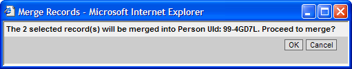

A dialog box appears, as shown in Figure 26, displaying the Row # of the surviving record, and asks if you want to proceed with the merge. Use the numbers you recorded before the merge to make sure the correct record survives.

- Click OK to accept the merge, or Cancel to abort it.
The records are merged into a single record that bears the name of the record you designated as the surviving record, and includes the data from it.
