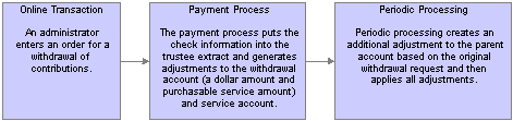

Withdrawal processing is triggered by an online transaction request, but actually occurs during two separate processes:
The payment process pays out the contributions and sets up appropriate account adjustment requests.
Periodic processing for employee accounts and service applies the adjustment requests, calculates the additional interest due if the employee decides to repay the withdrawal, and applies repayments.
Repayments can come from payroll deductions. In this case, periodic processing puts the deductions into consolidated contribution categories and then into the withdrawal account.
An employee can also make direct repayments by writing a check to the plan. In this case, you record the repayment using an online transaction (an adjustment request), which periodic processing subsequently applies to the account.
During the next Retiree Payments process, the system:
Includes the withdrawal payment in the Trustee Extract file so that the third-party who cuts your pension checks will pay the employee the specified amount.
Automatically enters adjustments to the withdrawal account and the master contributory account. If you select the option to forfeit service credit, the withdrawal changes the balance in the contributory account to zero.
Enters an adjustment that changes the associated service to zero (service is not adjusted unless all contributions are withdrawn).
Although the adjustments are set up during the Retiree Payments process, they are actually applied during the next periodic processing.
The following diagram illustrates the flow for withdrawing contributions:
