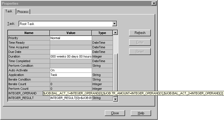

  3. Modify the root level INTEGER_OPERAND attribute value. Its attribute value should be specified as follows (For more information on modifying attribute values, see Instructions for Setting an Attribute Value or Modifying an Existing Value in Chapter 4, "Designing Business Processes."):
    $JOB.BAL_ACT_1=INTEGER_OPERAND[0];
    $JOB.TR_AMOUNT=INTEGER_OPERAND[1];
    $JOB.BAL_ACT_2=INTEGER_OPERAND[2]
    Figure B-4 Modifying Root Level INTEGER_OPERAND

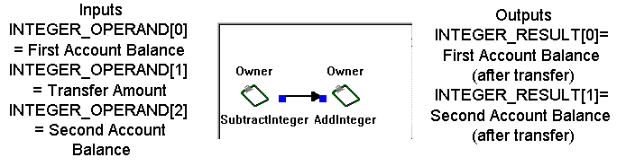

Figure B-6 shows inputs and outputs to and from the SimpleTeller process flow. This process flow implements a simple funds transfer. It is considered a simplified transfer because only whole dollar amounts may be transferred (parameters are of integer type) and because addition and subtraction tasks are used in place of actual deposit and withdrawal business services.
Figure B-6 SimpleTeller Process Flow Inputs & Outputs
We begin by looking at the top level of the process definition. This level of the process is also known as the Root Task. The process must "know" the input and output information presented in Figure B-6 to execute the process correctly. The input information coming into the process from the caller (INTEGER_OPERAND[*]) must be assigned to job-level attributes, and the output job-level attributes must be assigned to the output going out of the process as a reply to the caller. To do this (for the purposes of the funds transfer example), the following must be assigned as the value of the root-level INTEGER_OPERAND attribute:
and, the following must be assigned as the value of the root-level INTEGER_RESULT attribute:
INTEGER_RESULT[0]=$JOB.BAL_ACT_1;
INTEGER_RESULT[1]=$JOB.BAL_ACT_2
Assigning these values to the root-level parameter attributes defines the inputs and outputs to and from the process at the process (root) level.
The job-level attribute names BAL_ACT_1, TR_AMOUNT, and BAL_ACT_2 were arbitrarily created and assigned and each of them can be any string of alpha-numeric (UPPERCASE) characters. It is suggested that they describe the function they are to perform. For example, BAL_ACT_1 is short for Balance of Account 1.
Figure B-7 shows the Root Task properties screen with parameter assignments made as specified above.
Figure B-7 INTEGER_RESULT Root-Level Parameter Assignments

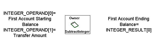

Figure B-8 shows inputs and outputs to and from the SubtractInteger task. This task subtacts one integer from another. It is used to simulate a withdrawal of funds from a bank account.
Figure B-8 SubtractInteger Task Inputs & Outputs
SubtractInteger is a sub-task of the root task, so the job-level attributes created in the Root Task can be used. These are the expressions that should be entered as the value for the SubtractInteger INTEGER_OPERAND attribute:
INTEGER_OPERAND[0]=$JOB.BAL_ACT_1;
INTEGER_OPERAND[1]=$JOB.TR_AMOUNT
and the expression entered as the value for the SubtractInteger INTEGER_RESULT attribute is:
$JOB.BAL_ACT_1=INTEGER_RESULT[0]
The actual operation performed at the application level is:
INTEGER_RESULT[0]=INTEGER_OPERAND[0]-INTEGER_OPERAND[1]
If you use substitution, the equivalent expression is:
$JOB.BAL_ACT_1=$JOB.BAL_ACT_1-$JOB.TR_AMOUNT
So, looking at this equation, you can see that a new balance is obtained for Account 1 by subtracting the transfer amount from Account 1's starting balance. This is the action that occurs in the withdrawal portion of a funds transfer. Notice that the same job-level attribute is used for the starting and ending account balance.

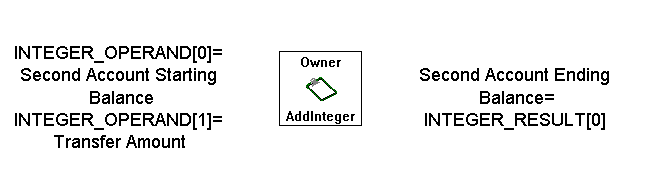

Figure B-9 shows inputs and outputs to and from the AddInteger task. This task adds one integer to another. It is used to simulate a deposit of funds to a bank account.
Figure B-9 AddInteger Task Inputs & Outputs
AddInteger is a sub-task of the root task, so the job-level attributes created in the Root Task can be used. These are the expressions that should be entered as the value for the AddInteger INTEGER_OPERAND attribute:
INTEGER_OPERAND[0]=$JOB.BAL_ACT_2;
$JOB.BAL_ACT_2=INTEGER_RESULT[0]
INTEGER_RESULT[0]=INTEGER_OPERAND[0]+INTEGER_OPERAND[1]
$JOB.BAL_ACT_2=$JOB.BAL_ACT_2+$JOB.TR_AMOUNT
So, looking at this equation, you can see that a new balance is obtained for Account 2 by adding the transfer amount to Account 2's starting balance. This is the action that occurs in the deposit portion of a funds transfer. Notice that the same job-level attribute is used for the starting and ending account balance.
