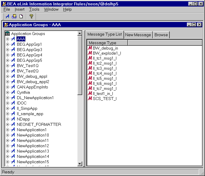

Each Rules window is split into two panes (see Figure 6-3). The left pane is a navigation tool and the right pane displays details about components selected in the left pane.
Figure 6-3 Rules Main Window
The left pane displays a list of all Application Groups and their associated Message Types, Rules, and Subscriptions. Single-click each category to just display a list of its contents in the right pane. Double-click each category to display its contents in the tree. For example, double-click to expand an Application Group. You can then double-click a Message Type name (or click on the + sign to its left) to display its associated Rules and Subscriptions.
The right pane, or Property Sheet, is where you will add the majority of information. It uses tabbed sheets to display the details for whichever object is currently selected. For example, if you have an Application Group selected, you can view the Message Type List and New Message tabs.

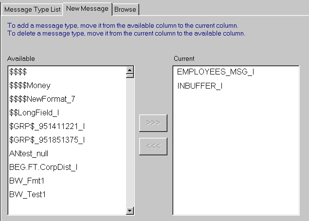

To add a message type, follow these steps.
Figure 6-4 New Message Property Sheet
The Available box on the left displays available message types. This list contains the input format names defined in Formatter.
The Current box on the right displays the message types currently associated with the application group.

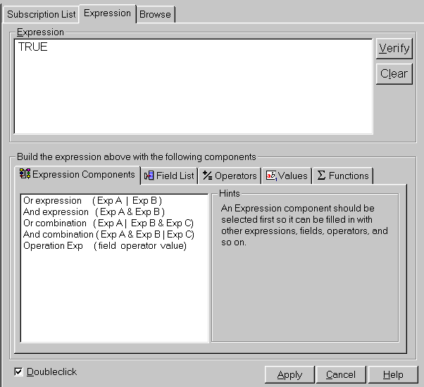

Expressions

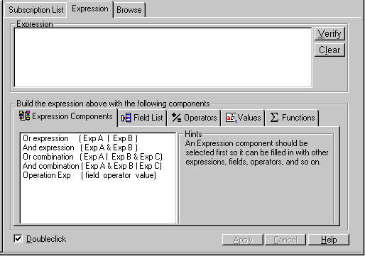

The Expression tab is used to create, modify, or delete an expression for a selected rule. You can create an expression by entering it directly in the Expression text area, or by building it interactively using the sub-tabs at the bottom of the Expression tab (see Figure 6-5). The following sub-tabs appear within the Expression tab:
The evaluation criteria for a rule consists of a Boolean expression containing the Boolean operators & (AND) and | (OR), expressions, and parentheses to control the order of evaluation. You can use | to explicitly direct what Boolean operations do together.
Notes: There must be at least one space between the field name and the Rules operator, as well as between the Rules operator and the comparison value.
The EXIST and NOT_EXIST operators should be followed by at least one space before a parenthesis or a Boolean operator.
Creating or Modifying an Expression
To create or modify an expression, follow these steps.
Figure 6-5 Expression Tab
Note: Click Clear to erase the contents of the Expression text area.
Notes: The literals AND and OR do not evaluate correctly in a rules expression. If you enter these values, a message box appears stating the expression is valid; however, AND is changed to &, and OR is changed to |.
If you move out of the Expression tab by using the mouse or the keyboard, the expression is automatically saved.
Examples of expressions are shown in Table 6-1.

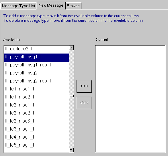

We will now create a new message type in the new application group.
Figure 6-8 New Message Type

We will now create an expression for the new rule.
Figure 6-10 Expression for II_Sample_Rule

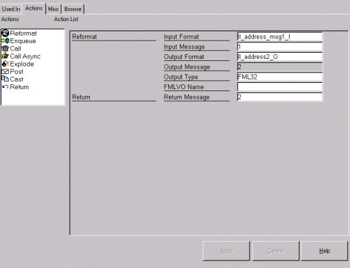

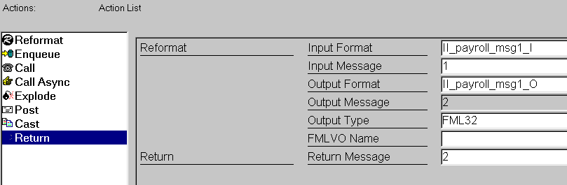

We will now add actions to the new subscription. We want to reformat the input data and return the reformatted data.
Note: The Output Message defaults to 2, assigning the number "2" to the output data.
Figure 6-12 Subscription for II_Sample_Sub
