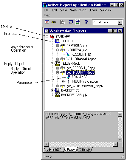

When calling a TUXEDO service asynchronously, an asynchronous operation contains only input parameters but no output parameters-instead, the information comes back as output parameters of the reply object operation. As shown on the Workstation Objects window, asynchronous operations are named differently (the suffix
Caution:
The naming conventions you use for operations (also known as services) can affect asynchronous mode. Do not include underscore characters in operation names that you want to call in asynchronous mode. Async mode does not work properly if the operation name includes an underscore.
Async is attached to the operation name) and the output parameters are returned in the operation reply objects. Notice that the sample code for an asynchronous operation contains events that indicate the replies. Figure 2-2 shows the workstation objects in asynchronous mode.
Figure 2-2 Workstation Objects in Asynchronous Mode
