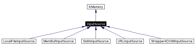

Inheritance diagram for InputSource:  [legend]Collaboration diagram for InputSource:  [legend]List of all members.

InputSource is never used directly, but is the base class for a number of derived classes for particular types of input sources. Derivatives are provided (in the framework/ directory) for URL input sources, memory buffer input sources, and so on.
