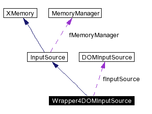

Inheritance diagram for Wrapper4DOMInputSource:  [legend]Collaboration diagram for Wrapper4DOMInputSource:  [legend]List of all members.
