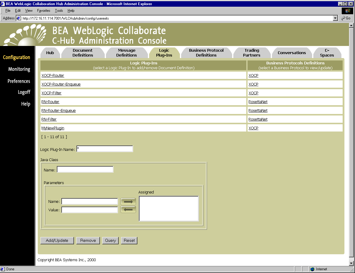

Using the Query Feature to Find Logic Plug-Ins
Notice the * in the Logic Plug-In Name field. This is a special wildcard character used for queries. In the above screen, the table shows all the logic plug-ins on the c-hub (except those configured as bea.hidden). You can type text strings in the Logic Plug-In Name field and do queries on them to refine the table display. For instance, to display just logic plug-ins that start with "XOCP", you can input XOCP* in the Logic Plug-In Name field and click Query. (The query is case-sensitive.) To display information just for XOCP-Router, you can enter XOCP-Router in the Logic Plug-In Name field and click Query, or just click on the XOCP-Router name in the Logic Plug-Ins list.

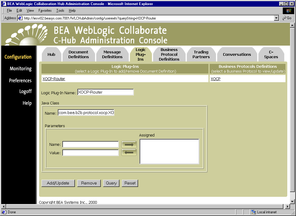

From the main Logic Plug-Ins configuration tab, click on a logic plug-in name under Logic Plug-Ins to display the configuration for that plug-in. (As an example, the following figure shows the configuration screen for a logic plug-in named "XOCP-Router".)
Figure 12-7 Configuration for an Individual Logic Plug-In
You can modify the configuration for the selected plug-in from this screen. Simply redefine the name, parameters, or other attributes as needed, then click Add/Update to save the changes. (For details on the fields, see Table 12-2.)
