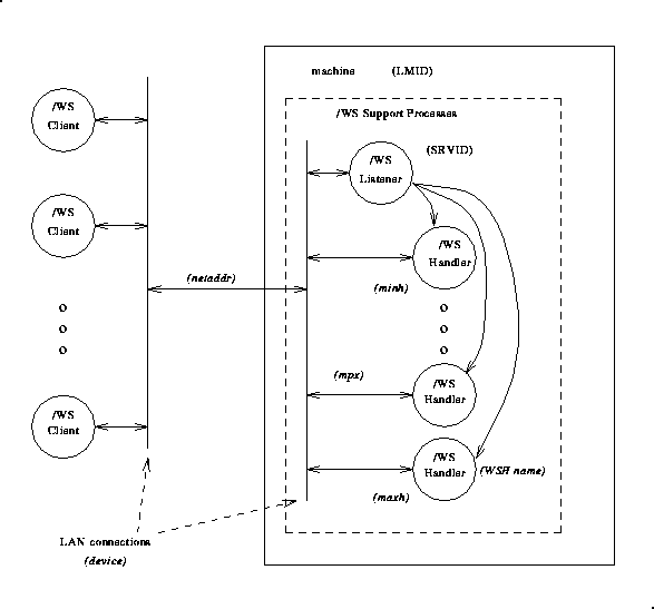

Figure 2-1 illustrates the relationship between Workstation clients and the support processes on the machine serving as the administrative domain. The words in parentheses are substitutables in the command line options of the
The format of the As noted above, the The This is required. The value of When a large number of workstation clients attempt to connect simultaneously, some of the requests may time out due to a blocking condition. The The The Use The entries related to Workstation as specified in the configuration file for the WSL or server entry parameters.
Figure 2-1 BEA TUXEDO Workstation Feature: Support Processes
CLOPT parameter is as follows:
CLOPT="[-A] [servopts options] - - -n netaddr [-d device] \
[-w WSHname] [-t timeout-factor] [-T client-timeout] \
[-m minh] [-M maxh] [-x mpx-factor] \
[-p minwshport] [-P maxwshport] \
[-I init-timeout] [-c compression-threshold] [-k compression-threshold] \
[-z bits] [-Z bits] [-H external_netaddr] [-K {client|handler|both|none}]"-A value indicates that the WSL is to be booted offering all its services. This is a default, but it is shown in the example to emphasize the distinction between system-supplied servers and application servers. The latter may be booted offering only a subset of their available services.
-- syntax marks the beginning of parameters that are passed to the WSL after it has been booted.
