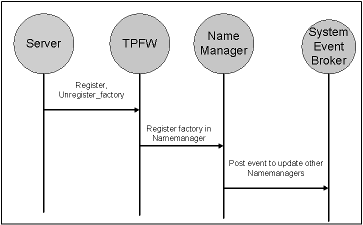

Registering a Factory
For a client application to be able to obtain a reference to a factory, an application server must register a reference to any factory object for which it provides an implementation with the FactoryFinder (see Figure 5-1). Using the WebLogic Enterprise TP Framework, the registration of the reference for the factory object can be accomplished using the TP.register_factory operation, once a reference to a factory object has been created. The reference to the factory object, along with a value that identifies the factory, is passed to this operation. The registration of references to factory objects is typically done as part of initialization of the application; normally, as part of the implementation of the Server.initialize operation.
Figure 5-1 Registering a Factory Object
When the server application is shutting down, it must unregister any references to the factory object that it has previously registered in the application server. This is done by passing the same reference to the factory object, along with the corresponding value used to identify the factory, to the TP.unregister_factory operation. Once unregistered, the reference to the factory object can then be destroyed. The process of unregistering a factory with the FactoryFinder is typically done as part of the implementation of the Server.release operation. For more information about these operations, see the section "Server Interface" on page 3-23.

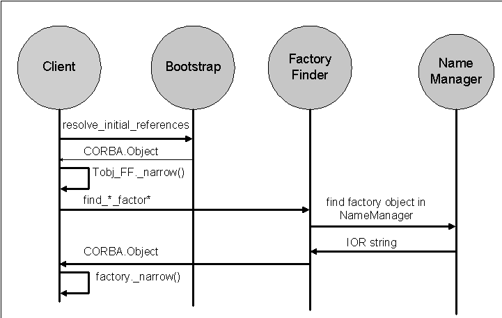

Locating a Factory
For a client application to request a factory to create a reference to an object, it must first obtain a reference to the factory object. The reference to the factory object is obtained by querying a FactoryFinder with specific selection criteria, as shown in Figure 5-2. The criteria are determined by the format of the particular FactoryFinder interface and method used.
Figure 5-2 Locating a Factory Object

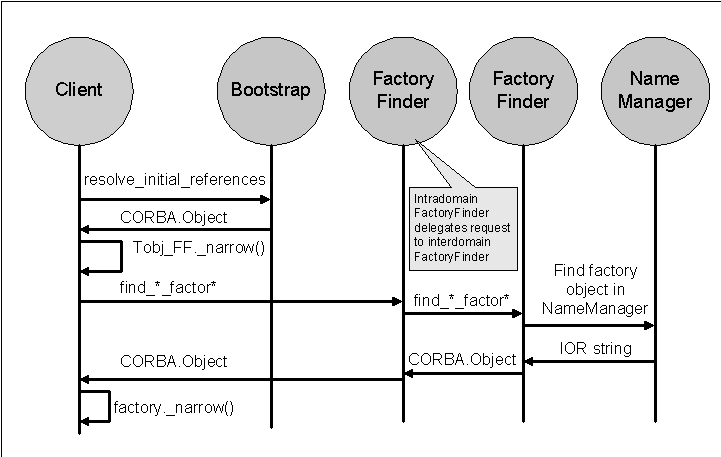

Locating Factories in Another Domain
Typically, a FactoryFinder returns references to factory objects that are in the same domain as the FactoryFinder itself. However, it is possible to return references to factory objects in domains other than the domain in which a FactoryFinder exists. This can occur if a FactoryFinder contains information about factories that are resident in another domain (see Figure 5-3). A FactoryFinder finds out about these interdomain factory objects through configuration information that describes the location of these other factory objects.
When a FactoryFinder receives a request to locate a factory object, it must first determine if a reference to a factory object that meets the specified criteria exists. If there is registration information for a factory object that matches the criteria, the FactoryFinder must then determine if the factory object is local to the current domain or needs to be imported from another domain. If the factory object is from the local domain, the FactoryFinder returns the reference to the factory object to the client.
Figure 5-3 Inter-domain FactoryFinder Interaction
If, on the other hand, the information indicates that the factory object is from another domain, the FactoryFinder delegates the request to an interdomain FactoryFinder in the appropriate domain. As a result, only a FactoryFinder in the same domain as the factory object will contain a reference to the factory object. The interdomain FactoryFinder is responsible for returning the reference of the factory object to the local FactoryFinder, which subsequently returns it to the client.

Server Registering a Factory
Listing 5-6 shows how to program a server to register a factory.
Listing 5-6 Server Application: Registering a Factory
// Register the factory reference with the factory finder.
// The second parameter to TP.register_factory() is a string
// identifier that is used to identify the object.
// This same string is used in the call to TP.unregister_factory().
// It is also used in the call to find_one_factory_by_id() that
// is called by clients of this interface.
fact_oref, // factory object reference
tellerFName // factory name
Client Obtaining a FactoryFinder Object Reference
