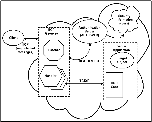

Figure 6-1 shows the security environment components.
When a user or other principal wants to use the WebLogic Enterprise system, the principal usually needs to authenticate and obtain credentials. The credentials obtained by the principal contain identity attributes that are used to control access to WebLogic Enterprise servers.
The WebLogic Enterprise Principal Authentication object provides a delegation mechanism to provide security to non-BEA branded clients. As illustrated in Figure 6-1, remote client applications perform authentication with the ISL/ISH, instead of with the server application itself. Consequently, the establishment of a security association is performed in the ISL/ISH, rather than in the server-side ORB.
In terms of CORBA security, the ISL/ISH acts as a CORBA-defined half-gateway into the WebLogic Enterprise domain, and is, therefore, responsible for providing the security mechanisms that will be used in secure invocations for a given object.

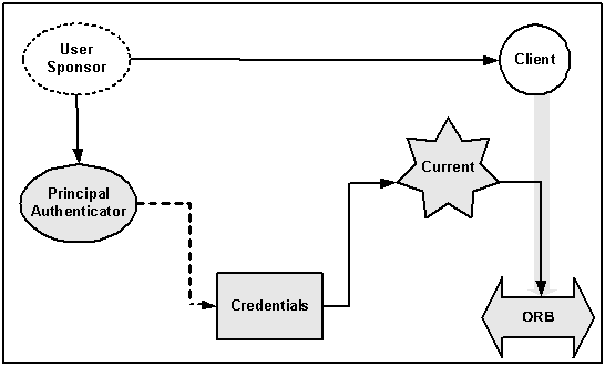

The process of authenticating a principal is done by a user sponsor (see Figure 6-2). A user sponsor is the code that calls the security interfaces for user authentication. In a WebLogic Enterprise domain configured to use BEA TUXEDO-based security, the client application is the user sponsor.
In either case, the user provides identity and authentication data, such as a password, to the user sponsor. The user sponsor uses the Principal Authenticator object provided as part of the security implementation to make the calls necessary to authenticate the principal. The credentials for the authenticated principal are associated with the security system's implementation of the SecurityCurrent object and are represented by a Credentials object.
Authentication Process
Figure 6-2 Authentication
The Principal Authenticator object is the object visible to the application that is responsible for the creation of Credentials for a given principal. A user or principal that requires authentication but has not been authenticated uses the Principal Authenticator object.

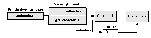

The SecurityCurrent object represents the current execution context at the client and target object. The SecurityCurrent object provides methods to give access to security information associated with the execution context. The SecurityCurrent object gives access to the Credentials associated with the execution environment.
At any stage, a client or target object can find the default credentials for subsequent invocations by calling the Current.get_credentials
method to request the invocation credentials. These default credentials are used in all invocations that use object references.

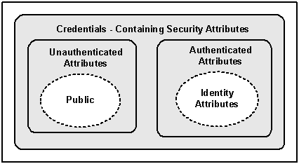

A Credentials object (see Figure 6-3) holds the security attributes of a principal. The Credentials object provides methods to obtain and set the security attributes of the principals it represents. These security attributes include its authenticated or unauthenticated identities and privileges. The Credentials object also contains information for establishing security associations.
Credentials objects are created as the result of:
There can be more than one Credentials object in a process address space. Multiple references to a Credentials object must be supported. A Credentials object is stateful. It maintains state on behalf of the principal for which it was created. This state includes any information necessary to determine the identity and privileges of the principal it represents. Credentials objects are not associated with the Principal Authenticator object that created it, but must contain some indication of the authentication authority that certified the principal's identity.
