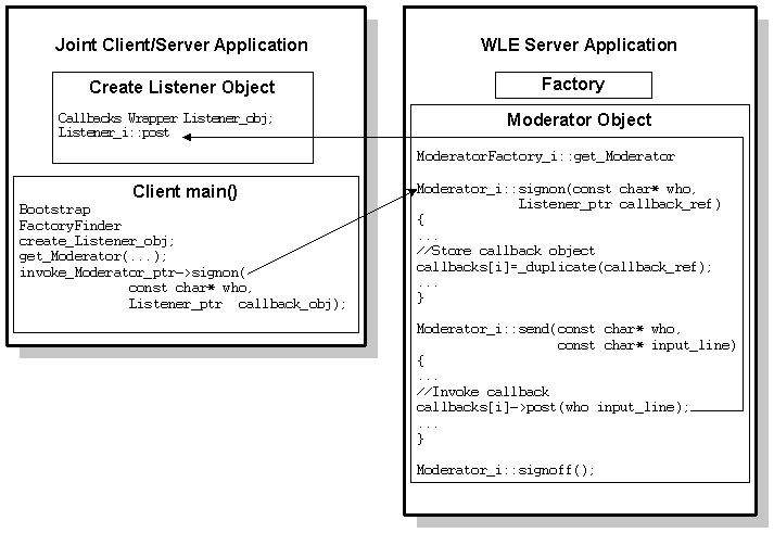

Figure 2-1 illustrates how the Chat Room sample application works.
Figure 2-1 How the Chat Room Sample Application Works
The Chat Room sample application works as follows:
  1. The joint client/server application implements the logic for the callback object (the Listener object), creates a servant for the Listener object, and activates the Listener object.
  2. The joint client/server application creates an object reference for the Listener object and passes it to the Moderator object as part of the signon operation.
  3. The server application in the Chat Room sample application checks the keyboard for messages.
  4. When messages are generated at the keyboard, the Chat Room sample application sends the messages to the Moderator object via the send operation.
  5. The Chat Room sample application temporarily passes control over to the ORB to allow the Listener object in the joint client/server application to receive post invocations from the Moderator object.
  6. The Listener object in the joint client/server application saves the posted messages until a client application requests them.
