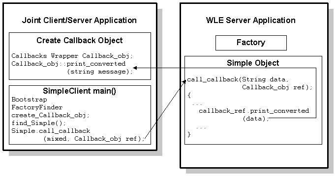

The Callback Sample Application
print_converted
method, which accepts a string from the Simple
object in the WLE server application and prints the string in uppercase and lowercase letters.
Figure 3-1 How the Callback Sample Application Works
WLEdir\
samples\corba\callback_java
directory of the WLE software. See "Building and Running the Callback Sample Application" for more information.
