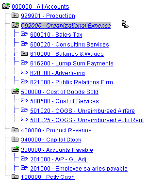

You can define security rules for specific budgets and for a range or group of budgets. Instead of specifying each individual ChartField combination that you want to include within a security rule, you can specify ranges of budgets by entering ranges of ChartField values.
There are three parameters you can use to enter ranges of ChartFields:
Range: enter the first and last ChartField value in a range. If you enter account 10000 as the start value and 20000 as the end value, for example, you include all budgets with accounts 10000 through 20000 that meet the other ChartField value criteria in the ChartField combination.
Wild Card: enter a wildcard (%). For example, if you enter department 14%, you include all budgets with departments beginning with 14 that meet the other ChartField value criteria in the ChartField combination. If you enter % alone, you include budgets for all departments that meet the other ChartField value criteria in the ChartField combination.
Tree: enter a translation tree and node to include budgets for that node and all the ChartField values that are children of that node (and which meet the other ChartField value criteria in the ChartField combination). Usually you can use the key ChartField translation trees you set up for control budget definitions.
Note. You use Explicit when you want to select a single ChartField value, which you enter in the Start field.
See Key ChartFields and Translation Trees.

ChartField Combination Set#2:
ChartField |
Parameter |
Start |
End |
Tree |
Node |
ACCOUNT |
Tree |
BUD_ACCOUNT |
682000 |
DEPTID |
Wildcard |
335% |
PRODUCT |
Range |
200 |
250 |
The following is an excerpt from the BUD_ACCOUNT ChartField tree for this example:
Accounts ChartField tree excerpt
Assume the following budgets are defined:

Your security rule would apply to the budgets whose ChartField values appear in italics in the table.
