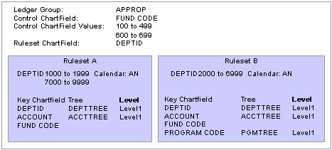

The Control ChartField and the Ruleset ChartField are always required as keys for all Rulesets. Each Ruleset in a budget definition can have its own set of additional budget keys.
See Defining Ruleset ChartFields.

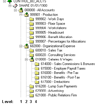

Accounts Tree Example
The following example illustrates how tree levels translate data.
Sample translation tree
The sample translation tree contains the following levels, beginning with the level 1 node:
Level1: Node 000000
Level2: 999901 and 682000
Level3: 999902−999907, 600010−600020, 610000, and 616200−621000
Level4: 614000−617000
When you define a control budget definition, you enter the tree level at which you want to define budgets for each key ChartField. Suppose that you want to budget at account ChartField level 3 for the sample translation tree. You enter tree level 3 for account on the Keys and Translations page. All account values found at level 3 and levels 2 and 1 above it are then valid for budget journals, and all source transaction account values below level 3 roll up for budget checking to the budgets that you define at that level. Budget Journal processing validates against the translation rules that you established in your budget definition in the tree to ensure that you selected the correct value for the budget account.
On the Control ChartField page, you can also choose whether or not to include all control ChartField values at your budgeting level or to exclude some. The results depending on your choices are:
If you select the All Values option, then all control ChartField values at or above the tree level you entered on the Keys and Translations page are valid for budgeting and budget-checking. Source transactions with any value for the control ChartField are budget checked.
If you clear the All Values check box, you must enter each value that you want to be valid for budgeting on the ChartField Values grid. Only source transactions with values that translate to the values in the list are budget checked.
For example, assume that you are budgeting at level 3. You clear the All Values check box and enter the values 999901 and 610000 onto the ChartField Values grid. You encounter the following:
If a purchase order has the level 4 account 614000, the Budget Processor translates the account to 610000 by using the tree and level information that you entered on the Keys and Translations page. The Budget Processor checks account 610000.
If a second purchase order has the level 3 account 616200, the Budget Processor translates the account to itself.
Because 616200 is not one of the level 3 accounts that you entered as valid for budget checking, the Budget Processor does not budget check this transaction.

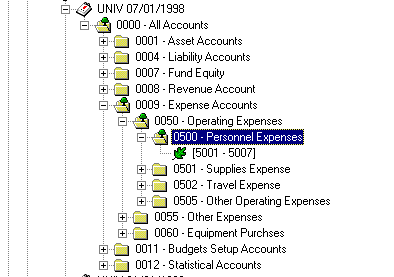

A spring tree is a hybrid between a node-only winter tree and a summer tree. A summer tree uses the PS_TREE_NODE table for nodes and a detail value table for leaves. A spring tree uses a detail value table for the nodes as well as the leaves:
Spring tree
In this spring tree, the 0500 account is a budget-level node, whereas accounts 5001-5007 are detail-level leaves that roll up to the 0500 node. Note that you can define leaves in spring trees as ranges of detail values.
Spring trees reduce tree maintenance by allowing you to add ChartField values to the system without having to update trees, as long as new values are within a detail-value range already defined for the tree.
Whether you use spring or winter trees, each node must be a valid ChartField value. You must therefore assign the detail table name as the tree node table in the tree structure.

RulesetsSome organizations require that a budget definition includes more than one set of the following rules:
Key ChartFields required for budget journals and source transactions.
Translation tree and level at which you budget for the key ChartFields.
Budget period calendar, which specifies valid budget periods.
You can, for example, budget at a higher translation level for a few of the budgets in your budget definition. You can also have some budgets in a budget definition that require an additional key ChartField, such as program ID or project ID, for tracking purposes.
For this reason, budget definitions include subsets, called Rulesets. Each Ruleset defines a different set of keys, translations, and budget period calendar.
Each budget definition has a Ruleset ChartField the values of which are used by the Budget Processor to determine which Ruleset each source transaction line should reference. You define the Ruleset ChartField values that apply to each Ruleset. The system automatically creates a default Ruleset, which is used for any Ruleset ChartField values that you do not explicitly assign to a Ruleset.
The following is an example of the use of rulesets:
Using Rulesets
The appropriation budget definition in the Using Rulesets example requires two Rulesets, because departments 2000 to 6999 require program codes on budget journals and source transactions for tracking purposes, whereas departments 1000 to 1999 and 7000 to 9999 do not. In all other respects, the appropriation budgets for these departments use the same processing rules (except for the attributes that you can override below the Ruleset level).
If you have only one set of budget keys, translation rules, and budget calendar for a budget definition, use the default Ruleset as your single Ruleset, with the control ChartField as the Ruleset ChartField. It is unnecessary, in that case, to enter any data onto the Ruleset page. If Budget Processor cannot find a Ruleset with the values matching the transaction, the Default Ruleset is used, provided the transaction is subject to control in that ledger.
Note. Rulesets must be mutually exclusive and complete, so that there are no multiple or missing setup parameters for a single ChartField value. When you save the Keys and Translations page, the Ruleset ChartField list is edited to ensure that there are no overlaps. When the Ruleset ChartField itself is translated , the system ensures that no node is split across two different Rulesets.

Defining Translation Trees for Budget Key ChartFieldsThis section discusses how to set up translation trees for key ChartFields.
See Also
Key ChartFields and Translation Trees
Page Used to Define Translation Trees for Budget Key ChartFields
Setting Up Translation Trees for Budget Key ChartFieldsInclude the following steps when you define translation trees for key ChartFields:
Assign the detail table name as the tree node table in the tree structure.
Each node must be a valid ChartField value, and you cannot use general labels such as ALLACCTS or ASSETS. For the account tree, or any tree based on a fully configurable ChartField, you can take advantage of the Budgetary Use Only check box and use a view selecting accounts with budgetary use only value of y as the tree node table.
On the Tree Definitions and Properties page:
Select the COMMITMENT CONTROL category.
Clear the All Detail Values in this Tree and the Allow Duplicate Detail Values check boxes.
Select Strictly Enforced levels.
When you define levels, clear the All Values box for all but the first level.
Warning! Level names cannot contain spaces.
After you define a tree, run the Budgetary Control Tree Audit report (GLS8007) to validate the following:
Tree structure and tree definition settings.
That all ChartField values are defined on the tree or represented by a detail node range.
Run the report when you add new ChartField values. Also run the report periodically to make sure that all ChartFields are represented in the appropriate tree.
You must have a tree for each ChartField that you use as a budget key and that you want to translate.
The budget processor references the version of the tree that has the greatest effective date that is less than or equal to the budget definitions effective date that is used to process a particular transaction. The budget definition's effective date is based on the budget date specified on every source transaction line.
The budget processor looks to the latest translation tree, that is the tree with the latest effective date, whether it is active or inactive when processing transactions with dates after the latest effective dated tree. For example, assume you have a tree for which the initial effective date is January 1, 1900 and its status is active. If you then create a tree for February 1, 2005 and set the status to inactive, the budget processor still looks to the latest tree with the effective date of February 1, 2005 for any transactions dated later than February 1, 2005. Under these conditions the budget processor will not process using the active tree dated January 1, 1900 but issues a message that there is an invalid tree because the February 1, 2005 tree is inactive.
Important! Do not include a ChartField value more than once in a tree. The audit may not report duplicate values if they occur at different translation levels.
See Also
Summarizing ChartFields Using Trees

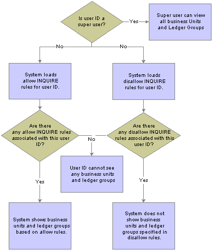

Commitment control security augments the security provided by PeopleSoft applications and PeopleTools for row level security for business units and ledger groups. However, the displaying of results for funding source inquires is primarily based on commitment control security setup.
Funding source inquires reference the commitment control Budget Inquire (INQUIRE) security event and your particular related securities setup and rules to determine which business units and ledger groups, that are found by any given search criteria, are displayed in the search results for a particular user ID.
Access to data for funding source allocations and activity inquiries depends on both commitment control and row level security. However, the total allocation amount and amount not allocated, which is the total defined funding source amount less the sum of the allocations that were already setup across business unit and control ChartField are calculated regardless of row level and commitment control security.
This diagram shows security behavior and the allow and disallow rules as applied to inquiry.
Inquiry security
See Setting Up Commitment Control Security.
