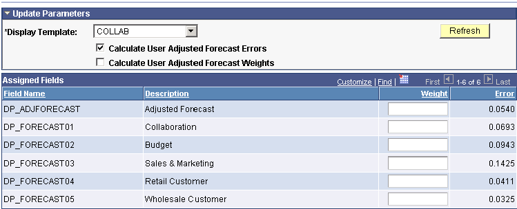

Error Calculations
You calculate errors in a similar manner as the MAPE (mean absolute percentage error updates) values currently being calculated. The user-adjusted forecast dataset is compared to the actual demand dataset for the calculation of an aggregate MAPE across all items for a forecast view and level. If the resulting error value is greater than 1.0000, then the system uses 1.0000.
During the calculation, the system uses the standard MAPE error calculation for the last historical periods and for each error value that it calculates, it totals those values for each item in that level of the view. That result is then divided by the total number of items in the collection. This provides an average error value for all items in a level of the forecast view. The process continues using first the adjusted forecast dataset as compared to the actual demand dataset, and then progresses through each of the user-adjusted forecast dataset that appear in the grid. If you calculate errors using the Calculate button, the new errors appear immediately for that field. If you calculate errors as a separate step, then you should save the errors prior to calculating weights.
Note. Since the error calculation may take much longer to execute, we suggest that you perform error calculation using Run Control.

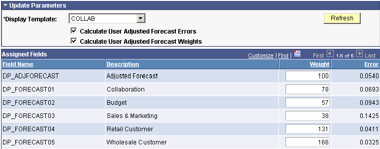

Weight Calculations
To perform weight calculations, the system compares the error for the applicable user-adjusted forecast dataset and the error for the adjusted forecast dataset. The system uses a mean value of 100 to represent the weight for the adjusted forecast dataset. This adjusted forecast weight is never recalculated, and is only used if you want to use the adjusted forecast dataset value in conjunction with the user-adjusted forecast to arrive at a final adjustment value.
This example displays how the system provides an error value when you are updating user-defined forecasts. You can calculate the weight value by selecting the Calculate User Adjusted Forecast Weights check box.
Example of user-adjusted forecast error calculation
Using the example of the calculated error values from the previous page example, the system can calculate a weight value for each field. The adjusted forecast error is multiplied by 100 and then divided by the error of the user-adjusted forecast dataset, which yields the weight for that field. This table describes system calculations:

The system updates the page with the new weights as shown in the next example. You can save the weights or make adjustments to them. If you run the calculations in batch mode, then the results are written directly to the applicable records.
Example of user-adjusted forecast weight calculations

Calculate User Adjusted Forecast Errors
Select to indicate for the system to calculate error values for the fields that appear in the Assigned Fields grid. To calculate the errors, click the Calculate button.
Note. If you select the Calculate User Adjusted Forecast Errors and the Calculate User Adjusted Forecast Weights, the system calculates the errors first and then the weights.
Select to indicate for the system to calculate weight values for the fields that appear in the Assigned Fields grid. To calculate the weights, click the Calculate button. This calculation is relatively quick and does not have to be processed through Run Control.
Field Name
Displays a field and a description that have been included in the collaborative display template. Values appear when you click Refresh.
Weight
The weight determines the influence of this user-defined forecast field in relation to other fields when you are reconciling a forecast. You can override weight values or enter a zero value.
Weight and error are retrieved from fields on the PS_DP_CONFIGLEVELS record for the selected view and level.
Error
Displays the MAPE value for this user-adjusted forecast in this view and level. MAPE values are the absolute values of all the percentage errors that are summed. The higher the value, the less accurate the forecast.

You use the Span From Period, Year, and Number of Periods fields to indicate which periods the system updates for Reconciliation Workbench. If you do not use the fields, the system provides a Reconcile column so you can select records row-by-row for update.
Adjustment Action
Select an action. The Replace action factors user-adjusted forecasts together to arrive at a final adjustment and the Add action aggregates user-adjusted forecasts to arrive at a final adjustment. This makes it possible for you to use forecast inputs from various sources and weight them accordingly, arriving at a final adjustment for collaborative purposes. It also makes it possible for you to accumulate forecast inputs from various sources weight them to arrive at a final adjustment for the forecast. While the same weight would normally be used for each one, it is not required.
If you use the Replace action, the system uses the fields that contain an integer other than blank or zero in the Weights field. If the adjusted forecast contains a weight value, then the system factors the current value into the calculation.
Weights
Enter a weight factor or use the current value in any of the selected fields, including the Adjusted Forecast field. If you do not enter a weight for a row, the system processes it as a zero. Weights provide relative weighting and are aggregated to derive a weight total.
The system uses calculations to factor the selected user-adjusted forecasts against the adjusted forecast to determine the exact forecast adjustment that it applies. If the adjustment action is Replace, the system uses this calculation formula:
(DP_ADJFORECAST * WeightFactorX0 / WeightTotal) + (UAF01 * Weight FactorX1 / WeightTotal) +
If the adjustment action is Add, the system uses this calculation formula:
(DP_ADJFORECAST * WeightFactorX0 / WeightAverage) + (UAF01 * WeightFactorX1 / WeightAverage) +
Note. Only those user-adjusted forecasts that display on the Reconciliation Workbench are included in the calculations.
