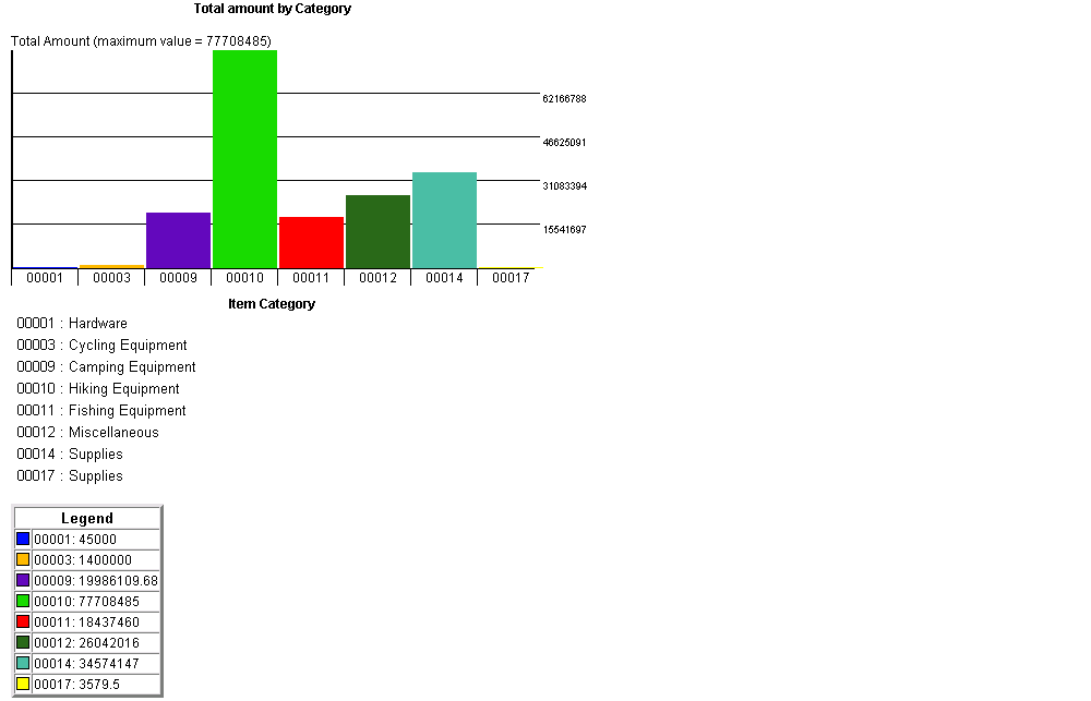

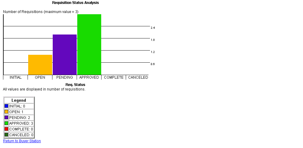

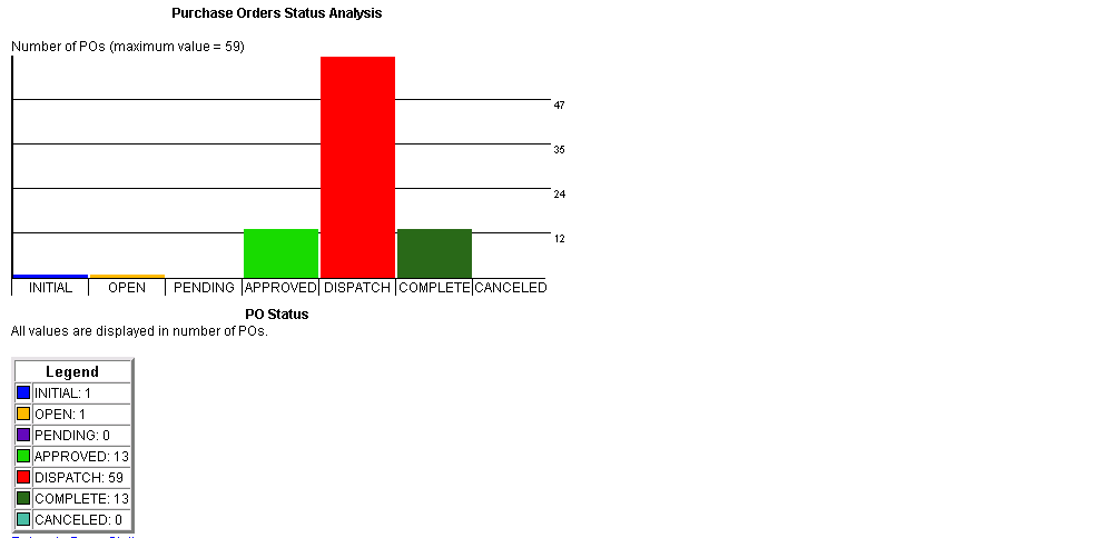

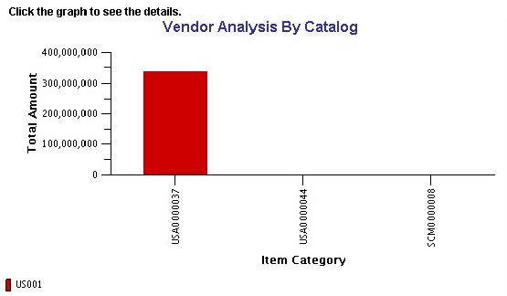

Using the SRM Dashboard
The SRM Dashboard is a centralized portal page with multiple pagelets that provide buyers with essential information to assist them with their daily jobs in one location. These buyer-facing pagelets are delivered with the SRM Dashboard and can be accessed if PeopleSoft Purchasing or PeopleSoft eProcurement are installed.
You may add any the delivered pagelets to the SRM Dashboard page.
The information that appears on each pagelet is by buyer or buyer manager. When a buyer logs into the system, the first page that appears is their home page with their selected pagelets. The information that appears on each pagelet is only those POs or requisitions on which they are specified as the buyer. If a buyer is responsible for multiple purchasing business units, the POs and requisitions for all purchasing business units will appear.

PO Status Analysis |
Provides information about the current state of purchase orders by displaying the number of purchase orders in each purchase order status. |
PO Value Analysis |
Provides information about the total purchase order costs by item category or ship-to location. |
Requisition Status Analysis |
Provides information about the current state of the requisitions by displaying the number of requisitions in each requisition status. |
Vendor Analysis by Categories |
Provides information about total quantities and amounts received from vendors. |
This graph displays the number of purchase orders that are currently in each purchase order status. Each column represents a different purchase order status; the height of the bar indicates the number of purchase orders within that status. The number of purchase orders in the largest column is noted at the top of the graph. The legend provides the total number of purchase orders by status. The graph displays information for only one PeopleSoft Purchasing business unit at a time. Within the business unit, you can further limit the purchase orders that appear to one vendor, one buyer, and for a specific date range.
PO Status Analysis graph
This graph displays the total monetary amount of the purchase orders. This information can be processed by item category (using the purchase order line level) or by ship to location (using the purchase order distribution line level). The method is noted at the top of the graph, along with the total purchase order monetary value in the largest column. Each column represents a different item category or ship to location; the height of the bar indicates the total monetary value of the purchase orders in that category or location. If you sort the information by item category, then a note appears below the graph with the item category descriptions. The Legend provides the total monetary value of all purchase orders by item category or ship to location. The graph displays information for only one PeopleSoft Purchasing business unit at a time. Within the business unit, you can further limit the purchase orders that appear to one vendor, one buyer, and a specific date range.
PO Value Analysis graph
Requisition Status Analysis Graph
This graph displays the number of requisitions that are currently in each requisition status. Each column represents a different requisition status; the height of the bar indicates the number of requisitions within that status. The number of requisitions in the largest column is noted at the top of the graph. The legend provides the total number of requisitions by status. The graph displays information for only one PeopleSoft Purchasing business unit at a time. Within the business unit, you can further limit the requisitions that appear to one requester and for a specific date range.
Requisition Status Analysis graph
Vendor Analysis by Categories Graph
You can view the quantity or amount of goods that a vendor supplies to a business unit for a specific category using the Vendor Analysis by Categories graph. The system totals the monetary value to arrive at an amount value from each vendor or it totals the number of units to arrive at a quantity from each vendor.
