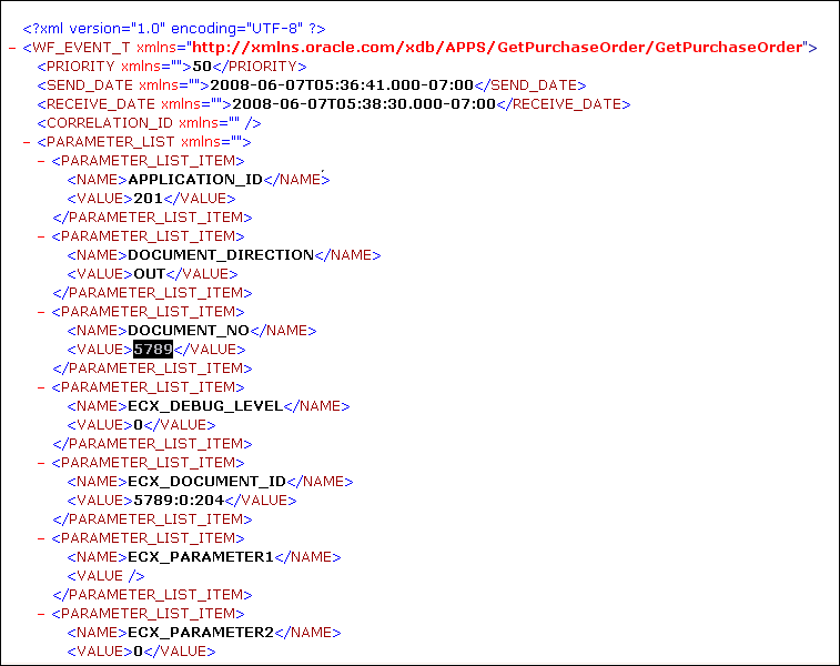

When a purchase order is created and approved, a Purchase Order Approved business event oracle.apps.po.evnt.xmlpo is raised. Since the subscription to this event is created through the interface details page (internally, an event subscription is automatically created for the selected event with WF_BPEL_QAGENT as Out Agent), and enqueued in WF_EVENT_T structure to Advanced Queue WF_BPEL_Q, we will create a BPEL process to first dequeue the subscription from the WF_BPEL_Q queue to get the event details. The event details will be passed through BPEL process activities and then will be written in XML file as an output file.

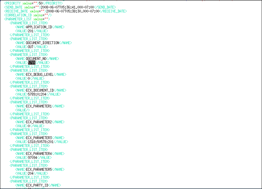

If the BPEL process is successfully executed after deployment, you should get the same purchase order information from the output file once a purchase order is approved.

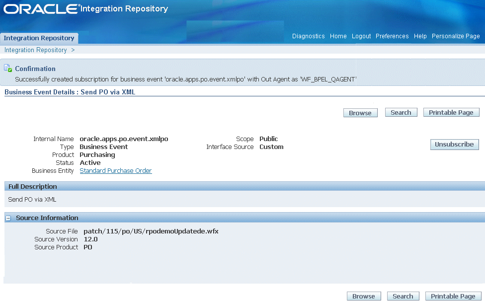

Integration repository administrators must first subscribe to a business event from the Oracle Integration Repository user interface. Internally, an event subscription is automatically created for that event with WF_BPEL_QAGENT as Out Agent.
For example, a business event oracle.apps.po.event.xmlpo needs to be subscribed. A confirmation message appears if the event subscription is successfully created.
Subscribing to a Business Event
To subscribe to a business event, the administrators will first locate an event from the Oracle Integration Repository, and then click Subscribe in the interface detail page to create the subscription.
For information on how to subscribe to business events, see Subscribing to Business Events, Oracle E-Business Suite Integrated SOA Gateway Implementation Guide.

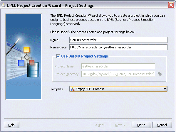

In the Name field, enter a descriptive name such as GetPurchaseOrder.
From the Template list, select Empty BPEL Process and then select Use Default Project Settings.
Click Finish.
Creating a New Project
A new BPEL project is created with the required source files including bpel.xml, using the name you specified (for example, GetPurchaseOrder.bpel).

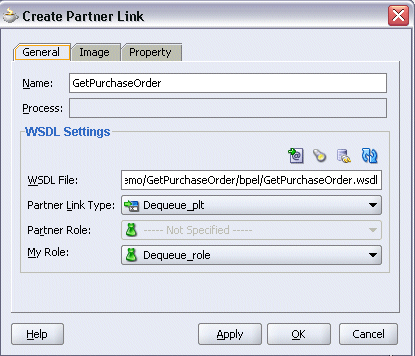

Use this step to create a Partner Link called GetPurchaseOrder for AQ Adapter to dequeue the subscription to oracle.apps.po.evnt.xmlpo event.
To create a partner link for AQ Adapter to dequeue the event subscription:
In JDeveloper BPEL Designer, drag and drop the AQ Adapter service from the Component Palette into the Partner Link border area of the process diagram. The Adapter Configuration Wizard appears.
Enter a service name in the Service Name dialog box, for example GetPurchaseOrder. You can also add an optional description of the service.
Click Next. The Service Connection dialog box appears.

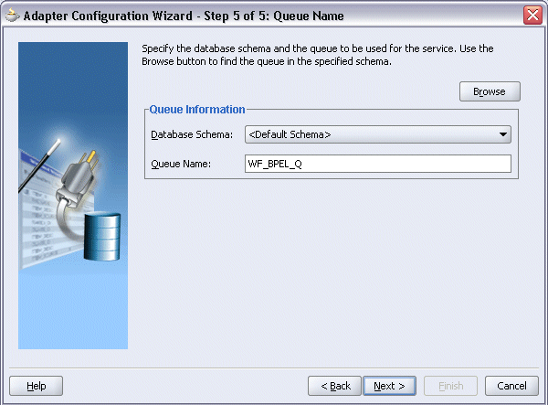

Click Next to open the Queue Name dialog box.
Select Default Schema as the Database Schema field. Enter 'WF_BPEL_Q' as the Queue Name field.
Click Next to open the Queue Parameter dialog box.

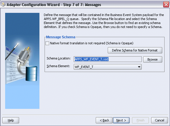

Click Next. The Messages dialog box opens where you can define the message that will be contained in the Business Event System payload for the APPS.WF_BPEL_Q queue.
Click Browse to open the Type Chooser window to select APPS_WF_EVENT_T.xsd as the Schema Location and WF_EVENT_T as the Schema Element.
Click Next to proceed to the Finish dialog box to confirm that you have finished defining the AQ Adapter for the GetPurchaseOrder service.
Click Finish. The wizard generates the WSDL file corresponding to the GetPurchaseOrder service.
Click Apply and then OK to complete the partner link configuration. The partner link is created with the required WSDL settings, and is represented in the BPEL project by a new icon in the border area of the process diagram.

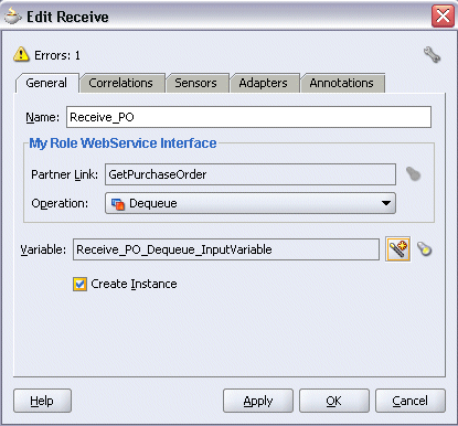

To add a Receive activity to obtain Purchase Order XML data:
In JDeveloper BPEL Designer, drag and drop the Receive activity from the BPEL Activities section of the Component Palette into the Activity box of the process diagram.
Link the Receive activity to the GetPurchaseOrder partner link. The Receive activity will take event data from the partner link. The Edit Receive dialog box appears.

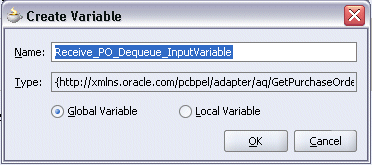

Enter a name for the receive activity such as 'Receive_PO' and then click the Create icon next to the Variable field to create a new variable. The Create Variable dialog box appears.
Creating a Variable
Select Global Variable and then enter a name for the variable. You can accept the default name. Click OK to return to the Edit Receive dialog box.
Select Create Instance check box then click Apply and then OK to finish configuring the Receive activity.
Editing the Receive Activity

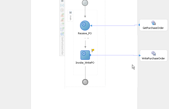

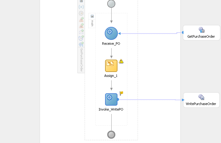

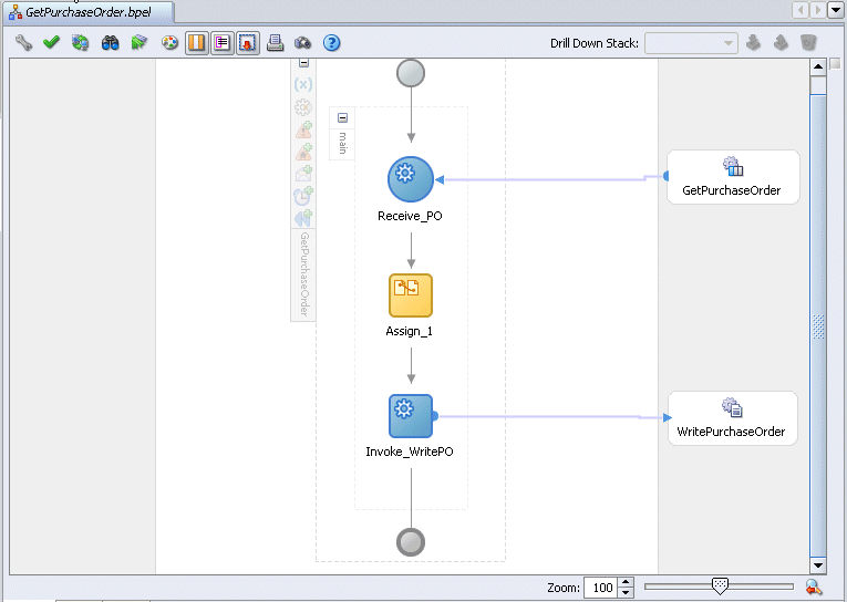

The Receive activity appears in the BPEL process diagram.
Process Diagram with Receive Activity

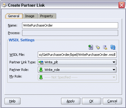

To add a Partner Link for File Adapter:
In JDeveloper BPEL Designer, drag and drop the File Adapter service from the Adapter Service section of the Component Palette into the Partner Link area of the process diagram. The Adapter Configuration wizard appears.
The Service Name dialog box appears.
Specifying the Service Name

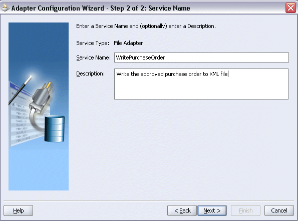

Enter a name for the file adapter service such as WritePurchaseOrder. You can add an optional description of the service.

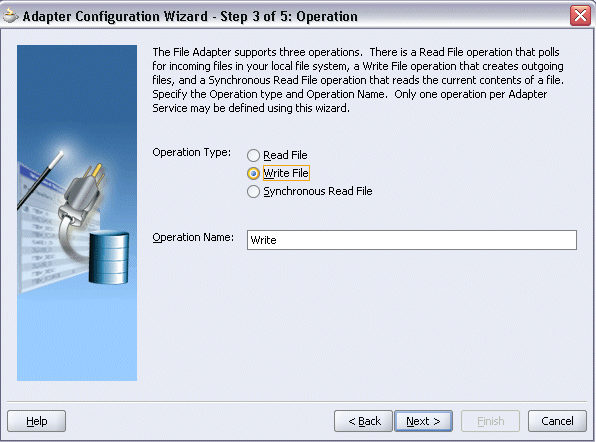

Click Next and the Operation dialog box appears.
Specifying the Operation
Specify the operation type, for example Write File. This automatically populates the Operation Name field.

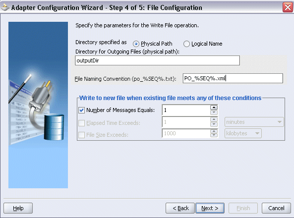

Click Next to access the File Configuration dialog box.
Configuring the Output File
For the Directory specified as field, select Physical Path. Enter directory path in the Directory for Outgoing Files field, and specify a naming convention for the output file such as PO_%SEQ%.xml.
Confirm the default write condition: Number of Messages Equals 1. Click Next. The Messages dialog box appears.

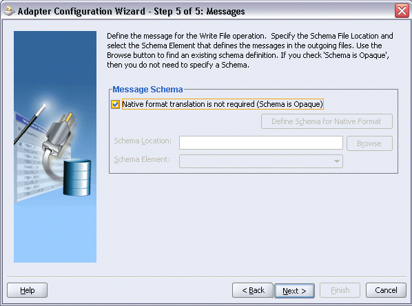

Select Native format translation is not required (Schema is Opaque) check box.
Specifying Message Schema
Click Next and then Finish. The wizard generates the WSDL file corresponding to the partner link. The main Create Partner Link dialog box appears, specifying the new WSDL file WritePurchaseOrder.wsdl.
Completing the Partner Link Configuration
Click Apply and then OK to complete the configuration and create the partner link with the required WSDL settings for the File Adapter Service.
The WritePurchaseOrder Partner Link appears in the BPEL process diagram.
Adding the Partner Link for File Adapter

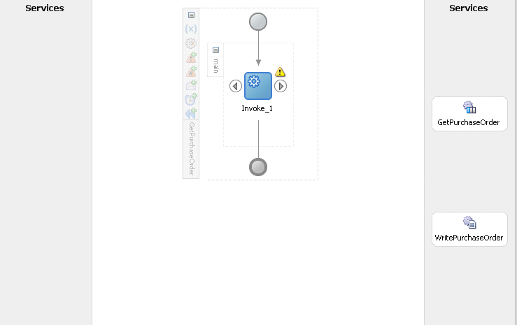

This step is to configure an Invoke activity to write the purchase order approved event details that is received from the Receive activity to the WritePurchaseOrder partner link in an XML file.
To add an Invoke activity:

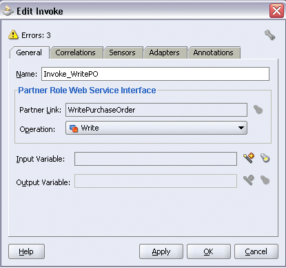

In JDeveloper BPEL Designer, drag and drop the Invoke activity from the Component Palette into the Activity box of the process diagram, after the Receive activity.
Link the Invoke activity to the WritePurchaseOrder service. The Invoke activity will send event data to the partner link. The Edit Invoke dialog box appears.
Editing the Invoke Activity

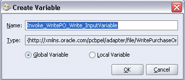

Enter a name for the Invoke activity, and then click the Create icon next to the Input Variable field to create a new variable. The Create Variable dialog box appears.
Creating a Variable
Select Global Variable and then enter a name for the variable. You can also accept the default name. Click OK to close the Create Variable dialog box.
Click Apply and then OK in the Edit Invoke dialog box to finish configuring the Invoke activity.
The Invoke activity appears in the process diagram.
Process Diagram With Invoke Activity

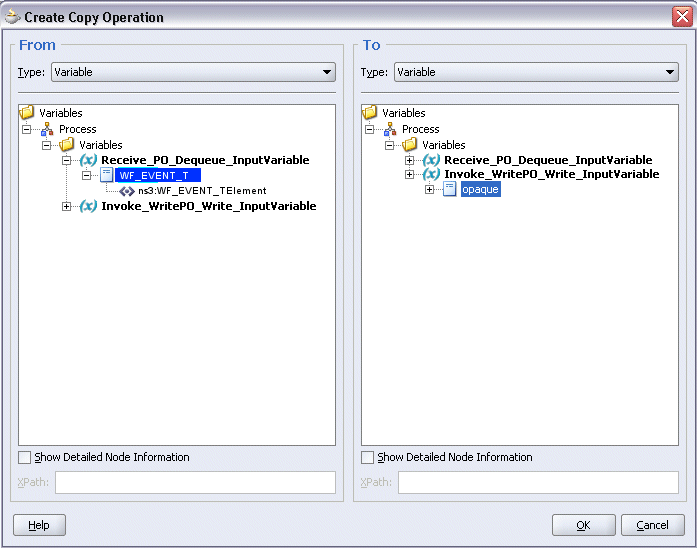

Use this step to pass the purchase order approved event details from the Receive activity to the Invoke activity.
To add an Assign activity:
In JDeveloper BPEL Designer, drag and drop the Assign activity from the Component Palette into the Activity box of the process diagram, between the Receive activity and the Invoke activity.
Process Diagram with Assign Activity
Double-click the Assign activity to access the Edit Assign dialog box.
On the Copy Operation tab, click Create and then select Copy Operation from the menu. The Create Copy Operation dialog box appears.
Defining the Copy Operation
In the From navigation tree, select type Variable. Navigate to Variable > Process > Variables > Receive_PO_DEQUEUE_InputVariable > WF_EVENT_T and select ns3:WF_EVENT_T element. The XPath field should contain your selected entry.
In the To navigation tree, select type Variable. Navigate to Variable > Process > Variables > Invoke_WritePO_Write_InputVariable > WF_EVENT_T and select Opaque. The XPath field should contain your selected entry.
Click OK to close the Create Copy Operation dialog box.
Click Apply and then OK in the Edit Assign dialog box to complete the configuration of the Assign activity.

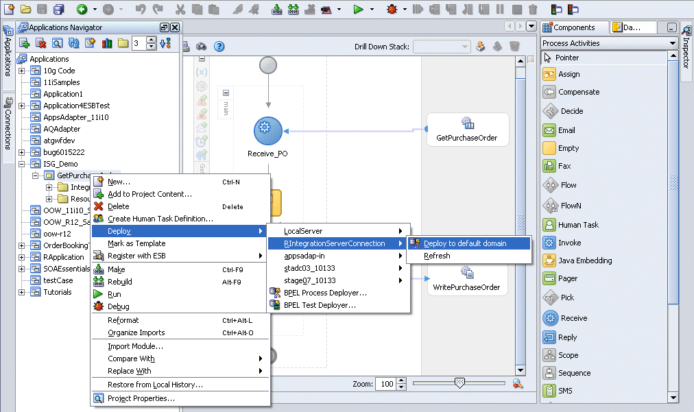

In the Applications Navigator of JDeveloper BPEL Designer, select the GetPurchaseOrder project.
Right-click the project and click Make action from the menu.
Look for any compilation error messages in Message Log.

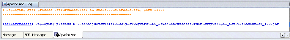

Right-click the project and select Deploy >Integration Server Connection name > Deploy to Default Domain action from the menu.
For example, you can select Deploy > BPELServerConn > Deploy to Default Domain to deploy the process if you have the BPEL Process Manager setup appropriately.
Deploying the BPEL Process
Look for ‘Build successful’ message in Apache Ant – Log to ensure that the BPEL project is compiled and successfully deployed.
Compilation and Deployment Message Logs

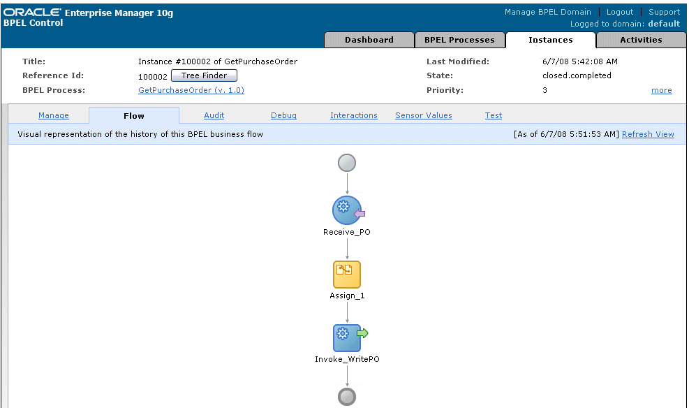

To validate whether the BPEL process that you created works or not, you need to manually initiate the process after it has been successfully deployed to the BPEL console. Therefore, the validation starts with the BPEL console to ensure that you can find the deployed BPEL process listed in the console. Then, you can log on to Oracle E-Business Suite to manually initiate the purchase order approval and acknowledgement processes and to confirm that the relevant event is raised and the updated purchased order details is also written in the XML file.
To manually test the BPEL process:
Log into Oracle Application Server 10g BPEL Console ( http://<soaSuiteServerHostName>:<port>/BPELConsole). The BPEL Console login page appears.
Enter the username and password and click Login.
The Oracle Enterprise Manager 10g BPEL Control appears.
In the BPEL Console, confirm that GetPurchaseOrder has been deployed.
Deployed BPEL Processes

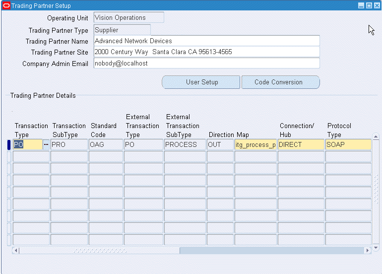

Select Define Trading Partner from the navigation menu to access the Trading Partner Setup window.
Enter the header values on the Trading Partner Setup form as follows:
Trading Partner Type: Supplier
Trading Partner Name: For example, Advanced Network Devices
Trading Partner Site: Enter a trading partner site information. For example, 2000 Century Way, Santa Clara, CA 95613-4565
Company Admin Email: Enter a valid email address.
Enter the following trading partner details:
Transaction Type: PO
Transaction SubType: PRO
Standard Code: OAG
External Transaction Type: PO
External Transaction SubType: Process
Direction: Out
Map: itg_process_po_007_out
Connection / Hub: DIRECT
Protocol Type: SOAP
Save the trading partner details. Switch responsibility back to Purchasing, Vision Operations (USA) and select Purchase Order from the navigation menu.

Log into Oracle BPEL Process Manager, and return to the BPEL Console to confirm that the GetPurchaseOrder process has been completed.
To verify, select the instance of your deployed process which opens up in the Instances tab of your selected BPEL process.
Double-click on the Receive activity in the BPEL process diagram and click the View XML document link to open the XML file. Please note that the purchase order (number 5789) has been received.
Examining the Receive Event Name
Examine the Assign and Invoke activities as well for the event raised and document number.
Go to the directory you specified for the write operation, for example outputDir (typically c:\temp). Open the output file (for example PO_1.xml), and confirm that the order number is the same as that of the approved purchase order.
Confirming the Output Order Number
