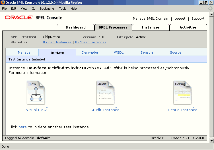

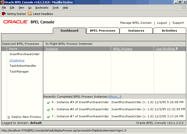

If the BPEL process is successfully executed after deployment, you should be able to validate if the generated shipment notice has correct trading partner information as described in the sales order.

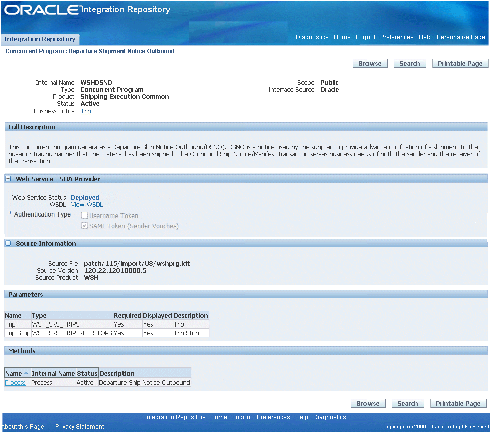

An integration repository administrator needs to successfully deploy the generated concurrent program Web service to the application server.
An integration developer needs to locate and record the deployed WSDL URL for the concurrent program exposed as a Web service.

To generate a Web service, locate the interface definition first from the Oracle Integration Repository (such as Departure Shipment Notice Outbound WSHDSNO concurrent program ) and click Generate WSDL in the interface details page. The Web Service - SOA Provider region appears in the interface details page. For detailed instruction on how to generate a Web service, see Generating Web Services, Oracle E-Business Suite Integrated SOA Gateway Implementation Guide.
To deploy a generated Web service, select at least one authentication type and click Deploy in the Web Service - SOA Provider region of the interface details page to deploy the service.
Once the service is successfully deployed, the selected authentication type(s) will be displayed along with 'Deployed' Web Service Status. For more information on securing Web services with authentication types, see Managing Web Service Security, Oracle E-Business Suite Integrated SOA Gateway Implementation Guide.
For detailed instruction on how to deploy a Web service, see Deploying Web Services, Oracle E-Business Suite Integrated SOA Gateway Implementation Guide.

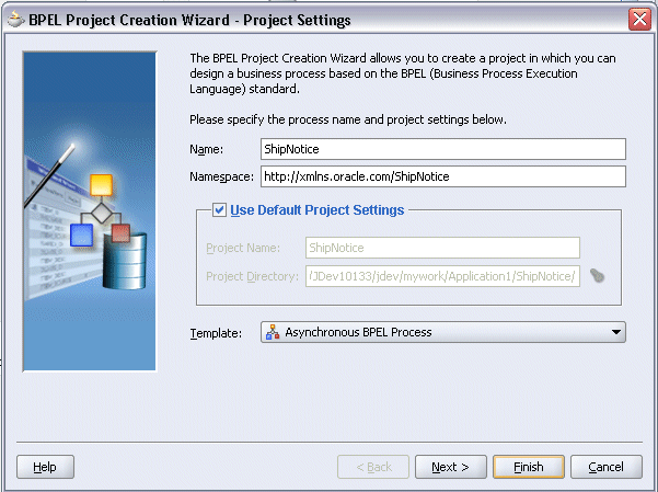

Use this step to create a new BPEL project that will contain various BPEL process activities.
To create a new BPEL project:
Open JDeveloper BPEL Designer.
From the File menu, select New. The New Gallery dialog box appears.
Select All Items from the Filter By box. This produces a list of available categories.
Expand the General node and then select Projects.
Select BPEL Process Project from the Items group.
Click OK. The BPEL Process Project dialog box appears.
Entering BPEL Project Information
In the Name field, enter a descriptive name for example ShipNotice.
From the Template list, select Synchronous BPEL Process and then select Use Default Project Settings.
Use the default input and output schema elements in the Input/Output Elements dialog box.
Click Finish.

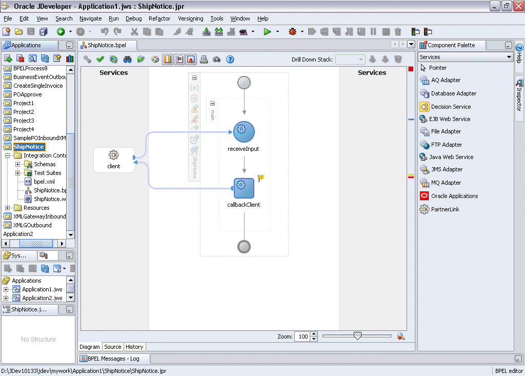

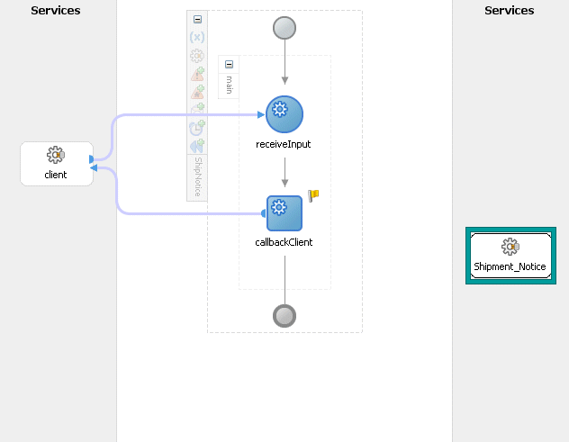

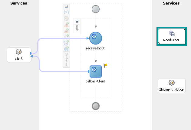

A new synchronous BPEL process is created with the Receive and Reply activities. The required source files including bpel.xml, using the name you specified (for example, ShipNotice.bpel) are also generated.
New BPEL Process Diagram

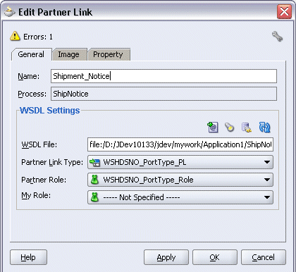

Use this step to create a Partner Link called Shipment_Notice for the Web service exposed through WSHDSNO concurrent program.
To create a partner link for Shipment_Notice Web service:
In JDeveloper BPEL Designer, drag and drop the PartnerLink service from the Component Palette into the Partner Link border area of the process diagram. The Service Name dialog box appears.
Copy the WSDL URL corresponding to the Departure Shipment Notice Outbound WSHDSNO service that you recorded earlier in the WSDL File field. Click OK.
A Partner Link Type message dialog box appears asking whether you want the system to create a new WSDL file that will by default create partner link types for you.
Click Yes to have the Partner Name value populated automatically.
The partner link is created with the required WSDL settings, and is represented in the BPEL project by a new icon in the border area of the process diagram.
Adding the Partner Link
You can optionally change the default partner link name by double-clicking the icon to open the Edit Partner Link window. For example, change it from WSHDSNO to Shipment_Notice.
Select the Partner Role value from the drop-down list. Click Apply.
Editing Partner Link Parameters

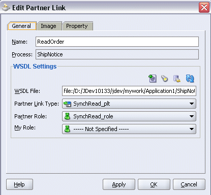

To add a Partner Link for File Adapter to read order details:
In JDeveloper BPEL Designer, drag and drop the File Adapter service from the Adapter Service section of the Component Palette into the Partner Link area of the process diagram. The Adapter Configuration wizard welcome page appears.
Click Next. The Service Name dialog box appears.
Enter a name for the file adapter service, for example ReadOrder. You can add an optional description of the service.
Click Next and the Operation dialog box appears.
Specifying the Operation
Specify the operation type, for example Synchronous Read File. This automatically populates the Operation Name field.
Click Next to access the File Directories dialog box.

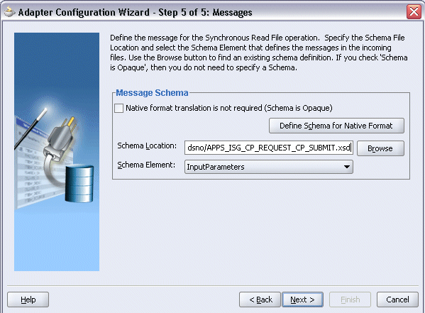

Select Physical Path radio button and enter the input payload file directory information. For example, enter /usr/tmp/ as the directory name.
Uncheck the Delete Files after successful retrieval check box. Click Next to open the File Name dialog box.
Enter the name of the file for the synchronous read file operation. For example, enter 'order_data.xml'. Click Next. The Messages dialog box appears.
Specifying Message Schema
Select Browse for schema file in Schema Location. The Type Chooser window is displayed.
Click Import Schema Files button on the top right corner of the Type Chooser window.
Enter the schema location for the service. Such as http://<myhost>:<port>/webservices/SOAProvider/concurrentprogram/wshdsno/APPS_ISG_CP_REQUEST_CP_SUBMIT.xsd.
Schema location for your service can be found from the service WSDL URL (for example, http://<myhost>:<port>/webservices/SOAProvider/concurrentprogram/wshdsno/?wsdl).
Select the Add to Project check box and click OK.
Click OK for Import schema prompt.
The Imported Schemas folder is automatically added to the Type Chooser window.
Select schema element by expanding the Imported Schemas folder > APPS_ISG_CP_REQUEST_CP_SUBMIT.xsd > InputParameters.
Click OK.
The selected schema location and element values are displayed.
Viewing Selected Message Schema and Element
Click Next and then Finish. The wizard generates the WSDL file corresponding to the partner link. The main Create Partner Link dialog box appears, specifying the new WSDL file ReadOrder.wsdl.
Completing the Partner Link Configuration
Click Apply and then OK to complete the configuration and create the partner link with the required WSDL settings for the File Adapter Service.
The ReadOrder Partner Link appears in the BPEL process diagram.
Adding the Partner Link for File Adapter

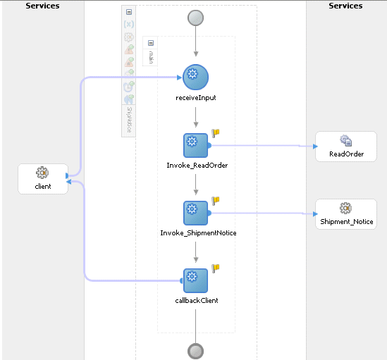

This step is to configure two Invoke activities:
Read order details that is passed from the first Assign activity through the ReadOrder partner link for File Adapter.
Send the order header and line details received from the Assign activities to generate an outbound shipment notice (DSNO) by using the Shipment_Notice partner link.

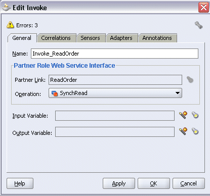

To add an Invoke activity for ReadOrder Partner Link:
In JDeveloper BPEL Designer, drag and drop the Invoke activity from the Component Palette into the Activity box of the process diagram, between the Receive and Reply activities.
Link the Invoke activity to the ReadOrder service. The Invoke activity will send order data to the partner link. The Edit Invoke dialog box appears.
Editing the Invoke Activity

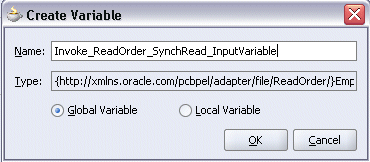

Enter a name for the Invoke activity, and then click the Create icon next to the Input Variable field to create a new variable. The Create Variable dialog box appears.
Creating an Input Variable
Select Global Variable and then enter a name for the variable. You can also accept the default name. Click OK.

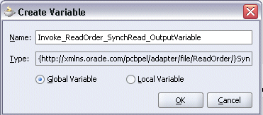

Click the Create icon next to the Output Variable field. Select Global Variable and then enter a name for the variable. You can also accept the default name. Click OK.
Creating an Output Variable
Click Apply and then OK in the Edit Invoke dialog box to finish configuring the Invoke activity.
The Invoke activity appears in the process diagram.

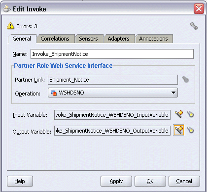

To add the second Invoke activity for Shipment_Notice Partner Link:
In JDeveloper BPEL Designer, drag and drop the Invoke activity from the Component Palette into the Activity box of the process diagram, after the Invoke and Reply activities.
Link the Invoke activity to the Shipment_Notice service. The Invoke activity will send event data to the partner link. The Edit Invoke dialog box appears.
Enter a name for the Invoke activity such as 'Invoke_ShipmentNotice'. Select input and output global variables as described in the first Invoke activity creation procedure.
Editing Invoke Variables
The second Invoke activity appears in the process diagram.
Adding Invoke Activities

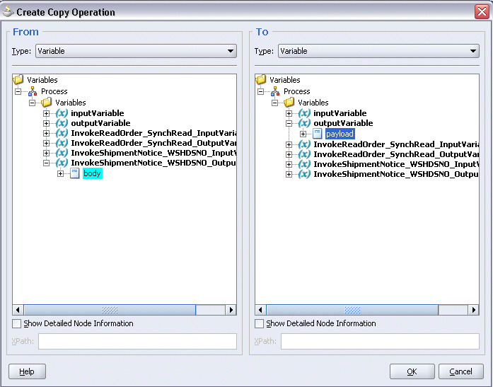

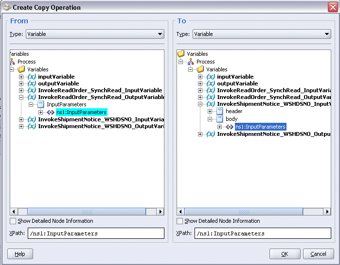

This step is to configure three Assign activities:
To pass the application context for SOAHeader in the invocation of the DSNO concurrent program service.
To pass the order details from the output of the Synchronous Read - File Adapter service to the input of the DSNO creation through the Invoke_ShipmentNotice Invoke activity.
To set the SOAP response to output.

To add the second Assign activity to set order details to the Invoke_ShipmentNotice Invoke activity:
In JDeveloper BPEL Designer, drag and drop the Assign activity from the Component Palette into the Activity box of the process diagram, between Assign and Invoke activities.
Double-click the Assign activity to access the Edit Assign dialog box.
Click the General tab to enter the name for the Assign activity, such as 'SetOrderDetails'.
On the Copy Operation tab, click Create and then select Copy Operation from the menu. The Create Copy Operation window appears.
Enter the first pair of parameters:
In the From navigation tree, select type elect type Variable. Navigate to Variable > Process > Variables > InvokeReadOrder_SynchRead_OutputVariable > InputParameters and select ns1:InputParametersr.
The XPath field should contain your selected entry.
In the To navigation tree, select type Variable. Navigate to Variable > Process > Variables > InvokeShipmentNotice_WSHDSNO_InputVariable > body and select ns1:InputParameters. The XPath field should contain your selected entry.
Click OK.
Assigning Parameters
The Edit Assign dialog box appears.
Click Apply and then OK to complete the configuration of the Assign activity.
To add the third Assign activity to set SOAP response to output:
Add the third Assign activity by dragging and dropping the Assign activity from the Component Palette into the Activity box of the process diagram, between the Invoke and the Reply activities.
Repeat Step 2 to Step 4 described in creating the first Assign activity to add the third Assign activity called 'SetCPdetails'.
Enter the following information:
In the From navigation tree, select type Variable. Navigate to Variable > Process > Variables > InvokeShipmentNotice_WSHDSNO_OutputVariable and select body.
In the To navigation tree, select type Variable. Navigate to Variable > Process > Variables > OutputVariable and select payload.
Click OK.
After creating a BPEL process using the WSDL URL generated from the concurrent program interface definition, you can deploy it to a BPEL server if needed. To ensure that this process is modified or orchestrated appropriately, you can also manually test the BPEL process by initiating the business process contained in the BPEL process to test the interface integration.

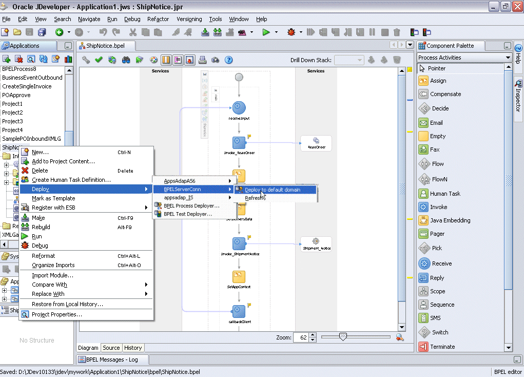

To deploy the BPEL process:
In the Applications Navigator of JDeveloper BPEL Designer, select the ShipNotice project.
Right-click the project and click Make action from the menu.
Look for any compilation error messages in Message Log.
Right-click the project and select Deploy >Integration Server Connection name > Deploy to Default Domain action from the menu.
For example, you can select Deploy > BPELServerConn > Deploy to Default Domain to deploy the process if you have the BPEL Process Manager setup appropriately.
Deploying the BPEL Process
Look for ‘Build successful’ message in Apache Ant – Log. The BPEL project is compiled and successfully deployed.

To test the BPEL process:
Log into Oracle Application Server 10g BPEL Console ( http://<soaSuiteServerHostName>:<port>/BPELConsole). The BPEL Console login page appears.
Enter the username and password and click Login. The The Oracle Enterprise Manager 10g BPEL Console appears with a list of deployed BPEL processes.
Deployed BPEL Processes
In the BPEL Console, confirm that ShipNotice has been deployed.
Click the ShipNotice link to open the Initiate tab.
Enter the payload input field and click Post XML Message to initiate the process.
The BPEL process is now initiated. You can check the process flow by clicking the Visual Flow icon.
BPEL Console Initiate Page
Double-click the Invoke_ShipmentNotice icon from the process flow chart and click View XML document link to open the XML file. This file records the Request ID that is returned for the transaction.
