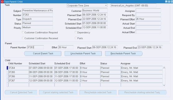

The Parent/Child tab of the Dispatch Center Task Details view displays the parent and child relationship of a set of tasks. When the effort of the task is longer than a regular work shift, Oracle Advanced Scheduler splits that task, called the "Parent" task, into multiple "Child" tasks, to accommodate and execute within the regular work shift of a technician.
For example, a parent task effort is 12 hours. The parent task propagates two child tasks, one for an eight hour task, and another for a four hour task.
Note: In the Task List table of the Dispatch Center Task Details view, task numbers appearing in italics indicate tasks having related parent or child tasks.
To manage parent or child tasks, dispatchers can invoke the Task Parent/Child window by right-clicking the task, and then selecting Parent/Child from the right-click menu options. The task you selected information appears at the top of this window. This could be a parent or child task. Parent task information appears in the middle of the window and Child task information appears in a table at the bottom of the window. Buttons enable the dispatcher to:
Cancel the parent task
Unschedule the parent task
Reschedule the parent task
Cancel a selected child task in the sequence
Cancel a selected child task and all subsequent child tasks
Reschedule a selected child task in the sequence
Reschedule a selected child task and all subsequent child tasks
Advanced Scheduler initially schedules Parent tasks to a single technician available for the entire effort of the task to be performed. Later if the technician falls sick or is unavailable for some reason, the child tasks can be rescheduled to another qualified technician. A single child task can be rescheduled to a qualified technician using the Reschedule selected Task button. All of the child tasks starting from the second in sequence of the child tasks hierarchy for a Parent task can be rescheduled to a qualified technician using the Reschedule starting selected Task button.
To either cancel or reschedule the original parent task, or all or some of the child tasks, see Rescheduling Tasks Longer Than a Shift, Oracle Field Service User Guide.

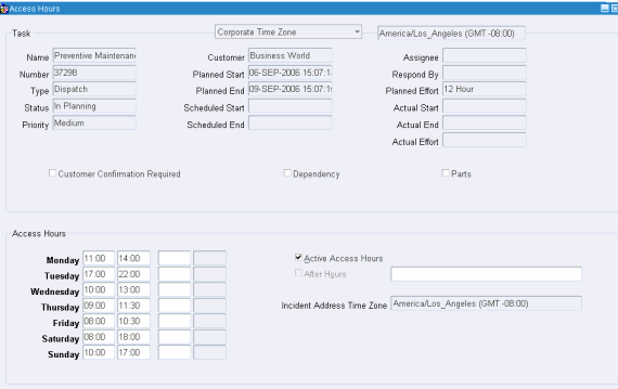

Use this procedure to create access hours and after hours for a particular task.
Steps
Navigate to the Access Hours window from the Dispatch Center.
The Access Hours window appears. Task details display for the selected task. Boxes appear in rows representing each day of the week. There are four boxes in each row. These boxes enable you to define up to two access hour time slots per day.
Setting Up Access Hours
To create Access Hours, select the Active Access Hours check box.
This disables the After Hours check box. The two actions are mutually exclusive.
Fill in the access hours that are available for scheduling service tasks. For example, Monday 17:00-21:00.
Hours must be entered in military time.
Save your work.
Although you can change Access Hours, even if the task status is 'Planned' or 'Assigned', you cannot remove Access Hours once the task status changes to 'Working' or 'Completed'. You can also update the access hours after work has started on a scheduled task.

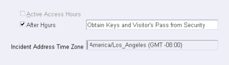

Setting Up After Hours
To define After Hours requirements, select the After Hours check box.
This disables the Active Access Hours check box.
In the text box to the right of the check box, enter instructions regarding the after hours scheduling that you want the dispatcher to consider.
Save your work.

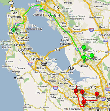

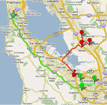

When tasks are scheduled manually, the corresponding travel times are not calculated in an optimized way. Hence an optimized schedule of a trip is not achieved. To achieve a better sequence in scheduling and optimizing the route of a technicians trip, you can perform a recalculation of the trip or an optimization of the trip.
This functionality is available in the Dispatch Center. This functionality calls Advanced Scheduler to sequence the trip in a regular fashion based on the scheduled start times of the task.
For more information see Recalculating a Trip, Oracle Field Service User Guide.

Scheduling Without Sorting Tasks by Geo-Spatial Attributes (Latitude and Longitude)
This diagram illustrates the trips of two technicians marked by the circles (green and red) with their home icons displayed. Tasks 1, 2 and 3 are scheduled to one technician and tasks 4, 5, and 6 are scheduled to another technician. Six tasks labeled as number 1 through 6 are retrieved and sorted using the query. From the task addresses (location) you can see that the tasks marked as 2 and 4 are in close proximity to each other. Similarly, tasks marked as 3 and 5 are in close proximity to each other.
Assuming that the tasks were fetched in the order of 1, 2, 3, 4, 5 and 6, and prior to the algorithm improvements, the scheduler engine would assign tasks to a technician whose trip has a task closer to the task being processed. In other words, if the technician (in green) was assigned task 1, subsequent tasks would also be assigned to that technician, as the tasks would be closer to this technician than the technician in red. For simplicity, let us assume that a technician can perform only three tasks in a day. So the trip of the technician in green gets filled with tasks 1, 2, and 3. So the remaining three tasks are placed in the trip of another technician as shown in red. This ends up in generating a sub-optimal schedule for the technicians. The core-scheduling engine does leverage travel time and distance and its associated costs during its search for the optimal technician and trip. The sub-optimal schedule (trips) occurs due to the manner in which the background engine used to sort and handle the to-be processed task list. The tasks are sorted without considering the location proximity of the tasks and because of that the core-scheduling engine has no visibility into the tasks that are yet to processed, the cheaper technician for a task is assigned to other tasks thereby completely utilizing the technician availability. This highlights the importance that is played by the order of processing and sorting of the task list in the generation of the final schedule.
Scheduling After Sorting Tasks by Geo-Spatial Attributes (Latitude and Longitude)
With the Optimization Across Trips functionality, the core Scheduler engine orders the tasks in the list not only based on the existing task sort criteria but also on the geographical location (based on the geo-spatial attributes, namely latitude and longitude) of the task. This improved sorting logic ensures that the closer location tasks are processed one after another by the core engine and the engine might schedule these tasks to the same technician, given the availability and qualification of the technician to perform the tasks.
The postal code or the name of the city does provide location information for a task. They do not represent the proximity of one task to another. More sophisticated algorithms are required to compute geographical proximity of the tasks from the address without compromising on performance. Hence, the Scheduler engine utilizes the latitude and longitude information of the task address to sort the tasks for processing. Autonomous Scheduler now employs this sophisticated algorithm during its initial sorting of tasks when determining better optimized schedules.
Using the same example as given before, yet this time leveraging the algorithm improvements, the Autonomous Scheduler would assign tasks as depicted in this illustration. Tasks 1, 2, and 4 are scheduled to one technician (green) and tasks 5, 3, and 6 are scheduled to another technician (red). This time task proximity is taken into consideration.
