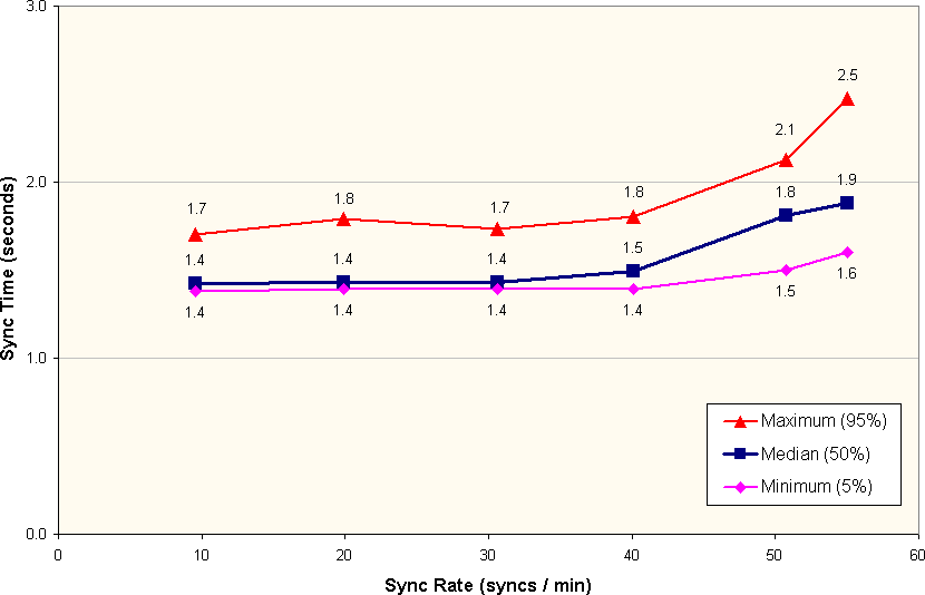

During the test, the time taken by each mobile user to communicate with the mobile server is recorded. The top and bottom 5% of the synchronization times are discarded before computing the minimum and maximum synchronization times.
The median synchronization time rises quite slowly as the synchronization rate is increased. Up to a synchronization rate of 40 synchronizations/minute, the synchronization time is essentially constant at just under 1.5 seconds. The median synchronization time increases from 1.4 seconds to 1.9 seconds (32%) as the synchronization rate increases from 10 to 55 connections per minute.

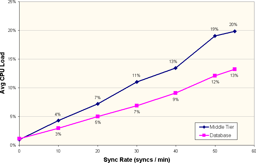

The average CPU load on the database computer and middle tier computer rises nearly linearly as the synchronization rate is increased. At 55 synchronizations per minute, the average database load is 13% while the average mobile server load is 20%. For a graphics representation of the CPU load, see the graph in "CPU Usage Tuning."
Note: Note: The Xeon Hyper-Threading is enabled during the test, so the average CPU usage is calculated over the four logical processors rather than the two physical processors.

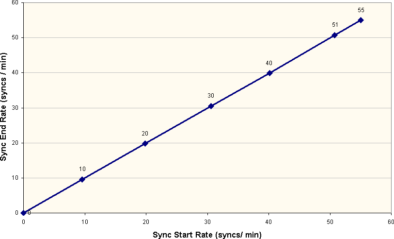

At a synchronization rate of 55 connections per minute, the average synchronization time remains very low and the peak CPU load on the database computer and middle tier computer is reasonable. However, beginning at a synchronization rate of 60 connections per minute, the server can no longer process the requests as fast as they arrive, so the excess requests are queued up. When the incoming load stops at the end of the test, the mobile server completes the remaining requests. All of the requests completed without errors.

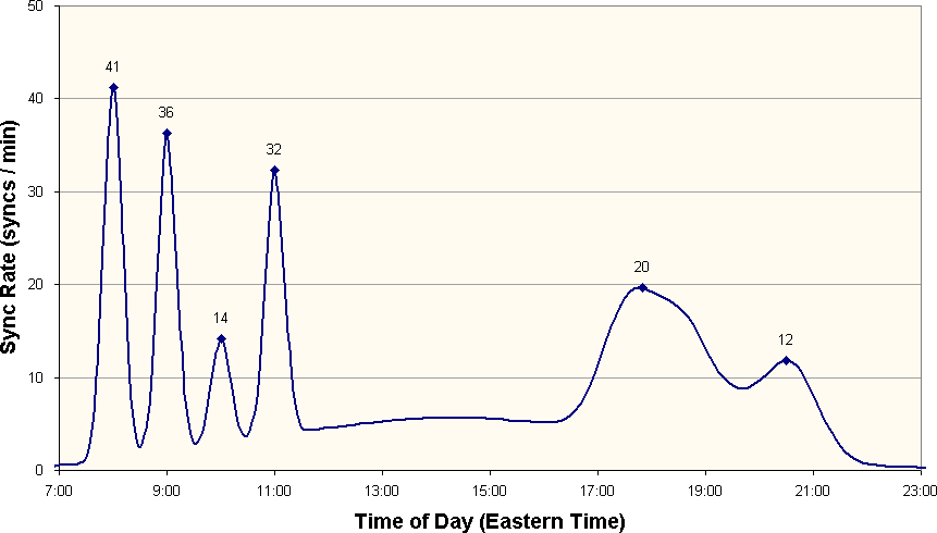

To determine the appropriate hardware for the mobile server and database, develop a model of the anticipated system load during the workday. For example, the graph in this section shows a load model for an organization with 3,000 mobile users working in four U.S. time zones.

As described in the following table, it is assumed that users synchronize three times per day, according to the normal distributions:
| Synchronization | Mean Time | Standard Deviations |
| Start of workday | 7:55 | 10 min |
| Middle of workday | 13:00 | 3 hrs |
| End of workday | 17:30 | 30 min |
For this model, the peak load is 41 synchronizations per minute at 7:55 Eastern Time. This load is well within the capabilities of the reference configuration used for the benchmarks in this appendix. At the time of the peak load, the estimated synchronization time is 1.6 seconds and the average CPU load is 9% for the database and 13% for the mobile server.
