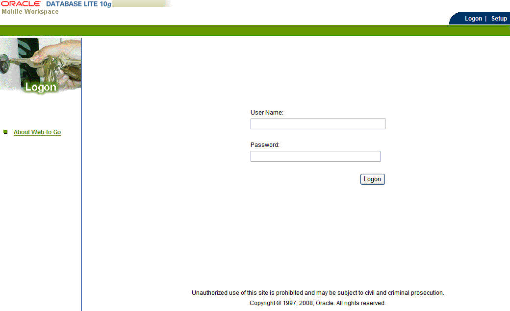

Access the Mobile Server Login page.
This page is available at: http://<mobile_server_host>:<port>/webtogo
Enter Administrator in the User Name field and the password in the Password field, and then click Logon.

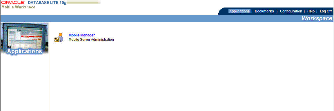

Click Mobile Manager link.
The Mobile Manager page appears.
