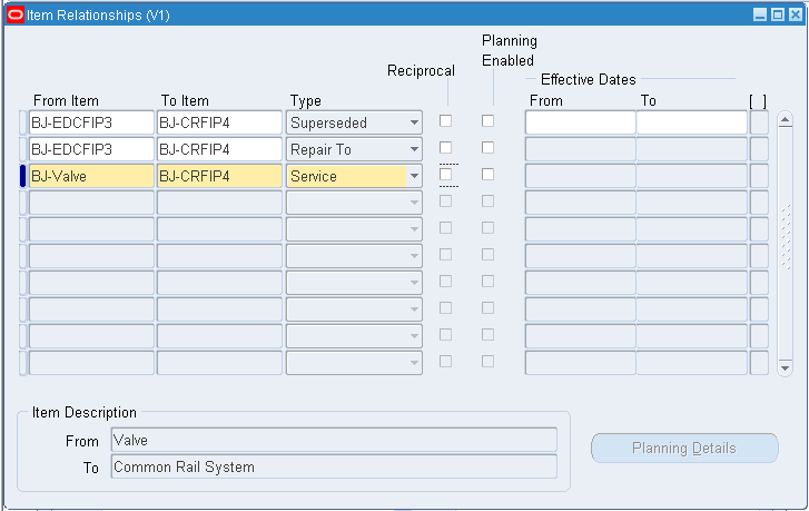

To define item relationships
From the Manufacturing and Distribution responsibility, navigate to the Item Relationships window.
Inventory > Items > Item Relationships
After you select an organization, the Find Item Relationships window appears.
To create a new item relationship, click New.
To update an existing item relationship, enter the relationship query criteria, and then click Find.
Tip: If you would like to see existing relationships in both directions, leave the Direction field blank. If you would like to see all types of existing relationships, leave the Type field blank.
The Item Relationships window appears.
To create an Item Relationship, highlight a blank row and select an item to be replaced from the From Item list of values.
Select the superseding item from the To Item list of values.
Select the desired relationship from the following Type list of values:
Superseded - Creates a link in the supersession chain.
Repair To - Defines whether the From item can be repaired to a higher revision.
If the relationship is bilateral, that is, if the transformation can go in either direction, select the Reciprocal check box.
(Optional) Specify Effectivity Start and End dates.
Click Save.

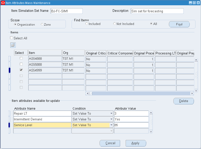

To define destination instance item attributes
From the Service Supply Chain planner responsibility, navigate to the Item Attributes Mass Maintenance window.
Setup > Item Attributes Mass Maintenance
In the header region, enter the Item Simulation Set Name. In the Scope region select the Organization radio button. In the Find Items region, select the All radio button.

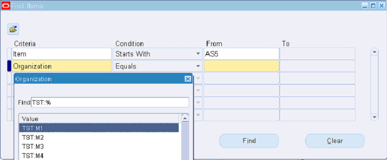

Click Find.
The Find Items window appears.
Specify criteria to retrieve the item-organization combinations for which you want to set these item attributes.
Click Find.
The Find Item window closes. Item and organization combinations matching the Find criteria are supplied on the Item Attribute Mass Maintenance window.
Select one or more items.
In the Item attributes available for update region, perform a query to retrieve the desired attributes.
For example:
Repair LT
Intermittent Demand
Service Level
Click Apply.

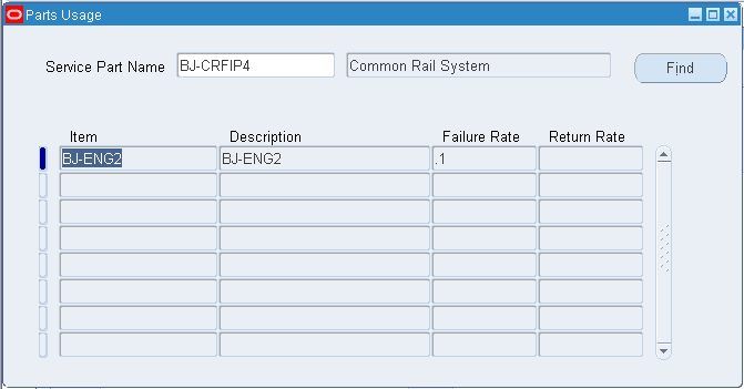

The Parts Usage window provides a where-used view of all the products that consume a given service part during maintenance or service.
To view parts usage, from the Supply Chain Planner responsibility, navigate to the Parts Usage window, or to open the Parts Usage window in context of a selected item, from the Planner’s Worksheet click the Parts Usage icon.
Note: You cannot create product-part relationships here. This relationship comes from the Failure Rates window.

Item-Instance: If the Item field is empty, use the Reduce Criteria Window to restrict the selection.

This attribute is available on the destination side through the Item Attribute Mass Maintenance form. It can take values of Yes or No, and if left blank, it is interpreted as No.
| Attribute | Valid Values | Default | Description |
| Compute Safety Stock Value | Yes / No | No | Item Organization level control to determine whether Safety Stock Value for the particular Item-Organization must be re-computed or not. |
The following example illustrates the effect of enabling or disabling this attribute.
| Item | Org | IMM \> Safety Stock Value | Compute Safety Stock Value |
| Item_1 | TST:M1 | 50 | Yes |
| Item_2 | TST:M1 | 40 | No |
| Item_3 | TST:M1 | - | Yes |
| Item_4 | TST:M1 | - | No |
For Item_1, since Compute Safety Stock Value = Yes, SPP will compute a new value for the safety stock and overwrite the 50 units in the IMM > Safety Stock Value field.
For Item_2, since Compute Safety Stock Value = No, SPP will retain and respect the target of 40 units.
For Item_3, since Compute Safety Stock Value = Yes. So SPP will calculate the safety stock value and update the IMM > Safety Stock Value field.
For Item_4, since Compute Safety Stock Value = No, SPP will not calculate the safety stock based on the new program. If Item_4 has an IO / MRP /Non-MRP safety stock target that will be respected.
| Compute EOQ | Yes / No | No | Item – Org level control to determine whether the Economic Order Quantity for the particular item-organization needs to be re-computed or not. |
| Item | Org | Fixed Order Qty | Compute EOQ |
| Item_1 | TST:M1 | 1000 | Yes |
| Item_2 | TST:M1 | 1200 | No |
For Item_1, since Compute EOQ = Yes, SPP will compute a new value for the EOQ and overwrite the 1000 units in the IMM.
For Item_2, since Compute EOQ = No, SPP will retain and respect the fixed order Qty of 1200 units.
For Item_3, since Compute EOQ = Yes. So SPP will calculate the EOQ and update the IMM.
For Item_4, since Compute EOQ = No, SPP will not calculate EOQ. SPP will plan orders for this item depending on demands (regular SPP planning).
