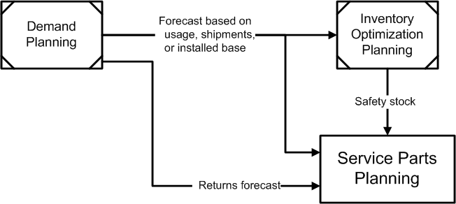

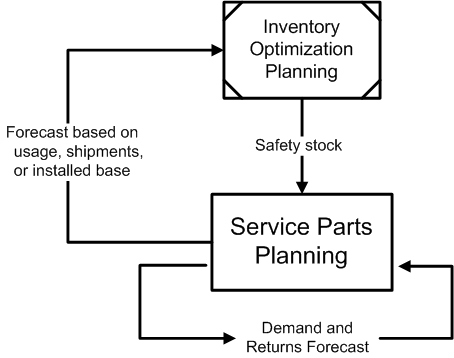

The Service Parts Planning solution supports both traditional and inline forecasting modes:
A demand planning system generates a demand forecast that serves as a demand schedule input to the service parts plan, and where implemented, also to the inventory optimization plan. The demand planning system also generates a returns forecast that serves as a supply schedule input to the service parts plan.
In this scenario, the Service Part Planning system uses Oracle Demantra Demand Management functionality to generate both the service parts demand and defective returns supply forecasts.
In either mode, forecasts can be based on usage history, shipment history, or returns history.
