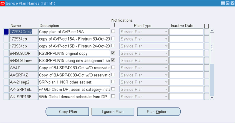

Service Supply Chain Plan Name
You use the Service Plan Names form for defining multiple plans, and storing them against plan names. You can access the Service Plan Names form from the Service Supply Chain Planner responsibility Navigator.
Service Parts Planning > Names
The design and uses of this form are similar to those of the DRP Plan Name form, except that the Plan Type value is Service Plan. You cannot update the Plan Type field. The Plan Type Service Plan is not visible to Distribution Requirements Planning (DRP). Similarly DRP plans are not visible to SPP. Inventory Optimization users can see and use DRP and SPP plan types, but cannot generate plans based on a mix of definitions from both plan types.

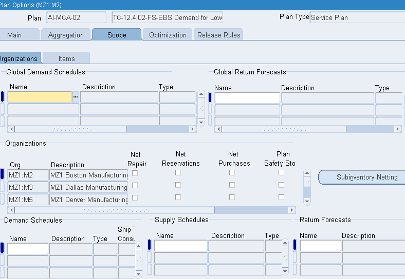

Scope Tab
The organizations and items included in the supply chain define the scope of the service plan.
Organizations Sub Tab
the picture is described in the document text
Field Group Validation Description
Global Demand Schedules The global demand schedules appear in the LOV. Select the names of Oracle Demantra Demand Management scenarios that drive this plan. You can select scenarios that do not reference an organization (organization dimension set to All Organization).
Global Returns Forecasts The global returns forecasts appear in the LOV. Indicates the scenario for returns forecast. This is similar to global demand forecast, but to indicate returns, planning marks the scenario as returns.
Organizations Field organizations are not part of the LOV.
Demand Schedules The local demand schedules and forecasts appear in the LOV. Select the names of demand schedules, forecasts, and plans that drive this plan.
Supply Schedules LOV includes forecast scenarios for return forecast as supply schedule Select the name of supply schedules that participate in this plan. Note that this production schedule should be referencing this plan within its schedule options. That is, the schedule name that is entered should reference the plan on the Schedule Options page, Scope tab.
Return Forecasts (Demantra) LOV includes Org Level forecasts as a schedule of defectives. When a returns forecast is included in the context of an organization, SPP interprets that as a projected stream of defective supply coming into that organization. It then applies the sourcing rules assigned in the plan to handle the defectives coming in.
Note: Since all Demantra forecasts are available under the Returns Forecast LOV, it is possible to include the same Demantra forecast as both a Demand Schedule and a Returns schedule. Functionally this would mean that returns equal spares.

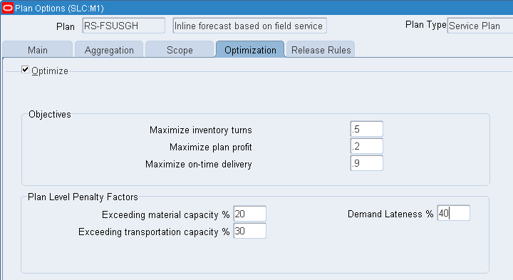

Optimization Tab
Select the Optimize check box to enable the Optimization tab, and then specify relative weights for the objectives. Valid objective weights range from zero to one.
For example, the following settings would favor plans that achieve high customer service (on-time delivery) at the cost of increased investment in inventory (low inventory turnover ratio):
Note: The weights do not necessarily sum to 1.0. Also note that the relative weights indicate your preferences among these competing objectives. Thus, setting all these weights to 1.0 produces the same result as setting them all to zero.
You can also define Plan Level Penalty Factors, in percent, for exceeding material capacity, exceeding transportation capacity, and demand lateness. This action causes the planning engine to search for alternatives that minimize the total of these penalties.
Field Validation Description Default
Maximize inventory turns Number >= 0, <= 1 Specify a weighting factor from 0 to 1. 0
Maximize plan profit Number >= 0, <= 1 Specify a weighting factor from 0 to 1. 0
Maximize on-time delivery Number >= 0, <= 1 Specify a weighting factor from 0 to 1. 0
Exceeding material capacity % Positive Number Enter a numerical value to quantify the impact of exceeding material capacity. For example, if you enter 20, the penalty factor is 20%. 0
Exceeding transportation capacity % Positive Number Enter a numerical value to quantify the impact of exceeding transportation capacity. For example, if you enter 30, the penalty factor is 30%. 0
Positive Number Enter a numerical value to quantify the impact of late demand. For example, if you enter 40, the penalty factor is 40%. 0

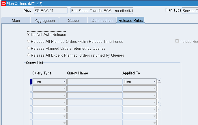

Release Rules Tab
The plan setup provides the following options for releasing orders:
Query List
For each auto-release query to be associated with the plan, fill in the appropriate information for each row.
Select the type of query in the Query Type drop-down list. (Note that orders selected for auto-release are not just the ones returned by the query; it depends on the Applied-to setting, as explained below).
Under Query Name, click the find icon (…) to show a list of available queries and select one.
Finally, select an item in the Applied-To list. This determines what type of object the query results are applied to, and has a large impact on which orders will be included for auto-release. For example, if an Order Query returns one order for ItemA, and Applied-to is set to "Item"’, then all orders for ItemA are marked for auto-release, not just the one returned by the query.
The Maintain Query button provides a convenient link to the Create Queries window. If no query is selected, you can use this button to create a new query if. If a query is selected, you can view and edit this query's definition.
The Include Re-schedules checkbox determines if rescheduled orders will be evaluated in the query criteria and considered for auto-release. If unchecked, rescheduled orders will not be included.
Note: Re-schedules of repair orders will not be automatically released and must be implemented manually.
Note: When a new plan is copied from a plan that has auto-release queries, these queries will not be automatically run, nor will orders be automatically released. These queries will become active, however, when the new plan is launched.

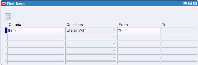

  5. In the Find Items region, click the Find button.
    The Find Items window appears. You can create new find criteria, or use existing criteria to search for item and organization combinations. The find criteria includes the destination-only item attributes and the updated item attribute, which indicates whether any attribute has changed.
  6. Define Find Items criteria to retrieve items for which you want to set Item Attributes values in this named Item Simulation Set. Click Find.
    The Items region is populated with items that match the find items criteria.

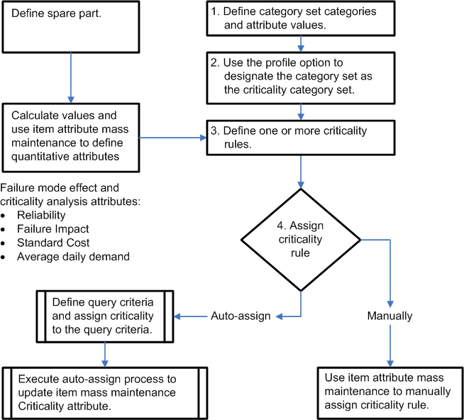

Criticality Matrix
Analyzing the cause, frequency, and effects of a spare part’s failure helps determine the importance of a given spare part to service operations. Service Parts Planning provides a framework of user-defined parameters that can be used to create flexible groups called criticality categories. These categories can be assigned to spare parts to create a criticality matrix.
The criticality matrix helps set up planning policies for the spare part items. These policies include planning method, frequency of planning, forecast methods and rules, and service levels. The criticality matrix helps determine service levels and demand fulfillment lead times (DFLT) that impact quantity and location of the spare parts inventory.
A criticality matrix can be broadly defined as a function of:
The figure depicts a process flow for defining and using criticality:
  1. Define the criticality category set and valid values for the category.
    Note: No pre-seeded category set is named Criticality. You either define a new category set, or use an existing one as the category for defining criticality.
  2. Specify the category set to be used for defining criticality in the profile option: MSC: Criticality Category Set.
  3. Create criticality rules.
  4. Assign criticality rules.

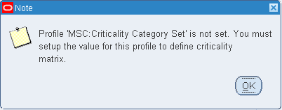

Implementation of the Criticality Matrix uses Category Set functionality. No seeded category set is named Criticality. You either designate an existing category set for use in defining the criticality matrix, or create a new category set for this purpose. You designate which category set you will use for setting up the Criticality Matrix in the profile option MSC: Criticality Category Set.
If you have not designated a criticality category set, when you navigate to the Criticality Matrix window, this note appears.
