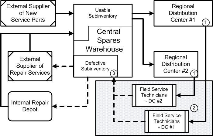

The logical sequence for forecast and forecast consumption for service supply chain in case of global forecasting techniques is:
Generate the global forecast.
Use global sourcing rules to apportion the forecast appropriately.
Perform forecast consumption at the replenishing organizations with ISO’s (outbound shipments) at the replenishing organization. In the case that local, zone level, and global forecasts all coexist at a replenishing organization, the local forecast is consumed first, before the zonal, and global forecasts, respectively.

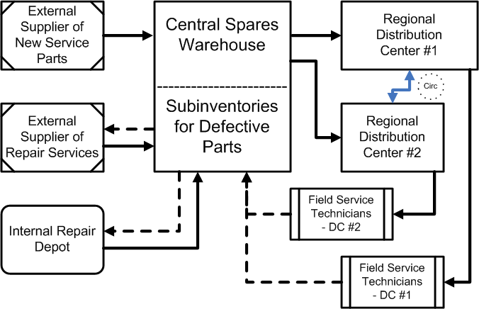

The field organizations in the service parts plan are only for the process of generating demand forecasts. These field organizations are not considered for supply planning. Only internal requisitions and internal sales orders (for outbound shipments) received from field organizations are considered as demand. There are no other demands placed from field organizations.

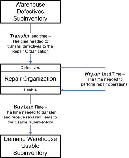

The manufacturing organization calendar is used for offsetting repair lead times. Preprocessing and post processing item lead times are not considered in the repair organization.
The item-organization attribute Repair lead time represents the total of the following three lead-time elements:
Lead time to transfer defectives to the repair organization
Planning uses the transfer sourcing rule and the relevant shipping network to determine the lead time to transfer defectives to the repair organization.
Lead time to repair a defective part at the repair organization
You define this lead time element for the item and organization combination to represent the duration of repair operations at the repair organization.
Lead time to buy (transfer and receive) usable parts from the repair organization into your warehouse
This lead time is based on the shipping network. It represents the lead time to transfer the usable parts from the repair organization (whether internal or external) and receive them into your warehouse.
The repair program impacts planning considerably, because it affects the lead time to procure parts from the repair supplier. Spares Management supports the following repair programs as set up on the Inventory MPS/MRP Planning tab for a given item and repair supplier combination.
All three lead-time elements are considered to offset repair purchase orders.

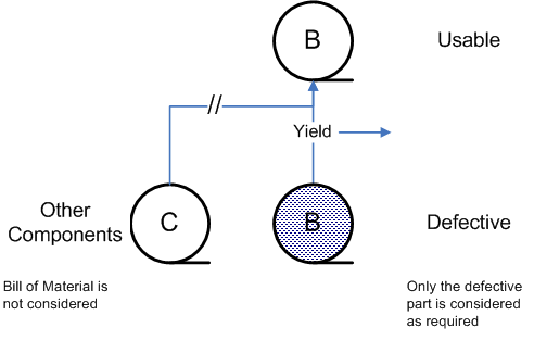

The external repair organization has separate subinventories marked for usable and defective parts. Planning will, by default, assume the usable spare part has the same part identification as the defective component in the repair bill.
Repair at sourcing looks for the usable part at the repair supplier organization. The bill structure at the repair supplier organization drives the component demand for the defective item. The planning engine looks for the defective part based on the transfer sourcing rule. Because the on-hand inventory is assumed to be defective, and the Returns order type is also assumed to be defective, planning pulls only defective parts for repair.
The assumed bill of material structure at the repair supplier is:
All defectives shipped for repair to the external repair supplier organization are received into the supplier subinventory that is marked as defective. The repair supplier removes parts from the defectives subinventory according to the repair order, completes the repair, and receives the item into the usable subinventory. When you receive the repaired part at your warehouse, a backflush transaction moves and then deducts the required quantity out of the usable subinventory.
The yield loss is scrapped as a miscellaneous issue out of the defective subinventory at the repair supplier.
For a depot repair organization, planning assumes that to produce a usable part, a defective part is required.
Note: To support the case in which the internal depot repair organization is the same as a manufacturing organization, it is assumed that the service part item numbers are different from the component item numbers used in production.
Defective parts are received into the defective subinventory at the depot repair organization. The backflush transaction for he repair order deducts inventory from the defective subinventory.

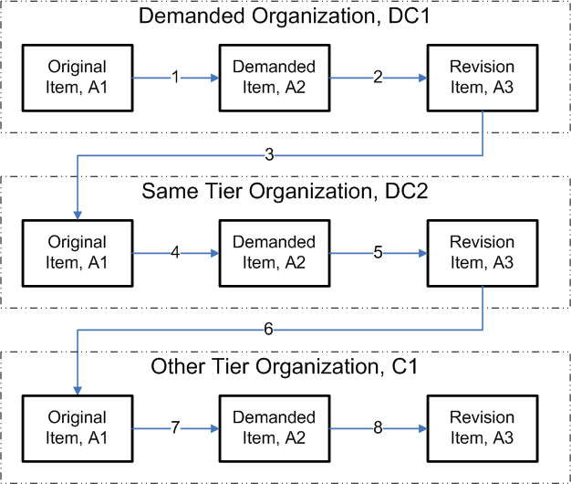

Location: The principle that guides search logic is: the demand must be satisfied locally before using the supply from other nodes in the supply chain.
Revision: When multiple item revisions have demand occurring on the same day, for the same order type, then the search logic tries to satisfy the demand for a lower revision item prior to moving to demand for a higher revision item. For example, if the supersession chain is A1 -> A2 -> A3, and forecast demand for A1, A2, and A3 exist on the same day, then satisfy demand of A1, then A2, then A3.
The figure illustrates the search logic, in which planning tries to satisfy the demand at the demanded organization by using all the available and valid supersession parts before searching and using the supply from the rest of the supply chain. Say the demand is for Item A2 on Organization C1:
The actual pattern of search within each organization is governed by supersession rules. Consider some of the examples for supersession to understand the meaning of various options for supersession rule definition.

Planning logic respects circular sourcing rules. Circular sourcing rules create a use-up-first relationship. In other words, all the excess supplies within the circular relationship are committed first, before additional supplies are sourced from other locations.
Consider the following example:
| Type | Org | Circular | Allocation % | Rank | Shipping Method | In-transit Time |
| Transfer from | D2 | 100 | 1 | Truck | 2 | |
| Transfer from | R2 | x | Acme | 2 |
| Transfer from | D2 | 100 | 1 | Truck | 1 | |
| Transfer from | R1 | x | Acme | 2 |
If demands are either in R1 or R2, the supplies located in the other organization are used up before supplies are sourced from D2. This has the net effect of balancing inventories between R1 and R2.

When deriving the organizations in which planning will look for defectives, you should have a set of sourcing rules such that planning and order promising can easily differentiate between permissible sources for usable and defective items. Repair at and Return to sourcing rules apply exclusively to defectives. Similarly, Transfer from and Buy from sourcing rules apply exclusively to usable inventory. Thus, depending on part condition, the engine can determine the type of sourcing rule to apply, and deduce the valid source for the item.
For example, both Transfer from and Return to sourcing rules are defined for the same item. If the defective inventory of the item needs to be transferred, then the valid sources will be determined based on the ‘Return to’ sourcing rule. Similarly, if the usable inventory of the item needs to be transferred, then the valid sources will be determined using the Transfer from sourcing rule. Essentially, the distinction between defective and usable parts is being made through the sourcing rules.
You can choose to generate local returns forecasts, based on the (1) outbound shipments from the replenishing organizations (see the following diagram). This method of forecasting filters out (3) incoming excess parts returning from the field.
Generate global forecast for the (2) field service zone, and then use global forecast assignment rules to apportion the forecast appropriately to the replenishing organizations. The global forecast is for both demand and returns.
For spare part demand, the forecast distribution set (in accordance with the global forecasting design), takes the usage forecast from technician organizations and places the demand at the replenishing organizations.
Return forecasts are generated for the field service organization, or the organization where the actual field service return occurs. This forecast is implemented in the returns network appropriately. Because supply chain does not plan for field service organizations, the returns forecast generated for the field service organization needs to be implemented in the organization to which the returned items are transferred. This supply of returns forecast is netted in the supply as Returns.
You assign the Return to sourcing rule to the global forecast assignment set so that it is appropriately considered for pushing down zonal demand to the organization-specific demand.

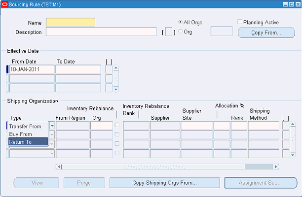

You can specify organizations only for the Return to sourcing rule, hence a user interface validation has been built into the LOV. Return to sourcing rules for Rank 1 are used. Any sourcing splits within Rank 1 will be honored. Rank 2 and higher can not be selected.
The Return to sourcing rule is also used to transfer the defectives all the way to the repair organization. Thus, Return to is not used only in the global context, but also in the context of transferring defectives from organization to organization. Therefore, both the All Org (global) level and the Org (local) level sourcing rules are supported with the Return to sourcing type.
This is a destination-instance only form, and can be assigned to the assignment set.
| Field | Description | Validation |
| Type | Determines the sourcing type: Buy, Transfer from, and Make at. | LOV If choosing the Return To sourcing rule, then also specify the organization. If the organization is a repair supplier organization, the supplier and supplier site attached to this organization appears. You cannot directly enter the supplier and supplier site. |

For example, consider the following service supply chain:
The Central spares warehouse has Repair at sourcing for both the external repair and the internal repair depot. The sourcing rule is defined as shown in the following table:
| Type | Organization/ Supplier | Rank | % |
| Transfer from | Repair Supplier | Rank 1 | 100% |
| Transfer from | Internal Repair Depot | Rank 2 | 100% |
| Buy from | New Buy Supplier | Rank 4 | 100% |
Additionally, at the internal and external repair organizations the following sourcing rule is defined:
| Repair at | Repair Supplier | Rank 1 | 100% |
The transfer rule to move defectives will be defined and assigned to the assignment set to move defectives from the central warehouse.
| Return to | Central warehouse | Rank 1 | 100% |
If defectives are being returned to the Central Warehouse, then you also need Transfer from sourcing rules to move the defectives to the repair organizations. These Sourcing Rules have Condition set as Defective in the assignment set.
This sourcing rule can then be assigned to the central spares warehouse and the repair organizations at the appropriate assignment level. This results in appropriate recommendations generated by the planning engine. These include:

Item lead-time constraints: This constraint considers the following lead-time elements:
Transfer defectives to the repair organization
Repair operations
Transfer and receive usable parts to your warehouse
Material constraints: The quantity of defective parts in the supply chain (considering returns and repair yield) act as a constraint for repair.

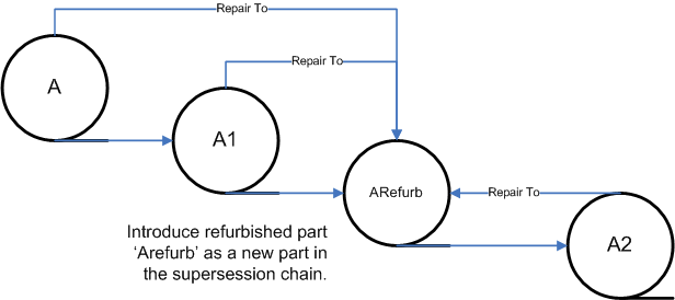

Set up the repaired or refurbished part as a supersession part and insert it in the supersession chain. Define it as a Bilateral relationship with the latest revision.
A ->A1 ->ARefurb <- -> A2
After defining the refurbished part ARefurb, introduce the refurbished part as a new part in the supersession chain. Define the Repair to part for all revisions to ARefurb:

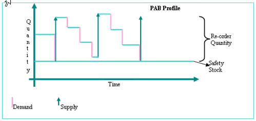

The figure below shows a typical usage and replenishment cycle designed to ensure that inventories stay above the safety stock level.

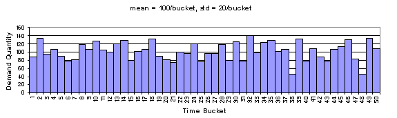

In the case of a regular demand pattern, the demand quantity in a time period is described by a normal distribution. Here is an example:
MAD is the mean absolute deviation of the historic forecasts from the actual demand. This method compares the forecast to actual demand to determine forecast accuracy, and therefore, how much safety stock is required to prevent stock-outs. If the forecast has been very accurate in the past, only a small safety stock is required.
The calculation of Mean Absolute Deviation is:
where n represents the number of time buckets.

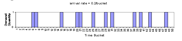

Intermittent Demands is used to describe a demand arrival pattern where demand arrivals are sporadic and there is often no demand in a time bucket. The pattern is usually modeled by a Poisson Process.
With intermittent demands, the planning engine determines a Target Inventory Level and then calculates the safety stock level based on that.
