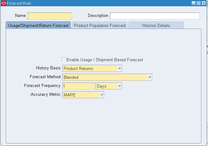

You use the Forecast Rules window to assign the forecast method and define the basis for calculating the forecast.
To define usage, shipment, or returns-based forecast rules
From the Service Supply Chain Planner responsibility, navigate to the Forecasting Rules window.
Setup > Forecast Rules Forecasting Rules – Usage / Shipment / Return Forecast tab
The Forecast Rule window appears, with the Usage/Shipment/Return Forecast tab selected.
Define the forecast rule name and description.
Select the Usage/Shipment/Return Forecast tab.
To enable Usage and Shipment based forecasting, select the Usage/Shipment/Return Forecast check box.
Define the forecast rule parameters. For a description of these parameters, see the table that immediately follows this procedure.
Select History Basis from the LOV. See Inline Forecasting Concepts.
Note: Inline forecasting generates forecasts for an item at either the zone level or the organization level.
If the history stream is based on field technicians’ usage, the forecast is at the zone level.
If the history stream is based on shipment or usage (component issue) at the internal repair depot organization, the forecast is at the organization ship from level.
Select the forecast method from the LOV. See Available Forecasting Methods.
Set the Forecast Frequency.
Choose one of the following accuracy metrics from the LOV.
Mean Absolute Percentage Error (MAPE)
Mean Absolute Deviation (MAD)
(Optional) Change the Forecast Method parameter default values. See Setting Forecasting Method Basic Parameters.
Click Save.
Proceed to Defining the Forecast Rule Horizon Details.

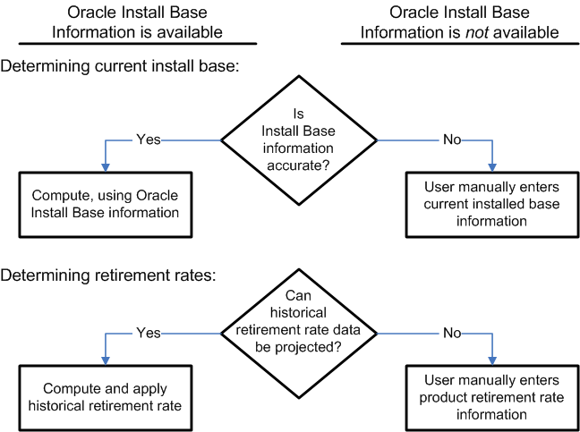

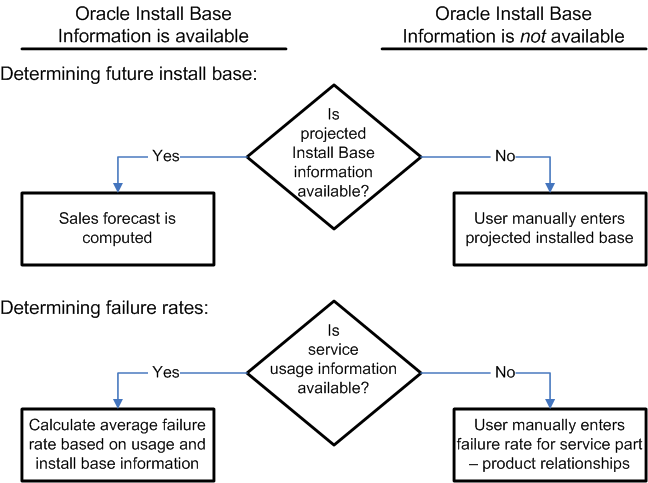

This alternative approach to calculating forecasts is often used when history data is insufficient to reliably calculate a forecast.
When suitable data is available, you can choose to allow the system to calculate factors used in the population based projections. When data is not available, you enter estimates for these values based on your experience. The following flow diagrams illustrate the decision process in selecting elements of population based forecasting:
As seen in the previous diagrams, if information from Oracle Installed Base is not available, you provide the relevant data needed to calculate projected demand. When the relevant data is not provided, the following assumptions are made, and appropriate warning messages are provided in the log file:
| Oracle Installed base available | Oracle Install Base not available | |
| Current installed base | Manual entry (but not provided) – Assume zero | Manual entry (but not provided) – Assume zero |
| Retirement rate | Manual entry (but not provided) – Assume zero | Manual entry (but not provided) – Assume zero |
| Projected installed base | Calculated, but sales order history is not available – Assume zero and provide a warning in the log file | Manual entry (but not provided) – Assume zero and provide a warning in the log file |
| Failure rate | Manual entry (but not provided) – Assume zero and provide a warning | Manual entry (but not provided) – Assume zero and provide a warning |

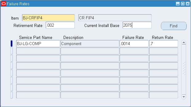

The Failure Rate window, available from the Setup menu, captures the average failure rates, return rates, retirement rates, and currently installed base population information.
You cannot add any new product and service part relationships in this window. The service item relationship is based on collected information.
Organization is not part of the find criteria, because this information is independent of organization.
From the Service Supply Chain Planner responsibility, navigate to the Failure Rates window.
Setup > Failure Rates
In the header region, select the product. The scope of the items is limited to items that are parent items in the service relationship.
Click Find.
The system populates the Product region of the Failure Rate form according to the find criteria.
Note: You can select a new product at the header level, if needed.
To Set the Retirement Rate and the Current Install Base
You can manually enter the retirement rate for the selected product, in percent per time bucket.
You can also manually enter the quantity of the selected product that represents the number of units that are currently installed.
To Set the Failure Rate and the Return Rate
when you select a product, the Service Part name region is populated with all the relevant service parts with which service relationships are established.
Note: Query functionality (F11 and Ctrl F11) is available in the Service Part Name region.
Select a service part.
Enter the average failure rate and average return rate for the selected service part, in percent per time bucket.
Click Save.

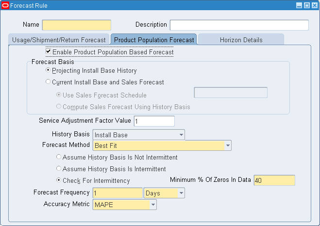

You specify Forecasting Rule parameters for population based forecasting in the Product Population Forecast tab of the Forecasting Rule window. The parameters for non-product population-based forecasts appear under the Usage/Shipment/Return Forecast tab. See Defining Usage Based Forecast Rules.
To specify product population-based forecasting rule parameters
From the Service Supply Chain Planner responsibility, navigate to the Forecast Rule form.
Select the Product Population Forecast tab.
To Define Forecast Rule Parameters
To enable forecasts based on install base population and failure rates, select the Enable Product Population Based Forecast check box.
Choose one of the following forecast basis radio buttons.:
Projecting Install Base History
Current Install Base & Sales Forecast.
If you select the Projecting Install Base History radio button:
The Use Sales Forecast Schedule and Compute Sales Forecast Using History radio buttons are disabled.
The History Basis is automatically set to Install Base.
If you select the Current Install Base & Sales Forecast radio button, the following two radio buttons are enabled:
Use Sales Forecast Schedule (or upload a flat file).
Compute the Sales Forecast Using History.
If you select Use Sales Forecast Schedule, and you want to upload a flat file, you can then point to a Demand Schedule for the Sales Forecast. Then select the flat file to be uploaded from the network. In the case of a flat file upload, the file is collected and presented as a schedule.
The control file for the flat file loading of sales forecast is as follows:
| Item | Quantity | Start Date | End Date | UOM |
Note: You must load the data in the same bucket as defined in the Forecasting tab of plan options.
If you select the Compute the Sales Forecast Using History radio button, the system computes the sales forecast. In the History Basis field choose either Usage or Shipment from the list of values.
(Optional) Specify the Service Adjustment Factor value in the range of zero to one. Because not all product sales necessarily translate into a service contract, you can use this factor to adjust the sales forecast to account for your estimated service market share.
Select the forecast method from the LOV. The forecast method applies to either the install base forecast or sales forecast, depending on previous selections. See Available Forecasting Methods.
(Optional) Change the forecast method parameter default values. See Setting Forecasting Method Basic Parameters.
Select one of the following radio buttons to indicate whether to use forecasting methods designed for intermittent data history:
Assume History Basis is Not Intermittent
Assume History Basis is Intermittent
Check For Intermittency
If you select the Check for Intermittency radio button, the Minimum % Of Zeros in Data field is enabled. Enter the threshold value..
Set the forecast frequency.
Choose an accuracy metric from the LOV.
MAPE
MAD
Click Save.

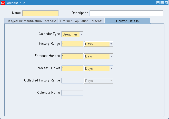

To define forecast rule horizon details
Select the Horizon Details tab.
Select the calendar type from the LOV.
Gregorian
Manufacturing
Complete the parameters. For a description of the parameters, see the table that immediately follows this procedure.
Click Save.

| History Range | Historical periods of data to be considered * | Positive integer | Manufacturing: Days, Weeks, Periods | 1 | Month |
| Forecast Horizon | Future periods for which forecast is generated | Positive integer | Manufacturing: Days, Weeks, Periods Gregorian: Months, Quarters, Years | 1 | Month |
| Forecast Bucket | Size of time bucket for generated forecasts, and as well as the history | Positive integer | Manufacturing: Days, Weeks, Periods Gregorian: Months, Quarters, Years | 1 | Month |
| Collected History Range | This noneditable field displays the maximum value for the ‘History Range’ setting. ** | ||||
| Calendar Name | When Calendar Type is Manufacturing, this noneditable field displays the Calendar name . |
* When the user specifies multiple forecast methods for an item, the History Range specified here applies to all methods. Each method, however, can be based on a different collection stream, for example, usage-based forecasting for parts where usage history is available, and product population-based forecasting where the part usage history is not available.
** The Collected History Range is the shortest of all the ranges of the individual streams that are being used.
Note: If the Manufacturing calendar is specified, then the forecasting engine uses the calendar specified in the profile Calendar reference for bucketing. In the absence of this profile setting, the forecasting engine uses the Manufacturing calendar for the organization that owns the plan.
