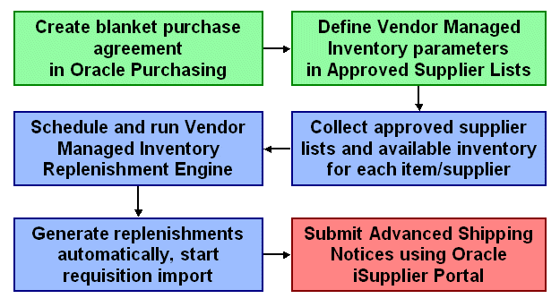

The user setup and process for Vendor Managed Inventory with suppliers consists of the following several steps:
Create Blanket Purchase Agreements (performed in Oracle Purchasing).
Define Parameters for Vendor Managed Inventory with Suppliers in approved supplier lists (performed in Oracle Purchasing).
Collect Approved Supplier Lists and available inventory for each item/supplier.
Schedule and Run the VMI Replenishment EngineSchedule and run the VMI replenishment engine.
View Replenishment Orders and start requisition import.
Submit Advance Shipment Notices (performed in Oracle iSupplier Portal).
The following image depicts the user setup flow for Vendor Managed Inventory with suppliers:

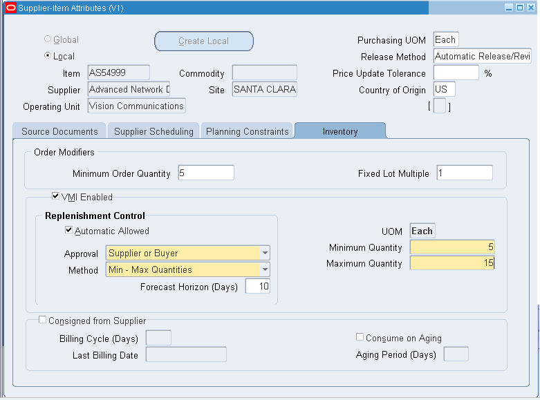

Complete the following mandatory steps in the Replenishment Control section of the Supplier-Item Attributes window when setting up the parameters for supplier-facing VMI:
Supplier-Item Attributes Window
Select the VMI Enabled check box to enable an item for Vendor Managed Inventory for a specified supplier and supplier site.
Select an option in the Approval list to determine whether the buyer or the seller needs to approve the VMI replenishment. Values are:
None: The system can release the VMI replenishment automatically.
Buyer: The Buyer must approve the release of the VMI replenishment. The system sends a notification for a request to release the replenishment quantity to you (the Buyer organization) after creating the VMI replenishment.
Supplier or Buyer: Either the Buyer or the Supplier has to approve the release of the VMI replenishment. After creating the VMI replenishment, the system sends a notification to you (the Buyer organization) and the supplier site contact requesting to release the replenishment quantity.
Select any one of the following replenishment methods from the Method list:
Min-Max Quantities
Min-Max Days
Min Qty and Fixed Order Qty
Min Days and Fixed Order Qty

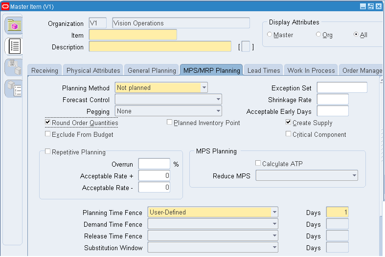

Select the check box for Round Order Quantities in the MPS/MRP Planning Attribute Group in Master Items window to create replenishment orders in whole number quantities.
Master Item Window

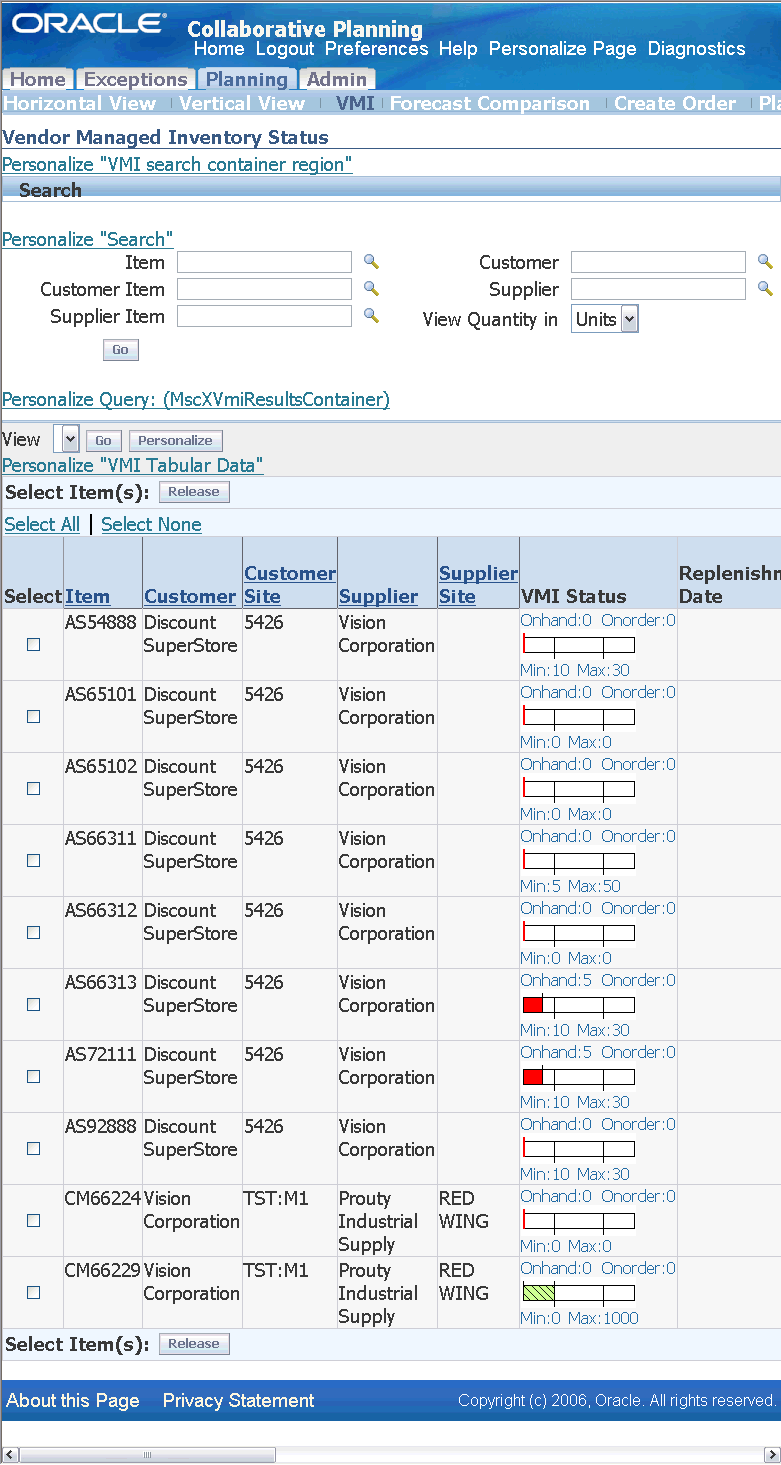

After you schedule and run the VMI Replenishment Engine, you can view replenishments in Oracle Collaborative Planning. The VMI screen provides you with a convenient snapshot to monitor inventory levels and release orders and to access forecast information. You can also navigate to the View Projected Stockout windows from a row in the VMI screen.
The following columns are specific to the VMI screen:
Replenishment Date. This date appears as the Need By Date on purchase requisitions/purchase orders.
Suggested Replenishment Quantity.
In-process quantity.
In transit Quantity
VMI Status
Stockout Chart
For more information about these fields, see Monitor and Replenish Inventory.

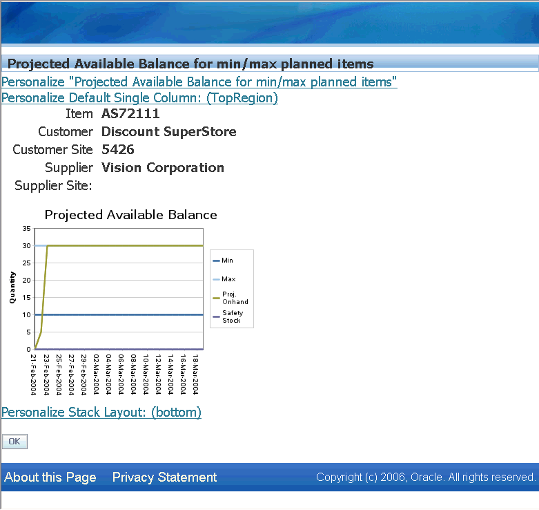

| Stockout Chart | A stockout chart provides a projection of the on-hand balance that is given the present state of supplies, demands, and inventory replenishment parameters. Using this chart, you can foresee inventory problems and make adjustments as required. For min-max planned items (items that are planned using days of minimum and maximum inventory) the stockout report displays the projected stock outs as per the order forecast. The stockout chart enables you to simulate the changes to replenishment parameters. Planners can change the replenishment method, the replenishment quantities, or both using the stockout chart. |
Complete the following steps to display the Projected Available Balance report for the selected item:
Click the Stockout Chart icon in the Stockout Chart column for a specific VMI record in the VMI screen.
The Projected Available Balance report opens in a pop-up window.
Projected Available Balance Report
Note that all the global buttons remain hidden in this window. The Projected Available Balance chart displays the:
Safety Stock
Minimum Quantity
Maximum Quantity
Projected On-Hand Quantity
The following colors are used to display the various quantities:
Red: Minimum Quantity
Green: Maximum Quantity
Blue: Projected Available balance
Orange: Safety Stock
Note: You can view the Projected Available Balance for only one item at a time belonging to a supplier / supplier site / organization combination.
To close the Projected Available Balance report and return to the VMI screen, click OK.

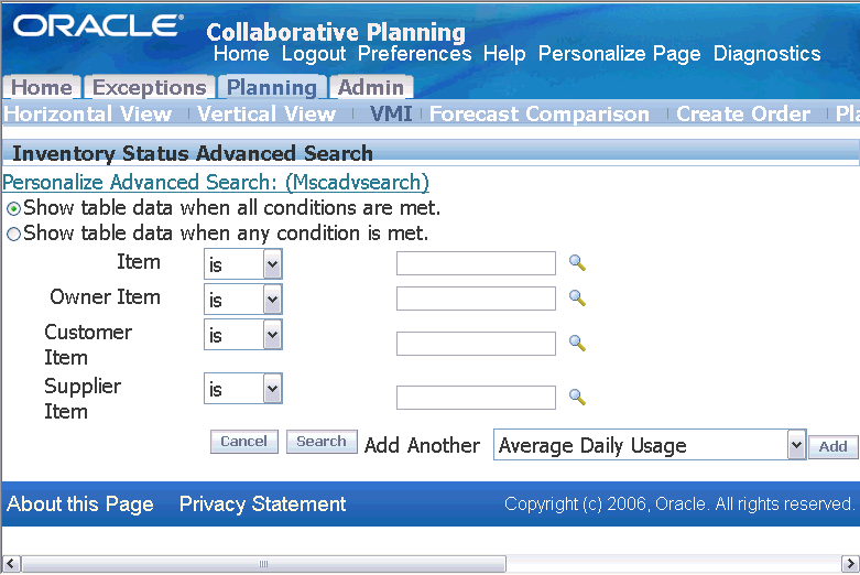

You and your trading partners who are related specifically to a particular customer can search information for all transactions under the customer's supervision in one view using the buyer code. Buyer codes also help you to categorize purchase orders and purchase requisitions based on customers' buyer codes and to quickly track an issue that is related to a specific customer.
Complete the following steps to search information based on a buyer code:
On the VMI screen, select Advanced Search.
The Inventory Status Advanced Search screen opens.
The Inventory Status Advanced Search Screen
To filter records based on buyer code, in the Add Another list, select Buyer as the new search field and select Add.
The Buyer Code field is appended.
Select the search criteria. For more information about advanced search, see "Horizontal and Advanced Horizontal View: Advanced Search".
In the Inventory Status Advanced Search window, select Search. The Collaborative Planning engine filters and displays the purchase orders and purchase requisitions for the buyer code on the VMI screen.
The VMI screen now displays new columns for the buyer code that are used as filtering criteria. Note that the Buyer column displaying the selected buyer code is added only after the user performs a filtration using the advanced search or preference sets based on the buyer code.
You must associate a buyer with an item in Oracle Inventory to search transactions based on buyer code. For more information about setting up this search field, see "Setup: Setting Up Buyer Code and Item Category."
In Vendor Managed Inventory (VMI) with suppliers, a supplier is responsible for managing inventory replenishment at a customer location. The customer posts onhand inventory information and the supplier posts in-transit information. This results in available quantity. Available quantity is the sum of the following:
Onhand inventory
Open purchase requisitions
Open purchase orders
In-transit shipments
Receipts awaiting delivery
When the available quantity at the customer location is less than a specified minimum (the replenishment trigger point) Oracle Collaborative Planning notifies the customer and supplier. The supplier can then replenish the necessary inventory.

To generate VMI exceptions and send notifications you must run the VMI Replenishment Engine. To run the VMI Replenishment Engine you must have the Advanced Planning System Administrator responsibility assigned to your username.
To schedule the VMI replenishment engine you must provide a replenishment time fence (RTF) multiplier. Supplies that fall within the time period (RTF x multiplier) are considered as available inventory.
To run the VMI replenishment engine, complete the following steps:
Log into under the Advanced Planning Administrator responsibility.
Navigate to Other > VMI Replenishment Engine.
Enter a value for the Replenishment Time Fence multiplier and select OK.
Note: The replenishment time fence is the point in time that marks a boundary within which supplies should be considered before triggering replenishments. This boundary is calculated by taking the sum of the processing lead time and the VMI engine run date. This time fence would allows you to specify time horizons of supply for items, which may have very short/long in-transit times.
Select Submit.
To view notifications, log onto the system. The main Collaborative Planning Home page displays any outstanding notifications that relate to your vendor managed inventory items. Alternatively, you can select the Exceptions tab to view any relevant exceptions.
Note: You must run the VMI Replenishment Engine to generate exceptions and send notifications.
