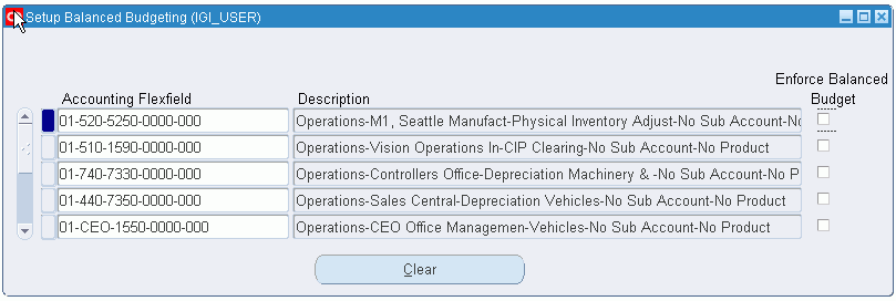

The Enabling Enforced Balanced Budgeting window enables budget control settings to be defined for each accounting flexfield combination for budgeting extensions.
To enforce balanced budgeting for an accounting flexfield code combination:
Navigate to the Setup Balanced Budgeting window.
Enter a query for the account combinations to enforce balanced budgeting.
Select Enforce Balanced Budget for each segment that requires enforced balanced budgeting.
Warning: Deselecting the Enforce Balanced Budget can cause a balanced budget to become unbalanced.
When the Enforce Balance Budget option is set for an accounting flexfield combination, balanced journal entry is enforced for the account combination.

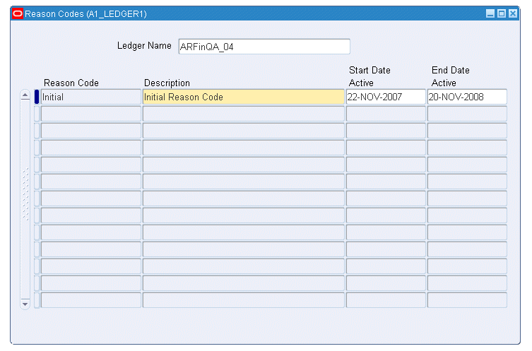

Reason codes are used to describe the reason for each budget transaction. Reason codes are used for reporting purposes only.
To define reason codes:
Navigate to the Reason Codes window.
Select a ledger.
The ledger name list is unique and displays the ledgers within the responsibility's Data Access Set that have Full Ledger read or write access with no restrictions on balancing segment values or management segment values.
Note: A single ledger can have multiple reason codes.
Enter a unique reason code.
Enter a reason code description.
Select the date that you want the reason code to be active.
If the field is left blank, the reason code is immediately activated.
Note: Once defined, you cannot delete or rename reason codes.
To disable a reason code, select an end date.

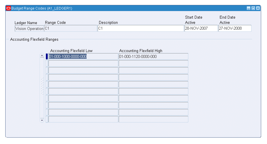

Budget range codes are used to group ranges of accounting flexfield combinations for easier budget maintenance using the budget maintenance procedures. The codes are assigned an active start and end date.
To define budget range codes:
Navigate to the Budget Range Codes window.
Select a ledger.
Note: The available flexfields are limited to the chart of account for the selected ledger.
Enter a unique range code.
Enter a range code description.
Select the date that the budget range code must be active.
If the Start Date Active field is left blank, the range code is immediately activated.
Note: Once defined, you cannot delete or rename budget range code.
To disable a range code, select an end date.
In the Accounting Flexfield Low field, select the low end of range.
In the Accounting Flexfield High field, select the high end of range.

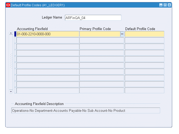

The default profile codes are applied while defining a journal in the Balanced/Unbalanced Journal window. If set, the Primary Profile Code is used initially. The Default Profile Code contains the last Profile Code used for the accounting flexfield.
To assign default profile codes:
Define the profile codes.
For information on defining profile codes, see Defining Profile Codes Procedure.
Navigate to the Default Profile Codes window.
Select a ledger.
Select the accounting flexfield.
Select the primary profile code. The default profile code is automatically set to the primary profile code.
Note: If a primary profile code or default profile code are not set, the default profile code for the accounting flexfield is automatically updated to the last profile code used for the accounting flexfield in the journal entry windows.
