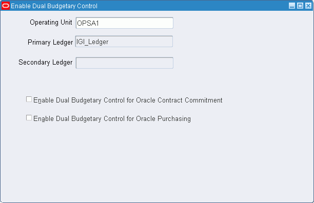

To enable dual budgetary control:
Navigate to the Enable Dual Budgetary Control window.
Select the operating unit
Select the primary ledger.
Note: The list of values in the Primary Ledger field depends on the selected operating unit.
Click Enable Dual Budgetary Control for the Contract Commitment to enable dual budgetary control for the Contract Commitment feature.
Click Enable Dual Budgetary Control for Oracle Purchasing to enable dual budgetary control for Oracle Purchasing.
Prepare budgets for both standard and commitment budgets using Oracle General Ledger.
