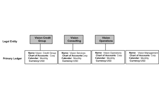

If your organization uses legal entities and you have accounting setups that have legal entities assigned, you can use another accounting setup with no legal entity for management purposes. For example, you can use its primary ledger to book internal management adjustments across ledgers in different accounting setups. The management adjustments can be for any management entity, such as line of business, cost center, department, or other segment that has management responsibility.
For example, assume the department segment of the chart of accounts represents the management entity and you have three departments: Finance, Sales, and HR. The figure below represents the management hierarchy for the department segment with the three departments reporting to the CEO.
Use the accounting setups described in the following table to perform the day-to-day accounting.
| Legal Entity | Vision Credit Group Legal Entity | Vision Services and Vision Consulting Legal Entities | Vision Operations Legal Entity |
| Number of Legal Entities | One | Multiple | One |
| Primary Ledger | Vision Credit Group | Vision Services | Vision Operations |
| Chart of Accounts: | Corporate | Corporate | Corporate |
| Calendar: | Monthly | Monthly | Monthly |
| Currency: | USD | USD | USD |
Transactions are entered for all three departments in all three ledgers during the normal course of business. For example, enter expenses for each department.
To enter management adjustments that cross the management entity for all three ledgers, define another accounting setup that has no legal entities assigned as described in the following graphic and table.
| Setup | Description |
| Primary Ledger | Vision Management |
| Calendar | Monthly |
| Currency | USD |
By itself, this management ledger may not represent the complete accounting picture; it may hold only the management adjustments. You can keep the management adjustments completely separate from day-to-day transactions. In order to obtain a complete management picture to use for management reporting and analysis, use a ledger set to combine the results of the management ledger with the other ledgers that hold the day-to-day transactions. You can obtain a complete management view of the company when reporting on the ledger set.
