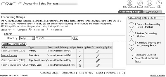

The Accounting Setup Manager provides the following pages:

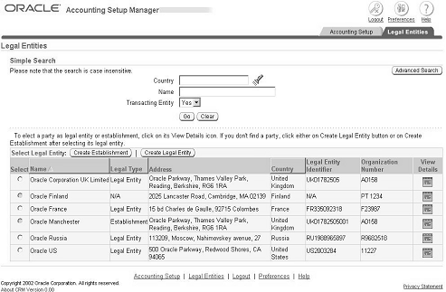

The Legal Entities page allows you to do the following:
Create new legal entities and assign specific balancing segment values to legal entities to help identify legal entities during transaction processing and reporting. You can take full advantage of all of the legal entity-related features, such as Intercompany Accounting.
Query existing legal entities, view their attributes, and make updates to the legal entities .
Update balancing segment values assigned to legal entities.
Enter an end-date to deactivate a legal entity.
Note: Legal Entities Overview
You can perform the following in the Accounting Setups page:
Create new accounting setups.
Query existing accounting setups (named after the primary ledger) by legal entity or ledger.
Update the accounting options for an accounting setup to modify the related setup components.
Query existing legal entities and view their attributes.
Identify the associated primary ledger for any legal entity, ledger, operating unit, and reporting currency.
View the status of accounting setups.

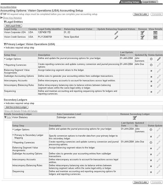

After creating an accounting setup structure, update the accounting options immediately after creating the structure or later.
The following table describes the steps to create accounting setups using Accounting Setup Manager. Each required setup step must be completed before you can complete your accounting setup.
| Step Number | Required | Step |
| Step 1 | Optional | Define Legal Entities If you plan to record accounting transactions for one or more legal entities, you can use the Legal Entities tab in Accounting Setup Manager or Oracle Legal Entity Configurator to define your legal entities. Note: If you plan to use jurisdictions that do not come seeded, you can define your own jurisdictions using Legal Entity Configurator before you define legal entities. A jurisdiction is the intersection of the physical territory and type of legislation within which judicial authority may be exercised. The jurisdiction is used to assign a territory to a legal entity.
| Step 2 | Required | Create Accounting Setup Structure
Repeat this step for each accounting setup. |
| Step 3 | Required | Complete ledger options. Define and update journal and transaction processing options for the ledger. If a secondary ledger is assigned, complete the ledger options for the primary ledger before completing the ledger options for the secondary ledger. Repeat this step for all ledgers in an accounting setup. Note: Ledger Options |

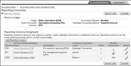

| Step 4 | Conditionally Required | Complete reporting currencies. If reporting currencies are assigned to the accounting setup when creating the accounting setup structure, it is required to complete the currency conversion options for each reporting currency. Assign reporting currencies to the primary or secondary ledger at any time. Repeat this step for each reporting currency assigned. Note: Reporting Currencies |
| Step 5 | Optional | Assign balancing segment values to legal entities. If you did not assign balancing segment values to legal entities when you created them, you can assign them now. It is strongly recommended that you assign specific balancing segment values to each legal entity to help identify legal entities during transaction processing and reporting. Note: See Balancing Segment Value Assignments |
| Step 6 | Optional | Assign balancing segment values to ledger. If you assigned balancing segment values to legal entities and want to reserve one or more balancing segment values for adjustments or nonlegal entity related transactions, assign specific balancing segment values to the ledger. For the accounting setup with no legal entity assigned, assign balancing segment values to the ledger to indicate which values are to be used for journal processing in the ledger. If balancing segment values are not assigned to the ledger, then all values will be available. Repeat this step for each ledger. |
| Step 7 | Conditionally Required | Define Subledger Accounting options. If a Subledger Accounting Method is assigned to the ledger, complete the Subledger Accounting options to provide instructions on how to create the accounting from Oracle financial subledgers or external systems to one or more ledgers in General Ledger. Repeat this step for each ledger that has a subledger accounting method assigned. |
| Step 8 | Optional | Define operating units. If using an accounting setup that has legal entities assigned, define operating units for your primary ledger.
Note: Operating Units |
| Step 9 | Optional | Define intercompany accounts. If the accounting setup has legal entities with specific balancing segment values assigned, define intercompany accounts. Intercompany accounts account for intercompany transactions between legal entities. Note: Intercompany Accounts |
| Step 10 | Conditionally Required | Define intracompany balancing rules. If the Intracompany Balancing option for the ledger is enabled, define Intracompany Balancing rules to provide instructions on how to balance journal entries between balancing segment values for the same legal entity or ledger. Repeat this step for each ledger that has this option enabled. |
| Step 11 | Optional | Define Sequencing. Define accounting and reporting sequencing options for ledgers and reporting currencies. Repeat this step for each ledger.
Note: Defining Sequences, Oracle Financials Implementation Guide |

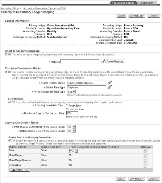

| Step 12 | Conditionally Required | Complete primary to secondary ledger mapping. If using secondary ledgers, specify how to convert subledger journals, General Ledger journals, or balances from the primary ledger to the secondary ledger. For example, if the secondary ledger uses a different chart of accounts and currency from the primary ledger, assign a chart of accounts mapping and currency conversion rules. Perform this step once for each secondary ledger that is assigned to an accounting setup. |
| Step 13 | Required | Complete the Accounting Setup After all required setup steps for both the primary and secondary ledgers of an accounting setup are completed, complete the accounting setup by clicking Complete on the Accounting Options page. This button is enabled after all required setup steps have a Complete status. Review the successful completion of the General Ledger Accounting Setup Program in the Concurrent Manager before proceeding. Perform this step once for each accounting setup. |
| Step 14 | Optional | Perform additional General Ledger setup steps. Take advantage of additional General Ledger features, such as ledger sets and data access sets, to improve processing efficiency and add additional security to secure access to ledgers.
| Step 15 | Required | Assign profile options to responsibilities. To control access to ledgers used by General Ledger users, assign a data access set to the profile option GL: Data Access Set for each General Ledger responsibility. If using subledgers, you should also set the SLA: Enable Data Access Security in Subledgers profile option to control the generation of accounting entries for subledger transactions. This profile option determines whether the General Ledger Data Access Set security mechanism is applied for a subledger application responsibility when viewing, reporting, or creating subledger journal entries associated with a given ledger. The General Ledger Data Access Set security mechanism is always applied for responsibilities associated with the General Ledger application. The profile option enables you to combine data access security with subledger transaction security and therefore control access to subledger journal entries depending on the ledger to which they belong. For example, you can implement a Multiple Organizations Security Profile that allows you to create Oracle Receivables invoices for two different operating units, each associated with different ledgers, but restrict drill-down from the subledger transaction to the associated subledger journal entry based upon the destination ledger contained in the Access Set. If you skip this step, you cannot control access to ledgers and process data optimally in Oracle subledgers and General Ledger.

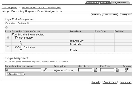

Assigning balancing segment values to legal entities is optional; however, it is strongly recommended that you assign specific balancing segment values to each legal entity to help identify legal entities during transaction processing and reporting. This is particularly important for accounting setups that use the accounting setup where multiple legal entities share the same primary ledger.
By assigning balancing segment values to legal entities, you can also take advantage of all of the legal entity accounting features available, such as intercompany accounting.
If you do not assign any balancing segment values to your legal entities, then all balancing segment values will be available for transaction processing.
Note: If using multiple value sets for the balancing segment across charts of accounts, be sure to assign the correct value set to the legal entity. Once assigned, you cannot remove the value set from legal entities. However, there is no harm in assigning the wrong value set or assigning balancing segment values for the wrong value set; the system will ignore it during transaction processing.
Tip: If you are unsure about the value set to assign to each legal entity, allow Accounting Setup Manager to do it. When assigning a legal entity to an accounting setup, Accounting Setup Manager automatically assigns the correct value set associated with the legal entity's primary ledger and secondary ledger, if used.
Any balancing segment values assigned to a legal entity are automatically assigned to the legal entity's ledger when completing the accounting setup.
When entering transactions using Oracle subledgers, use only the valid balancing segment values that are assigned to the legal entity.
When entering journals in General Ledger, use only the valid balancing segment values assigned to the ledger's legal entities and the ledger itself.
If no balancing segment values are assigned to the legal entities or ledgers, then all balancing segment values will be available to enter transactions and journal entries.
Special Note for Disabling Legal Entities: If disabling a legal entity by entering an end date, also enter end dates for all assigned balancing segment values to prevent the use of the balancing segment value.
If you have an accounting setup with multiple legal entities assigned and specific balancing segment values assigned to legal entities, you cannot complete the accounting setup if the following violations exist:
overlapping balancing segment values assigned to the legal entities for the same accounting setup
balancing segment values assigned to some, not all, of the legal entities assigned to the same accounting setup
Note: Accounting Setup Manager does not check for overlapping balancing segment values assigned to legal entities in different accounting setups. Therefore, ensure that the correct balancing segment values are assigned to legal entities in all accounting setups.
Note: Before the accounting setup is complete, delete and add balancing segment values to legal entities at any time. After completing the accounting setup, you cannot delete balancing segment values from legal entities; you can end date the balancing segment value to prevent the use of it.
It is recommended that you designate the balancing segment of the chart of accounts as the legal entity or company segment. If there are multiple legal entities that use different charts of accounts, limit the number of value sets you define for the balancing segment to ease maintenance efforts. This allows you to share value sets across multiple charts of accounts and assign unique balancing segment values for each legal entity that is consistent across charts of accounts.

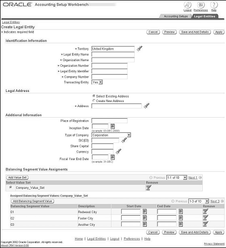

Use the Create Legal Entity page to create legal entities.
The following prerequisites are required only if planning to assign balancing segment values to legal entities:
define a chart of accounts
define segment values for the balancing segment
Navigate to the Legal Entities page.
Click Create Legal Entity.
Enter all relevant fields for the Identification Information, Legal Address, Additional Information, and Balancing Segment Value Assignments.
Click Apply or click Save and Add Details to enter additional information for the legal entity that includes the following:
registrations
establishments
Note: Adding this additional information is not required for creating an accounting setup.
Note: You can quickly create legal entities when creating an accounting setup.
In the Balancing Segment Value Assignments region, click Add Value Set.
Select a value set from the list of values.
Only value sets that use the balancing segment value qualifier are displayed.
To assign balancing segment values for the value set, click Add Balancing Segment Value.
Select one or more balancing segment values to assign to this legal entity. You cannot assign parent values.
Note: Be sure to assign unique balancing segment values to each legal entity. You cannot complete the accounting setup if multiple legal entities assigned to the same accounting setup have overlapping balancing segment values assigned or only some of the legal entities have balancing segment values assigned.
To make this value available for a limited time, enter a start date and/or an end date.
Note: Start and end dates can be changed at any time.
Click Apply.

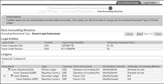

The accounting setup structure defines the framework or skeleton of an accounting setup.

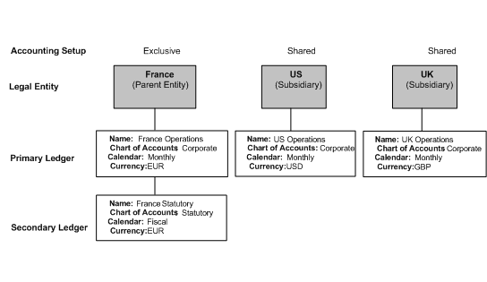

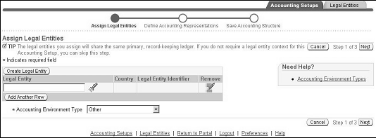

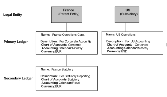

Assigning legal entities to accounting setups is optional. Assign legal entities if you are planning to use Oracle financial subledgers that require a legal entity context for transaction processing. Also, assign legal entities if you are planning to use legal entity specific features, such as intercompany accounting.
In the Assign Legal Entities page, assign legal entities.
If creating legal entities from the Assign Legal Entities page, you are not creating a complete definition of your legal entity. Complete the definition of the legal entity later from the Legal Entities tab.

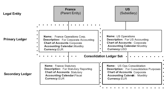

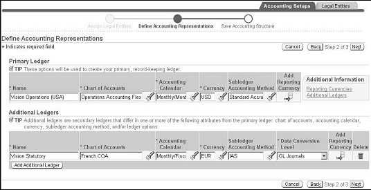

Specify the ledger attributes for the primary ledger. The primary ledger acts as the primary accounting representation. Optionally specify the ledger attributes for one or more secondary ledgers to represent primary ledger transactions in a different chart of accounts, calendar, currency, subledger accounting method, and/or ledger processing options.

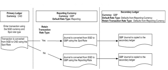

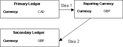

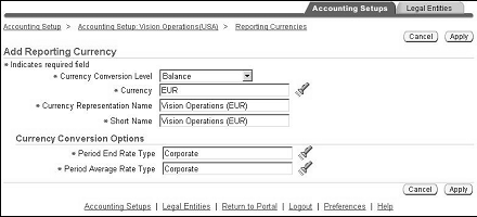

To maintain additional currency representations of primary or secondary ledgers, assign reporting currencies to them.

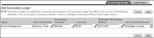

Note: Add secondary ledgers and reporting currencies to accounting setups at any time. Before completing the accounting setup, you can delete secondary ledgers and reporting currencies. After completing the accounting setup, you can only disable the conversion of reporting currencies and secondary ledgers.
Navigate to the Define Accounting Representations page from the Assign Legal Entities page.
Specify primary ledger attributes for the required fields.
Note: You cannot assign a calendar if it contains gaps between periods or it does not have a full fiscal year defined.
Optionally assign a subledger accounting method if planning to use Subledger Accounting to integrate data from Oracle financial subledgers or external feeder systems.
Note: Once you assign a subledger accounting method, you must always have a subledger accounting method assigned. You can change the subledger accounting method at any time.
Optionally, specify the following secondary ledger attributes:
name
chart of accounts
accounting calendar
currency
Note: To define a subledger level secondary ledger, assign a subledger accounting method to both the primary ledger and to this secondary ledger.
Note: To define an adjustments only secondary ledger, the chart of accounts, accounting calendar, and currency must be the same as the primary ledger. If you only want to use the Adjustments Only secondary ledger for manual adjustments in General Ledger, do not assign a subledger accounting method. To use the Adjustments Only secondary ledger for both manual and automated adjustments from Subledger Accounting, assign a subledger accounting method to both the primary and secondary ledger.
Specify a Data Conversion Level.
Note: Data Conversion Levels
If assigning a balance level secondary ledger that uses a different currency from the primary ledger, a balance level reporting currency is automatically assigned to the primary ledger if you did not create one. For example, if the primary ledger's currency is EUR and you assign a balance level secondary ledger whose currency is CAD, the system automatically creates a balance level reporting currency for the CAD currency. This reporting currency is used as the source representation when transferring CAD balances to this secondary ledger.
Optionally, select the Add Reporting Currency icon.
In the Add Reporting Currency page, enter a currency and one of the following currency conversion levels:
Balance: maintains translated balances
Note: The currency of the balance level reporting currency cannot be the same currency as its source ledger.
Journal: maintains journals and balances in the reporting currency using the General Ledger Posting program
Subledger: maintains a currency representation of the source ledger's subledger journals, General Ledger journals, and balances using both Subledger Accounting and the General Ledger Posting program.
Note: The subledger level reporting currency requires a subledger accounting method to be assigned to the primary ledger.
Note: You cannot assign subledger level reporting currencies to secondary ledgers.
Click Apply.
Carefully review and save the accounting setup structure to finish creating the framework of the accounting setup before proceeding to the Accounting Options.
Once you save the accounting setup structure, you cannot change the following:
chart of accounts, accounting calendar, or currency of the primary ledger and secondary ledger
Navigate to the Save Accounting Structure page from the Define Accounting Representations page.
Review the accounting setup structure.
Click Finish.
The Accounting Options page is displayed in a checklist format to complete the relevant setup steps to make the accounting setup ready for entering transactions and journals.
Before entering transactions, complete all of the required setup steps for each accounting setup. If using secondary ledgers, complete all of the required setup steps for the primary ledger before completing the setup steps for the secondary ledgers
Navigate to the Accounting Options page in one of the following ways:
After saving the accounting setup structure, click Define Accounting Options.
Query an existing accounting setup from the Accounting Setups page, and then select the Update Accounting Options icon.
The name of the Accounting Options page is named after the primary ledger, such as Accounting Options: <Name of primary ledger>

The Legal Entities region of the Accounting Options page allows you to do the following:
view legal entities and make changes
update legal entities
add legal entities
remove legal entities from one accounting setup and assign them to another accounting setup
Once the accounting setup is complete, you cannot remove any of its legal entities. To disable a legal entity, end-date it.
Once you end-date a legal entity, you cannot enter new subledger transactions against the legal entity. You can use the legal entity's balancing segment values to enter manual journal entries in General Ledger. This allows you to enter adjusting entries during the accounting close.
If you end-date a legal entity, end date its balancing segment value to prevent the use of the balancing segment value for journal entries.
assign unique balancing segment values to legal entities
Note: If you use balancing segment values to represent legal entities, do not assign the same balancing segment values to multiple legal entities that are assigned to different accounting setups. Accounting Setup Manager will not prevent you from assigning the same values to legal entities in different accounting setups.
remove balancing segment values
You can only remove balancing segment values before the accounting setup is complete. A balancing segment value removed from one legal entity can be assigned to another legal entity within the same or different accounting setup
Note: If the accounting setup is complete, you cannot remove any balancing segment values from the accounting setup's legal entities. To disable the balancing segment value, end-date it.
You can query historical transactions and report on the end-dated balancing segment value
end-date balancing segment values
You can end-date balancing segment values at any time. If you end-date a balancing segment value, you cannot enter new transactions with dates after the end-date. You can query historical transactions and report on the end-dated balancing segment value.
Note: If you end-date a legal entity, end-date the balancing segment values that are assigned to the legal entity. This prevents users from entering transactions using a balancing segment value that is associated with an inactive legal entity.

The same setup steps for the primary ledger also apply to secondary ledgers. The following setup step applies only to secondary ledgers:
Primary to Secondary Ledger Mapping, required
Note: Add secondary ledgers at any time after completing the ledger options for the primary ledger by clicking Add Secondary Ledgers.
A ledger determines the chart of accounts, accounting calendar, currency, subledger accounting method, and ledger processing options for each company, legal entity, or group of companies and legal entities.
Each accounting setup requires a primary ledger that acts as the main record-keeping ledger for none or one or more legal entities that use your main chart of accounts, accounting calendar, subledger accounting method, and currency to record and report on all of your financial transactions.
To maintain an additional accounting representation, use secondary ledgers.
To maintain an additional currency representation, use reporting currencies.
To report on account balances in multiple currencies, assign reporting currencies to ledgers.
Reporting currencies can only differ by currency from their source ledger and must share the same chart of accounts, accounting calendar/period type combination, subledger accounting method, and ledger processing options as their source ledger.

Reporting currencies express the accounting in your primary and/or secondary ledgers in an additional currency representation. For example, the USD primary ledger balances can be expressed in CAD or Yen by assigning a balance level reporting currency to the primary ledger.
Unlike secondary ledgers, reporting currencies can only differ by currency from their source ledger. They must share the same chart of accounts, accounting calendar/period type combination, subledger accounting method, and ledger processing options as their source ledger (primary or secondary ledger).
Reporting currencies can be maintained at three different currency conversion levels:
Subledger: Maintains a currency representation of your subledger journals, General Ledger journal entries, and balances.
When using the subledger level reporting currency, you must define subledger accounting rules using Subledger Accounting. These rules provide instructions on how to convert subledger data entered into the source ledger to one or more subledger level reporting currencies.
You must also define journal conversion rules. General Ledger Posting uses the journal conversion rules to automatically replicate specific journals, such as manual journal entries, to one or more subledger level reporting currencies.
Note: Subledger level reporting currencies can only be assigned to primary ledgers, not secondary ledgers.
Journal: Maintains General Ledger journal entries and balances in another currency representation.
Journal level reporting currencies are maintained using the General Ledger Posting Program. Every time a journal is posted in the source ledger, the journal is automatically converted to the respective journal level reporting currency based on the journal conversion rules defined.
Balance: Maintains balances in another currency.
The General Ledger Translation program is used to convert balances from the source ledger to the balance level reporting currency. When you run Translation in your primary or secondary ledger and specify a target currency, the translated balances are reflected in the balance level reporting currency.
Note: If a balance level reporting currency is not assigned to the ledgers in the accounting setup, a balance level reporting currency is automatically created the first time Translation is run. The name of the balance-level reporting currency is the same as its source ledger except its currency code, such as (USD), is appended to the end of its name.
Note: The subledger level and journal level reporting currencies act similarly to ledgers. You must open and close the periods for these reporting currencies before you can enter transaction and journal entries. You can also enable journal approval for these reporting currencies if planning to enter manual journal entries directly to these reporting currencies.
If reporting currencies are assigned to ledgers when creating an accounting setup structure, the status for the Reporting Currencies step is In Process. To complete the accounting setup, update the reporting currency and complete the conversion options for all reporting currencies that are assigned.
If no reporting currencies are assigned to the ledgers when creating the accounting setup structure, the Reporting Currencies step is not required and the status is Not Started.
Add reporting currencies to accounting setups at any time.
Note: Adding Reporting Currencies
In the Accounting Options page, click the Update icon for a reporting currency.
Update each reporting currency.
Enter all relevant fields for the reporting currency.

| Field | Description |
| Currency Conversion Level | Balance defaults to indicate that this is a balance level reporting currency; cannot be changed |
| Period End Rate Type | Translates actual account balances; defaults from the source ledger; can be changed |
| Period Average Rate Type | Translates actual account balances; defaults from the source ledger; can be changed |

Add reporting currencies to primary or secondary ledgers at any time. If adding journal level or subledger level reporting currencies to existing ledgers that have periods opened, you must initialize the beginning balances for your reporting currency and optionally choose to convert historical data from the source ledger to the reporting currency. Historical Conversion refers to converting the historical transactions of the source ledger to the journal level or subledger level reporting currency.
Note: Historical Conversion does not apply to reporting currencies that are assigned to new accounting setups.
Note: Before adding journal or subledger level reporting currencies, carefully review the information in the Implementation Considerations section of the Journal or Subledger-Level Reporting Currencies chapter of the Oracle General Ledger User Guide.
Note: If you allow users to make adjustments in Oracle Projects to expenditure items that represent receipts, receipt non-recoverable tax, or exchange rate variances, then Oracle Projects does not perform accounting for adjustments in reporting currencies and subledger level secondary ledgers if the secondary ledger currency differs from the primary ledger currency. Please review your business practices and ensure that the Oracle Projects profile options PA: Allow Adjustments to Receipt Accruals and Exchange Rate Variance are set appropriately. For additional information, see: Profile Restrictions to Supplier Cost Adjustments, Oracle Project Costing User Guide.
Navigate to the Accounting Options page.
Click the Update icon for the reporting currency.
In the Reporting Currency Assignment region, click Add Reporting Currency.
Select the Currency Conversion level.
You can only assign subledger level reporting currencies to primary ledgers that have subledger accounting methods assigned.
If assigning a reporting currency to a secondary ledger, the currency conversion level of the reporting currency must be equal to or less than the Data Conversion Level of the Secondary Ledger. The following table lists the types of reporting currencies that can be assigned to Secondary Ledgers.
| If the secondary ledger data conversion level is ... | Then the type of reporting currency available is… |
| Balance | Balance level only |
| Journal | Balance or journal level |
| Subledger | Balance or journal level
Note: : Secondary ledgers cannot have subledger level reporting currencies assigned. |
| Adjustments Only | Balance level only |
Enter all required fields.
To initialize beginning balances and convert historical transactions or journals to this reporting currency, enter Data Conversion Initialization options as described in the following table.
| Option | Description |
| First Future Conversion Period | The first period for which you want to convert transactions or journals to your reporting currency. The First Future Conversion Period is also the period in which account balances are initialized in your reporting currencies. It must be the first future-enterable period in your source ledger. |
| Retain Original Conversion Rate Type | To convert data from the source ledger to your reporting currency for periods prior to the First Future Conversion Period, this options determines whether the original rate type can be used to convert historical data.
| Historical Conversion Rate Date | Enter the date of the conversion rate to use to convert historical data to this reporting currency. |
| Historical Conversion Rate Type | If you entered No to retain the original transaction's conversion rate type, enter the conversion rate type to use for historical data conversion. |
Note: For more information about the previous four options, see the Implementation Considerations section of the Journal or Subledger-Level Reporting Currencies chapter of the Oracle General Ledger User Guide.
Click Apply.
Note: Reporting currencies can only be deleted before the accounting setup is complete. If the reporting currency acts as the source representation for a secondary ledger, delete the secondary ledger before deleting the reporting currency.
After the accounting setup is complete, you cannot delete reporting currencies; you can disable the conversion of subledger and journal level reporting currencies. This prevents future transactions and journals from being converted to the reporting currency. You will still be able to use the disabled reporting currency to view historical data and enter manual journals.
If the reporting currency acts as the source representation for a secondary ledger, disable the conversion of the secondary ledger before disabling the conversion for the reporting currency.
Note: The source representation of the secondary ledger is displayed in the Source Representation field in the Primary to Secondary Ledger Mapping page.
Note: Balance level reporting currencies cannot be disabled. To stop the conversion of balances from the source ledger to the balance level reporting currency, stop running Translation.
Once the conversion of a reporting currency is disabled, the status of the reporting currency is changed to Disabled.
Navigate to the Reporting Currencies page.
In the Reporting Currency Assignment region, click the Disable Conversion icon.
Note: Once disabled, the conversion of a reporting currency cannot be enabled.
Optionally assign specific balancing segment values to ledgers to track non-legal entity-related transactions or adjustments using a specific balancing segment value.
Note: Assign specific balancing segment values to all legal entities in an accounting setup before assigning a specific balancing segment value to the ledgers in the accounting setup.
Balancing segment values can be added to ledgers at any time.
Before the accounting setup is complete, you can remove balancing segment values from ledgers.
After the accounting setup is complete, you can only disable the balancing segment value by entering an end date.
Click the Update icon for the Balancing Segment Value Assignments step.
View the balancing segment values assigned to the legal entities associated with the accounting setup in the Legal Entity Assignment region.
In the Ledger Assignment region, enter a balancing segment value.
Note: The value cannot be the same as the balancing segment values assigned to the legal entities.
Optionally, enter a start and end date to make the value effective for a limited time.
Note: This step does not have to have a status of Complete in order to complete the accounting setup.
Balancing segment values can only be removed from ledgers before the accounting setup is complete.
Navigate to the Ledger Balancing Segment Value Assignments page. You access this page by updating the Balancing Segment Value Assignments step for the ledger.
To remove balancing segment values, click the Remove icon for each balancing segment value.
Disable balancing segment values by entering an end date for the value. You cannot use the balancing segment value to enter new transactions or journals after the end date. You can only use the value for reporting and viewing historical data.
To disable a balancing segment value, enter an end date.

Secondary ledgers represent the primary ledger's accounting data in another accounting representation that differs in one or more of the following ways:
chart of accounts
currency
Use secondary ledgers for supplementary purposes, such as consolidation, statutory reporting, or adjustments for one or more legal entities within the same accounting setup. For example, use a primary ledger for corporate accounting purposes that uses the corporate chart of accounts and subledger accounting method, and use a secondary ledger for statutory reporting purposes that uses the statutory chart of accounts and subledger accounting method. This allows you to maintain both a corporate and statutory representation of the same legal entity's transactions in parallel.
Assign one or more secondary ledgers to each primary ledger for an accounting setup.
The secondary ledgers assigned can only perform the accounting for the legal entities within the same accounting setup.
Note: If an additional ledger is needed to perform accounting across legal entities or ledgers in different accounting setups, use a ledger in an accounting setup with no legal entity assigned. This can be used for multiple purposes, such as performing management reporting or consolidation across multiple legal entities.
Related Topics
Secondary Ledgers can be maintained at one of the following data conversion levels:
The following conversion rules are used to convert data from the primary ledger to the secondary ledger:
Chart of Accounts Conversion: If the secondary ledger uses a different chart of accounts from the primary ledger, a chart of accounts mapping is used to provide instructions for mapping accounts or entire account segments from the primary ledger to the secondary ledger.
Calendar Conversion: If the secondary ledger uses a different accounting calendar from the primary ledger, the journal effective date determines the corresponding non-adjusting period in the secondary ledger.

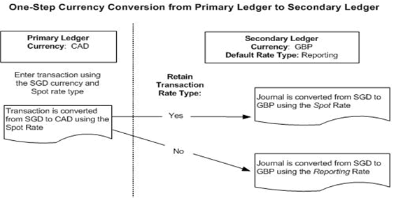

Currency Conversion: If the secondary ledger uses a different currency from the primary ledger, currency conversion rules are required to instruct the system on how to convert data from the currency of the primary ledger to the currency of the secondary ledger.
Journal Conversion (Used by General Ledger Posting only): To select the journals for transfer to the secondary ledger based on journal source and category combinations. The General Ledger Posting program uses these rules to determine which journals to automatically transfer to the secondary ledger during posting.
Note: The above conversion rules do not apply to Adjustments Only level secondary ledgers because they must share the same chart of accounts, accounting calendar, and currency as the primary ledger.

Use secondary ledgers for consolidated reporting to prevent the need to perform balance transfer consolidations, and to obtain a cross-company view of your enterprise. For example, assume the two accounting setups described in the following graphic and table are defined for the company's legal entities.
| Legal Entity | France (Parent Entity) | US (Subsidiary) |
Primary Ledger
| France Operations Corporation
| US Operations
Secondary Ledger
| France Statutory (Subledger Level)
The France legal entity uses a primary ledger for corporate accounting purposes and a secondary ledger for statutory reporting purposes. Both ledgers use different charts of accounts and accounting calendars.
The US subsidiary uses its own chart of accounts and currency to account for its transactions in its main record-keeping ledger, the primary ledger.
For ease of consolidation, the US subsidiary can assign a secondary ledger to its primary ledger. The secondary ledger should use the same chart of accounts, accounting calendar, and currency as the parent entity, France. Then, by using a ledger set to group the secondary ledger of the US subsidiary with the primary ledger of the parent entity, consolidated results can be obtained by simply running an FSG report using the ledger set. This prevents the need to perform balance transfer consolidations every period.
The following graphic and table describe an example of the ledger configuration when a secondary ledger is added to the US subsidiary. The Consolidation Ledger Set is comprised of the primary Ledger for France and the secondary ledger for the US.
| Legal Entity | France (Parent Entity | US (Subsidiary) |
Primary Ledger
| US Operations
Secondary Ledger
| US Operations Consolidation
Note: If the parent entity, France, needs to enter consolidation adjustments, such as intercompany eliminations, they can enter those adjustments in their primary ledger using a balancing segment value that is reserved for manual adjustments.

Add secondary ledgers to accounting setups at any time in the Accounting Options page.
If you add a balance level secondary ledger that uses a different currency from the primary ledger, a balance level reporting currency is generated for the primary ledger unless one already exists. This balance level reporting currency maintains the primary ledger's translated balances and is the source representation for the secondary ledger. In other words, when using GL Consolidation to transfer balances to the secondary ledger, transfer the balances from the source representation, the balance level reporting currency.
Note: The source representation is displayed on the Primary to Secondary Ledger Mapping page.
The ledger options for the primary ledger must be completely defined.
Click Add Secondary Ledger.
This button will only appear after the ledger options for the primary ledger have a complete status.
Enter all relevant fields.
The table below describes selected fields in the Add Secondary Ledger page.
| Accounting Calendar | General Ledger uses the calendar periods that have the period type specified for journal entry, budgeting, and reporting with this ledger.
Note: Accounting Setup Manager reports an error if there are any gaps between periods in the accounting calendar or if any of the non–adjusting periods overlaps. |
| Subledger Accounting Method | If defining a balance or journal level secondary ledger, do not assign a subledger accounting method. If defining a subledger journals level secondary ledger, a subledger accounting method must be assigned to the secondary ledger and its primary ledger. Note: If defining an Adjustments Only secondary ledger for manual adjustments in General Ledger, do not assign a subledger accounting method. To use the Adjustments Only secondary ledger for both manual and automated adjustments from Subledger Accounting, assign a subledger accounting method to both the primary and secondary ledger. Note: Subledger Accounting Methods, Oracle Subledger Accounting Implementation Guide |
| Data Conversion Level | To select Subledger, a subledger accounting method must be assigned to both the primary and secondary ledger. To select Adjustments Only, the secondary ledger must share the same chart of accounts, accounting calendar, and currency as the primary ledger. The subledger accounting method, if used, can be different from the primary ledger. However, to assign a subledger accounting method to the adjustments only secondary ledger, you must also assign one to the primary ledger. Note: The data conversion level cannot be changed. |
Note: After adding a secondary ledger, complete the Ledger Options step and the Primary to Secondary Ledger Mapping step to enable the secondary ledger for data entry.

The Primary to Secondary Mapping step specifies the conversion options to convert data from the primary ledger to the secondary ledger that may use a different chart of accounts, currency, and calendar from the primary ledger.
Note: If using an adjustments only secondary ledger, the Primary to Secondary Ledger Mapping step is not displayed. No conversion rules are required because the adjustments only secondary ledger must share the same chart of accounts, accounting calendar, and currency as the primary ledger.
This section describes the following conversion options:
In order to convert data between the charts of accounts of the primary and secondary ledgers, assign a chart of accounts mapping. A chart of accounts mapping is a set of instructions for mapping accounts or entire account segments from your primary ledger’s chart of accounts to your secondary ledger’s chart of accounts. This is particularly important if the primary and secondary ledgers use different charts of accounts.
Note: If a chart of accounts mapping is not assigned when the primary and secondary ledgers use different charts of accounts, errors are caused with Subledger Accounting and General Ledger posting.
If the primary and secondary ledgers use the same chart of accounts, the chart of accounts mapping is not required but can be assigned to the journal level and balance level secondary ledgers. This allows more flexibility to utilize different rollup rules when transferring journals or balances from the primary ledger to the secondary ledger. For example, you can maintain more detailed information in the primary ledger but maintain more summarized information in the secondary ledger, depending on the rollup rules defined for the chart of accounts mapping.
Note: You cannot change the chart of accounts mapping that is assigned to the secondary ledger once the accounting setup is complete.
Note: Mapping Charts of Accounts, Oracle General Ledger User Guide
If the primary and secondary ledgers use different accounting calendars, the journal effective date is used to determine the corresponding non-adjusting period in the secondary ledger. If the secondary ledger does not share the same calendar as the primary ledger, each primary ledger journal is transferred to the secondary ledger’s non-adjusting period that includes the journal's effective date.
In order to transfer journals to the secondary ledger, specify journal conversion rules. Choose the journals to transfer to the secondary ledger by specifying journal source and category combinations. The General Ledger Posting program uses these journal conversion rules to determine which journals it should automatically transfer to the secondary ledger during posting.
Note: Journal conversion rules are only applicable if the data conversion level of the secondary ledger is subledger or journal.
Journal sources identify the origin of journal entry transactions, such as Purchasing or Payables. Journal categories describe the purpose of journal entries, such as purchase requisitions or purchase orders.
Specifying a journal source and category combination and selecting Yes to Transfer Journals to this Secondary Ledger, instructs the General Ledger Posting program to automatically transfer those journals to this secondary ledger when they are posted in the source representation.
The journal source and category Other represents all other journal sources and categories other than those explicitly defined.
To transfer the majority of journals to this secondary ledger, specify Yes for the Other journal source and category and then selectively choose No for the journal source and category combinations that you do not want transferred.
If you do not want the majority of journals to be automatically transferred to this secondary ledger, specify No for the Other journal source and category and then selectively add those journal source and category combinations that you do want transferred.
By default, journals using the journal sources described in the following table are not automatically converted to the secondary ledger using General Ledger Posting.
| Journal Source | Journal Category | Transfer Journals to Secondary Ledger |
| Move/Merge | Other | No |
| Move/Merge Reversal | Other | No |
| Revaluation | Other | No |
This means that if you revalue balances in the source representation, such as the primary ledger, the resulting journals are not transferred to the secondary ledger. The same is true if you use MassMaintenance to move or merge balances between accounts in the source representation.
For example, if moving or merging account balances in the primary ledger, the resulting journal entries that use the source Move/Merge are not automatically converted to the secondary ledger. The same rule applies if reversing the Move/Merge journal entry. You must perform the Move/Merge operation and Move/Merge reversal in the secondary ledger separately.
Run Revaluation separately in the secondary ledger. General Ledger does not automatically convert the primary ledger's revaluation journal to the secondary ledger.
By default, all other journal sources and categories are converted to the secondary ledger as indicated by the Other journal source and category.
For subledger level secondary ledgers, the journal sources for transaction sources that use Subledger Accounting must be set to No in the Transfer Journals to this Secondary ledger field. Any journal source that uses Subledger Accounting to generate its accounting entries must not be converted to the secondary ledger using General Ledger Posting because Subledger Accounting automatically performs the conversion for these subledger journals.
Note: To find all transaction sources that integrate with Subledger Accounting, query them in the Subledger Application form that is accessed from the Subledger Accounting Setup menu.
Note: Subledger Accounting Options
Note: If integrating with transaction sources that do not use Subledger Accounting and you want General Ledger posting to maintain journals from these subledgers in the subledger level secondary ledger, do not use Oracle's seeded journal sources. For example, if you use a non-Oracle Receivables application, you can create your own journal source for that application instead of using the seeded source Receivables that is reserved for Oracle sources. If you use the seeded source to import data from third party systems, those journals will not be transferred to a subledger level secondary ledger when you post them in the primary ledger.
If the primary and secondary ledger use different ledger currencies, currency conversion rules are required to instruct the system on how to convert data from the currency of the primary ledger to the currency of the secondary ledger.
Note: If both the primary and secondary ledgers use the same currency, the currency conversion rules are not applicable.
For information on the Default Rate Type and Retain Transaction Rate Type options, see the Journal and Subledger Level Reporting Currencies table.

When the source representation is the primary ledger, this is referred to as a one-step conversion from the primary ledger.
Assume you have a primary ledger and a journal level or subledger level secondary ledger. The primary ledger’s currency is CAD; the secondary ledger’s currency is GBP; and the Default Rate Type is Reporting.
An SGD foreign currency journal is entered in the primary ledger using the transaction rate type of Spot.
The journal is first converted to the currency of the primary ledger using the transaction rate type, Spot. When the journal is posted in the primary ledger, the Secondary Ledger’s Default Rate Type and Retain Transaction Rate Type settings determine how the SGD entered journal is converted.
If Retain Transaction Rate Type is set to Yes, then the journal is converted from SGD to GBP (the currency of the secondary ledger) using the transaction rate type, Spot.
If Retain Transaction Rate Type is set to No, then the journal is converted from SGD to GBP (the currency of the secondary ledger) using the Default Rate Type, Reporting.
This example is shown in the figure below.
One-Step Conversion from Primary Ledger to Secondary Ledger
For journal level secondary ledgers only, you can choose to make the source representation a journal level reporting currency that is assigned to the primary ledger. For example, the source representation for a journal level secondary ledger can be a journal level reporting currency.
Note: The currency of the journal level reporting currency must match the currency of the secondary ledger.
This is referred to as a two-step conversion from the primary ledger. When data is entered in the primary ledger, the data is first converted to the journal level reporting currency and then transferred to the journal level secondary ledger, as described in the figure below.
Two-Step Conversion from the Primary Ledger
This is useful if you are already using a journal level reporting currency for reporting purposes. By using a journal level reporting currency as the source representation, you can enter additional journal entries directly in the reporting currency to have them propagated to the secondary ledger.
Note: The two-step conversion method is most suitable for companies that require a reporting currency level of detail for the primary ledger.
When choosing a journal level reporting currency as the source representation, the Default Rate Type and Retain Transaction Rate Type settings for the reporting currency control the currency conversion of transactions to the secondary ledger. In other words, the secondary ledger inherits the same settings as the reporting currency.
Two-Step Currency Conversion from Primary to Secondary Ledger
Assume you have a primary ledger, a journal level reporting currency that is assigned to the primary ledger, and a journal level secondary ledger. The primary ledger’s currency is CAD and the currency for both the secondary ledger and reporting currency is GBP. The source representation for the secondary ledger is the reporting currency.
An SGD foreign currency journal is entered in the primary ledger using the transaction rate type, Spot.
The following table lists the conversion rates for different currencies used in this example.
| From Currency | To Currency | Rate Type | Rate |
| SGD | CAD | Spot | 1.50 |
| SGD | CAD | Reporting | 1.65 |
| SGD | GBP | Spot | 1.70 |
| SGD | GBP | Reporting | 1.75 |
The journal is first converted to the currency of the primary ledger, CAD, using the transaction rate type, Spot, as described in the following table.
| Account | Entered Debit (SGD) | Entered Credit (SGD) | Converted Debit (CAD) | Converted Credit (CAD) |
| 01.6110 | 1000.00 | 1500.00 | ||
| 01.2110 | 1000.00 | 1500.00 |
Upon posting the journal described in the preceding table, the same journal is converted to the reporting currency based on the reporting currency's Default Rate Type and Retain Transaction Rate Type settings.
If Retain Transaction Rate Type is set to Yes, then the journal is converted from SGD to GBP using the transaction rate type, Spot.
The following table describes the journal entry that appears in both the reporting currency and the secondary ledger.

Assume you have a journal level reporting currency that is the source representation for a journal level secondary ledger. The default rate type assigned to the secondary ledger is Reporting. The currency for both the reporting currency and secondary ledger is GBP.
The SGD foreign currency journal described in the following table is entered in the reporting currency using the transaction rate type, Spot
| Account | Entered Debit (SGD) | Entered Credit (SGD) | Converted Debit (GBP) | Converted Credit (GBP) |
| 01.6110 | 1000.00 | 1700.00 | ||
| 01.2110 | 1000.00 | 1700.00 |
Upon posting the journal in the journal level reporting currency, the same journal is converted to the secondary ledger based on the secondary ledger’s Default Rate Type and Retain Transaction Rate Type settings.
If Retain Transaction Rate Type is set to Yes, then the journal is copied directly to the secondary ledger.
If Retain Transaction Rate Type is set to No, then the journal is converted using the Default Rate Type, Reporting.
The following table describes the journal entry that appears in the secondary ledger if Retain Transaction Rate Type is set to No.
| 01.6110 | 1000.00 | 1750.00 | ||
| 01.2110 | 1000.00 | 1750.00 |
To use a journal level reporting currency as the source representation for a journal level secondary ledger, perform the following tasks:
Define a journal level reporting currency for the primary ledger.
Note: A journal level secondary ledger can only have the primary ledger or a journal level reporting currency as its source representation.
Choose the reporting currency to be the source representation in the Primary to Secondary Ledger Mapping page.
Specify currency conversion rules.
Specify journal conversion rules.
The journal conversion rules specified for the secondary ledger should be the same as the journal level reporting currency, but you can change them for the secondary ledger in the Primary to Secondary Ledger Mapping page.

The following prerequisites are required to complete the primary to secondary ledger mapping step:
A chart of accounts mapping must be defined in General Ledger if the secondary ledger uses a different chart of accounts
A secondary ledger must be assigned to a primary ledger.
The reporting currencies assigned to the primary ledger must be completely defined.
The ledger options for the secondary ledger must be completely defined.
Note: This step is required to complete the accounting setup.
In the secondary ledger regions of the Accounting Options page, click the Update icon for the Primary to Secondary Ledger Mapping step.
Specify the following:
Chart of Accounts Mapping
This mapping is used to convert data from the primary ledger's chart of accounts to the secondary ledger's chart of accounts. If a mapping is not defined, click Create Mapping.
Note: You must assign a mapping if your primary and secondary ledgers use different charts of accounts.
Note: You cannot change the mapping assigned after the accounting setup is complete.
The options in the following table pertain to balance level secondary ledgers only.
| Options | Description |
| Source Representation | When transferring balances using GL Consolidation, the source representation acts as the source of the balances. If the secondary ledger's currency is different from the primary ledger, the name of the primary ledger's balance level reporting currency defaults and cannot be changed. |
| Currency | Currency of the source representation defaults |
| Period End and Period Average Rate Type | The period end and period average rate types are used by General Ledger's Translation program. These rate types are used to translate balances from the primary ledger's currency to the balance level reporting currency that is used as the source representation for the secondary ledger. These rate types should be the same as the source representation. |
journal conversion rules for subledger level and journal level secondary ledgers
The following table describes currency conversion options for journal and subledger level secondary ledgers that use a different currency from the primary ledger.
| Source Representation | Acts as the source of the data that is transferred to the secondary ledger. The primary ledger defaults. For journal level secondary ledger the source representation can be a journal level reporting currency that is assigned to the primary ledger.
Note: The source representation cannot be changed after completing the accounting setup. |
| Default Rate Type | The conversion rate type to use to retrieve exchange rates for converting transactions from the primary ledger to this secondary ledger. The Default Rate Type works with the Retain Transaction Rate Type field. If you choose not to retain the same rate type that was used to convert the original transaction, then the Default Rate Type is used instead. For the default rate type, specify your own conversion rate type or choose one of the predefined rate types. To specify your own, first define it in General Ledger. Note: Defining Conversion Rate Types, Oracle General Ledger User's Guide |
| Retain Transaction Rate Type | Controls the conversion rate type the system should use to convert transaction currency amounts from the source representation to this secondary ledger.
The Retain Transaction Rate Type option is ignored if the following conditions exist:
| If Missing Conversion Rate | Controls what the system should do if it cannot find a conversion rate as of the conversion date
| Number of Days to Find Last Rate | If Use Last Rate is selected, enter a number from 1 to 999. This number indicates how many days back in time the system should look to find a rate.
Note: If a number is not entered, it adversely affects system performance. |
| Post Journals Automatically from Source Ledger | Controls the automated posting of journals.
| Retain Journal Creator from Source Ledger | Controls the Created By user information that can be viewed for each journal using Tools > Examine.
