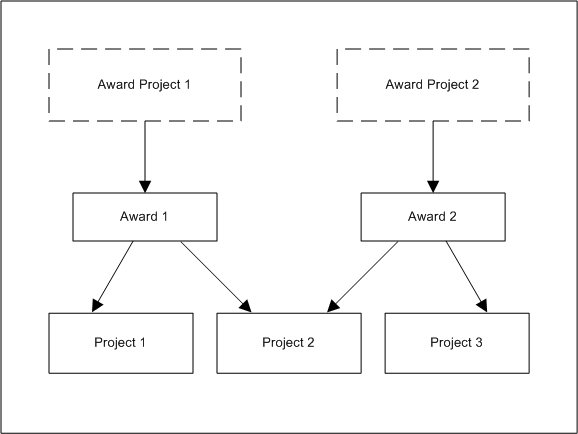

Multiple Awards Funding Multiple Projects Diagram
The diagram below shows multiple awards funding multiple projects.
Award Project 1 funds Award 1, which is funding Projects 1 and part of Project 2. Award Project 2 funds Award 2, which is funding part of Project 2 and all of Project 3.

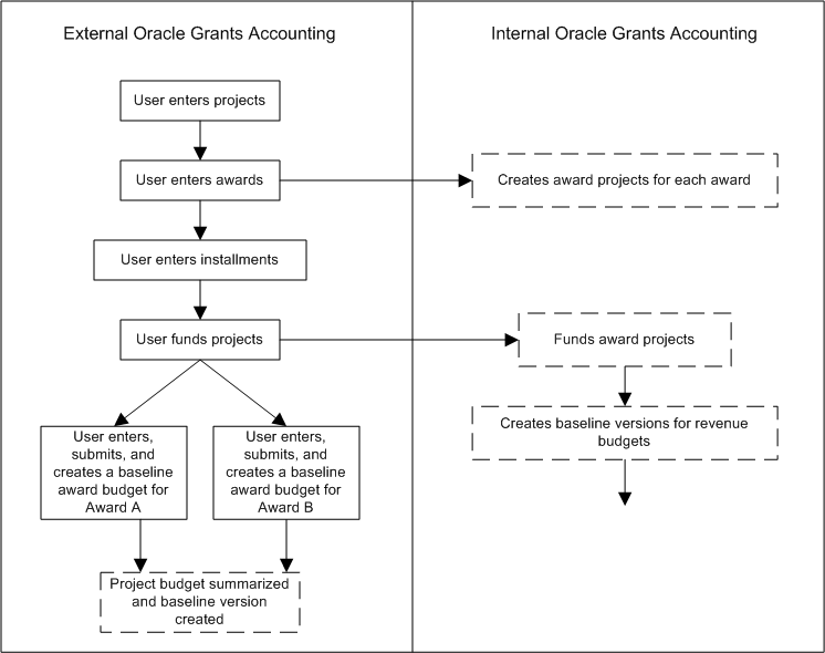

Multifunding Flow Chart
The following diagrams show the multifunding process as described in the Multifunding Process table. Rectangles with solid lines indicate tasks that are viewed by the Grants Accounting user. Rectangles with dashed lines indicate tasks that are not viewed by the Grants Accounting user because they occur internally.
The table below describes the sequence of events that occur in the Grants Accounting user interface and internally in Grants Accounting during the multifunding process.
Event Description of Action that Occurs in the Oracle Grants Accounting User Interface Description of Action that Occurs Internally in Oracle Grants Accounting
1. The user enters projects. No action occurs.
2. The user enters awards. When a new award is created, the system automatically creates an award project. The award project is used to accrue revenue and invoice the award.
3. The user enters installments. No action occurs.
4. The user funds the projects. Award Projects are automatically funded, which result in the automatic creation of baselined revenue budgets.
5. The user enters, submits, and creates baseline versions for award budgets. When you submit an award budget version for baseline processing, a process is activated that summarizes, submits, and creates a baseline version of the project budget.
The first time you create a baseline version for an award budget, Grants Accounting automatically sets budgetary controls using the default settings.
When you create subsequent baselines for the award budget, Grants Accounting sets budgetary controls using the default settings for:
  • Any new tasks that you add to project
  • Any new resources that you add to the resource list assigned to the budget
In addition, you can change the budget entry method for an award budget after you create a baseline version. If the budget entry level for the new budget entry method is different from the budget entry level for the current budget entry method, then Grants Accounting resets the budgetary controls to the default budgetary control level settings when you create the next budget baseline.
6. The user enters transactions against the project and award. No action occurs.
7. The user distributes costs and checks funds available. Transactions are committed, funds are reserved, and the award budget balance is updated when funds check is successful. When funds check fails, transactions are not committed and the award budget balance is not updated.
8. The user runs GMS: Generate Draft Revenue for a Single Award process or GMS: Generate Draft Revenue for a Range of Awards process. Grants Accounting's billing extension creates revenue events for the award project. The award project and revenue events are used to accrue revenue.
9. The user runs GMS: Generate Draft Invoices for a Single Award process or GMS: Generate Draft Invoices for a Range of Awards process. Grants Accounting's billing extension creates billing events for the award project. The award project and billing events are used to invoice by award.
