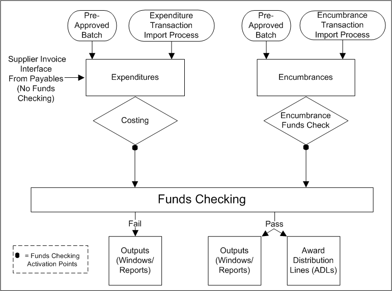

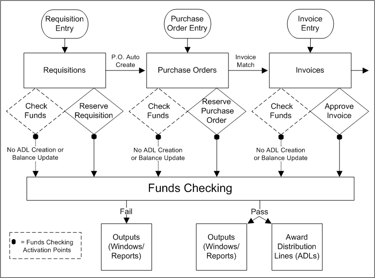

The following figures show the funds check activation points in Purchasing, Payables, and Grants Accounting. The funds check flow shown in the diagram is described in the accompanying text.
Funds Check Activation in Purchasing and Payables
Funds Check Activation in Grants Accounting
In Purchasing, after entering Requisitions or Purchase Orders, users have the option of checking the availability of funds before reserving a transaction. Checking the availability of funds before reserving a transaction results in funds checking that does not commit the transaction or update the balance of the award budget. Checking the availability of funds can be at the detail or summary level. If users elect not to check the availability of funds at this point, funds check is still automatically activated by the reserve action in Purchasing. Reserving a requisition or purchase order transaction results in funds checking that both commits the transaction and updates the balance of the award budget. Reserving a transaction is successful only if the transaction passes funds check.
Note: In Purchasing, if one distribution line fails funds check, then all distribution lines fail funds check. This applies to both General Ledger and Grants Accounting-related distributions.

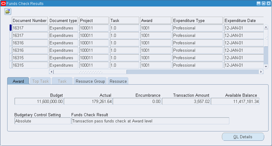

In Grants Accounting, check the available budget in the Funds Check Results window for the project/award distributions that have failed funds check in Purchasing.
Transactions are funds checked from the following activation points in Purchasing:
After entering a requisition in Purchasing, users have the option of checking the availability of funds immediately or reserving the requisition which automatically activates the funds check process. Checking the availability of funds before reserving the requisition is possible at any level of a requisition.
After entering a purchase order in Purchasing, users have the option of checking the availability of funds immediately or reserving the purchase order which automatically activates the funds check process. Checking the availability of funds before reserving the purchase order is possible at the purchase order header, lines, shipments, distributions, and release levels.
In Payables, after entering supplier invoices, users have the option of checking the availability of funds before approving a transaction. As in Purchasing, checking funds before approving a transaction results in funds checking that does not commit the transaction or update the balance of the award budget. If users elect not to check the availability of funds at this point, funds check is still automatically activated by the approval action. Approving the transaction in Payables results in funds checking that both commits the transaction and updates the balance of the award. Approving a transaction is successful only if the transaction passes funds check.
Transactions are funds checked from the Invoice Entry activation point in Payables.
After entering a supplier invoice in Payables, users have the option of checking funds immediately or approving the invoice which automatically activates the funds check process.
In Grants Accounting, funds check is initiated from the following activation points:
Expenditure Costing and Recosting
Encumbrance Funds Check
You must submit one of the following concurrent programs to process a preapproved encumbrance batch:
GMS: Costing and Funds Check on Expense Report Adjustments
GMS: Costing and Funds Check on Straight Time Labor
GMS: Costing and Funds Check on Straight Time Labor for a Range of Projects
GMS: Costing and Funds Check on Usage and Miscellaneous Costs
The costing concurrent programs automatically activates funds check. The output reports list funds check exceptions.

After you enter a pre-approved encumbrance batch, you must submit one of the following concurrent programs for checking funds:
GMS: Encumbrance Funds Check
GMS: Encumbrance Funds Check for a Range of Encumbrance Groups
GMS: Encumbrance Funds Check for a Range of Projects
After funds check is initiated from any of the activation points, the funds check results are accessed from the Funds Check Results window.
The Funds Check Results window details funds check results by the budgetary control levels of Award, Top Task, Task, Resource Group, and Resource.

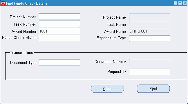

To view funds check results in Grants Accounting, perform the following steps.
In Grants Accounting, navigate to the Find Funds Check Details window as follows:
Expenditures - Funds Check Results
The Find Funds Check Details window appears.
Enter data in each field of the Find Funds Check Details window as described in the Find Funds Check Details Window Description.
Click Find.
The Funds Check Results window appears as described in the Funds Check Result Window Description.

| Field Name | Type | Features | Description |
| Project Number | optional | list of values | project number |
| Project Name | display only | project name | |
| Task Number | optional | list of values | task number |
| Task Name | display only | task name | |
| Award Number | optional | list of values | award number |
| Award Name | display only | award name | |
| Funds Check Status | optional | list of values | funds check status |
| Expenditure Type | optional | list of values | expenditure type |
| Document Type | optional | list of values | document type |
| Document Number | optional (must first select supplier invoice, purchase order, or requisition in the Document Type field) | list of values | document number |
| Request ID | optional | concurrent request ID | |
| Clear | button | erases data from fields | |
| Find | button | searches for data based on parameters entered |
| Document Number | display only | document number | |
| Document Type | display only | document type | |
| Project | display only | project number | |
| Task | display only | task number | |
| Award | display only | award number | |
| Expenditure Type | display only | expenditure type of cost | |
| Expenditure Date | display only | expenditure date | |
| Packet Number | display only | identifier assigned to the budgetary control packet | |
| Funds Check Status | display only | status of funds check request | |
| Amount | display only | expenditure amount | |
| Source Document | display only | expenditure item source | |
| Request ID | display only | concurrent request id | |

| Budget | display only | budget funds checked against |
| Actual | display only | actual balance |
| Encumbrance | display only | encumbrance balance |
| Transaction Amount | display only | transaction amount |
| Available Balance | display only | funds available balance |
| Budgetary Control Setting | display only | budgetary control setting at Award level |
| Fund Check Result | display only | report on whether transaction passed or failed funds check at Award level |
