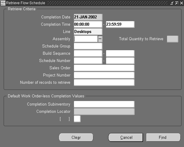

To complete multiple flow schedules:
Navigate to the Work Order-less Completion window.
Change the date and time to the completion date and time desired.
Choose Retrieve.
Enter the retrieve criteria. Line is a required field, all others are optional.
Optionally, enter default completion sub-inventory, locator, and flex field information.
Choose Retrieve.
A window will appear informing you how many records will be retrieved. Choose OK to retrieve them all, choose Cancel to return to the Retrieve window and change your criteria.
Note: Items under lot and serial control cannot be retrieved and must be entered individually using the Work Order-less Completions window. If any other items cannot be retrieved, you will receive an error. Other errors are usually caused by an incorrect or missing completion sub-inventory on a routing. To permanently fix the errors, return to all routings and ensure a completion sub-inventory and locator are entered. To temporarily fix it, you can return to the retrieve screen and enter a default completion sub-inventory and locator.
If there are schedules retrieved that you do not want to complete, highlight them and delete them.
Add any other scheduled or non-scheduled items you wish to complete at the same time, and choose Save.

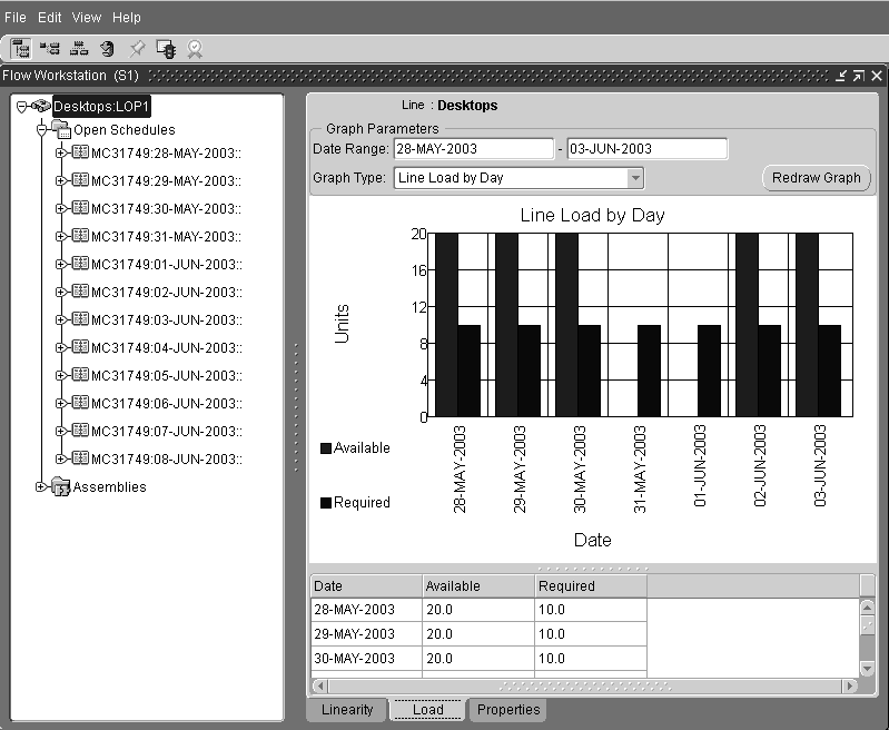

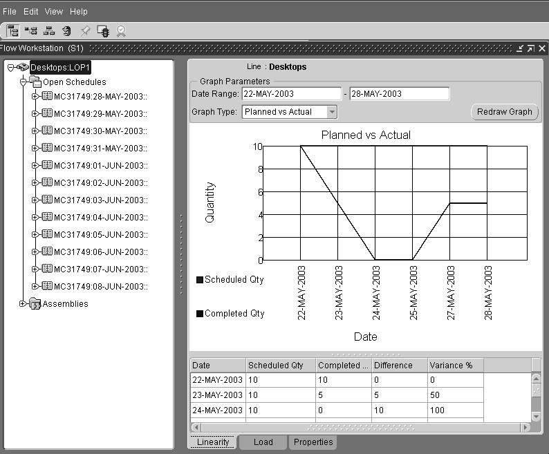

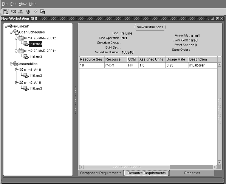

The Flow Workstation provides you with immediate access to critical Flow Manufacturing production information. It enables you to track the flow of work throughout the shop floor and to complete scheduled and unscheduled assemblies directly from the workstation. It also provides you with detailed component, resource, and property information on flow schedules, unscheduled assemblies and their events, and operation instructions and other attachments.
The Flow Workstation enables you to:
View the linearity, load, and properties of the selected line
View a line operation's open schedules and events, and unscheduled assemblies
View detailed information on the components and resources required for schedules and events
Obtain the kanban locations of components required at an operation

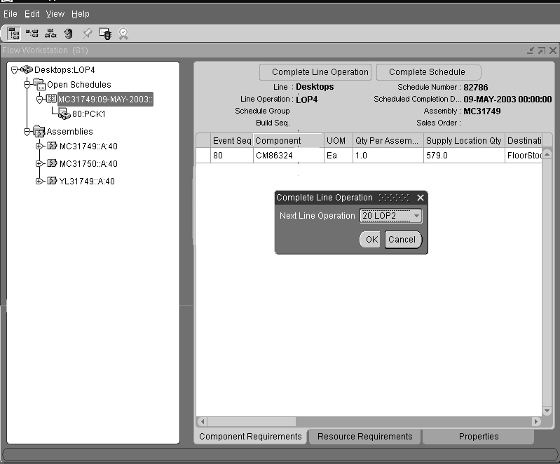

Complete flow schedules and unscheduled assemblies
Complete line operations
Request kanban replenishment
Obtain operating instructions, diagrams, component attachments, and other information attached to assemblies and events

The Flow Workstation window consists of two panes. The left pane displays the workstation directory chooser or navigator in tree format. The right pane displays one or more tabs of detailed information that correspond to the branch that you select from the tree.
The workstation's left pane displays a hierarchical listing of the workstation's contents. Since its structure is analogous to a tree with branches, it is referred to as the workstation tree. The tree displays four branches (levels) of information. When you select a branch (this highlights the branch), information relevant to that branch is displayed on tabs in the right pane of the workstation. When you launch the Flow Workstation, it immediately displays the tabs for the first event of the first scheduled line operation.
The workstation's right pane displays one or more tabbed regions of detailed information pertaining to the branch that you select on the tree. The information on the tabs is displayed either in tables, lists, or in graph format, so that you can quickly assess the status of the schedule or assembly. See: Flow Workstation Tree and Tabbed Regions for detailed information on each of the workstation branches and tabs.
There are tabs available to:
Open windows directly from the workstation so that you can perform common transactions, such as Work Order-less Completion transactions and kanban replenishment.
View attachments previously appended to a job, such as drawings and instructions. See: View Instructions
Dynamic information: the information on the tree is dynamically created when you launch the workstation. You also can update the display at any time by choosing the Refresh tool (curved arrow icon on the toolbar). As schedules are completed, they are automatically removed from the tree so that only current schedules are displayed.

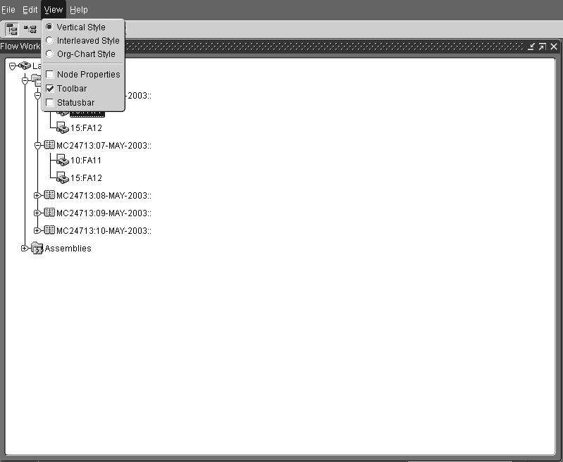

Choice of Formats: you can choose to view the information on the tree in Vertical (the default), Interleaved (horizontal), or Org Chart (organization chart) format. These choices are available through tools on the toolbar or as menu selections under the View menu.
Wider View: in order to view the tree in Interleaved or Org Chart format, you may need to widen the left pane to see the full display. There are two ways that you can do this: you can use your mouse to drag the right side of the pane towards the right side of the window, or you can hide the tabbed regions so that the window's full width can be used to display the contents of the left pane. As follows:
To hide the right pane of the workstation:
Select the View menu, then remove the check mark from the Node Properties check box. The tabs in the right pane are hidden, and the contents of the left pane fill the window area.
To again display the right pane of the workstation:
Select the View menu, then place a check mark in the Node Properties check box. The tabs in the right pane are again displayed.
The following tools are located on the toolbar directly below the workstation menus. From left to right, they are:
Vertical Style: the default; displays the branches of the navigation tree vertically
Interleaved Style: displays the branches of the navigation tree horizontally
Org Chart Style: displays the branches of the navigation tree in the same format as a standard corporate organization chart
Refresh: use this tool to refresh (update) the workstation display
Pin Tab: use this tool to place the active tabbed region in a separate window that remains on top of and separate from the workstation
Replenish Kanban: use this tool to replenish kanbans
Enter Quality Results: use this tool to access the Enter Quality Results window, it is enabled if there is an exiting collection plan

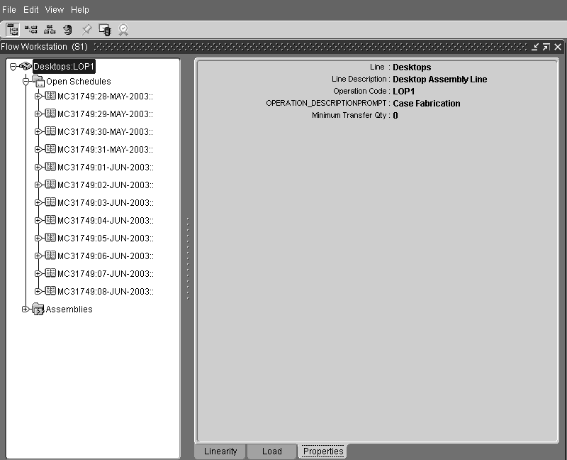

To launch the Flow Workstation:
Navigate to the Flow Workstation. The Flow Workstation Startup window displays.
In the Line field, select a line from.
In the Line Operation field, select a line operation.

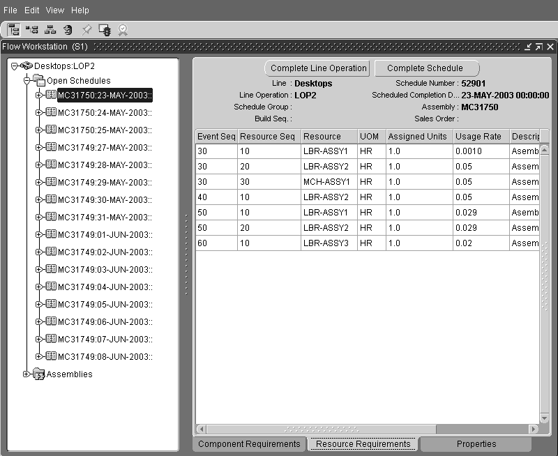

In the Open Schedules region, enter a range of dates in the Completion Dates fields.
This allows you to filter and view schedules for a particular shift or date.
In the Schedule Group field, select a value from the list of values.
This identifier groups schedules for scheduling and releasing purposes. Schedules within a schedule group can be sequenced.
Choose Open.
The Flow Workstation displays.

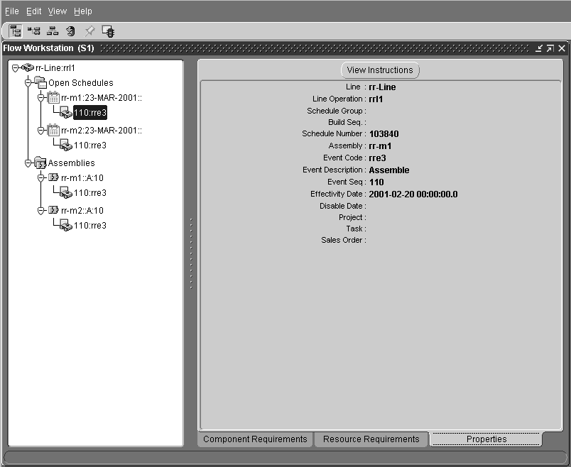

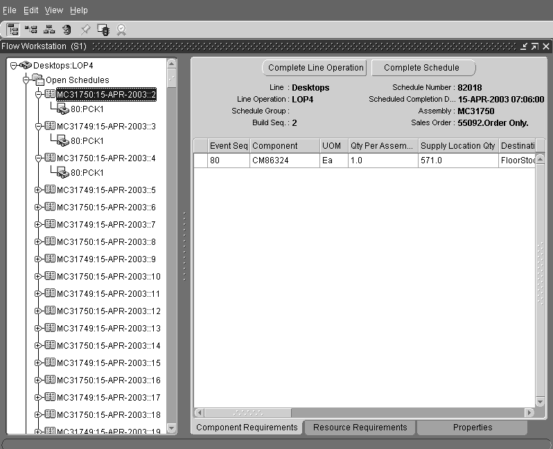

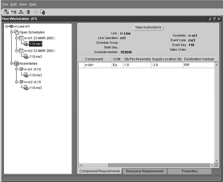

The first and topmost branch on the Flow Workstation tree displays the name of the line and line operation that you selected when you launched the workstation. The main branches:
The Open Schedules branch displays all of the flow schedules at that operation
The Assemblies branch displays all of the unscheduled flow assemblies at that operation
Expanding any branch in the Open Schedule or Assembly branches, displays branches for that schedule's or assembly's events. When you select (highlight) a branch, corresponding tabbed regions of information about that branch are immediately displayed in the right frame of the workstation. When you launch the workstation, it automatically displays the first event of the first open schedule:
The following table lists the workstation branches and the corresponding tabbed regions of information that are displayed.
| Flow Workstation Branch | Corresponding Tabbed Region Displayed |
| Line and Line Operation | Linearity, Load, Properties of the entire line |
| Open Schedules | Blank Tab |
| Individual Schedules | Component Requirements, Resource Requirements, and Properties for each assembly scheduled at the line operation |
| Schedule Events | Component Requirements, Resource Requirements, Properties for each assembly's events |
| Assemblies | Blank Tab |
| Individual Assemblies | Component Requirements, Resource Requirements, Properties for each unscheduled assembly assigned to the line operation |
| Assembly Events | Component Requirements, Resource Requirements, Properties for each assembly's events |
Branch titles contain sections of information identifying the branch. Each section in the branch name is separated by a colon (if two colons appear together, no information is available for the section):
Topmost branch: Displays first the name of the line, then the line operation code. For example: FlowLine01:Op20
Open Schedules branches: Display the Assembly, Schedule Completion Date, Schedule Group, and Build Sequence. For example: Assy01:25-SEP-99:Grp1:20

Choosing Complete Schedule displays the Work Order-less Completions window to complete an open schedule. If you are at the last operation on a schedule, you are prompted to complete the schedule. You can choose another time to complete the schedule. See: Complete Schedule button, and Performing Work Order-less Completions.
You can complete assemblies by choosing Complete Assembly. Choosing this button opens the Work Order-less Completions window in unscheduled mode (the Scheduled check box is not selected), so that you can perform a Work Order-less Completion transaction to complete the assembly.
Performing a Work Order-less Completion transaction automatically backflushes components and charges resource and overhead costs. Once the assembly has been completed, it is removed from the line operation's list of unscheduled Assemblies. See: Buttons on Open Schedule Tabs.

Selecting the topmost branch of the tree (Line:Line Operation), displays three tabbed regions of information in the right pane - the Linearity, Load, and Properties tabs. The information on these tabs can help you manage production across the entire line.

One of the goals of Flow Manufacturing is to produce a constant quantity of products. Linearity determines how close your production matches the production schedule, and the Flow Workstation provides you with immediate access to that information.
When you select the topmost branch of the tree, the Linearity tab is the first tab displayed. Its two graphs, Planned vs Actual and Mix, enable you to determine if production is meeting linearity.
Both the Planned vs Actual and Mix graphs chart the linearity for the entire line, not just the line operation selected. The graphs automatically display the last week of production, but you can select your own range of dates to view. If you change the dates of the graph, choose Redraw Graph to refresh the display.
The Planned vs Actual graph compares the cumulative actual quantity completed on the line to the quantity that was scheduled to be completed during the past week or a defined date range.
The cumulative quantity completed is the total combined number of scheduled and unscheduled units completed on the line for each date.
The cumulative quantity scheduled is the total combined number of units scheduled to be produced on the line for each date, displayed on the Line Scheduling Workbench.
Both scheduled and completed quantities accumulate the units over the date range. For example, the data point on the graph for the first day shows the values for that day only. The data point for the second day, shows the combined data values for the first and the second day, and so on.
The information from the graph is also displayed in a table below the graph including Date, Scheduled Quantity, Completed Quantity, Difference (between the scheduled and actual quantities), and Variance Percent.
The Mix graph displays the linearity percentage of the product mix on the line over time, based on the assembly being built. The information on this graph is beneficial for lines that produce multiple products. Its linearity calculation measures the difference (differential or deviation) between the number of units scheduled to be completed and the number of units actually completed for each product. It compares it to the total planned quantity for all products. The differential is calculated for each assembly built on the line, and then the differentials are summed.
The variance (the sum of the differences between what is scheduled and what is completed) is calculated using this formula:
Linearity = (1 - (sum of differentials/total planned quantity) * 100

The Load tab provides you with two graphs that compare the load on the line to the line's capacity either by completion date or by line operation resource. Both graphs show the load and capacity for the entire line, not just for the line operation selected when you opened the workstation. The Line Load by Day graph calculates the load on the entire line for each day. The Cumulative Load by Line Operation Resource graph calculates the load for each line operation resource over a date range that you define. If you define your own date range, you must choose the Redraw Graph button to refresh the display.
The Line Load by Day bar graph calculates the load (required hours) versus the capacity (available hours) of the entire line by completion date. For each completion date in the date range, it displays two bars, one representing the load, and the other representing the capacity of the entire line.

The Properties tab displays the following information about the line operation that you selected when you opened the workstation: the line, line description, operation code, operation description prompt, and the minimum transfer quantity.
Note: An application program interface (API) enables customized attributes to display on the Properties tab. See: Customized Display for Properties Tabbed Region.

The Component Requirements tab for open schedules lists all of the components required at the line operation to make the particular assembly. It provides you with details on the line and line operation, as well as information on each required component.
The following information on the assembly's components is listed: Event Sequence, Component, Unit of Measure, Quantity Per Assembly, Supply Location Quantity, Destination Kanban Subinventory, Destination Kanban Locator, Supply Kanban Subinventory, Supply Kanban Locator, and Description.
The Resource Requirements tab lists all of the resources that are required to manufacture the particular assembly that you selected from the tree. In addition to detailed information on each required resource, the tab also provides you with information on the line and line operation.
The following information is included in this region: Event Sequence, Resource Sequence, Resource, Unit of Measure, Assigned Units, Usage Rate, Description.
The Properties tab provides you with the following information on the Line and Line Operation and assembly: line, line operation, schedule group, build sequence, schedule number, scheduled completion date, assembly, assembly description, scheduled quantity, unit number, Bill of Material (BOM) revision, alternate BOM designator, routing revision, alternate routing designator, project, task, and sales order.
Selecting a schedule from the list of open schedules displays the events (tasks) required to produce that assembly at that operation. For example, events for the Paint operation, might be: Sand, Paint, Finish. Each event is supported by three tabs of information: Component Requirements, Resource Requirements, and Properties.
In addition, if an attachments are associated with the assembly or any of its components, you can download them by choosing the View Instructions.

The Component Requirements tab for scheduled assembly events lists all of the components required at this event to produce the assembly. The tab lists details of the line and line operation and information on each required component.
You can view the following information in this region:

The Properties tab for scheduled assembly Events lists the following information on the line and line operation: line, line operation, schedule group, build sequence, schedule number, assembly, event code, event description, event sequence, effectivity date, disable date, project, task, and sales order.
The Complete Line Operation and Complete Schedule buttons enable you to perform transactions directly from the workstation. View Instructions enables you to download attachments associated with schedules and components.
Complete Line Operation enables you to complete a line operation by removing it from the list of open schedules and placing it on the list of open schedules for any other operation.
Note: Completing a line operation does not complete the schedule, nor does it trigger inventory transactions or charge costs. If you want to complete a schedule, you must use the Work Order-less Completions window.
When you choose Complete Line Operation, the Complete Line Operation window opens for selecting another operation for completion. If you are at the last line operation, you will be prompted to complete the schedule. If you choose to complete it, the Work Order-less Completions window automatically opens. See: Performing Work Order-less Completions.
The Flow Workstation is integrated with Oracle Quality. If collection plans exist for line operation completions, you can enter quality data. See: Integration with Oracle Quality., and Setting Up Collection Plans for Line Operation Completion Transactions, Oracle Quality User's Guide
On the Flow Workstation tree, select the open schedule.
On any of the tabbed regions displayed in the right frame of the workstation, select the Complete Line Operation button. The Complete Line Operation window opens.
If a mandatory collection plan exists for this line operation, the Enter Quality Results window from Oracle Quality automatically displays. You can also enter optional collection plan data by choosing the Quality icon on the toolbar. See: Entering Quality Results Directly, Oracle Quality User's Guide.
In the Next Line Operation field, select the number of the line operation that you want to move the assembly to from the field's list of values (you can move it to a previous line operation).
Select OK to complete the line operation and close the window. The schedule is removed from the list of Open Schedules on the workstation tree.

You can View Instructions from the Events and Properties tabs, This enables you to view any attachments that were previously associated with an open schedule or event's components and resources. Attachments may include operating instructions, drawings, memos, web pages, or any other kind of information.
When you choose View Instructions a web page displays a list of the available attachments. Select any of the attachments listed.
Note: If a resource, assembly, or component is associated with an attachment, an icon of a paper clip is visible next to its name.
