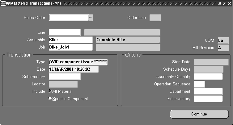

You can push (issue) and pull (backflush) components items onto jobs and repetitive schedules. A component's supply type determines how it is supplied. See: Supply Types, Backflush Transactions, and Component Issues and Returns.
You can replenish depleted supply subinventory stores. This ensures that materials are available for backflush transactions. See: Supply Subinventory and Locator Replenishment.

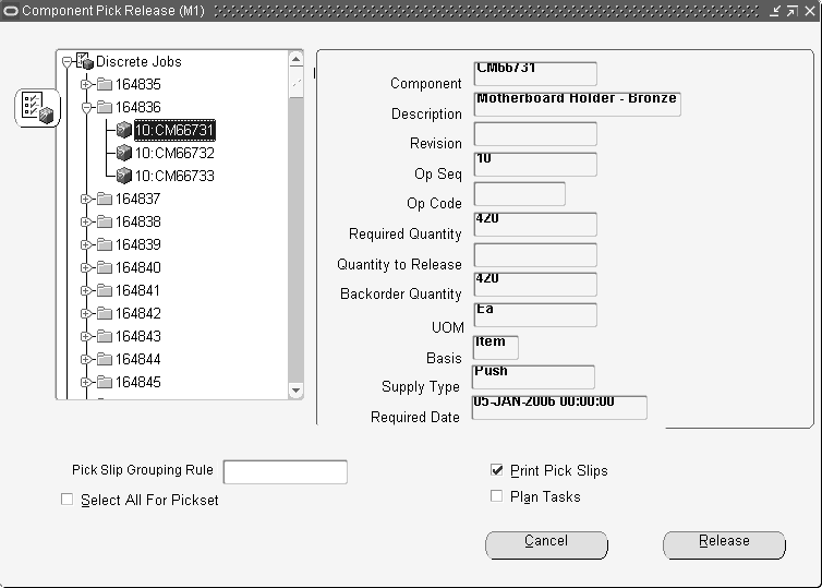

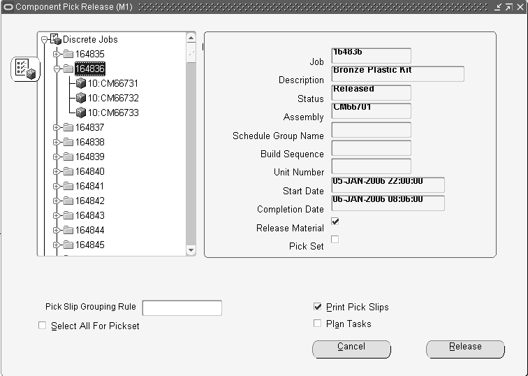

You can select component requirements to issue to jobs and schedules on the Component Pick Release window. This window generates move orders. You can select items for discrete jobs, lot based jobs, repetitive schedules, and flow schedules. Each manufacturing mode has a distinct and individual window. You can also use a rules based system to determine a recommended source location for each component. See: Component Picking
Material transactions are reversible. You can return components that have been issued to jobs and schedules back to inventory. You can also return completed assemblies from inventory to jobs and schedules. See: Component Issues and Returns and Assembly Completions and Returns.
You can choose how to process material transactions using WIP transaction processing profile options. For most transactions, the available options are on-line, concurrent, and background processing. See: Profile Option Descriptions.
You can load work in process material transaction information from external systems - such as bar code readers and other data collection devices - into the Inventory Transaction Interface. When this data is processed, it is validated, and invalid records are marked so that you can correct and resubmit them.

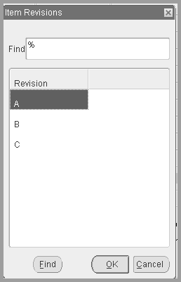

Complete revision control is provided. You can define item revisions in either Oracle Inventory, Oracle Bills of Material, or Oracle Engineering—and build open, released, scheduled, and implemented revisions. You can specify a bill of material revision for an assembly when performing a completion or return transaction, providing the option to complete a particular revision of revision controlled assemblies. See: Item and Routing Revisions, Oracle Bills of Material User's Guide, and Specifying Revision at Completion

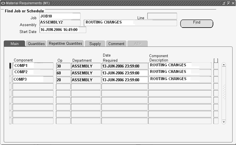

If adding a component, select the Operation Sequence number. See: Overview of Routings, Oracle Bills of Material User's Guide and Creating a Routing, Oracle Bills of Material User's Guide.
You can only add components at existing operations. The operation sequence identifies where the material is required.
If you add a requirement to a job or schedule without a routing, the system displays 1 as the default operation sequence. This value cannot be updated.
For jobs with routings, the system displays the start date of the operation as the default. For repetitive schedules with routings, the system displays the first unit start date of the operation as the default. You can update the date required with a date that lies between the start and completion dates of the operation.
For jobs and schedules without routings, the systems displays the scheduled start date of the job or the first unit start date of the schedule as the default. You can update the date required with a date and time that lies between the start date and time and completion date and time of the job or schedule.

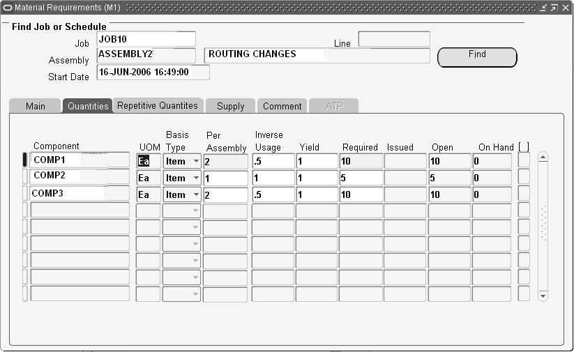

In the Quantities tabbed region, the default Basis Type of the component displays from the bill of material. This field is used for calculating component requirements. You can change this value, your choices are:
Item: Usage quantity is the amount required per job or schedule, and multiplied by the job quantity.
Lot: Usage quantity is taken directly from the bill of material and not multiplied by job quantity, component usage is fixed per lot. See: Fixed Component Usage
Enter the Per Assembly Quantity, or the Required Quantity for the component.
Required Quantity field is calculated based on basis type.
If you are adding a component, the per assembly quantity defaults to 1 and the required quantity is derived from the job or schedule quantity and displayed in the component's primary UOM. It can be updated. If you update the per assembly quantity, the required quantity is automatically calculated. Conversely if you update the required quantity, the per assembly quantity calculated. You can enter a decimal value, such as 1.25, for both the per assembly and the required quantity. You can also enter a required or per assembly quantity of zero.
The Inverse Usage and Yield fields are used in cases where decimal quantities may inflate requirements or cause variances in rounding calculations. The Inverse Usage and Yield fields default to the value of 1. You can edit these fields to fit your manufacturing requirements. See: Component Yield and Shrinkage and Inverse Component Usage

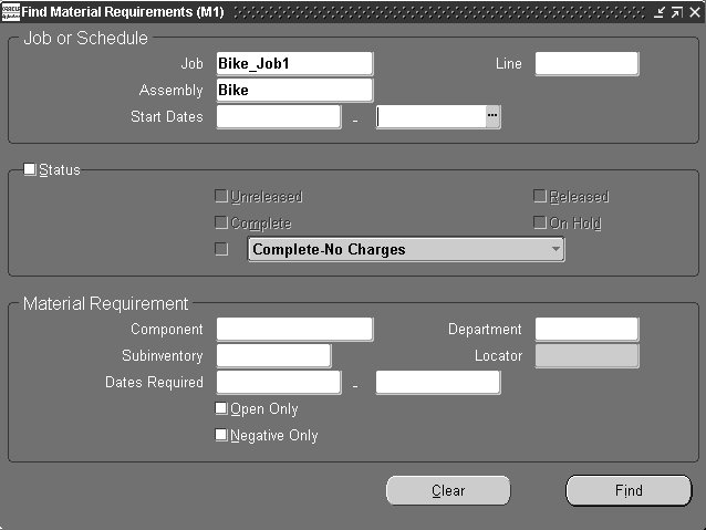

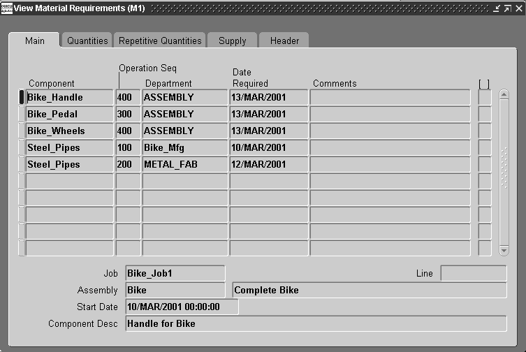

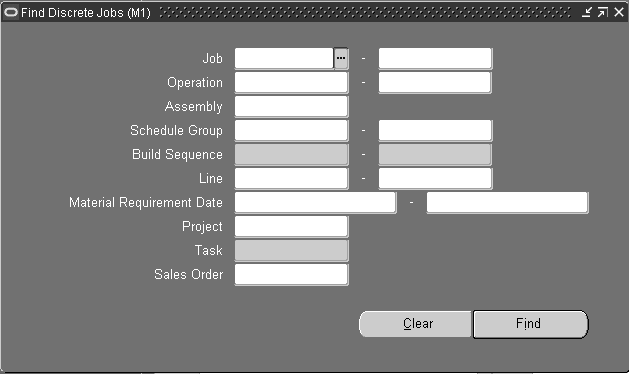

You can view material requirements for individual discrete jobs and repetitive schedules using the View Material Requirements window. You can also view material requirements across jobs and schedules using this window.
To find and view material requirements
Navigate to the View Material Requirements window. The Find Material Requirements window appears.
You can view requirements for jobs and schedules of a specific status (Unreleased, Complete, Released, On Hold, Complete-No Charges). You can view all requirements for a specific component or all components required from a specific subinventory/locator. You can also view components required on a specific date or within a range of dates. Lastly you can view open or negative requirements.
Enter any combination of search criteria and choose the Find button. The results display in the View Material Requirements window.
You can view the following information in View Material Requirements window's tabbed regions:
Main: Component, Operation Sequence, Department, Date Required, Comments
Note: You can view Component Descriptions using the Material Requirements window. See: Adding and Updating Material Requirements
Quantities: Component, UOM, Per Assembly, Basis Type, Inverse Usage, Yield, Required, Issued, Open, and On Hand
Repetitive Quantities: Component, UOM, Per Assembly, Required Today, Issued Today, Ahead or Behind Quantities, Days
Supply: Component, (Supply) Type, Subinventory, Locator, and MRP Net flag
Header: Component, Job, Line, Assembly, and Status
ATP: ATP Allowed flag and ATP Rule

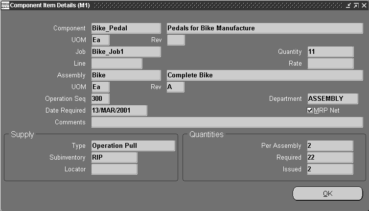

You can view job and repetitive schedule component requirements by choosing the Components button from the Discrete Jobs, Simulate Discrete Jobs, View Discrete Jobs, Close Discrete Jobs, Purge Discrete Jobs, Repetitive Schedules, View Repetitive Schedules, and Purge Repetitive Schedule windows. You can also view component requirements for a specific job or repetitive schedule operation by choosing the Operations then the Components button from any of these windows. From the Discrete Jobs, Simulate Discrete Jobs, and View Discrete Jobs windows, you can optionally view ATP component information.
Note: Oracle Work in Process does not support Enforce Integer Rounding.
To view component requirements for the current job, schedule or operation
After choosing the Components button, the Material Requirements window (in view only mode) appears. You can then view detailed information about components in the window's tabbed regions. You can view material requirements across jobs and schedules using the View Material Requirements window. See: Viewing Material Requirements.
Main: Component, Operation Sequence, Department, Date Required, Component Description.
Quantities: Component, UOM, Basis Type, Per Assembly, Inverse Usage, Yield, Required, Issued, Open, and On Hand.
Repetitive Quantities: Component, Per Assembly, Required Today, Issued Today, Ahead or Behind Quantity, Days.
Supply: Component, (Supply) Type, Subinventory, Locator, and MRP Net flag.
Comment: Component, comment
ATP: Component, ATP Allowed flag and ATP Rule
Note: This region is accessible only if you are viewing material requirements using a window that allows ATP checking the Material Requirements window, the Check ATP button is enabled only if you have accessed this window from a window that allows ATP checking.
To view component ATP for jobs and repetitive schedules
If the Check ATP button is enabled in the Material Requirements window, you can check the ATP status of components. See: Viewing Component ATP Information.
Note: The Check ATP button is only enabled if you choose the Components button from the Discrete Jobs, Simulate Discrete Jobs, View Discrete Jobs, or View Repetitive Schedules window, or if you choose the Operations button, then the Components button from any of these windows.
You can only check the ATP status of the components that have their ATP Allowed flag set. This flag is automatically set if the Check ATP attribute for that item is set. See: Defining Items, Oracle Inventory User's Guide and Order Management Attribute Group, Oracle Inventory User's Guide.
You can view the ATP status of several component records at one time by choosing multiple records. If you choose Select All from the Edit menu, only those components that have their ATP Allowed flag set are highlighted. If you specifically select components that do not have this flag set, you are warned that the components that you have selected are not Check ATP enabled. You must deselect these components before proceeding. .

Component picking, obtaining requirements for specific jobs and schedules, is the process of moving items from source locations and issuing them to work orders. You can use a rules based system to determine a recommended source location for each issued component item specified on the bill of material. The features for component picking include:
The Component Pick Release window is used to select requirements and create move orders for discrete jobs, lot based jobs, repetitive schedules, and flow schedules.
Move orders are created for picked items. Move orders are requests for the movement of material within an organization. They enable the replenishment of material within a warehouse or manufacturing shop floor.
There is a distinct and individual window for the manufacturing mode selected.
The source for material picked is based on Oracle Inventory allocation rules entered on the Picking Rules window. Or, if Oracle Warehouse Management is installed, rules based picking recommendations.
Rules based picking uses the Warehouse Management Rules engine. This employs user defined rules to recommend locations to pick from, specific items to pick, and item revision.
Pick methodologies, or grouping rules, control how pick tasks are grouped to individual picking. All grouping rules, available during picking for shipment against a sales order, are supported for component picking. These grouping rules include order pick, bulk pick, cluster pick, and user defined grouping rules.
The destination for picked material depends on the supply type. It can be a staging area, or directly to a job or schedule.
You have the option to release picking tasks at the time of the pick release. Or you can choose another time to release. See: Component Pick Release Submit Requests Program
You can link a supply subinventory to a machine resource. Defining this subinventory to a resource enables backflush components required on operations to have the specified subinventory as their supply subinventory.
You can issue a quantity of a component greater than the total quantity allocated during previous runs of pick releases.
Material requirement and move order changes are synchronized to account for changes in job status, job or component quantities, component deletions, assembly scrap, supply type, and location. Corresponding material handling related events include changes to picking instructions, warning messages, or move order line cancellations.

The Component Pick window is a graphical workbench that consists of two panes:
The left pane is a navigation tree hierarchy containing three nodes. You can expand items on the navigation tree by left-clicking the plus sign (+) with your mouse to select a node detail. The associated fields display below the node.
The first node displays Discrete Jobs, Repetitive Schedules, Flow Schedules, or Lot Based Jobs-depending on the application you are using.
The right pane displays field information associated with the applicable records meeting your search criteria.
The initial view, or if you select the top job or schedule node, is a summary window. This displays rows with fields associated with the jobs or schedules meeting your search criteria.
You can display a detail window by selecting a record on the hierarchy tree.

To query jobs or schedules for component picking
Navigate to the Component Pick Release window.
The Find window displays fields pertaining to the specific job or schedule type. Select query criteria. You can combine or omit criteria as required.
Discrete Jobs: You can query by range of jobs, operations, schedule groups, build sequences, lines, and material requirement dates. If you are using Oracle Projects or Project Manufacturing, you can search by project number and task number. You can also search using assembly number and sales order information. See: Defining Discrete Jobs Manually,
For discrete jobs only, you have the option to pick by a operation sequence range in a single job - or across multiple jobs. All components in the operation sequence range selected are displayed on the Component Pick Release window. This feature is valuable in manufacturing environments where pick releases based on the timing of operations is not feasible, because operation start times are unpredictable.
The Material Requirement Date field is used to search requirements based on a range of Date Requirement values entered on the Material Requirements window.
Note: The Material Requirements Date limits the date components are picked. For example, if you set this date for July 1, and you have requirements for June 1 and August 1 - the system will not consider the August 1 requirements. Set this date to consider material requirements and lead times.

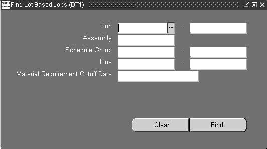

Lot Based Jobs: You can query by Job name, Assembly, Schedule Group, and production Line. See: Creating a Lot Based Job in the Shop Floor Management User's Guide.
The Material Requirement Cutoff Date field is used to search for component records. The Date Requirement value entered on the Material Requirements window is used as the basis.
Note: The material requirements cutoff date limits the date components are picked. For example, if you set this date for July 1, and you have requirements for June 1 and August 1 - the system will not consider the August 1 requirements. Set this date to consider material requirements and lead times.
Repetitive Schedules: You can query by Assembly, production Line, and Material Requirement Cutoff Date. See: Overview of Creating Repetitive Schedules
The Days of Supply value is multiplied by the daily production rate and component quantity per assembly to calculate the pick quantity. If the open quantity is less than the value entered here, the open quantity is used instead.
Flow Schedules: You can query by flow Line, Schedule Group, Build Sequence, or Sales Order. If you are using Oracle Projects or Project Manufacturing, you can search by Project Number and Task Number. See: Line Scheduling Workbench Options Window, Oracle Flow Manufacturing User's Guide
Choose Find to display the Component Pick Release window.

When you navigate to the Component Pick Release window, a Find window initially displays with the criteria for the job or schedule type you select.
To select and pick items for component picking
Choose your search criteria on the Find window. See: Using the Find Window for Component Picking
The Component Pick Release window displays in the summary view. Fields display applicable to the job or schedule type you choose. The Summary window is enabled as a folder form window. This gives you control of the columns displayed so you can view the information significant to you. See:
Customizing the Presentation of Data, Oracle E-Business Suite User's Guide
Creating Lot Based Jobs in Shop Floor Management
The Include in Release check box defaults as marked for all the records. Uncheck records you do not want to release, or clear a record from the Edit menu.
For the discrete manufacturing mode, the Pickset feature enables you to create move orders only when all the components can be allocated. If there is insufficient quantity for any component, then no components for that job are pick released. The Pickset check box is in both the summary and detail windows.
Note: For the Flow manufacturing mode, this feature is always enforced so there is not check box feature displayed.
The Pick Slip Grouping Rule field displays the organizational default selected on the Work in Process Parameters window. You can select another value for this pick release.
The grouping rule is used to group tasks based on the pick method. For example, if you select the Bulk Picking rule, all pick tasks for the same component item- across multiple work orders and operations - are picked. Rules are defined on the Pick Slip Grouping Rules window in Oracle Inventory. See: Pick Slip Grouping Rules, Oracle Inventory User's Guide
The Select All For Pickset box enables you to select, or deselect all Pickset check boxes.
The Print Pick Slips box is used to indicate if you want to print the Move Order Pick Slip Report, in Oracle Inventory as part of this component pick release. Check this box to enable printing, or deselect the box to disable it.
If you are using an Oracle Warehouse Management enabled organization, the Plan Tasks box displays the default on the Work in Process Parameters window. You can change this value.
This flag provides the option to plan tasks automatically or manually at the time of pick release.
If this check box is enabled, the system creates pick tasks in an Unreleased status. This option is used if you want to create the allocations, but postpone the dispatching. You can later choose the time to release the task. See: Component Pick Release Submit Requests Program
If this check box is not checked, tasks are created in a Pending status and are immediately eligible for dispatching.
To display detail windows of one of the records-expand the job or schedule node in the navigation tree, and select a record. Select the job or schedule to display the summary window.
The information on this window includes Job number, Description, Status, Assembly, Schedule Group Name, Build Sequence, Unit Number, job dates, Release Material flag, and Pick Set.
Select a component to display detail information on this item.
The detail window displays fields for Component, Description, Revision, Operation Sequence, Operation Code, Required Quantity, Quantity to Release, Back Order Quantity, Basis, Supply Type, and Required Date.
Note: The Revision field is null unless you are using Inventory allocation rules, or Warehouse Management rules based picking to choose previous revisions.
Choose Release to perform the pick release process.
All jobs or schedules displayed in the tree are released. Move orders are generated for ecords where the Include in Release check box is unchecked.
Records are cleared using the Edit menu.
All records on the tree are released regardless of whether you choose Release from the summary or detail window. When the transaction is complete, the pane is displayed as blank.
Choose Cancel to end this transaction. Records are not updated, and the Find window displays again.

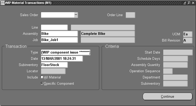

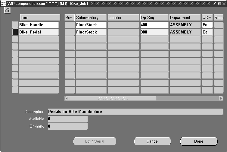

You can issue components from inventory to jobs and repetitive schedules and return issued components from jobs and schedules to inventory using the WIP Material Transactions window. There are two issue and return options available from this window: All Material and Specific Component.
You can issue and return both push and pull components. You can 'push' components from inventory to specific job and repetitive schedule operations. A component's supply type determines how it is supplied to a job or schedule. See: Supply Types.
You can issue components to satisfy negative job and schedule requirements. When you issue negative requirement components, the components are returned from the job or schedule to inventory.
You can reverse negative component issues with negative component returns. When you return components that have negative requirements, the components are issued from inventory to the job or repetitive schedule. See: WIP Material Transaction Types.
You can set the Allow Negative Balances Parameter in Oracle Inventory so that the inventory balances of items can be driven negative. If this parameter is set, a warning message is displayed to notify you that balances are about to be driven negative. You can continue with the transaction or stop it and fix the condition.
You can issue partial requirement quantities. You can also over-issue requirements. Material that is required, but not issued, is considered an open requirement.

You can issue and return component items that are under revision control. The system always defaults the component revision to the current revision as of the transaction date. You can select a different revision. See: Item and Routing Revisions, Oracle Bills of Material User's Guide

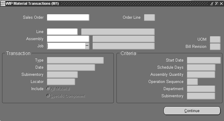

You can use the Specific Component option to issue and return components of any supply type to and from jobs and schedules. If the job or schedule has a routing, components can be issued and returned to any operation.
You can use the Specific Component option to issue and return components that are not required on the work in process bills of jobs and schedules. These ad hoc material requirements are created with a required quantity of 0.
Prerequisites
To select sales orders, discrete jobs, or repetitive schedules
Navigate to the WIP Material Transactions window.
Select a Sales Order, repetitive Line and Assembly, Assembly, or Job. The cursor defaults to one of these fields based on how the TP:WIP:Material Transactions First Field profile option is set. See: Profile Options.
You can only select a discrete job or a repetitive line and assembly for a repetitive schedule if the job or schedule has a status of Released or Complete.
To define issue or return transaction header information
In the Transaction region, select the transaction Type: WIP component issue, WIP component return, WIP negative component issue, or WIP negative component return. See: WIP Material Transaction Types.
Enter the transaction Date and time.
The date and time must fall within an open accounting period and cannot be greater than the current date or less than the release date of the job or the earliest valid repetitive schedule.
Optionally, select a default supply Subinventory and, if required by the supply subinventory, the supply Locator. See: Supply Subinventory and Locator Fields, Oracle Bills of Material User's Guide.
If a supply subinventory/locator is entered here, it is used in the transaction detail window as the default for those components that do not have a supply subinventory/locator defined at the component or item level.
If the Oracle Inventory INV:Allow Expense to Asset Transfer profile option is set to Yes, you can select an expense subinventory. See: Inventory Profile Options, Oracle Inventory User's Guide.
Choose the Include Specific Component option.
Note: You cannot enter transaction criteria when issuing or returning specific components.
Choose the Continue button.
Depending on the transaction type selected, the transaction detail folder window (WIP component issue, WIP component return, WIP negative component issue, or WIP negative component return) appears. See: Customizing the Presentation of Data in a Folder, Oracle E-Business Suite User's Guide.
To transact or add and transact `ad hoc' component requirements
In transaction detail folder window (WIP component issue, WIP component return, WIP negative component issue, or WIP negative component return), select the component Item.
You can select Push, Assembly Pull, Operation Pull, Bulk, Supplier and Phantom supply type items. You can select lot, serial, or lot and serial controlled items. You can select components that are required by a job or schedule even though they are not automatically displayed.
If the component is under revision control, select the component's Revision. See: Item and Routing Revisions, Oracle Bills of Material User's Guide.
The item's current revision is defaulted.
Select the supply Subinventory and, if required by the subinventory, the supply Locator. See: Supply Subinventory and Locator Fields, Oracle Bills of Material User's Guide.
If the component does not have an assigned subinventory/locator, the subinventory/locator entered in the WIP Material Transaction window is defaulted. It can be overwritten.
If the job or schedule has a routing, select the Operation Sequence.
If no routing exists, the operation sequence defaults to 1.
Note: Do not assign Assembly Pull items to operations that are non-count point/autocharge operations. This can result in over-issues at the operation if you do not transact all assemblies that you are completing through the operation.
Select the UOM. See: Overview of Units of Measure, Oracle Inventory User's Guide.
Enter the transaction Quantity.
You can enter any nonzero quantity including a quantity that result in an over-issue or over-return of a job or schedule's components requirements.
Optionally, select the transaction Reason code. See: Defining Transaction Reasons, Oracle Inventory User's Guide.
Optionally, enter the transaction Reference.
References can be used to identify transactions on standard reports. They can be up to 240 characters of alpha numeric text.
If the component is under lot, serial, or lot and serial control, choose the Lot/Serial button. See: Assigning Lot Numbers, Oracle Inventory User's Guide and Assigning Serial Numbers, Oracle Inventory User's Guide.
Choose the Done button to save your work.

You can use the All Material option to issue and return Push supply type components to discrete jobs and repetitive schedules. You can only issue and return Push components that already exist on the work in process bill or routing however.
Prerequisites
To select a sales order, discrete job, or repetitive schedule
To define issue or return transaction header information for discrete jobs
In the Transaction region, select the transaction type: WIP component issue, WIP component return, WIP negative component issue, or WIP negative component return. See: WIP Material Transaction Types.
The date and time must fall within an open accounting period and cannot be greater than the current date or less than the release date of the job.
The supply subinventory/locator is optional. If it is entered here, it is used as the default in the transaction detail window for those components that do not have a supply subinventory/locator defined at the component or item level.
Choose the Include All Material option.
In the Criteria region, optionally enter any criteria or combination of criteria that is valid for the job: Assembly Quantity, Operation Sequence, or Department.
Assembly Quantity: If you enter an assembly quantity, it must be less than or equal to the job quantity. If the job has a routing and you do not enter an assembly quantity, required component quantities - original required quantity minus component quantities already issued - for all push components are calculated and displayed as defaults in the transaction detail folder window. You can change these defaulted quantities.
Operation Sequence: If the job has a routing, you can issue push components to or return push components from a specific operation.
If the job does not have a routing and you do not enter an assembly quantity, required component quantities are not automatically displayed in the transaction detail folder window.
Department: If the job has a routing, you can issue push components to or return push components from a specific department.
Supply Subinventory: If you select a supply Subinventory, only those components that have the same default supply Subinventory are displayed in the transaction detail folder window. This is convenient when assembly components have different subinventories and these subinventories are controlled by different users.
Note: You can optionally use the 'All Material' option to add push components to the work in process bill. However, you can only add requirements that already exist on that bill. Conversely, you can return only components that already exist on the work in process bill when you return components.

To display details for components being added or issued
From the transaction detail folder window (WIP component issue, WIP component return, WIP negative component issue, or WIP negative component return), select or add the component Item
If you are adding a component, enter the transaction quantity. .
You cannot view component item details until you enter a quantity.
Choose Component Item Details from the Tools menu. .
The Component Item Details window appears displaying complete information about the component in a single record format.

Generate the Discrete Job Pick List report for pull components. This report identifies material requirements, subinventories and locators with available inventory, and supply subinventories and locators where you backflush from. You would then pick the components using the pick list and transfer them into the appropriate supply subinventories and locators. Repetitive replenishment works the same way except you would replenish for an assembly for a number of days instead of for a job.
You can also use the Component Pick Release window to select material using rules based picking. See: Using the Component Pick Release Window

To select a sales order, discrete job, or repetitive schedule to replenish
Select a Sales Order, repetitive Line and Assembly, Assembly, or Job. The cursor defaults to one of these fields based on how the TP:WIP:Material Transactions First Field profile option is set. See: Profile Option Descriptions.
To define replenishment transaction header information
In the Transaction region, selectBackflush Transfer as the transaction Type.
Enter a transaction Date and time.
Select the Subinventory and, if required by the subinventory, the Locator.
This subinventory/locator becomes the default replenish from subinventory/locator in the Backflush Transfer window.
Choose Continue. The Backflush Transfer window displays. See: Customizing the Presentation of Data in a Folder, Oracle E-Business Suite User's Guide.
To replenish component supply subinventories and locators
Select the component item.
Assembly pull and operation pull components requirements that cannot be fulfilled from their default supply subinventories/locators are automatically displayed.
Note: To determine where on-hand inventories exist see: Viewing On-hand Quantities, Oracle Inventory User's Guide.
If the component is under revision control, select the Revision. See: Item and Routing Revisions, Oracle Bills of Material User's Guide.
The current revision for the item is displayed as the default.
Select the Subinventory and, if required by the subinventory, the Locator from which to transfer replenishment quantities.
The supply subinventory/locator selected in the WIP Material Transactions window is defaulted but can be overridden.
Select the replenish To Subinventory and, if required by the subinventory, the To Locator.
If defined, the component's default supply subinventory/locator is defaulted but can be overridden. See: Supply Subinventory and Locator Fields, Oracle Bills of Material User's Guide.
Enter the replenishment Quantity.
The component's open requirement quantity is displayed. You can enter a quantity greater or less than this quantity.
Optionally, select the transaction Reason code. See: Defining Transaction Reasons, Oracle Inventory User's .
If the component that is being transferred is under lot, serial, or lot and serial control, choose the Lot/Serial button. See: Assigning Lot Numbers, Oracle Inventory User's Guide and Assigning Serial Numbers, Oracle Inventory User's Guide.

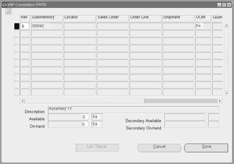

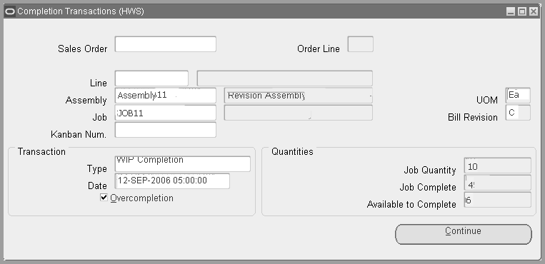

Select the WIP assembly completion Transaction Type. See: Completion Transaction Types.
Choose the Transact button. The WIP assembly completion transaction detail window appears.
In the WIP assembly completion transaction detail window, select the replenish to Subinventory and, if required by the subinventory, the Locator. See: Completion Subinventory and Locator Fields, Oracle Bills of Material User's Guide.
The completion subinventory must be the supply subinventory for the assembly on the next level bill of material. See: Supply Subinventory and Locator Fields, Oracle Bills of Material User's Guide.
If the Oracle Inventory INV:Allow Expense to Asset Transfer profile option is set to Yes, you can select an expense subinventory. See: Inventory Profile Options, Oracle Inventory User's Guid.
Enter the completion Quantity.
The quantity should be in the UOM you are transacting. You can receive partial quantities to different subinventories or locators.
If the assembly is under lot, serial, or lot and serial control, choose the Lot/Serial button. See: Assigning Lot Numbers, Oracle Inventory User's Guide and Assigning Serial Numbers, Oracle Inventory User's Guide.

When you complete or return assemblies under revision control, the system defaults the current revision. You can specify another bill of material revision for an assembly when performing these transactions, providing the option to complete a particular revision. In cases for specific revision on serial controlled assemblies, you can associate the correct revision with the serial number. This may be appropriate in situations when a serialized assembly is returned to inventory, and the revisions associated with the assembly is older than the current effective revision.
Note: This functionality is not supported for Express move completion transactions, or simultaneous completion and scrap, or completion and reject transactions.
The Revision field default is derived using the following logic:
Completions
Standard Discrete Job: Highest current revision of assembly.
Non-Standard Discrete Job
Latest issued revision of the assembly.
If latest issued revision not available, default the highest current revision of assembly.
Returns
Latest completed revision of the assembly.
If latest completed revision not available, default the highest current revision of assembly

To define complete transaction header information
Navigate to the Completion Transactions window.
Select applicable values for Sales Order, Line, Assembly, Job, or Kanban Number.
Note: The cursor defaults to one of these fields based on how the TP:WIP:Completion Transactions First Field profile option is set. See: Profile Option Descriptions.
You can reserve over-completion quantities from jobs linked to sales orders. The sales order number must be entered to reserve the excess quantity. See: Linking Sales Orders and Discrete Jobs.
In the Transaction region, select the WIP Assembly Completion or WIP Assembly Return Transaction Type. See: Completion Transaction Types.
The date and time must fall within an open accounting period and cannot be greater than the current date or less than the release date of the job or schedule.
If you are over-completing the assembly quantity, select the Overcompletion check box. If the transaction type is WIP Assembly Return, however, the check box will be disabled.
The Quantities regions displays Job Quantity, Job Complete, and Available to Complete values.
Choose the Continue button to navigate to the WIP Assembly Completion or WIP Assembly Return window.
To complete or return assemblies
If this assembly is under revision control, you can select a different bill of material revision than the current revision. Place your cursor in the Revision field to display the Item Revisions window. See: Specifying Revision at Completion
Choose the revision number you want to complete or return, and select OK.
In the WIP Assembly Completion or WIP Assembly Return window, select the Subinventory and, if required by the subinventory, the Locator.
Assemblies are completed into or returned into or from this subinventory and locator. The completion subinventory and locator you specified for the job or the repetitive line/assembly association is defaulted but can be overwritten. See: Completion Subinventory and Locator Fields, Oracle Bills of Material User's Guide.
Enter the completion or return Quantity.
The quantity should be in the UOM you are transacting. You can complete or return partial job or schedule quantities to different subinventories and locators. You can over-complete from jobs and schedules, whether or not they have a routing. You can complete or return partial job or schedule quantities to different subinventories and locators.
If you are completing a serial controlled assembly, you can only enter a quantity that is an integer when expressed in the primary unit of measure. For example, you can complete 0.5 dozen (DZ) if the primary unit of measure is each (EA).
Choose the Final Complete check box.
If your current organization is an average costing organization, the Final Complete check box is displayed.
The value of the Final Completion option (enabled/disabled) is defaulted based on how the WIP Autocompute Final Completions parameter is set. Using the default eliminates the need to manually choose the option. Final completions ensure that no residual balance is left in the job after the last assembly has been completed. Residual balances are handled as discussed below under WIP Job Closures.
If you are completing assemblies under lot, serial, or lot and serial control, choose the Lot/Serial button. See: Assigning Lot Numbers, Oracle Inventory User's Guide and Assigning Serial Numbers, Oracle Inventory User's Guide.
