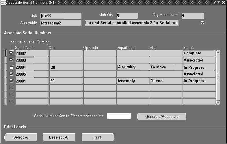

You can track your jobs using serial control throughout the manufacturing process. This enables you to assign, perform serial transaction entry, import serial numbers, and print serial number labels. This functionality is supported through Oracle Mobile Supply Chain Applications. See: Serial Number Tracking Throughout Manufacturing

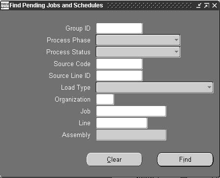

You can import planned order and planned order update recommendations for discrete jobs from external systems into Work in Process. See: Work Order Interface, Oracle Integration Repository at http://irep.oracle.com

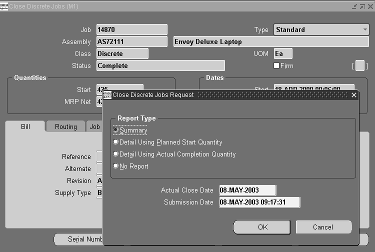

You can close several standard and non-standard discrete jobs simultaneously. You can also close individual discrete jobs. See: Overview of Discrete Job Close.

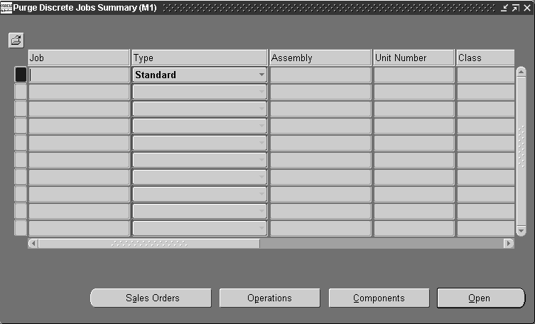

You can purge all information associated with discrete jobs including job header records and job detail and transaction information. You can also selectively purge some or all of the following job related information: job details (material requirements, resource requirements, and operations), ATO configurations, move transactions, and resource cost transactions.

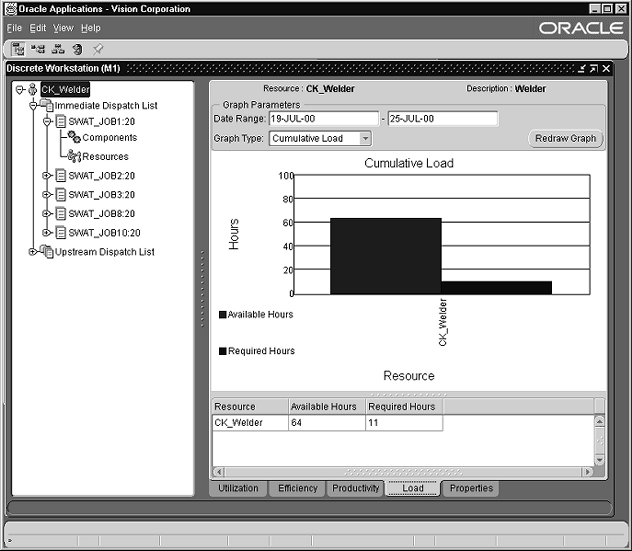

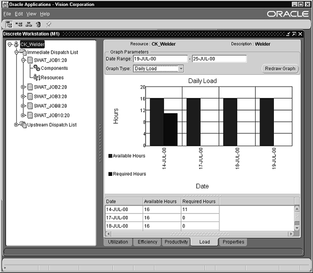

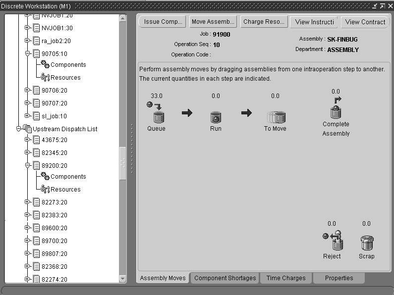

The Discrete Workstation provides you with a single window to obtain critical production information and perform common shop floor transactions. The workstation displays information by department or for a resource, and it lists all of the job operations for immediate and future dispatch at that department or resource.
You can view broad information, such as the utilization, efficiency, productivity, and load on the resources within a department or on a specific resource across all departments. You also can obtain detailed component and resource information on each individual job scheduled for the department or resource. You can perform move, completion, and other common transactions directly on the workstation's tabs, or open their corresponding Work in Process windows directly from the workstation. There is also a link to Oracle Project Contracts records associated with specific jobs.
The Discrete Workstation can record and track discrete production in organizations enabled for Oracle Shop Floor Management. You can use all the capabilities of monitoring and transaction work on discrete jobs in a mixed mode organization where discrete and lot based jobs are both used.
On the Discrete Workstation, you can:
View the utilization, efficiency, productivity, and load on the resource from all departments in table and graph format
View all of the jobs for immediate and future dispatch at the selected resource, including their components and resources
Complete assemblies and operations, and move quantities across more than one operation in a routing

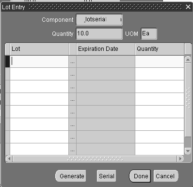

Backflush lot and serial items
Scrap assemblies
Launch the workstation for a specific resource instance, and view dispatch lists by individual machine or person

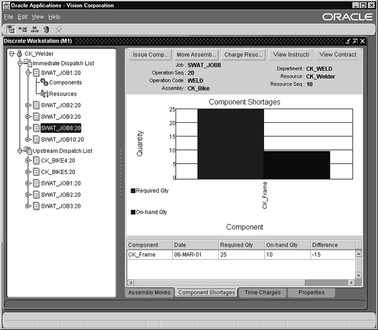

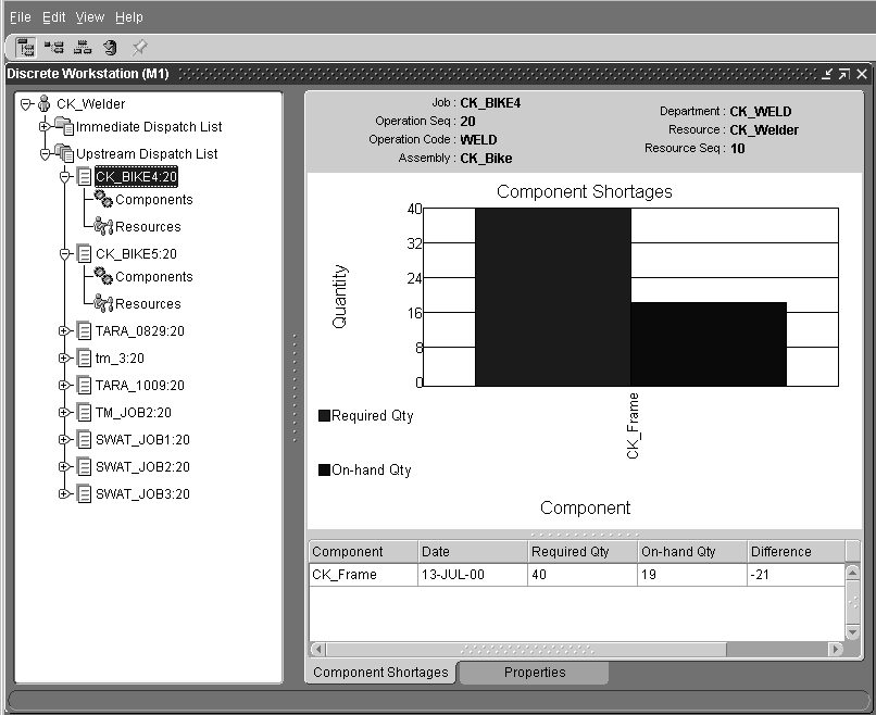

View job component shortages
View resource properties
View project contract information linked to specific jobs
Open the Material Transactions window and Issue components to jobs
Open the Work in Process Move Transactions window and perform Move transactions
Open the Work in Process Resource Transactions window and manually charge resources to jobs
Collect quality results data during move and completion transactions
Obtain operating instructions, diagrams, component attachments, and other information previously attached to jobs, assemblies, and components
Note: Use profile option, WIP: Display Scrap and Reject Quantity in Discrete Workstation, to display jobs with quantities remaining only in the Scrap or Reject intraoperation step on the Discrete Workstation. If there is no quantity remaining in the Queue, Run and To Move steps, but there is a quantity in the Reject or Scrap —the work order will not appear unless this profile option is set to Yes.
For an overview of the workstation and its branches and tabs, and for information on how to perform common transactions from the workstation, see the following topics:

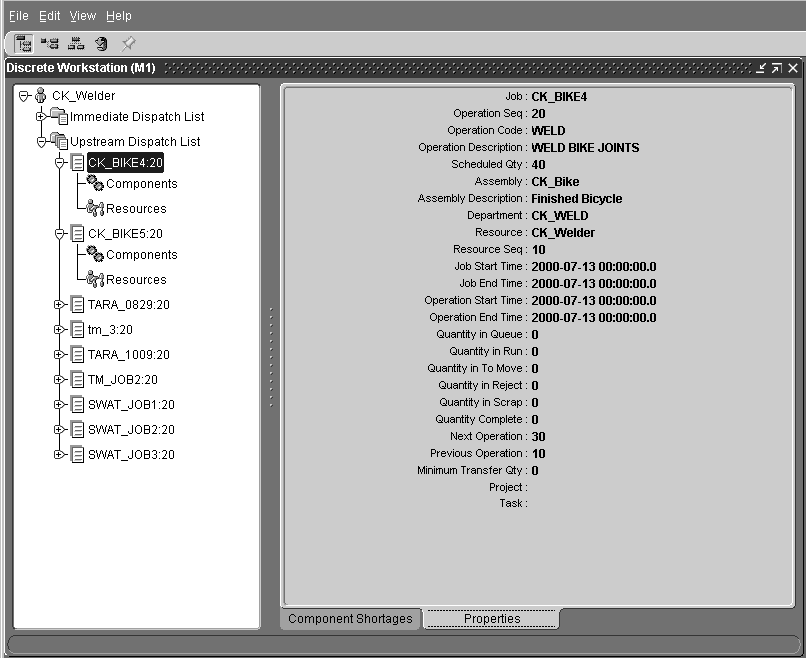

The Discrete Workstation window is composed of two panes. The left pane displays the navigational tree. The right pane displays one or more tabs of detailed information that correspond to the branch or tab that you select from the tree.
The workstation's left pane contains its navigational structure, which displays a hierarchical listing of the workstation contents. Since its structure is analogous to a tree with branches, it is referred to as the workstation tree, The tree displays four branches or levels of information. When you select a branch (the branch is highlighted), information relevant to that branch is displayed on tabs in the right pane of the workstation. See: Discrete Workstation Tree and Tabs for detailed information on each of the workstation branches and tabs.
The workstation's right pane displays one or more tabs of detailed information pertaining to the branch that you selected from the tree. The information is displayed either in tables, on lists, pictorially, or on graphs, so that you can quickly assess the status of the job. Tabs may also have buttons that enable you to:

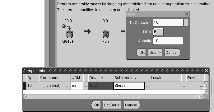

Perform common transactions directly from the tab, such as issuing components, performing assembly moves, or charging resources,
Open the WIP Material Transactions, Move Transactions, and Resource Transactions forms directly from the workstation
Obtain attachments previously appended to a job, such as drawings and instructions
The information on the tree is always current, as jobs are completed - they are automatically removed from the tree. You can update the display at any time by choosing the Refresh tool.
You can choose to view the information on the workstation tree in Vertical (the default), Interleaved (horizontal), or Org Chart (organization chart) format. These choices are available through tools on the toolbar, or as menu selections under the View menu.
To view the tree in Interleaved or Org Chart format, you may need to widen the left pane to see the full display. You can use your mouse to drag the right side of the pane towards the right side of the window, or you can hide the tabs so the window's full width can be used to display the contents of the left pane.

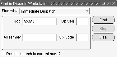

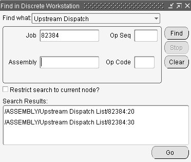

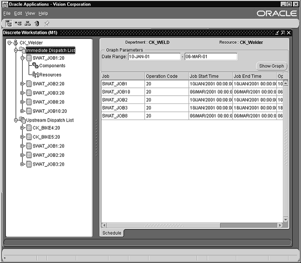

You can search for records on the tree. After entering search criteria on the Find in Discrete Workstation window, and choosing Find—a list of nodes meeting your criteria display on this window. Select a node to display that information on the workstation canvas.
To find records on the Discrete Workstation
Navigate to the Find in Discrete Workstation window.
In the Find what field, select a dispatch type: upstream or immediate.
Enter search criteria. You have the option to enter values in the Job, and corresponding Operation Sequence fields, or Assembly and corresponding Operation Code fields.
You have the option to search records in one node only. Select a note and search criteria, and check Restrict search to current node.
Choose Find. Choose Stop to end the search program while it is compiling.
A listing of nodes meeting your search criteria displays in the window.
Select a node to display that information on the workstation window.

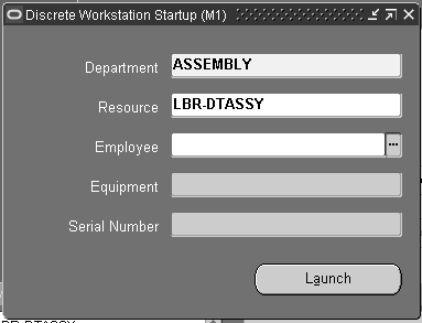

The Discrete Workstation provides you with production information on the jobs assigned to a particular department or resource. You select the department, or the department and the resource to launch the workstation for jobs to view. You can also launch the workstation for a specific instance and see dispatch lists by individual machine or person.
To launch the Discrete Workstation
Navigate to the Discrete Workstation to open the Discrete Workstation Startup window.
In the Department field, select the department to view.
To view all of the job operations scheduled in a department, select only the department
Select a Resource to view the job operations assigned to a resource associated with a specific department.
If you are using resource instances, you can select a defined Employee value for labor type resources—or an Equipment value for machine resources.
Optionally, select defined Serial Number values for machine type resources.
Choose Launch to display the Discrete Workstation.

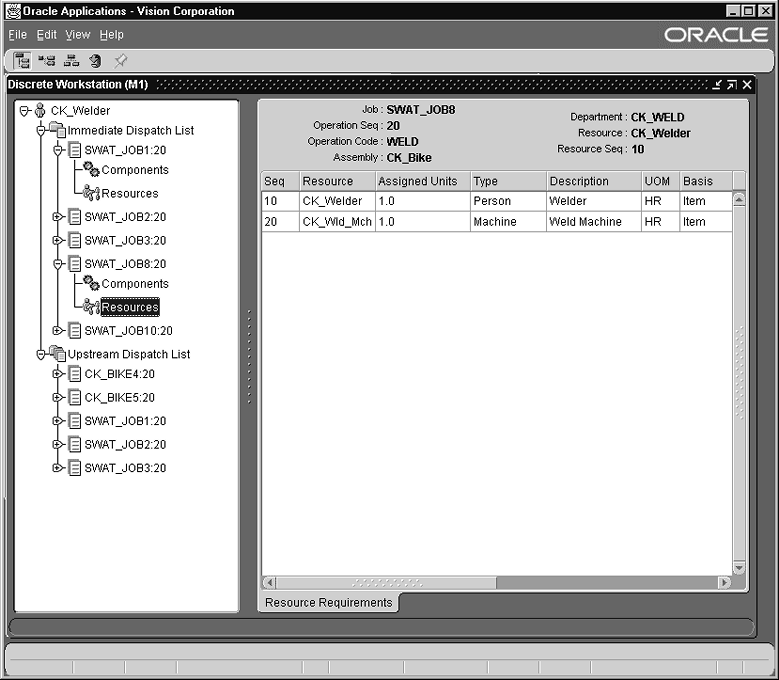

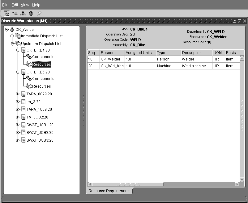

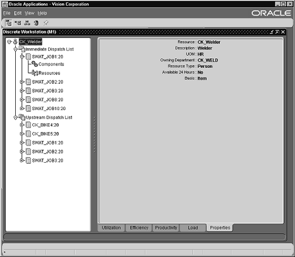

The first, topmost branch on the Discrete Workstation tree displays information for the department or the resource that you selected when you launched the workstation. Listed below it are its two main branches:
The Immediate Dispatch List branch, which displays all of the job operations that are ready to be worked on in the department or by the resource (there is a quantity of assemblies in its queue).
The Upstream Dispatch List branch, which displays all of the job operations that are to be worked on in the department or by the resource in the near future (there is a quantity of assemblies ready to be moved in the previous operation).

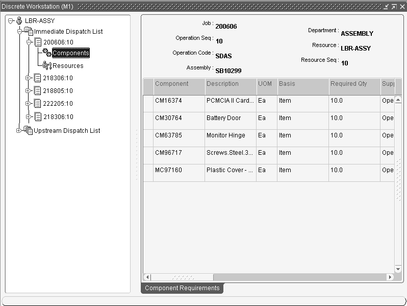

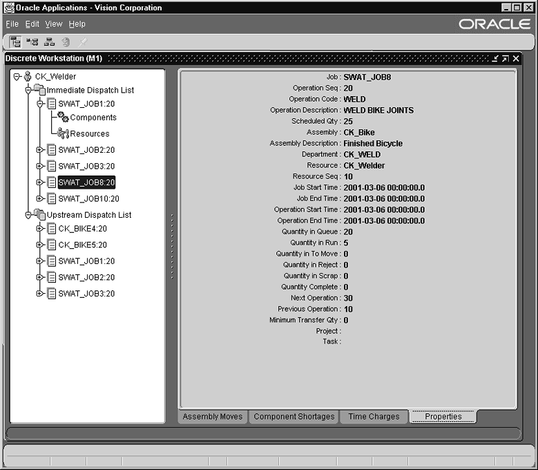

Expanding any of the individual job operation branches under either main branch displays two additional branches, the components and resources branches for that job.
The branch names displayed on the Discrete Workstation are automatically generated by the system. They contain the name of the job (which you created when you defined the job in the Discrete Jobs window), and the number of the operation, separated by a colon. For example: BIKE_Assy1:20 is the BIKE_Assy1 job at operation 20.

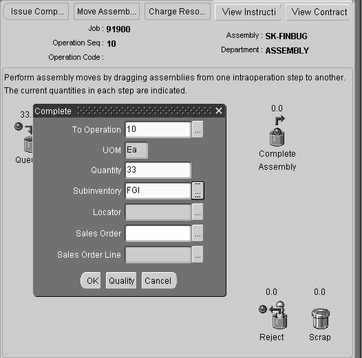

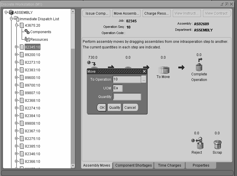

From the Discrete Workstation, you can issue components, move assemblies, complete assemblies and operations, and charge resources without having to return to the main menu. You can either perform the transactions directly on the workstation tabs, or open the appropriate Work in Process window for that transaction.
To issue components to a job from the workstation, you choose the Issue Components button, which opens the WIP Material Transactions window. All relevant job information is automatically defaulted into the window from the workstation. See: Component Issues and Returns.
During move and completion transactions, you can access the Enter Quality Results window when there are available collection plans. Choose Quality on the Move or Complete dialog box to navigate to this window.

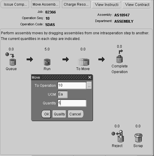

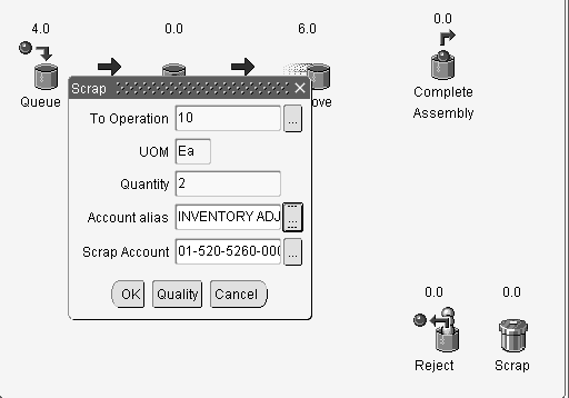

You can perform simple assembly Move transactions directly on the Assembly Move tab graphic using the mouse. The graphic displays a bucket for each intraoperation step, and uses a red ball to represent the assembly quantity. You have the option to move quantities across more than one operation in a routing. See: Moving Assemblies on the Workstation

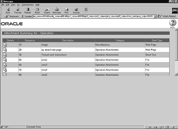

The View Instructions button is displayed on the Assembly Moves, Component Shortages, and Time Charges tabs. It enables you to download, view, and print instructions or other documents including drawings and web pages that were previously attached to the operation.
Choosing the View Instructions button opens an Oracle Web Applications page that lists the available attachments. Selecting an attachment displays it in the space below the list. To view a different attachment, choose the web page's Back button, which returns you to the list. To return to the workstation, choose the Back to Invoking Page button (appears after you select an attachment to view). See: Attaching Files to Jobs, Schedules, and Operations.

The topmost branch of the tree displays the name of either the department or the resource that you selected when you launched the workstation. Your choice affects which jobs are displayed, as described below:
If you launch the workstation by selecting a department, but do not select a resource, the workstation branches display all of the job operations scheduled to be worked on in that department. You can identify whether you are viewing information for a department or a resource by the graphic preceding the name. Department names are preceded by a graphic of a building.
If you launched the workstation by selecting a department and a resource, the workstation branches display only the job operations scheduled to be worked on at or by that resource. If you selected a person resource when you launched the workstation, the name of the resource on this branch will be preceded by a graphic of a person; machine resources are preceded by a graphic of a conveyor belt.
You can also launch the workstation using a specific instance to display dispatch lists by individual machine or person.
When you select this branch, five tabs of information are displayed in the workstation's right pane. Four of the tabs provide tables and graphs that show you the utilization, efficiency, productivity, and load of the resources within the department or on a specific resource from across all departments that use the resource. The fifth tab displays a list of the department's or resource's properties.

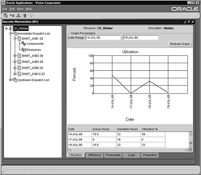

The Utilization tab displays in graph and table format, the department's or resource's daily percent utilization during the past five days (the default date range), or during a date range that you select. The top section of the tab displays the name of the department or resource and its description, and provides you with two Date fields that you can use to change the date range of the graph.
The Utilization graph displays as a percentage the hours the department or resource was actually used compared to the hours it was available to be used. It shows the daily percent utilization of the resources within the selected department, or of a particular resource across all departments, depending on whether you chose to view a department or a department/resource when you launched the workstation.
The utilization formula is: Utilization = Actual Hours / Available Hours.
The default view for the graph displays information for the last five working days, however, you can change the date range (you are restricted to dates in the past). If you change the graph dates, you use the Redraw Graph button to refresh (update) the display.
The following information on the graph is also displayed in a table below the graph:
Date: a day in the selected date range (the default date range is the last five working days)
Actual Hours: the actual hours charged
Available Hours: the hours defined in Bills of Material resource definitions
Utilization Percent (%): Actual Hours / Available Hours

The Efficiency formula is: Efficiency = Actual Hours / Standard Hours
The information from the graph is also displayed in a table below the graph:
Actual Hours: the actual hours charged to the resource
Standard Hours: the number of hours that were expected to have been charged as defined in the routing
Efficiency Percent (%): Actual Hours / Standard Hours

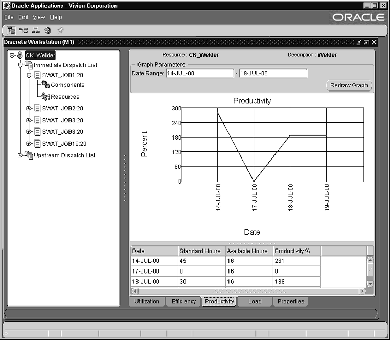

The Productivity tab displays the daily productivity of the department or resource in graph and table format. It shows the percent productivity of the resources within the selected department or of a particular resource across all departments, depending on whether you chose to view a department or a department/resource when you launched the workstation. The top section of the tab displays the name of the department or resource and its description, and provides you with two Date fields that you can use to define the date range for the graph.
The Productivity graph displays the daily percentage of hours the department or resource was expected to be used compared to the number of hours it was available to be used. The default date range for the graph is the last five working days, however you can change it (you are restricted to dates in the past). If you change the graph's dates, you must choose the Redraw Graph button to refresh (update) the display.
The Productivity formula is: Productivity = Standard Hours / Available Hours
Productivity Percent (%): Standard Hours /Available Hours
The Load Tab displays a bar graph that represents the load versus the capacity of the resource. It shows the percent load versus capacity of the resources within the selected department or of a particular resource across all departments, depending on whether you chose to view a department or a department/resource when you launched the workstation. The top section of the tab displays the name of the resource and its description, and provides you with two Date fields that you can use to define the date range for the graph.
On this tab, you can view the load on the department or resource on the two graphs, the Cumulative Load and Daily Load graphs, which you select from the Graph Type field's list of values.
The Cumulative Load graph displays the cumulative available and required hours for the department or resource across the entire date range. The default date range for the graph is the last five working days, however you can change it (you are restricted to dates in the past). If you change the date range of the graph, you use the Redraw Graph button to refresh (update) the display.
The following information from the graph is also displayed in a table below the graph:
Department or Resource: the name of the department or resource that you selected at launch
Available Hours: calculated from Bills of Material resource definitions. It represents the number of hours that can be worked during the given date range.
Required Hours: calculated from the scheduled start/end times and the usage rates. It represents the number of hours required to be worked on any scheduled jobs during the given date range.
The Daily Load graph displays the available and required hours for the resource by day. The default date range for the graph is the last five working days, however you can change it (you are restricted to dates in the past). If you change the date range of the graph, you use the Redraw Graph button to refresh (update) the display.
Required Hours: calculated from the scheduled start/end times and the usage rates. It represents the number of hours that are required for any job operations scheduled during the given date range.
The Properties tab for the department or resource provides you with the resource, description, UOM (Unit of Measure), owning department, resource type, whether or not the resource is available 24 hours, and the basis:
The Immediate Dispatch List is the first of the two main branches on the Discrete Workstation's navigation tree. When you select the Immediate Dispatch List branch itself, the Schedule tab is displayed. This tab lists all of the job operations on the tree in a table, along with their job and operation start and end times.
Listed below the Immediate Dispatch List branch are all of the current job operations that need to be worked on at the department or resource that you selected when you launched the workstation. Selecting an individual job operation branch displays the job operation's Components and Resources branches.
Each of the Immediate Dispatch List branches displays tabs of information about the job operation. Further, the tabs contain buttons that you can use to perform common transactions, and one that enables you to view attachments. All of these branches, tabs, and buttons are described in the sections that follow.
The Schedule tab lists all of the job operations on the Immediate Dispatch List and provides you with the job name, operation code, and operation start and end times. The top of the tab displays the name of the department and resource that you selected when you launched the workstation. There also are two Date fields that you can use to select a different date range for the jobs that appear on the graph (the last five working days are the default dates for the graph). If you change the default dates, you must choose the Show Graph button to refresh (update) the display.
Job operations listed under the Immediate Dispatch List branch have assembly quantities in their Queue intraoperation step, and thus are jobs that you can work on immediately. Any job operation listed on the tree in red text and preceded by an icon of a stoplight, however, has been put on hold.
Each branch represents one job operation, and each job operation is supported by two branches of information: its Components branch, which displays the operation's Component Requirements tab, and its Resources branch, which displays its Resource Requirements tab.
When you select a job operation branch, four tabs of information about that operation are displayed in the workstation's right pane: the Assembly Moves, Component Shortages, Time Charges, and Properties tabs. These tabs provide you with production information and enable you to perform common shop floor transactions using the Issue Components, Move Assemblies, and Charge Resources buttons that appear at the top of the tabs. You also can download and print any operating instructions or other attachments associated with the operation by choosing the tab's View Instructions button.
Each of the tabs are pictured below and described in the following sections. For a description of each button and how you can use it to perform transactions, see Discrete Workstation Transactions.
The top section of the Assembly Moves tab displays the job that you selected, its operation sequence, operation code, assembly, department, resource, and resource sequence:
The Assembly Moves tab displays an interactive graphic that you can use to perform simple Move and Completion transactions. It consists of buckets that represent Work in Process intraoperation steps, and a red ball graphic that represents the assembly quantity for the job. You use the mouse to perform simple move and transactions on the graphic.
The tab also displays three buttons, the Issue Components, Move Assemblies, and Charge Resources buttons, which you can use to open Work in Process transaction windows. You also can download operating instructions by choosing the View Instructions button.
Moving Assemblies: you use the mouse to perform simple move transactions by dragging the red ball graphic from one bucket to another. When you drag the red ball a small window opens so that you can enter the assembly quantity that you want to move. The assembly quantities that you move at each intraoperation step are displayed above the step's bucket.
Completing Assemblies: you can complete assemblies on the Assembly Tab if you are at the last operation on the routing. The completed assembly is then moved into the completion subinventory designated on the routing. You also can complete and over-complete assemblies on the Move transactions window, which you open by choosing the Move Assemblies button.
Completing Operations: at any operation other than the last operation, you can complete the operation, and the assembly is moved into the Queue of the next operation. You complete assemblies and operations when you drag the red ball graphic into the Complete Assembly or Complete Operation bucket on the tab's interactive graphic.
For information on performing these transactions, see Discrete Workstation Transactions
The Components Shortages tab displays in graph and table format a comparison of the components required for a job operation to the quantities of components on-hand. You can choose the Issue Components button on the tab, which opens the WIP Material Transactions window so that you can issue components to the job.
The top section of the Component Shortages tab displays the job that you selected, its operation sequence, operation code, assembly, department, resource, and resource sequence:
The Component Shortages bar graph compares the job operation's required quantity to its on-hand quantity. The graph only displays job operations that have fewer components on-hand than are required for the operation.
The graph provides you with the following information, which is also presented in a table below the graph:
Component: the name of the component
Date: the date where a shortage occurred
Required Quantity: the number of components required for the job operation
On-Hand Quantity: the number of the components required for the job operation that are in inventory
Difference: the Required quantity minus the On-Hand quantity

The Components branch displays the Component Requirements tab. This tab lists all of the components required for the job operation.
The header of the Component Requirements tab for jobs in the immediate dispatch list displays the job, operation sequence, operation code, assembly, department, resource, and resource sequence.
The tab's table provides the following information about the component:
Component
Description
Basis
Required Quantity
Supply Type
Date
Subinventory
Locator
Quantity Issued
Quantity Per Assembly
Inverse Usage
Yield
Comments
Selecting the Resources branch opens the Resource Requirements tab. This tab lists all of the resources required the job operation.
The top section of the Resource Requirements tab for jobs in the immediate dispatch list provides you with the job, operation sequence, operation code, assembly, department, resource, and resource sequence.
The tab's table provides the following information about the resource (you may have to scroll to see all of the columns of information):
Sequence
Resource
Assigned Units
Type
Description
UOM
Basis
Usage Rate
Start Date
Completion Date
You can perform simple assembly Move transactions directly on the Assembly Move tab. You move assembly quantities by dragging the red ball to the bucket at that step. You have the option to move quantities across more than one operation in a routing.
You can also navigate to the Move Transactions window. You open the window directly from the workstation by choosing the Move Assemblies button on the Assembly Moves tab. All relevant job information is automatically defaulted into the window from the workstation.
To move assemblies on the Discrete Workstation
Navigate to the Discrete Workstation, the Assembly Moves tabbed region.
Select an assembly in the tree hierarchy to display the operation steps in the Assembly Moves region.
With your cursor, select the red ball at the step you want to move, and drag it to your move location.
The Move dialog window displays. The To Operation field defaults to the current operation.
You have the option to move quantities across more than one operation in a routing—for operations eligible to you. Select the list of values tag in the To Operation field to display the Find dialog box.
Select an operation, and Choose Find.
Note: If the Autocharge flag is enabled, each operation must be in the same department to cross over operations. See: Count Point and Autocharge Fields, Oracle Bills of Material User's Guide, and Adding and Updating Operations
Enter a quantity.
The assembly quantity at each intraoperation step is displayed numerically above the step, and changes to reflect the number of assemblies moved in and out of that step.
If quality collection plans exist for this assembly, choose Quality to navigate to the Enter Quality Results window. See: Entering Quality Results Directly, Oracle Quality User's Guide
Choose OK to save your work.
You can capture account information when scrapping assemblies. Enter values in the To Operation and Quantity fields. If the Require Scrap Account parameter is enabled, you must also enter either a value in the Account alias or Scrap Account field.

You can complete assemblies on the Assembly Moves tab if you are at the last operation on the routing. The completed assembly is then moved into the completion subinventory designated.
To complete assemblies on the Discrete Workstation
With your cursor, drag the red ball to the bucket of the last step of the operation—at the Complete Assembly icon.
The Complete dialog window displays.
Enter the number you are completing in the Quantity field.
In the Subinventory field, you have the option to specify the completion subinventory. Select the list of values tag to display the Find dialog box to choose a value
In the Locator field, specify locator information if applicable. Select the list of values tag to display the Find dialog box to choose a value.

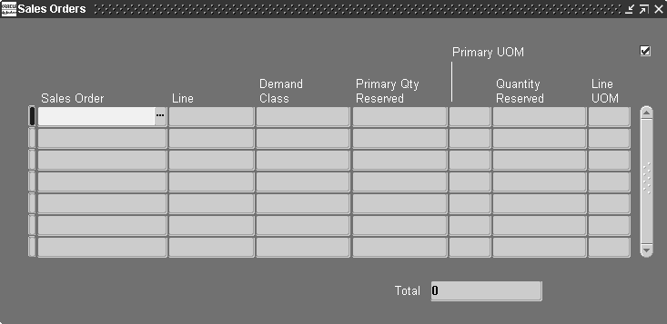

If applicable sales orders are attached to this job, you can select values in the Sales Order and Sales Order Line fields.
The window refreshes with the completed quantity displaying next to the Complete Assembly graphic icon.

To enter operation completion transactions for serial, or lot and serial components on the Discrete Workstation
During operation completion transactions, when moving quantity to the last step of the operation, the Move dialog box displays. Enter the number you are completing in the Quantity field.
If quality collection plans exist, choose Quality to navigate to the Enter Quality Results window. Entering Quality Results Directly, Oracle Quality User's Guide
The Components dialog window displays. This window displays fields for the Operation, Component, Unit of Measure, Quantity, Subinventory, Locator, and Revision.
You can change the default information for Unit of Measure and Subinventory.
In the Quantity field, if information is required, it displays with a background color of red. The default is the required quantity. If you have enabled the Allow Quantity Changes During Backflush parameter—you can change the quantity. Otherwise, you must transact the Quantity Required value. See Backflush Transaction Options
Choose Lot/Serial to assign lot and serial numbers.
The Lot Entry window displays to select or assign lot information, if required. Otherwise, if only serial number values are required, the Serial Entry window displays.
Enter lot information, if applicable. See: Assigning Lot Numbers, Oracle Inventory User's Guide
Choose Serial to access the Serial Entry window, see: Assigning Serial Numbers, Oracle Inventory User's Guide
Choose Done to save your work, and return to the workstation canvas.

Choose Lot/Serial to assign lot and serial numbers. The Lot Entry window displays to select or assign lot information, if required. Otherwise, if only serial number values are required, the Serial Entry window displays.
Choose Serial to access the Serial Entry window. Enter the serial number information, see: Assigning Serial Numbers, Oracle Inventory User's Guide
The Upstream Dispatch List branch is the second of two main branches on the Discrete Workstation. The tab for the Upstream Dispatch List branch itself is blank. If there are jobs for future dispatch at that department or resource, expanding the tree displays them on a list below this branch. When you select a job operation from the tree, the workstation also displays the operation's Components and Resources branches.
Job operations on the Upstream Dispatch List display two tabs of information, the Component Shortages and Properties tabs. The job operation's Components branch displays the Component Requirements tab, and its Resources branch displays the Resource Requirements tab.
Detailed information on each of these tabs is provided in the sections that follow.
For detailed information on each tab, see the following topics:
Job operations on the Upstream Dispatch List have assembly quantities in the To Move intraoperation step of the previous operation. These job operations are scheduled to be worked on in the near future at the resource you are viewing.
Each branch under the Upstream Dispatch List represents one job operation, and each job operation is supported by two branches of information: its Components branch, which displays the operation's Component Shortages and Properties tabs, and its Resources branch, which displays its Resource Requirements tab.
The Component Shortages tab displays a comparison of the components required for a job operation to the quantities of components on-hand.
The top section of the Component Shortages tab displays the following information about the department and resource: job, operation sequence, operation code, assembly, department, resource, and resource sequence.
The Component Shortages bar graph for jobs in the upstream dispatch list compares the job operation's required quantity to its on-hand quantity. The graph only displays job operations that have fewer components on-hand than are required for the operation.
Date: the date where the shortage occurred
The Properties tab for jobs in the upstream dispatch list displays the following information:
Job
Operation Sequence
Operation Code
Operation Description
Scheduled Quantity
Assembly
Assembly Description
Department
Resource
Resource Sequence
Job Start Time
Job End Time
Operation Start Time
Operation End Time
Quantity in Queue
Quantity in Run
Quantity in To Move
Quantity in Reject
Quantity in Scrap
Quantity in Complete
Next Operation
Previous Operation
Minimum Transfer Quantity
Project
Task
The header section of the Component Requirements tab for jobs in the upstream dispatch list displays the job, operation sequence, operation code, assembly, department, resource, and resource sequence.
Component
Description
Basis
Required Quantity
Supply Type
Date
Subinventory
Locator
Quantity Issued
Inverse Usage
Yield
Comments
The top section of the Resource Requirements tab for jobs in the upstream dispatch list provides you with the job, operation sequence, operation code, assembly, department, resource, and resource sequence.
The table provides the following information about the resource (you may have to scroll to see all of the columns of information):
Sequence
Resource
Assigned Units
Type
Description
UOM
Basis
Usage Rate
Start Date
Completion Date

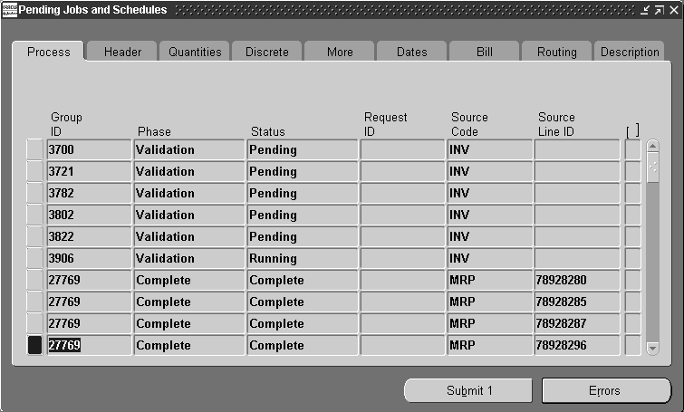

Signals to create discrete jobs and repetitive schedules are processed by the WIP Mass Load program.
When discrete jobs and repetitive schedules are created in response to kanban replenishment signals, they are automatically loaded into the Work Order Interface and automatically processed. If the replenishment signal creates a discrete job, the kanban card is referenced on that job; however, if the replenishment signal creates a repetitive schedule, the kanban card is not referenced. Once the discrete job or repetitive schedule has been successfully loaded, the status of the kanban card is updated to In process.
When kanban replenishment jobs and schedules fail validation and processing, they are automatically deleted from the interface table. The reason for their failure is noted on the Job and Schedule Interface report, which is automatically printed each time the Mass Load program is run. When imported, non-kanban job and schedule information that fails validation or processing is marked. You can use the Pending Jobs and Schedules window to view, update, and resubmit this information.

Attaching illustrative or explanatory files in the form of text, images, word processing documents, spreadsheets, and video
After saving a job, you can access the Components and Operations windows to view the details of the job, including its material requirements, operations, and operation material and resource requirements. You can enter a subjective completion percentage on any job operation. The system uses these entries to calculate the percent complete for the entire job. See: Adding and Updating Operations
About Attachments, Oracle E-Business Suite User's Guide

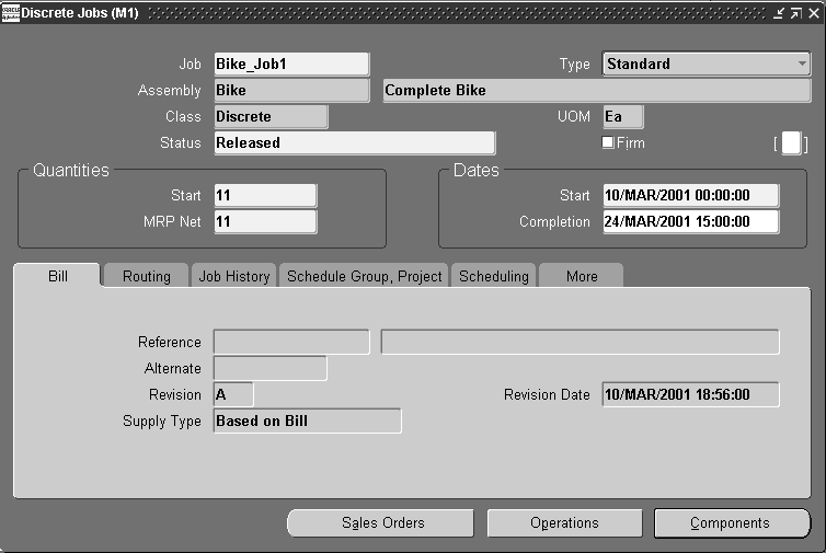

To define a discrete job
Navigate to the Discrete Jobs window. The Discrete Jobs Summary window appears
Choose New to display the Discrete Jobs window.
You can define discrete jobs one-at-a-time in the Discrete Jobs window. This method is described below. You can, however, also define several jobs simultaneously using the Discrete Jobs Summary folder window.
Note: The following nine fields cannot be accessed in the Discrete Jobs Summary folder window even if included in your user folder: bill and routing Alternates, bill and routing Revisions and Revision Dates; Completion Subinventory and Locator; and Supply Type. If you need to change the values that are defaulted into these fields, navigate to the Discrete Jobs detail window.
Enter or generate the Job name.
You can generate a default Job name by choosing Apply Default Job Name from the Tools menu or by simply pressing the tab key. If you do enter the job name, it must be unique and alphanumeric.
Note: Default job names can only be automatically generated by the automatic sequence generator if a prefix has been specified for the WIP:Discrete Job Prefix profile option.
Select the job Type, either Standard or Non-Standard. See: Standard Versus Non-Standard Discrete Jobs.
If defining a standard discrete job, select the job Assembly.
The assembly is the item you are building. If a primary bill of material, primary routing, or both exist for this assembly, they are defaulted.
You cannot select an assembly that has a primary routing that is Flow related. If you do, a warning is displayed and you are prompted to enter another routing designator.
See: Creating a Flow Routing, Oracle Flow Manufacturing User's Guide.
Assemblies are optional for non-standard discrete jobs, however, you must enter them for non-standard discrete jobs with routings if you want to track shop floor move and resource transactions.
If you set the WIP:See Engineering Items profile option to Yes, you can define jobs for engineering items.
Note: If you are defining a job for an ATO sales order, you must enter an ATO item.
Note: You can define discrete jobs for assemblies that do not have components and for assemblies that have components with disable dates less than or equal to the current date.
See: WIP Accounting Class Defaults, Discrete Accounting Classes, and Accounting Class Defaults on the Discrete Jobs Window
When you define a job, its status defaults to Unreleased but can be changed to Released or On Hold. See: Discrete Job Statuses.
Check the Firm check box to firm your job. You cannot firm a non-standard discrete job.
Firming a discrete job prevents MRP from suggesting rescheduling and replanning recommendations when changes to supply or demand occur. If replanning is required, the MRP planning process creates new jobs to cover the new demand. See: Firm Order Planning, Oracle Master Scheduling/MRP and Oracle Supply Chain Planning User's Guide.
To define job quantities
Standard discrete jobs must have a start quantity greater than zero. When you enter a start quantity for jobs with bills and routings, the component material requirements, department schedules, resource load, and job start and end dates are all determined automatically.
For non-standard jobs, if you enter a start quantity of 0 and specify a bill of material reference, the corresponding bill is exploded but material requirements equal to 0 are created. To perform move and completion transactions for a non-standard job, the start quantity must be greater than zero.
Note: If you link a job to an ATO sales order, the start quantity defaults from the sales order. If you link several sales orders to a single job, the order quantities are totalled and the start quantity is automatically updated.

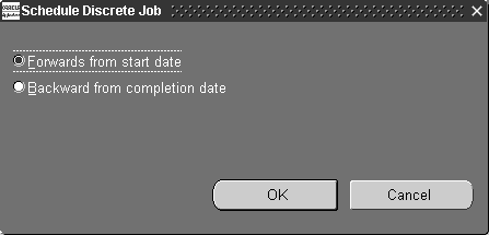

To schedule a discrete job with a routing
Enter or select either the Start or Completion date and time.
If you enter a start date and time the completion date and time are automatically forward scheduled based on the assembly's routing. Similarly, if you enter a completion date, the start date and time are automatically backward scheduled based on the assembly's routing. You can enter a past due start date to forward schedule a job that should have started before the current date. You cannot enter a start date and time greater than the completion date and time.

To change a saved job

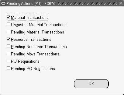

To view pending job information
You can determine if there are any pending transactions or documents for a job using the Pending Actions window. See: Viewing Pending Job Transactions.
To view operations:
Choose Operations The Operation window appears and the job's operations are displayed. You can optionally view the components required at a selected operation by choosing Components. See: Viewing Job and Schedule Operations.
To view component requirements
Choose the Components button. The Material Requirements window appears and the job's components are displayed. See: Viewing Component Requirements and Viewing Component ATP Information.
Note: When no routing exists, all components default to operation sequence of 1.
You can reserve assemblies on a Discrete job for a specific sales order line whether or not the assemblies are Assemble-to-Order (ATO) items. You link both standard and non-standard Discrete jobs to sales orders by selecting one or more sales orders from the Sales Order window when you create the job. You can link one or more sales order lines with one or more jobs.
You can also enter the demand class for the job to help you track production by sales channel. When you are building final assembly orders, the demand class is automatically loaded based on the customer. You can enter any valid demand class.
When linking ATO sales orders and jobs, however, the following rules are applied:
Assembly item cannot be a Pick-to-order item
Sales order line item must be demanded, but not yet shipped
Assembly item must be a standard item or an ATO item, not a model or an option
The WIP parameter, Respond to Sales Order Changes, determines the response to changes for configured sales orders and their linked Discrete jobs. Options are to ignore the sales order change or change the status of linked jobs to On Hold. When making changes to sales order lines with ATO items, this parameter is ignored by the system. See: WIP Parameters.
You cannot cancel jobs linked to sales orders without first undoing the links between them (see the task.
Prerequisites
To link a Discrete job with a sales order
Enter the Job name.
Note: Once you chose a job or assign an assembly to a job, you can only select sales order lines that are for that assembly.
Choose the Sales Orders button. The Sales Order window appears.
Select one or more sales orders.
You can select multiple sales orders as long as the total quantity allocated does not exceed the job quantity. You cannot select a sales order that has order lines that are currently being satisfied by a Flow schedule.
Note: You can attach a sales order to a job before entering an assembly, start quantity, or demand class for a job. Work in Process defaults the assembly, start quantity, or demand class based upon the sales order you specify.
If you enter a line that also specifies a shipment number, the sales order shipment number is entered in the Ship Number field. You can specify a sales order line that does not include a sales order shipment number.
Enter the Quantity Allocated.
This is the quantity of the sales order, line number, and shipment number combination that the discrete job fulfills.
Save your work.
To link a Discrete job with an ATO sales order
Select a Sales Order that has a line defined for the job's ATO item and demand class.
Enter the sales order Line.
Save your work.
To view an ATO sales order linked with a discrete job
Choose Find from the Query Menu. See: Finding Discrete Jobs.
To undo links between Discrete jobs and sales orders
Navigate to the Sales Order window.
Enter the Job name.
Choose Delete from the Edit Menu to undo the link.
Save your work.
You can reserve over-completion quantities from jobs linked to sales orders when using the Completion Transactions and Move Transactions windows. To reserve over-completions:
The linked sales order must be open.
You enter the sales order number for each completion line. This reserves the surplus amount, otherwise the over-completion is unreserved excess inventory.
Note: Oracle Mobile Supply Chain Applications does not support this feature.
Over-completion Reservations and Multiple Sales Orders
When multiple sales orders are tied to the same job, you can have instances where a job fulfilled by several sales orders is closed by over-completing only one order line. For example:
JobA is a quantity of 200
It is linked to Sales Order1 for 100, and Sales Order2 for 100, the completed quantities on both lines are reserved
The over-completion tolerance for the job is 20 percent
Note: Over-completion tolerance limits for discrete jobs are defined in the WIP Parameters window. See: Defining WIP Parameters
80 are completed referencing Sales Order1
120 completed referencing Sales Order2
The over-completion quantity meets the tolerance level, and the job status is changed to complete-even though Sales Order1 still has 20 units open linking to this job. You have several options to close this open record:
Cancel the jobs linked to the sales order line
Delink the jobs linked to the same sales order line
Reduce the quantity on the jobs linked to the same sales order line
Sales Order Over-shipments and Over-completion Reservations
The over-shipment tolerance for the sales order is defined in Order Management. Depending on the tolerance settings for job over-completions and sale order over-shipments, it is possible to have job over-completions that are not reserved to the sales order. For example:
JobA is for a quantity of 10, and linked to Sales Order1 for 10 each
The over-completion tolerance is 20 percent for the job, and the over shipment tolerance is 10 percent for the sales order
12 are completed for Job A-an over-completion quantity of 2, (20 percent)
One of the over-completions is reserved to the job, the other is unreserved. You can reserve the other surplus by increasing the quantity on the picking transaction to reserve it to the sales order.

The Associate Serial Numbers window is accessed from the Discrete Jobs window, and is enabled only for jobs under serialization. If you are creating a new job, you must first save your record in order to enter information on this window.
This window enables you to generate and associate new or existing serial numbers to the job. You can also print labels for these serial numbers from this window.
To associate serial number to jobs
Navigate to the Associate Serial Numbers window.
The Job name, Job Quantity, and Assembly name field values default from the record accessed on the Discrete Jobs window.
If there is a quantity of this job already associated to serial numbers - that quantity displays in the Qty Associated field, and those serial records display in the Associate Serial Numbers region.
Association can be performed either by creating a new record, selecting from the list of values, or generating multiple serial numbers to a job.
To create a new serial number and associate to an assembly, enter a value in the Serial Number field.
You can enter any value according to serial number uniqueness rules. See: Defining Revision, Lot, LPN Serial Parameters, Oracle Inventory User's Guide
You also have the option to select a serial number from a predefined list of values.
See: Generating Serial Numbers, Oracle Inventory User's Guide.
To generate and associate serial numbers from this window, enter the number of serial numbers to generate in the Serial Number Qty to Generate/Associate field.
Choose Generate/Associate.
The serial number values display in the Serial Number field. The number of serial numbers associated to this job displays in the Qty Associated field.
Check the Include in Serial Printing if you want to print labels for these records.
Save your work.
Initially, the values in the Operation, Operation Code, Department, and Step fields are blank - and the Status field is Associated until you perform transactions.
As you perform move transactions, the applicable values for those moves display Operation, Operation Code, Department, and Step fields. The Status field is In Progress while you are performing move transactions.
When the assembly is completed, the value in the Status field changes to Complete.
To cancel a serial number associated to a job
Select the row for the record you want to disassociate.
Delete the entire row from the window.
You can only disassociate or delete rows with a status of Associated.

You can perform serialized move transactions through Oracle Mobile Supply Chain Applications using a mobile device. The location of the assembly on the routing determines the window used for the transactions. For example, jobs not serialized do not require serial entry - and serialized jobs require serial number entry before you can proceed. This functionality uses the following rules:
Before reaching the serialization start operation, move transactions are performed using the window where serial number entry is not available.
Once a serialized assembly moves to the Queue of the serialization start operation, move transactions are performed using a window requiring serial number entry.
The current location of the assembly (the From Operation and Step), and the setting of the Default Intraoperation Step for Assembly Moves parameter - is used as the default destination for the To Operation and Step.
The default destination is the next occurrence of the step that you selected for the parameter setting. The next occurrence is in either the current operation, or the next countpoint operation - depending on the From Step. Default information can be changed. For example:
If the From Operation and Step is 20 Queue, and the parameter is set to Run, 20 Run is the default value for the To Operation.
If the From Operation and Step is 20 Queue, and the parameter is set to Queue, 30 Queue is the default if 30 is a countpoint operation.
Before the serialization start operation, where serial number entry is not available, you can move both backward and forward. However, when moving forward, an assembly must be moved to Queue of the serialization start operation before it can move forward. Starting from that point, the serial number represents a specific assembly and serial number entry is required.

Moving assemblies between routing operations and intraoperation step. See: Performing Move Transactions.
Scrapping assemblies. See: Scrapping Assemblies.

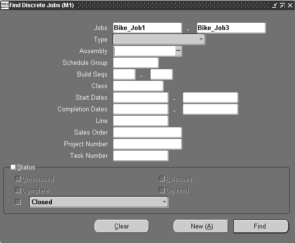

You can find then view, release, change, reschedule, or close discrete jobs. You can also query to find jobs to purge.
To find one or several discrete jobs to view, release, change, reschedule, or close
When the Find Discrete Jobs window appears, enter your search criteria.
You can query by Job name, job Type (standard or non-standard), Assembly, Schedule Group, a range of Build Sequences, accounting Class, a range of Start Dates, a range of Completion Dates, Sales Order, Project Number, Task Number, or job Status. You can combine or omit criteria as required.
Note: Querying to find jobs does not validate the records returned. For example, querying to find a range of jobs to close does not return only those jobs in that range that can be closed.
Choose the Find button.
To find one or several discrete jobs to include in your purge
When the Find Discrete Jobs window appears, enter your general search criteria.
You can by query by Job name, job Type (standard or non-standard), Assembly, Schedule Group, a range of Build Sequences, accounting Class, a range of Start Dates, a range of Completion Dates, Sales Order, Project Number, or Task Number.
Select an accounting Period or enter a Cutoff Date for the purge.
You can query by closed accounting Period. When you select an accounting period, the end date of that period is defaulted as the purge Cutoff date and cannot be overridden.
If you do not select an accounting Period, the cutoff date of the most recently closed accounting period is defaulted. You can override this date with any date in a closed period.
Note: Only jobs with close dates before or on the purge cutoff date are purged.
Choose whether to Include Configurations for jobs that have ATO configurations.
If you do not choose to include jobs that have ATO configurations in your query, no jobs that include ATO configurations are returned when you choose Find. If you do include configurations, you still have access to lot and serial information using the Lot Genealogy window or the Lot Transactions and Transaction Serial Numbers windows in Oracle Inventory. See: Viewing Material Transactions, Oracle Inventory User's Guide.

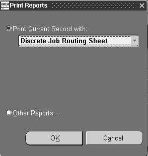

To print a report for the current discrete job
From the Discrete Jobs, Close Discrete Jobs, or View Discrete Jobs window choose Print Reports from the Tools menu.
The Print window appears.
Select the Print Current Record with option.
Select the name of the report and choose OK.
When you choose OK, a concurrent request to print the report is submitted. You can view the status of concurrent requests. See: Using the Concurrent Requests Window, Oracle E-Business Suite User's Guide.

To view component requirements:
From either the View Discrete Jobs or View Discrete Jobs Summary windows, choose the Components button. The Material Requirements window appears and the job's components are displayed. See: Viewing Component Requirements and Viewing Component ATP Information.
To view sales orders that are linked to a standard discrete job:
From either the View Discrete Jobs window, choose the Sales Order button. See: Linking ATO Sales Orders and Discrete Jobs.

To view pending transactions and conditions for a job
Select a queried job in the Discrete Jobs, View Discrete Jobs, Close Discrete, or Purge Discrete Jobs window. See: Finding Discrete Jobs.
Choose Pending Actionsfrom the Tools menu to invoke the Pending Actions window.
If a restriction exists, the check boxes indicating the type of restrictions is marked. An explanation of each restrictive condition follows:
Material Transactions: Components have been issued to the job and there are records in the WIP_REQUIREMENTS_OPERATIONS table. You can view information about issues material in the Material Requirements. See: Viewing Material Requirements and Viewing Component Requirements.
Uncosted Material Transactions: There are uncosted transaction records in the MTL_MATERIAL_TRANSACTIONS table. You can check to see if transactions are uncosted, the costed indicator is off, using the Material Transactions window. See: Viewing Material Transactions, Oracle Inventory User's Guide and Oracle Inventory Electronic Technical Reference Manual (eTRM) .
Pending Material Transactions: There are unprocessed material transaction records in the MTL_MATERIAL_TRANSACTIONS_TEMP table. You can view, update, and resubmit these records in the Pending Transactions window in Oracle Inventory. See: Viewing Pending Transactions, Oracle Inventory User's Guide.
Resource Transactions: Resources have been charged and there are records in the WIP_OPERATIONS_RESOURCES table.
Pending Resource Transactions: There are pending resource and overhead transaction records in the WIP_COST_TXN_INTERFACE table. You can view and resubmit these records using the Pending Resource Transactions window. See: Processing Pending Resource Transactions .
Pending Move Transactions: There are pending move transaction records in the WIP_MOVE_TXN_INTERFACE table. You can view and resubmit these records using the Pending Move Transactions window. See: Processing Pending Move Transactions a.
PO Requisitions: There are purchase requisitions in the PO_REQUISITION_LINES table. See: Reviewing Requisitions, Oracle Purchasing User's Guide and Oracle Purchasing Electronic Technical Reference Manual (eTRM) .
Pending PO Requisitions: There are unprocessed records in the PO_REQUISITION_ INTERFACE table. See: Requisition Import Process, Oracle Purchasing User's Guide .

Add, change, and delete WIP Attachments. See: Attaching Files to Jobs, Schedules, and Operations.

You can change discrete jobs using the Discrete Jobs and Discrete Jobs Summary windows. The status of the job determines if and what information can be changed. See: Discrete Job Status Control.
You can increase or decrease the job quantity with no restrictions if the job is unreleased. If the job is released and work has begun on the assembly, you cannot decrease the job quantity lower than the number of assemblies that have already passed the Queue intraoperation step of the first operation. If a sales order is linked to the job, you cannot decrease the job quantity lower than the order quantity. The material requirements and job dates are automatically adjusted based upon the quantity change. If the job's assembly is an MPS-planned item, the update process automatically adjusts the MPS relief quantity.
You can reschedule standard and non-standard jobs to respond to changes in plans or unexpected downtime by changing their start and/or completion dates and times. Jobs might require rescheduling when capacity or material schedules change, or when standards change. See: Rescheduling Discrete Jobs.
You can change the status of a discrete job although some changes from one status to another are disallowed and others are conditional. See: Job and Repetitive Schedule Status Changes.

To change discrete jobs
Change jobs in either the Discrete Jobs or Discrete Jobs Summary folder window. From the Discrete Jobs Summary window, you can choose the Open button to navigate to the Discrete Jobs window.

To reschedule a discrete job with a routing after changing a start quantity
After changing your start quantity and saving your work, the Schedule Discrete Job window appears.
Select a scheduling method:
Forwards from start date: The completion date is cleared and the job is forward scheduled using the start date and time.
Backwards from completion date: The start date is cleared and the job is backward scheduled using the completion date and time.
Manual: For jobs without routings and operations, you have the option to reschedule by accepting the current job start and completion dates.

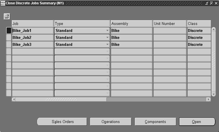

You can change the status of a group of discrete jobs using the Change Status option from the Tools menu. This mass change capability can be used for a variety of purposes such as releasing jobs to production and putting jobs on hold.
To change the status of several Discrete jobs
Choose Find from the Query menu. See: Finding Discrete Jobs.
The Discrete Jobs Summary window appears with the results of the query.
In the Discrete Jobs Summary window, select and deselect jobs as required. .
Choose Change Status from the Tools menu. .
The Change Status window appears.
Choose a status. See: Discrete Jobs Statuses and Job and Repetitive Schedule Status Changes.
Choose OK.
Save your work.

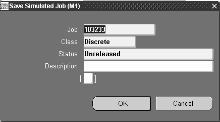

You can simulate a standard job to determine what materials, operations, and operation resources are required to support that job. You can specifically do all of the following:
vary the job quantity and/or start and completion dates to determine scheduling and requirement constraints
view both on-hand and available to promise quantities for simulated component requirements
vary the bills of material and/or routings and their associated revisions and revision dates
When you are satisfied with the simulated job, you can convert it into an actual job and save it.

To save a simulated job
Choose Save Simulated Job from the Tools menu. The Save Simulated Jobs window appears.
Enter the Job Name.
If a prefix has been entered for the WIP:Discrete Job Prefix profile option, the automatic sequence generator generates a default job name. This name can be overwritten. See: Profile Option Descriptions.
The following fields are defaulted as follows:
Class: If a default accounting class can be found, it is used. If one cannot be found, you must assign an accounting class to the job in the Discrete Jobs window. See: WIP Accounting Class Defaults and Discrete Accounting Classes.
Status: The status defaults to Unreleased. See: Discrete Job Statuses.
Note: The above defaults can be changed using the Discrete Jobs window. See: Defining Discrete Jobs Manually
Descriptions can be used to identify jobs on standard reports. They can be up to 240 characters of alpha numeric text. They are optional.
Optionally, enter the a descriptive flex value for the job. See: Setting Up Descriptive Flexfields.
Save your work.
Note: Values for the following fields are derived or defaulted but can be changed using the Discrete Jobs window. See: Defining Discrete Jobs Manually
MRP Net Quantity: Derived from the job start quantity.
Supply Type: Defaults to Based on Bill. See: Supply Types.
Firm Planned option: Defaults to off (not automatically firmed).
Completion Subinventory and Locator: For jobs with routings, defaults from the routing.
Lot Number: For lot controlled job assemblies, defaults based on how the WIP Default Lot Number Type parameter is set. See: Material Parameters.
You can also use the Discrete Jobs window to enter values for optional fields: Demand Class, Project, Task, Schedule Group, Build Sequence, and Production Line.

You complete job assemblies into inventory using the Completion Transactions and Move Transactions windows. You also use these windows to return completed assemblies back to jobs. When you complete or return assemblies, any remaining quantities are automatically updated.
Note: You can also complete Work in Process assemblies using the Inventory Transaction Interface and the Open Move Transaction Interface.
Over-completing and over-moving assembly quantities
You can complete an assembly quantity into inventory that is greater than the job start quantity, or move an assembly quantity that is greater than the quantity at an intraoperation step, whether or not the assemblies have a routing. This is referred to as an over-completion, and it is useful when your production process yields more assemblies than planned.
Note: You also can over-complete assemblies using the Inventory Transaction Interface and the Open Move Transaction Interface, but you must explicitly specify the over-completion transaction quantity, as it will not be derived by Work in Process.
To be able to over-complete assemblies on jobs, you must:
Set up a tolerance level to restrict the number of assemblies that can be over-completed
Enable the over-completion feature by checking the Over-completion check box on the Completion Transaction or Move Transaction windows when completing assemblies
When you over-complete assemblies to Discrete jobs, all resources are charged and any backflush components are backflushed.

For a serialized item returned to stock, validations occur to prevent re-issuing to a different job. At the time of completion, serialized assemblies and components are available from stock if they have specific values set for discrete assemblies and components in the Serial Numbers window in Oracle Inventory:
See: Serial Number Validations for Component Returns and Assembly Completions
Label printing capabilities are available at the time of completion. This provides the ability to create labels for any descriptive information or customer requirements. See: Label Printing at Completion and Maintaining Serial Number Information, Oracle Inventory User's Guide

To find one or more jobs to view, close, or reopen
Navigate to the Close Discrete Jobs window. The Find Discrete Jobs window appears.
Query to find one or more jobs. See: Finding Discrete Jobs.
The Close Discrete Jobs Summary window appears with the results of your query. Option: to navigate to the Close Discrete Jobs window, choose the Open button.
You can view information about the jobs you intend to close from either the Close Discrete Jobs or the Close Discrete Jobs Summary window. You can view job operation information by choosing the Operations button and component requirement information by choosing the Components button, see: Viewing Job and Schedule Operations, Viewing Component Requirements, and Viewing Component ATP Information. You can also view sales orders that are linked to standard discrete jobs by choosing the Sales Orders button, see: Linking ATO Sales Orders and Discrete Jobs.
To close discrete jobs
Navigate to the Discrete Jobs Summary window. If more than one job is displayed in the Discrete Jobs Summary window, select the jobs to close. .
You can only close jobs with statuses of Cancelled, Complete, Complete - No Charges, Failed Bill Load, Failed Close, Failed Routing Load, On Hold, Released, and Unreleased.
Choose Close from theTools menu. The Close Discrete Jobs Request window appears.
Select a Report Type.
Reports are printed per the Report Type specified, after the close process computes job close variances. If your organization uses standard costing, the Discrete Job Value Report - Standard Costing is printed when standard discrete jobs and non-standard asset jobs are closed. If your organization uses average costing, the Discrete Job Value Report - Average Costing is printed. The Expense Job Value Report is printed when expense non-standard jobs are closed regardless of your costing method. It is always printed in detail format regardless of the Report Type option specified. For more information about these reports see: Discrete Job Value Report and Expense Job Value Report.
Report Type options and formats are as follows:
Summary: Lists each job and includes job header, period-to-date summary, and cumulative-to-date summary information. The system also lists summary elemental account values for each job.
Detail Using Planned Start Quantity: Lists each job using the planned start quantity of the job to calculate the material usage variance. A detail report includes the following: job header, material, resource, resource-based and move-based overhead costs, completion, scrap, and job close variance transactions. It also includes period-to-date and cumulative-to-date summary information.
Detail Using Actual Completion Quantity: Lists each job using the actual completion quantity of the job to calculate the material usage variance. A detail report includes the following: job header, material, resource, resource-based and move-based overhead costs, completion, scrap, and job close variance transactions. It also includes period-to-date and cumulative-to-date summary information.
No Report: Does not print a report.
Select an Actual Close Date. The system date is the default.
The actual close date must be later than the most recently dated material, resource, or move transactions associated with the selected job or jobs. It must also be in an open accounting period. If it is not, the last date of the most recent open accounting period is defaulted.
Select a Submission Date and time. The system date and time is the default.
Choose OK to submit the request.
Only those jobs with appropriate statuses are closed. The statuses of jobs that are being closed are changed to Pending Close until the close process completes.

To print reports for a job
If you need additional information about a job, you can optionally print reports for the active or current job. See: Printing Reports for Current Discrete Jobs.
You can use the Pending Actions window to determine if there are pending or uncosted transactions associated with a job. You cannot close jobs if pending or uncosted transactions exist. See: Viewing Pending Job Transactions.

You can use the Purge Discrete Jobs window to purge information associated with discrete jobs that were closed in a now closed accounting period. You can purge all discrete job information or just selected information: details (material requirements, resource requirements, and operations), associated ATO configurations, or associated move and/or resource cost transactions.
Before purging a job, you can view detail and ATO sales order information for that job. You can also print one or all of the reports in the Discrete Job Packet for the job. See: Current Record Indicator, Oracle E-Business Suite User's Guide and Discrete Shop Packet.
Prerequisites
Navigate to the Purge Discrete Jobs window. The Find Discrete Jobs window appears.
Query to find one or more discrete jobs. See: Finding Discrete Jobs.
The Purge Discrete Jobs Summary window appears with the results of your query.
To print reports for a selected job
You can use the Pending Actions window to determine if there are pending transactions or conditions associated with a job. You cannot purge jobs if pending transactions or unprocessed documents exist. See: Viewing Pending Job Transactions.
To view operations and operation requirements for a selected job:
From either the Purge Discrete Jobs or Purge Discrete Jobs Summary window choose the Operations button.
The operations, if any, required for the job are displayed. See: Viewing Job and Schedule Operations.
To view component requirements for a selected job:
From either the Purge Discrete Jobs or Purge Discrete Jobs Summary window choose the Components button.
The component materials, if any, required the job are displayed. See: Viewing Component Requirements.
From the Purge Discrete Jobs Summary window choose the Sales Order button. See: Linking ATO Sales Orders and Discrete Jobs.
To select which discrete jobs to purge and/or report:
From the jobs displayed, select which to include in the purge. You can select and deselect jobs as required. .
Choose Purge from the Tools menu. .
The Purge Options window appears. See: Specifying Purge Options.

Choose the level of detail to include in the report. The options are as follows:
Full: The report lists all job and/or schedule records selected for the purge, the table and number of rows affected as well as those records that cannot be purged because of purge rule violations. Full is the default option.
Summary: The report lists all job and/or schedule records selected for the purge but in a tabular form. The table and row detail is omitted although exception information is included.
Exception: The report lists only those job and/or schedule records that cannot be purged because of purge violation rules. Exception information is included.
Choose OK to submit the purge and print the report.
Note: Once you commit the process, all related information is removed from the database.
To only print a report for the selected jobs or schedules
From the Purge Options window, choose the Report Only action.
Choose the level of detail to include in the report. The options are Full, Summary, or Exception (see above).
From the Include option group, choose what information to include in the report. The options are as follows:
Headers: If you choose to purge Headers, all other options are automatically selected and are, furthermore, required. Purging headers purges all information associated with the selected jobs or repetitive schedules.
Details: You can choose to purge job or repetitive schedule details (operations and material and resource requirements). If you choose this option, you can also choose to purge move and resource transactions.
Move Transactions: You can choose to purge move transactions. If you choose this option, you can also choose to purge schedule details and resource transactions.
Resource Transactions: You can choose to purge resource transactions. If you choose this option, you can also choose to purge schedule details and move transactions.
Note: If you enter a date that is earlier than the repetitive schedule's complete or cancel date or the discrete job's close date, the system does not purge any job or schedule information.
Choose OK to print the report.
To purge without printing a report
From the Purge Options window, choose the Purge Only action.
From the Include option group, choose what information to purge. See above.
You can determine if there are any pending transactions or conditions for a job using the Pending Actions window. See: Viewing Pending Job Transactions.

You can view, update, delete, and resubmit records (rows) that have failed validation and remain in the Work Order Interface (WIP_JOB_ SCHEDULE_INTERFACE) table. You can view the error messages associated with failed records. Error messages assist you in updating failed records before resubmission.
You cannot insert new job and schedule records into your interface table using this window.
Prerequisites
To find job and schedule interface records:
Navigate to the Pending Jobs and Schedules window. The Find Pending Jobs and Schedules window appears.
Enter your selection criteria.
You can find all records with a specific Group ID. You can also find all records that have a specific Process Phase (Validation, Explosion, Creation, or Complete), Process Status (Pending, Running, Error, or Complete), Source Code, Source Line ID, Load Type (Create Standard job, Create Repetitive Schedule, Update Discrete Job, or Create Non-standard Job), or are for a specific Organization. You can also search for a specific Job, Assembly, or Line and Assembly.
Choose the Find button. The Pending Jobs and Schedules window appears with the results of your query.
To view job and schedule interface records:
For each record, you can view the following information using the Pending Jobs and Schedules window's tabbed regions:
Process: Group ID, Phase, Status, Request ID, Source Code, and Source Line:
Header: Load Type, Organization, Job, Line, Assembly
Quantities: Discrete Start and Net Quantities, Repetitive Daily Quantity and processing Days, and Total Quantity (both discrete and repetitive)
Discrete: Class, Lot Number, Schedule Group, Build Seq, Project Number and Task
More: Status, Firm planned option, Demand Class, Scheduling Method, Unit Number
Dates: First Unit Start Date, First Unit Completion Date, Last Unit Start Date, and Last Unit Completion Date
Bill: Reference, Alternate, Revision, Revision Date, Supply Type
Routing: Reference, Alternate, Revision, Revision Date, and Completion Subinventory, and Completion Locator
Description: Description and Created By
To view error details for failed job and schedule records:
In the Pending Jobs and Schedules window, select the failed (Status=Error) record.
Choose the Errors button. The Pending Job and Schedule Errors window appears.
All errors for the selected record are displayed. The Type indicates whether the failed record produced an Error or a Warning. The Message explains why the transaction failed. Using these messages you can determine what fields need to be updated.
