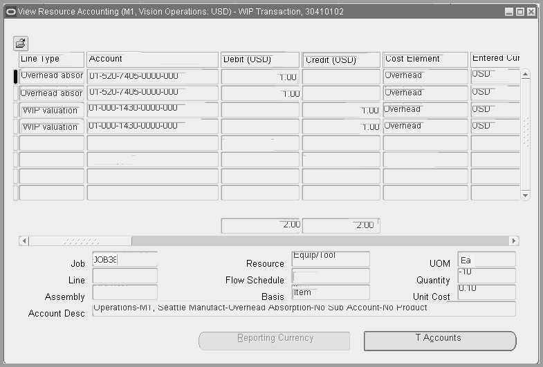

The appropriate overhead costs are automatically charged as you move assemblies through the shop floor. You can charge overheads directly based on move transactions or based on resource charges. You can base the material overhead charge on the number of units, or on the percentage of resource value. The overhead rate with the basis of resource value must be directly assigned to the resource's respective routing. Overhead charges are automatically reversed during a backward move transaction.

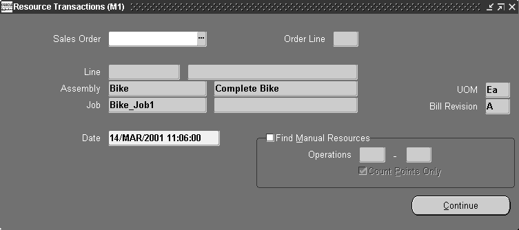

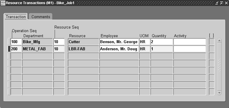

Manual resources can be charged independent of move transactions using the Resource Transactions window. If you complete an operation with a move transaction, and there are Manual resources assigned to that operation, a message informing you that Manual resources exist at that operation is displayed. You can then charge these Manual resources by choosing the Resources button in the Move Transactions window.
Note: You can control whether the Resources button appears in the Move Transactions window using function security. See: Security Functions.
When you charge Manual resources, you must enter the actual resource units applied rather than autocharging the resource's usage rate or amount based on the move quantity. You can charge Manual resources using that resources unit of measure or any valid alternate unit of measure. If the resource is a person-type resource, you can enter an employee number. Manual resources for repetitive schedules are charged to the first open repetitive schedule on the line.
You can create ad hoc resource requirements as you charge resources. Ad hoc resource requirements an be created for any resource that is defined for the department that is associated with the operation.
You can reverse Manual resource charges by entering negative resource units. For example, if you intend to charge 8 hours but mistakenly enter 10, you can correct the error by entering an additional resource charge transaction for -2 hours.

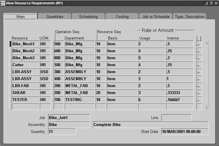

You can assign a resource basis type of Item to a resource if its per unit usage rate is dependent on the number of assembly items being produced. If the per unit usage rate is fixed, for example labor to setup a machine for a job, you can assign a resource basis of Lot. See: Resource Usage, Oracle Bills of Material User's Guide.

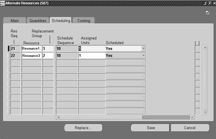

Simultaneous resources consist of two or more resources scheduled with the same start date and time within a job operation. These resources have the same value in the Scheduled Seq field of the Routing window. Simultaneous resources must begin at the same time, but they may complete at different times depending on the Usage Rate or Amount.
Alternate resources consist of other resources-or groups of resources-used instead of the primary resource in the job operation. Alternate resources are defined on the Alternate Resources window. They are invoked in one of two ways:
During backward scheduling, when the use of alternate resources is the only means for a job to complete by the Requested Due Date
When a resource for an operation is unavailable
You can also use alternate resource sets. In infinite scheduling, you can change an alternate resource to a primary resource, This specifies it as a one-for-one substitution, or substitution by a group when the resources in the group are simultaneous. In constraint-based scheduling, you can specify the resources in a sequence, and have them span multiple schedule sequences. See: Alternate Resource Sets

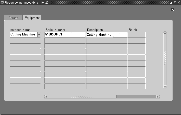

You can define specific machines to any of your machine type resources, and specific employees to labor type resources. All instances for a resource are viewable in the Resource Property window on the Scheduler Workbench, Job Workbench, and Resource Workbench.

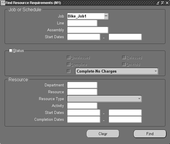

You can add and update resources as you add and update operations. You can add resources that are not pre-assigned to job or repetitive schedule routing operations. You can add resources to jobs and schedules that do not have operations.
You can add resource requirements regardless of their charge type: Manual, PO move, PO receipt, or WIP move. When you add a resource with an charge type of PO move, PO receipt, or WIP move, the resource is added to the job or repetitive schedule as a Manual resource.
Prerequisites
To add or update resource requirements
Navigate to the Operations from Job/Schedule Details in the menu.
Select the Job or repetitive Line and Assembly.
If you select a line and assembly, choose the repetitive schedule by selecting the first unit start date of that schedule. If you have selected a discrete job, the system displays the scheduled start date of the job.
In the Main tabbed region, select the operation Sequence.
If you are adding a resource, the operation Sequence specifies at which operation to add the resource.

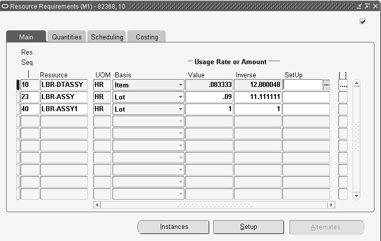

Choose the Resources button. The Resource Requirements window appears.
In the Main tabbed region of the Resource Requirements window, select or enter the resource Sequence number.
Valid sequence numbers range from 1 to 9999 inclusive.
You can add any resource that is assigned to the department of the operation you have selected. You can also add any multi- departmental resource.
When you add a resource, the UOM, basis, activity, charge type, and rate or amount that are associated with the resource are defaulted. See: Assigning Resources to a Department, Oracle Bills of Material User's Guide and Defining a Resource, Oracle Bills of Material User's Guide.
Note: You cannot update a resource if you have charged the resource to a job or schedule.
Select a resource Basis basis. See: Resource Usage, Oracle Bills of Material User's Guide.
The options are as follows:
Item: Charge and schedule the resource on an item-by-item basis. Select Item when resource times and costs are dependent on the job or schedule quantity, such as when charging per unit labor costs.
Lot: Charge and schedule the resource on a one per job or schedule basis. Select Lot when resource times and costs are independent of quantity, such as when setting up a machine to run an entire job.
You cannot update the resource basis if you have charged against the resource.

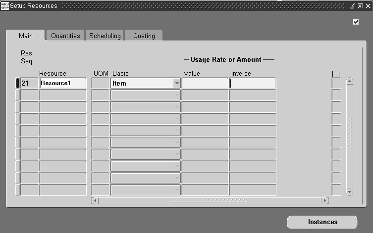

Enter the Usage Rate or Amount Value or Inverse.
Value: Enter a Value if you know how much of the resource is consumed at the operation (per item or per lot) given the resource UOM. For example, if your manufacturing process consumes a mold (resource UOM=EA) for every 5 items produced, enter a Value of 0.2 (1/5). When you enter the Value of 0.2, the Inverse is automatically calculated as 5. In other words, producing one unit consumes 0.2 of the mold.
Inverse: Enter an inverse amount if you know the number of units a resource can process given the resource UOM. For example, if you can process 10 units on a lathe (resource UOM = HR) in an hour, enter an inverse amount of 10. When you enter the inverse amount of 10, the value is automatically calculated as 0.1 (1/10). In other words, each unit takes 0.1 hours to process.
You cannot enter a quantity less than zero for resources with time-based units of measure. When you enter the usage rate or amount, the inverse usage rate or amount is automatically supplied.

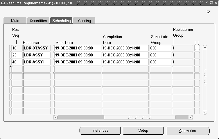

To schedule or reschedule a resource
In the Scheduling tabbed region, enter the number of Assigned Units. See: Resource Usage, Oracle Bills of Material User's Guide.
When you add a resource, the number of assigned units default value of 1. The number of Assigned Units must be greater than zero.
The number of assigned units affects the scheduling of jobs and repetitive schedules. If you assign more than the default number of resource units, less elapsed time is scheduled for the operation.
For example, if you have an operation that normally takes a machine 10 hours to complete, and you assign 2 machines, then only 5 hours are scheduled for the resource at that operation. You should only assign multiple resource units if they work simultaneously at an operation.

To enter resource instance information
Choose Instances on the Resource Requirements window.
Enter the number for the employee, or equipment and serial number applicable to the resource type. All instances for a resource are viewable in the Resource Property window on the Scheduler Workbench.
To enter resource setup information
Choose Setup on the Resource Requirements window.
You can create a performance model for machine and labor resource setups. The setups for a resource are independent of the department that the resource is defined in.
Enter a resource sequence in the Res Seq field.
The resource sequence indicates the order of a resource relative to other resources.
Select a value in the Resource field.
Select the resource basis, indicating whether the usage required is by item or lot.
In the Usage Rate or Amount section, enter the amount the resource is consumed at an operation.
In the Setup Type field, select a setup that is specific to this resource.
Save your work.
To enter alternate resource information
Navigate to the Resource Requirements window. Select a record and choose the Scheduling tabbed region.
Enter a value in the Substitute Group field.
This value indicates which resources are replaced as alternates— alternates have the same substitute group number as the operation resource.
Note: The Alternates button is active when a value is entered in the Substitute Group field, and the record is saved.
Save your work.
Choose Alternates to display the Alternate Resources window.
Alternate resources consist of other resources used instead of the primary resource. See: Defining Simultaneous and Alternate Resources, Oracle Manufacturing Scheduling User's Guide
In the Main tabbed region, optionally you can enter the Resource Sequence. The resource sequence indicates the order of a resource relative to other resources. The value must be unique for each operation.
Navigate to the Scheduling tabbed region. For each alternate resource, enter a Replacement Group value.
This is used in grouping several resources together as an alternate resource group. The primary resource is always a Replacement Group value of 0.
In the Scheduled Sequence field, enter a value.
The schedule sequence number indicates the sequence the resource is to be used—this value defaults from the Resource Requirements window. The replacement group can contain different sequences even if the primary replacement group has only one schedule sequence.
Save your work.
Alternate Resource Sets enable resources to be substituted and replaced as a group. In infinite scheduling—alternate resources can be a one-for-one substitution, or substitution by a group when the resources in the group are simultaneous.
In constraint-based scheduling—you can specify that a group, or set of resources, is substituted for another set. This enables resources to be sequential and span multiple schedule sequences. This functionality is used in manufacturing environments where groups of machines are used consecutively in an operation. The type of machine used in the first group determines the type of machine used in the second group. The groups are not simultaneous, therefore each corresponding pair of machines is assigned a replacement group value within a substitute group. Alternate resource sets are defined using the Resource Sequence, Schedule Sequence, Substitute Group, and Replacement Group fields:
Resource Sequence
The resource sequence is the number that indicates the order a resource is used in an operation, relative to the other resources. This value is unique for each operation.
If a schedule sequence number is not provided, since it is an optional field—the resource sequence is used for scheduling.
Schedule Sequence
The schedule sequence number indicates the period the resource is used. When defining resource sets, you can define records with different schedule sequences using the same substitute group number value. This enables each replacement group, within a substitute group, to have a different set of schedule sequences.
Substitute Group
This value indicates which resources can be used as alternates. Resources with the same substitute group number can replace other resources defined with that substitute group number, and the same replacement group number value.
Substitute groups are used in the order of their defined schedule sequence number and resource sequence number combination.
A resource can have alternates without defined schedule sequences; the substitute group value is not dependent on the schedule sequence number.
Replacement Group
This value is used in grouping several resources together as an alternate resource group. The primary resource is always a Replacement Group value of 0.
Alternate Resource Sets Example
The resource Grinder1 is the primary resource and includes Tool-50 in its resource set. The replacement resource is Grinder-2.
Grinder-2 is an alternate resource set that includes Tool-46 in its setup.
The tools for each grinder are second in the setup of the grinders.
The primary resource and alternate resource sets are in the same substitute group.
The replacement group for the primary resource is 0, for the alternate it is another value.
| Resource | Resource Sequence | Schedule Sequence | Substitute Group | Replacement Group |
| Grinder-1 | 23 | 10 | 668 | 0 |
| Tool-50 | 24 | 11 | 668 | 0 |
| Grinder-2 | 23 | 10 | 668 | 1 |
| Tool-46 | 24 | 11 | 668 | 1 |

You can view resource requirements for a specific discrete job or repetitive line and assembly. You can also view resource requirements across jobs and schedules.
To find and view resource requirements
Navigate to the View Resource Requirements window. The Find Resource Requirements window appears.
You can query by Job or production Line and Assembly or a range of start dates. You can query to find resource requirements for jobs and schedules of a specific status. For example, you can query to find only resources for Released jobs and schedules
You can also query by Department, Resource, Resource Type, Activity, and/or a range of First Unit and Last Unit Start or Completion Dates.
Enter any combination of search criteria and choose the Find button. The results display in the View Resource Requirements window.
You can view the following information in View Resource Requirements window's tabbed regions:
Main: Resource, UOM, Operation Sequence number, Department, Resource Sequence number, Basis, Rate or Amount of Usage and Inverse Value
Quantities: Required, Applied, and Open quantities
Scheduling: Assigned Units, Scheduled, Start Date, and Completion Date
Costing: Activity, Standard Rate option, Charge Type
Job or Schedule: Job/Assembly or production Line/Assembly and Status
Type, Description: Resource Type and Description
You can also view, if entered, descriptive flexfield information. See: Setting Up Descriptive Flexfields.

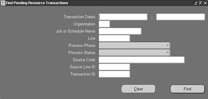

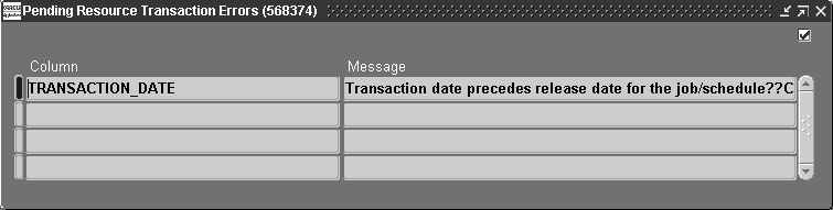

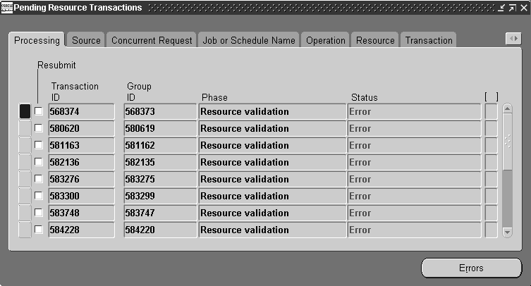

You can load resource transaction information into the Open Resource Transaction Interface table from external sources such as bar code readers and payroll systems. The resource cost transaction manager, launched in Oracle Inventory, processes and validates this information to ensure accuracy and compatibility with other Oracle Applications information.
Resource transaction information that fails validation or processing is marked. You can use the Pending Resource Transactions window to view, update, and resubmit this information.
Related Topics
Processing Pending Resource Transactions

Manual resources can be charged to discrete jobs and repetitive schedules that have statuses of Released or Complete. Resources are charged based on how they are defined at the operation they are assigned.
You can charge resources that are not assigned to job or repetitive schedule routing operations thus creating ad hoc resource requirements. You can choose to add ad hoc resources of any charge type - Manual, PO Move, PO Receipt, or WIP Move - however ad hoc resources are actually added as Manual resources and have with a required quantity of zero.
Prerequisites
To add, charge, or add and charge a resource
Navigate to the Resource Transactions window.
Select a Sales Order, repetitive Line and Assembly, Assembly, or Job. The cursor defaults to one of these fields based on how the TP:WIP:Resource Transactions First Field profile option is set. See: Profile Option Descriptions.
You must select a discrete job or repetitive line and assembly with a status of Released or Complete.
Check the Find Manual Resources check box to find the manual resources operations for the Job or Line/Schedule.
Note: Be aware that costed, manual resources on the manufacturing routing are part of the standard cost for the assembly you are building. If you do not apply the correct number of resource units, you may have a variance on the job or repetitive schedule.
Enter the range of operation sequence numbers to transact manual resources.
Check the Count Points Only check box to find only the count point operations for the Job or Line/Schedule. See: Count Point and Autocharge Fields, Oracle Bills of Material User's Guide.
Choose the Transact button. The Resource Transactions window appears.
In the Transaction tabbed region, enter or select a resource.
You can select any resource associated with the department of the operation or any multi-departmental resource.
Optionally, select the Employee.
If you enter an employee, you can charge job or schedule resources at the employee's effective rate. If you do not specify an employee, the resource is charged at the standard rate for the person-type resource.
Select the UOM. See: Overview of Units of Measure, Oracle Inventory User's Guide.
You can use any valid, alternate unit of measure for the assembly you are moving.
Enter the transaction Quantity.
Enter the number of units charged by the resource. If you enter an amount different from the standard for a resource that is part of your standard manufacturing routing, a cost variance is incurred. All charges for 'ad hoc' resources, represent a cost variance.
Note: If you add a manual resource, the transaction quantity is blank. The resource is not transacted unless you enter a transaction quantity.
Select the Activity. See: Defining Activities and Activity Costs, Oracle Cost Management User's Guide.
The enabled activity, if any, associated with the resource is displayed.

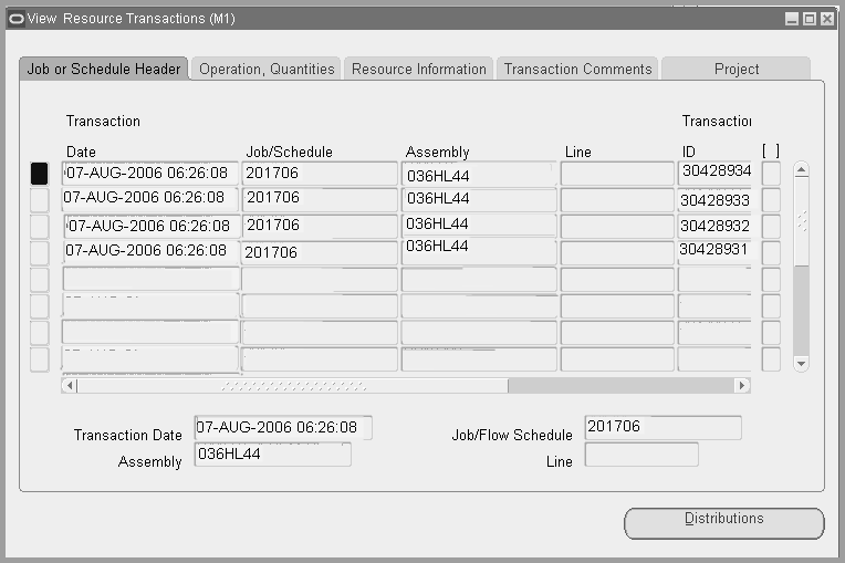

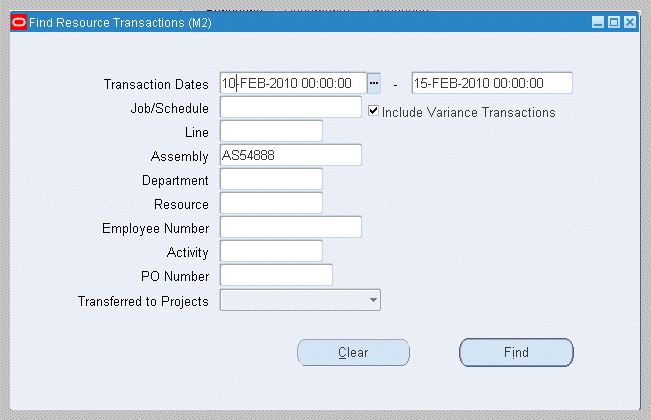

You can find and view resource transactions for an individual job or schedule using the View Resource Transactions window. This window enables you to view resource transactions across jobs and schedules, and access subledger accounting transaction windows in Oracle Cost Management. You can choose to view only resource and overhead transactions, or also include variance transactions in the display.
To find and view resource transactions
Navigate to the View Resource Transactions window. The Find Resource Transactions window first appears.
You can query to find resource transactions by Transaction Date range, Job or Schedule, Line, Assembly, Department, Resource, Employee Number, Activity, PO Number, and Transferred to Projects values.
Enter any combination of search criteria.
For the Include Variance Transactions check box, when the check box is:
Unchecked only resource and overhead transactions display.
Enabled all variance transactions also display including cost update transactions, job close variance transactions, and final completion variance transactions.
Choose Find. The results display in the View Resource Transactions window.
Select the following tabs to view information:
Job or Schedule Header: Transaction Date, Job/Schedule, Assembly, Line Transaction ID
Operation, Quantities: Operation Sequence, Department, Sequence, Name, Employee Number, UOM and Quantity in both the transaction and primary units of measure
Resource Information: Basis, Usage Rate or Amount, Activity, Autocharge Type, PO Number, Currency
Transaction Comments: Transaction Type, Reason, Reference
Project: Project Number, Project ID, Task Number, Task ID
You can access accounting windows by choosing Distributions, and using options in the Tools menu:
Select Distributions to access the WIP Transactions Distributions window.
From the Tools menu, select View Accounting to access the View Resource Accounting window.
From the Tools menu, select View Accounting Events to access the Accounting Events page.

When you query a resource transaction in Oracle Work in Process, you can choose to view the detail accounting lines for the queried transaction in the form of a balanced accounting entry (such as debits equal credits). You can also choose to view the detail accounting as t-accounts. Use these features to see how a transaction will affect the account balances in your general ledger.
To view accounting lines and t-accounts
Query the resource transaction for which you want to view accounting lines.
From the Tools menu, choose View Accounting.
The View Resource Accounting window opens.
To view the accounting detail, choose T-Accounts.
The first time you open the View Resource Accounting window, the following information will be displayed for the detailed accounting lines:
| Account | Line |
| Accounting Date | Line Type |
| Assembly | Operation Sequence |
| Basis | Primary Quantity |
| Cost Element | Reference |
| Credit | Resource |
| Curr Conversion Rate | Resource Sequence |
| Debit | Set of Books Short Name |
| Department | Trans Reason |
| Entered Credit | Trans Source |
| Entered Curr | Transaction Class |
| Entered Debit | Transaction Date |
| Flow Schedule | Transaction Num |
| GL Batch | Transaction Type |
| Inventory Organization Code | Unit Cost |
| Job | UOM |
When you select a detailed accounting line, the system displays the following information at the bottom of the View Resource Accounting window:
| Account Desc | Line |
| Assembly | Quantity |
| Basis | Resource |
| Flow Schedule | Unit Cost |
| Job | UOM |
Customizing the View Accounting Window
The View Resource Accounting window is a folder. You can easily customize the information that is displayed in the window. When you select a detailed accounting line, the system displays additional information at the bottom of the View Resource Accounting window.
From General Ledger, you can drill down to subledger details from the Account Inquiry, Journal Entry Inquiry, or Enter Journals windows for journals that have specific journal sources assigned to them. For example, if a journal source is WIP, you can drill down to the transaction details in Oracle Work in Process.
When you drill down from General Ledger, the WIP Accounting Lines window will open. The first time you open this window, the following information will be displayed:
| Accounting Date | Line |
| Assembly | Line Type |
| Basis | Operation Sequence |
| Cost Element | Primary Quantity |
| Credit | Reference |
| Currency | Resource |
| Debit | Trans Reason |
| Entered Curr | Transaction Date |
| Entered Debit | Transaction ID |
| Flow Schedule | Transaction Type |
| GL Batch | Unit Cost |
| Job | UOM |
When you select a detailed accounting line, the system displays the following information at the bottom of the window:
| Basis | Resource |
| Job | UOM |
| Line |
From the WIP Accounting Lines window, you can drill down even further to view detail transactions or you can choose to view the underlying transaction accounting.
To drill down to detail transactions or to view transaction accounting
From the WIP Accounting Lines window, select a detail accounting line.
Choose the Show Transaction button to view detail transactions.
Choose the Show Transaction Accounting button to view the transaction accounting.
You can find pending resource transactions for an individual job or schedule name. You can also find pending resource transactions for multiple jobs and schedules simultaneously.
You can find pending resource transactions by a range of Transaction Dates, Organization, Job or Schedule Name, Line, Process Phase (Move validation, Move processing, or Backflush setup), Process Status (Pending, Running, or Error), Source Code, Source Line ID, and Transaction ID. You can limit or expand your selection by combining selection criteria.
To find pending resource transactions
Navigate to the Pending Resources Transactions window. The Find Pending Resources Transactions window appears.
Enter any combination of search criteria and choose the Find button. The Pending Resource Transactions window appears with the results of your query.

You can view, update, delete, and resubmit resource transactions that have failed validation and remain in the Open Resource Transaction Interface table (WIP_RESOURCE_TNX_INTERFACE). You can also resubmit transactions whose concurrent process has failed and have a processing phase of Complete and process status of Error. You can view error messages associated with failed records. Error messages can assist you in updating failed records before resubmission.
To view pending resource transaction records
Navigate to the Pending Resources Transactions window. The Find Pending Resource Transactions window appears.
You can find pending records by Transaction Date range, by Organization, by Job, Schedule Name, and production Line. You can also search for records that have a specific Process Phase (Move validation, Move processing, or Backflush setup, Process Status (Pending, Running, or Error), Source Code, Source Line ID, or Transaction ID.
For each pending record displayed, you can view the following information using the Pending Resource Transactions window's tabbed regions:
Processing: Group ID, processing Phase, processing Status
Source: Source Code, Source Line (if applicable), Created By
Concurrent Request: Request ID, Phase, Status, Message
Job or Schedule Name: Organization, Job, Schedule Name, Line
Operations: Operation Sequence, Department, resource Sequence, resource Name, resource Type, Employee Number
Resource: Activity, Charge Type, PO Number, Currency, Actual Rate
Transaction: UOM, Quantity, Date and Time, Type
You can also view the descriptive flexfield information entered for the transaction record. See: Setting Up Descriptive Flexfields.
To view error details for failed resource transactions
In the Pending Resource Transactions window, select the failed record.
Choose the Errors button. The Pending Resource Transactions Error window appears.
All errors for the selected transaction are displayed. Column indicates the name of the column in the resource transaction interface table that failed validation. Message indicates why the transaction failed.
Messages that are not specific to a Column, for example processing errors, may also be displayed. In such cases, a Message but no Column is shown.
To update failed resource transaction records
Select the record to update.
You can update records with a processing status of Error.
In the Source tabbed region, enter the Source Code and Source Line.
When you insert records into the Open Resource Transaction Interface table, you can optionally identity a record's source using the source code and source line. For example, you can enter a different source code and source line for records from a bar code reader versus those from a radio frequency device.
Select the Created By identifier.
The name of the user that created the transaction is displayed. This field can be updated.
In the Job or Schedule Name tabbed region, select the Organization.
You can only select enabled organizations. See: Creating an Organization, Oracle Human Resources User's Guide.
In the Operations tabbed regions, select the Operation Sequence for the resource.
You can select any operation defined for the job or repetitive schedule.
Select or enter the resource Sequence.
You can update this field with any resource sequence defined for your operation or you can add a resource ad hoc by entering a new resource sequence. If you choose a predefined resource sequence, all fields specific to that resource are automatically populated.
If you inserted an 'ad hoc' resource requirement into the Open Resource Transaction Interface table by entering a new resource sequence, you can select resources associated with the department of the operation or multi-departmental resources. All related fields are automatically populated based on your selection.
If you choose a resource of type Person and the employee number has no value, you are prompted to enter an employee number.
If you choose a resource type other than Person and the employee number has a value, you are prompted to clear the employee number.
If you have entered a person-type resource, you can update this field with any valid employee number.
In the Resource tabbed region, select the Activity.
You can select an activity defined for your organization or an activity that is not tied to any specific organization and is not inactive.
Enter the Actual Rate for your resource.
This rate is used to determine the cost of a resource when the resource's standard rate option is set to No.
In the Transaction tabbed region, select the UOM. See: Overview of Units of Measure, Oracle Inventory User's Guide.
You can update this field with any resource alternate UOM that is not inactive.
This is a quantity of the UOM which you are charging to a job or schedule. The job/schedule is costed at the resource standard, the employee rate, or the actual rate. You can update this field with any number.
Enter the transaction Date and time.
The date and time must fall within an open accounting period. It cannot be greater than the current date or less than the release date of the job or the earliest valid repetitive schedule.
In the Comments tabbed region, select the Reason code. See: Defining Transaction Reasons, Oracle Inventory User's Guide.
Enter the transaction Reference.
References can be used to identify transactions on standard reports. They can be up to 240 characters of alpha numeric text.
Save your work.
To resubmit individual failed resource transaction records
In the Pending Resource Transactions window, check the transaction's Resubmit check box.
You can resubmit transactions of any processing status. If you leave the check box unchecked you can still update your transaction record but the transaction manager does not process it again when polling the resource interface table.
Save your work to resubmit the transaction.
When you resubmit a transaction, the system nulls the Transaction ID, Group ID, and concurrent Request ID and changes the processing status to Pending. The resubmit level of the Resource Cost Transaction Manager determines at what specific start date and time or at what specific intervals transactions are processed.
To select and resubmit all failed resource transactions
In the Pending Resource Transactions window, chose Select All for Resubmit from the Tools menu. .
You can deselect selected transactions as required.
Save your work to resubmit the transactions.
When you resubmit transactions, the system nulls their Transaction IDs, Group IDs, and concurrent Request IDs, and changes their processing Statuses to Pending. The resubmit level of the Resource Cost Transaction Manager determines at what specific start date and time or at what specific intervals transactions are processed.
To delete pending resource transaction records
In the Pending Resource Transactions window, select the transaction.
Choose Delete from the Edit Menu
You can delete failed records that have a processing status of Error regardless of their processing phase. When you delete transaction records, their corresponding error messages are also deleted.
