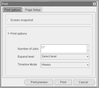

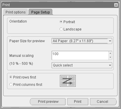

Print: Enables Gantt chart printing. See: Printing Your Gantt Chart

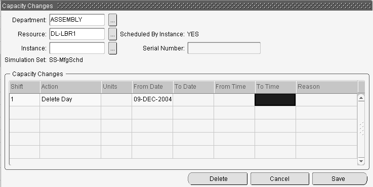

Adjust Resource Capacity: Accesses the Resource Load Versus Capacity pane to modify the required resource

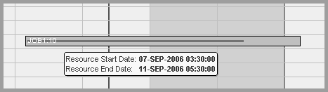

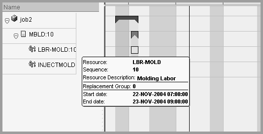

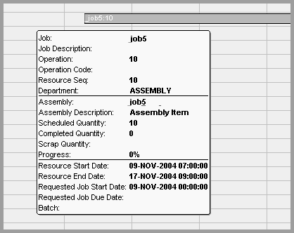

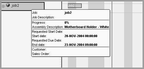

Tool tip windows provide an ease of use mechanism for displaying start and end date information about jobs. They are displayed by rolling your cursor over the appropriate bar on the Gantt chart. For more detailed information, you can access the Properties windows.
Job Tool Tip
The Job tool tip window displays the following information: Job name, Job Description, Progress percentage of completed operations, Assembly Description, Requested Start Date, Start date, Requested Due Date, End date, Customer, and Sales Order.

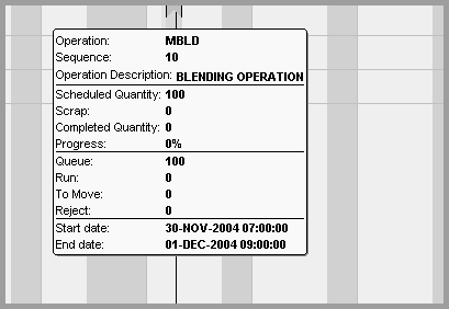

Job Operation Tool Tip
The Job Operation tool tip window displays the following information: Operation number, operation Sequence, Operation Description, Scheduled Quantity, Scrap, Completed Quantity, Progress percentage of completed operations, Start date, and End date. Also displayed are the quantities in Queue, Run, To Move, and Reject.
Job Resource Tool Tip
The Job Resource tool tip window displays the following information: Resource name, resource Sequence, Resource Description, Replacement Group, Start date, and End date.
Bar Inspector Tool Tip
The Bar Inspector tool tip window provides scheduling accuracy by displaying start date and end date information during a drag and drop action. This tool tip is available for job, operation, and resource bars on the Job Workbench.

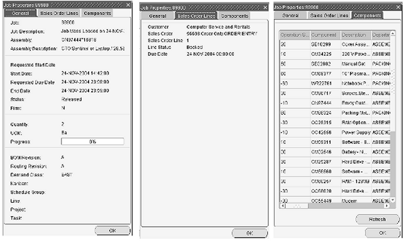

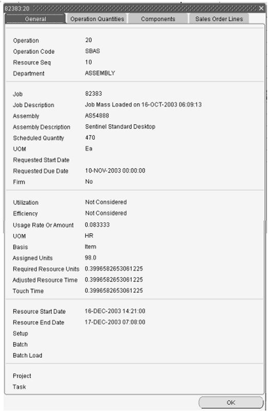

Job Properties Window
Job information is on three tabbed areas: General, Sales Order Lines, and Components. The data on the General tab originates from the Discrete Jobs window when you create the job, or derives through job transactions such as status and revision changes. This includes job and assembly number, description, dates, and quantity data. The progress bar displays a value that is calculated by the percent completed of all operations based on the time of each operation.
The Sales Order Lines tab displays information about all sales order lines linked to this job. This includes customer, status, and due date information.
The Components tab displays the component detail information for each operation sequence. This includes item master details, bill of material requirements, and quantity information derived through job transactions. You can update this view to display current transactions by choosing Refresh.
See: Defining Discrete Jobs Manually

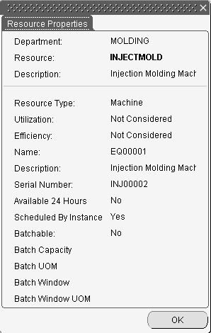

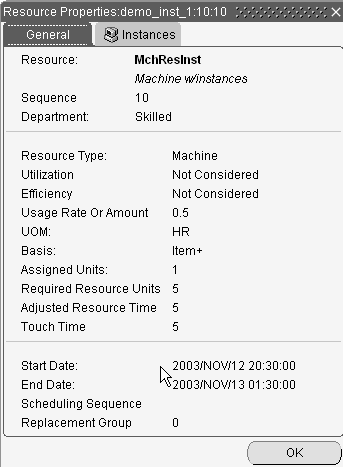

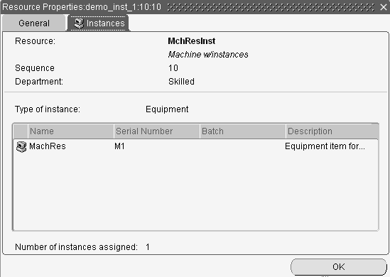

Job Resource Properties Window
The Resource Properties window consists of two tabbed areas. The information on the Resource Properties window displays resources assigned to a particular job operation. The data on the General tab originates from the Resource Requirements window when you assign a resource to an operation. The Instances tab displays the resource name, the type of instance, the instance names, and the number of assigned instances.
See: Adding and Updating Resource Requirements, and Defining Manufacturing Scheduling Resources
Assigning Resource Instances
You can assign resource instances to a job on the Job Workbench. Resource instances are defined on the Resource Instance window, and viewable in the Properties windows. See: Defining Manufacturing Scheduling Resources
Select a resource on the tree or Gantt chart, and right-click with your cursor to display the popup menu.
Choose Assign to Instance to display the Assign Instance window.
Select the instances you want to assign to this resource.
Choose OK to save your work.

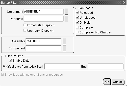

The Session Filter and the Startup Filter windows enable you to display specific jobs in the tree hierarchy and Gantt Chart, and eliminate jobs that do not meet your criteria. The Startup filter sets the initial display each time you open the workbench, the Session filter is used to change settings in a specific session.
To set job filter settings when opening the workbench
Select Startup Filter from the Tools menu to display the window.
You can select a department and resource. Only departments with jobs already defined display in this field.
If you select a department or resource, you can choose dispatch information, the values are:
Immediate Dispatch: Includes all job operations ready for production in the specified department or defined resource.
Upstream Dispatch: Includes all job operations that will be ready in the near future for production in the specified department or defined resource. This indicates a quantity of assemblies ready to be moved in the previous operation.
In the Job Status region, select the job status types to display on the workbench. Your choices are:
Released: The job is transactable
Unreleased: The job is planned but not released for work and not yet transactable
On Hold: The job is prevented from progressing through the production cycle
Complete: The job is complete and charges are allowed
Complete No Charges: The job is complete but charges are not allowed
You can specify Assembly and Component criteria information.
Use the Filter By Time region to use offset days in your criteria. Check Enable Date to enable the Offset days from today date fields.
Enter values, in days, to create the time period window around your system date for filtering. Jobs falling within this time period, in conjunction with other criteria, display. Jobs that overlap this time period display if part of the job is in the selected time window.
If you want to display jobs without attached operations or resources, check the Show jobs with no operations or resources box.
This box is disabled if you are filtering by department or resource. Departments identify which group is performing the operation, and are also used for charging resources at an operation. Therefore, these jobs would always have operations and resources defined.
Choose OK to save your filter criteria.

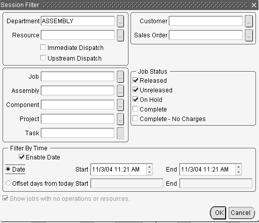

To filter job information for your session
Choose Filter from the tree pane to display the Session Filter window.
You can select a department and resource. Only departments with jobs already defined will display in this field.
Optionally, you can select a customer or sales order.
You can specify Job, Assembly, Component, Project, and Task criteria information.
In the Job Status region, indicate the job status types to display on the workbench: Your choices are:
Released
Unreleased
On Hold
Complete
Complete No Charges
Use the Filter By Time region to select date and time criteria. You can filter by either date or offset days. Check the Enable Date check box to enable these fields.
If you choose Date, select values in the Start and End date and time fields. Jobs falling within this time period, in conjunction with other criteria, display. Jobs that overlap this time period window can display if part of the job is in the selected time window.
If you choose Offset days from today, enter the number of days used to create the time period window around your system date. For example, if you enter 3 in the Start field, and 2 in the End field—jobs are filtered using a time period window of 5 days. That is 3 days before today’s date, added to 2 days after today’s date.
Choose OK to save your filter criteria. The Job Workbench refreshes and shows the selected jobs associated with the information entered.

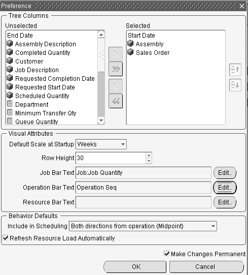

Data display on the workbench is controlled by preferences selected in the Preference window. You can select options for the tree display, bar display, and scheduling behavior.
To set display features on the Job Workbench
Choose Preference from the tree pane to display the Preference window.
In the Tree Columns region, select job fields you want to display on the workbench from the Unselected column, and move them to the Selected column.
The field values include
| End Date | Sales Order | To Move Quantity |
| Start Date | Scheduled Quantity | Assigned Units |
| Assembly | Department | Available 24 Hours |
| Assembly Description | Minimum Transfer Quantity | Basis |
| Completed Quantity | Queue Quantity | Resource Description |
| Customer | Reject Quantity | Resource Type |
| Requested Completion Date | Run Quantity | Setup |
| Requested Start Date | Scrap Quantity | UOM |
| Usage Rate | - | - |
The Visual Attributes region is used to select default bucket size, row height, and text display. In the Default Scale at Startup field, select the time line bucket size to display when you initialize the workbench. Your choices are Months, Weeks, Days, hours, 30 Minutes, and 15 Minutes.
In the Row Height field, select a value, in pixels, for the height of the row on the Gantt chart.
Note: Larger row height is optimal, visually, if you have overlapping resources.
The Job Bar Text, Operation Bar Text, and Resource Bar Text fields enable you to select the descriptive text displayed for the particular bar type. To select descriptive text, choose Edit to display the Bar Text window.
For Job Bar Text, select Job, Assembly, or Job Quantity.
For Operation Bar Text, select Operation Sequence, Department, or Standard Operation Code
For Resource Bar Text, select Resource Sequence or Resource Code
Select a category in the Unselected column, and use the arrow key to move to the Selected column. You can order the list by using the vertical arrow keys next to the Selected column.
Choose OK to save your work, and display the Preference window.
Set the default automatic scheduling option in the Behavior Default region. Set the scheduling method in the Include in Scheduling box. Your choices are:
Both directions from operation (Midpoint): Reschedules all prior and next operations when a time slot is found for the operation. Prior operations are backward scheduled. Next operations are forward scheduled.
Forward from operation (Midpoint Forward): Moves only the selected and next operations, keeping them in sequence, when a time slot is located to move this specified operation. Prior operations will not be rescheduled.
Backward from operation (Midpoint Backward). Moves only the selected and prior operations, keeping them in sequence, when a time slot is located to move this specified operation. Next operations will not be rescheduled.

Tool tip windows provide an ease of use mechanism for displaying start and end date information. The window is displayed by rolling your cursor over the appropriate resource bar on the Gantt chart. For more detailed information, you can access the Properties window.
Resource Tool Tip
The Resource tool tip window displays the following data: job name and description, operation, operation code, resource sequence, department, assembly name and description, quantity information, start date, and end date information.
The Bar Inspector tool tip window provides scheduling accuracy by displaying start date and end date information during a drag and drop action. This tool tip is available for job, operation, and resource instance bars on the Resource Workbench.
Information for each job and resource is displayed in Properties windows. These windows contain information about dates, quantities, assembly descriptions, sales orders, and customers. See: Properties Windows
Resource Properties Windows
The Resource Properties window displays information about a specific resource assigned to a particular department. You access this window by right-clicking on a specific resource in the tree. This window displays department, and resource name, type, serial number. It also displays resource factors such as utilization, availability, instance, and batch information.
Resource Properties for Job Operation Window
The Resource Properties window for the job operation is accessed by right-clicking on a job on the Gantt chart. It has four tabbed regions—General, Operation Quantities, Components, and Sales Order Lines. This window displays the same information as the Job Properties and Operation Properties windows on the Job Workbench, see: Properties Windows
You can view an entire job and all its operations and resources by accessing the View Job Information pane
To display the Job Information pane
Select a job on the Gantt chart, and right-click with your cursor to display the popup menu.
Choose View Job Information.
This pane displays the job name, assembly number, and all operations and resources for the selected job.
To view resource information, select an operation bar and right click to display the popup menu
Choose Properties, and select the Resources tabbed region in the Resource Properties for Job Operation window:
The Resources region lists all resources used for this operation.
Choose the Close box to close this pane.
Data display on the workbench is controlled by preferences selected in the Preference window. You can select options for the tree display, bar display, and scheduling default.
To set display features on the Resource Workbench
You can search for a resource by entering text in the Find field, and choosing Find.
The window moves to the section of the resource tree where your search string result is located.
In the Tree Columns region, select resources you want to display from the Unselected column, and move them using the arrow key, to the My Resources column. You can order the list by using the vertical arrow keys next to the My Resources column.
You can define specific machines to machine type resources, and specific employees to labor type resources. You can assign or override the resource instances assigned to the job.
Instances are defined on the Resource Instance window, and viewable in the Properties windows. You can assign resource instances on the Job Workbench, but you must navigate to the Resource Requirements window to unassign the instance.
To assign a resource instance on the Resource Workbench
Select a resource instance on the tree, for a specific resource.
Use your cursor to drag the instance to the instance rows for that specific resource.
Save your work.

You can adjust resource capacity to respond to machine or personnel availability. This includes: .
Delete or add a day of capacity, adjusting for overtime shifts or shop closures
Add or delete resource units when either extra resources are obtainable or resources are unavailable
Adjust Assigned Units or Usage Rate for the resource on the job routing
Simulation sets are used to link resource changes to available resource capacity. If the Use in Scheduling field is enabled on the Simulation Sets window for particular simulation sets, capacity modifications associated with that set are used when scheduling jobs. Simulation sets are defined, associated to resources in Oracle Bills of Material, and linked to Work in Process scheduling in Work in Process Parameters window. When you assign resources to departments, you can use simulation sets for capacity modifications by defining them on the Capacity Changes window in Oracle Bills of Material. See: Assigning Resources to a Department, Oracle Bills of Material User's Guide and WIP Parameters
There are two methods for adjusting resource capacity: You can change capacity in Oracle Bills of Material, or directly on the workbench.
To adjust capacity in Bills of Material
Navigate to the Departments window, see: Defining a Department, Oracle Bills of Material User's Guide
Choose Resources to navigate to the Resources window.
Select a resource, then choose Shifts to display the Shifts window.
Select a shift, and choose Capacity Changes to define capacity changes for a shift. The Capacity Changes window displays. See: Assigning Resources to a Department, Oracle Bills of Material User's Guide.
To adjust capacity in the Job or Resource Workbench
Select Adjust Resource Capacity from the tools menu, or right-click on a resource, and select Change Capacity from the popup menu.
Note: A resource must be assigned to a department and a shift to display this window.
This window displays the resource name and the department assigned, the simulation set used to link resource changes to available capacity, and any specified instances. In the Capacity Changes region, change or add information depending on the resource definition. If you selected a resource scheduled by instance, the only available value in the Action field is Delete a Day. For these resources, access the instance to adjust capacity.
In the Shift field, select available shifts from the list of values. Shifts are defined on the Shifts window when you are assigning a resource to a department.
Select the action you want to perform. The choices are Add Capacity, Delete a Day, Reduce Capacity, or Add a Day. You can only delete work days, and only add non-work days.
If you are adding or reducing capacity, select the capacity units you want to change.
In the Date fields, From and To, select the dates for this capacity action to occur.
In the Time fields, From and To, the values default from the shift information, but can be changed.
Save your work.

The Bar Inspector window displays, showing the Start and End Dates, as you are moving the bar.

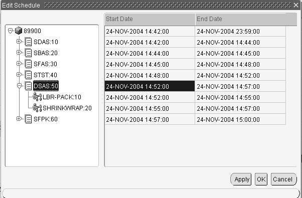

To manually forward or backward reschedule using the editor
Select a record to reschedule on the tree or Gantt chart, and right-click to display the popup menu.
Choose Manual Reschedule to display the Edit Schedule window.
If you have accessed this window from the Job Workbench, expand the job tree to display all operations and resources.
In the Start Date and End Date fields, enter the new dates for the specific job, operation, or resource.
Choose Apply to save your work. Or choose OK to save your work and close this window.
The bar moves to the new date when the Gantt chart is refreshed.
If you have accessed this window from the Resource Workbench, enter new dates in the Start Date and End Date fields.
Choose Schedule to save your work. The bar moves to the new date when the Gantt chart is refreshed.

You have the ability to print Gantt charts to use as referable hard copies on the production shop floor. This feature supports customizing the format and content, and offers a print preview. You can specify:
Date and time range
The level of job and operation details, or resource levels
Snapshot view of the Gantt chart
Number of jobs or resources to avoid a cluttered display.
To print a Gantt chart directly from the Job or Resource Workbench
Select Print from the File menu to display the Print window.
This window contains two tabbed areas: one for Print options and one for Page Setup.
In the Print Option tab, choose one of the options:
Screen snapshot: Prints the view exactly as it appears on the visible area of the screen.
Print options: Options are provided to print the number of records, level of detail, and time line.
If you chose Print options, you have the option to enter a value for the number of records printed.
For the Job Workbench, enter a value in the Number of Jobs box. Printing begins with the first job displayed on the Gantt chart.
For the Resource Workbench, select either All selected resources—or enter a value in the Number of Resources box. Printing begins with the first resource displayed on the Gantt chart.
In the Expand Level box, select the level of detail you want on the output.
For the Job Workbench, the levels are:
Collapse all: Displayed jobs are not expanded to other levels.
Expand all to Operations level: Jobs are expanded to the operation level.
Expand all to Resource level: Jobs are expanded down to the operation and resource levels.
For the Resource Workbench, the levels are:
Collapse all: Displayed resources are not expanded to other levels.
Expand all to Resource Instance level: Resources are expanded down to the resource instance level.
Choose a time line for the data on this report. Choices are:
Months
Weeks
Days
Hours
30 Minutes
15 Minutes
If you are printing the Gantt chart from the Resource Workbench, in the Date Range region, select Enable Date Selection to consider dates in your print version.
Choose one of the date options:
Number of days forward: Enables you to enter days forward from the current date to consider in the print output.
Date: Enables you to enter a date range in the Start and End date fields.
In the Page Setup tab, select the paper format orientation. Choices are Portrait or Landscape.
In the Paper Size for preview box, select a paper size for the Preview print option.
In the Manual scaling box, you can scale your Gantt chart printing by selecting a size of the original chart. This can be useful when charts contain great amounts of data, and you want to print on one paper size. You can:
Fit to page width
Fit to page height
Choose a value from 10% to 500% of the original chart
You can choose a print order for Gantt charts spanning multiple pages. Choices are:
Print rows first: Divide the output by printing all the rows first, then the corresponding columns
Print columns first: Divide the output by printing all the columns first, then corresponding rows
Choose Preview to access the Print Preview window. This enables you to view on screen your the result of your print selections, and return to the Print window to change settings.
Choose Print to print your Gantt chart.
