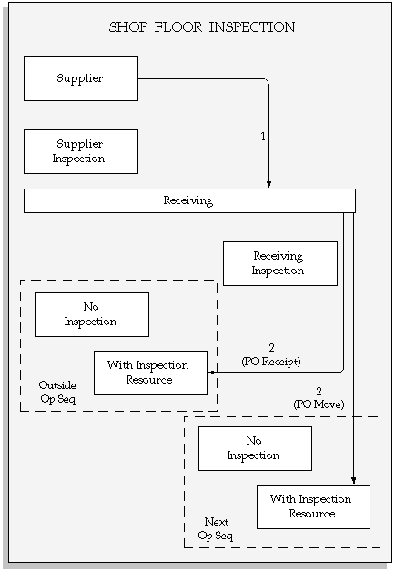

Oracle Manufacturing provides you with several options for inspecting your supplier work. In general, either you or your supplier can perform inspections.
If your suppliers perform inspections, they can then ship the assemblies directly to the next operation on your routing.
If you perform the inspection internally, you can define an internal inspection resource either at the outside operation or at a separate inspection operation with an inspection resource.
You can also receive the outside processed assemblies into a receiving inspection location in Purchasing and perform your inspection activities in receiving inspection. Then, you can deliver the assemblies to the shop floor and charge the job or repetitive schedule for the outside processing services.

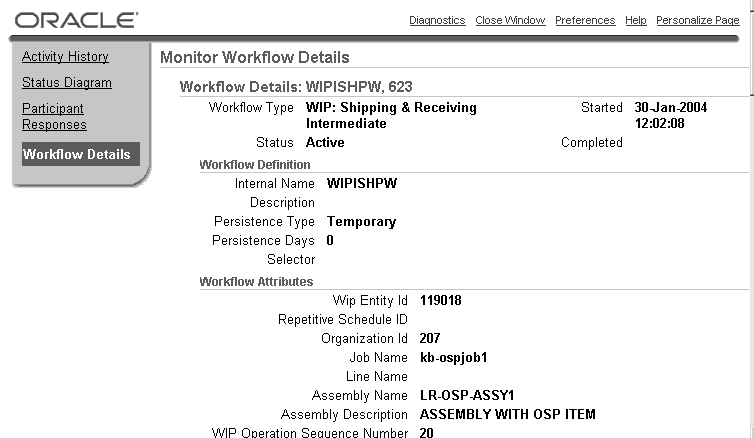

To enable you to track your outside processing assemblies from the shop floor to the supplier, Work in Process provides the following four workflows, which automatically send notifications and activate processes during specific points in the outside processing process:
Intermediate Shipment workflow tracks outside processing assemblies from the shop floor to the supplier.
Ship and Receive Intermediates workflow notifies the shipping manager and the supplier that outside processing assemblies are ready to ship.
Notify Second Buyer and Supplier workflow is used when you have two consecutive outside processing operations.
Change Order Approval Workflow in Oracle Purchasing is used to change date, quantity, or status on the purchase order. If the supplier approves the change, the need by date is updated on the requisition and the purchase order—and a notification is sent to the buyer and supplier.
In order to use workflow functionality, you must have Oracle Workflow installed. To enable outside processing workflows, your system administrator must set up the profile option WIP:Enable Outside Processing Workflow. You also must set up the Production Scheduler and Shipping Manager parameters. See: WIP Parameters and Profile Option Summary
The purpose of this workflow is to track outside processing assemblies from the shop floor to the shipping dock, and then to the supplier. The workflow is activated when you move assemblies into the Queue intraoperation step of an outside processing operation that has a PO Move resource charge type. It first imports pending requisitions, checks to see how many approved (non-cancelled) purchase orders exist for the outside processing supplier, then notifies the buyer.
Note: Only PO Move initiates the workflow.

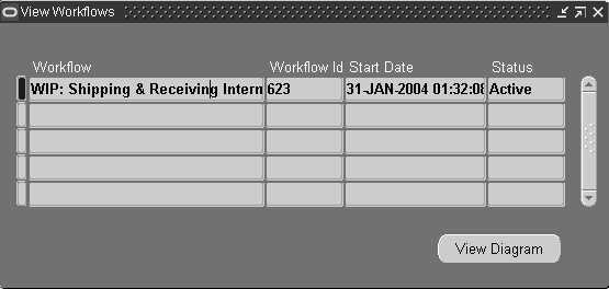

To view outside processing workflows
Navigate to one of the windows where you can access outside processing workflows.
You can view the progression and status of the workflows from the Discrete Jobs, View Discrete Jobs, Repetitive Schedules, and View Repetitive schedules windows.
From the Tools menu, select View Workflows.
The View Workflows window displays.

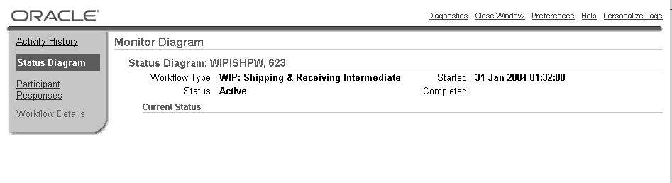

Select one of the workflows listed on this window and choose View Diagram.
This action launches your browser and the View Diagram appears.
This window enables you to select a view of the workflow including Active History, Status Diagram, Participant Responses, and Workflow Details.
Caution: The Monitor Diagram may not accurately reflect the workflow status correctly if the concurrent program is processing. The workflow may display no document found when using blanket releases and the following conditions exist:

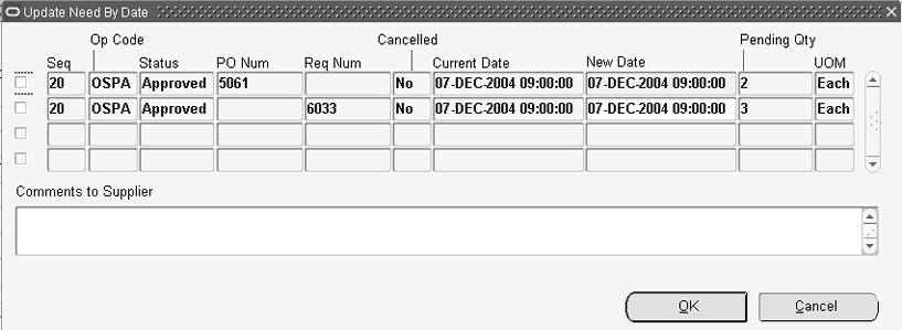

When the Update Need By Date window opens, it displays the Need by Date in the Current Date field for all requisitions and purchase orders associated with that operation. The check box for each operation sequence is enabled if there are existing requisitions and purchase orders with at least one day's difference between the values in the Current Date and New Date fields.
To change Need By Dates for a specific job or schedule
Navigate to the Update Need by Date window by selecting Update PO Need By Date in the Operations window.
To change the Need By Date, enter a value in the New Date column for all appropriate records.
Select the check box for the row you want to update, then choose OK.

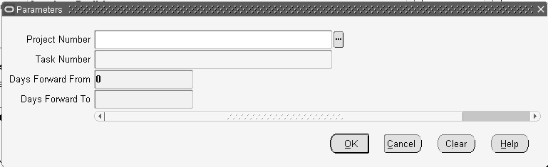

In the automatic method, you can initiate the Update OSP Need-by Dates concurrent program. If you have numerous jobs, updating the need by date manually is time consuming. The concurrent program automatically launches the workflow for Need By Date changes, associated with all appropriate work orders that are rescheduled. The concurrent program considers the tolerances set in the Work in Process Parameters window, see: Defining WIP Parameters.
To initiate the Update OSP Need-by Dates concurrent program:
Navigate to the Update OSP Need-by Dates concurrent program from the Discrete or Repetitive menus.
The Parameter window displays.
For discrete jobs, if you are using Oracle Projects or Project Manufacturing—you can search by Project Number and appropriate Task Number.
In the Days Forward From and To fields, , enter the range of days in the future to consider changes.
For example, if these values equal 2 days, and your program is scheduled to run daily–it will pick up requirements for jobs and schedules up to 2 days forward. Changes after two days are picked up by the concurrent program when it is scheduled to run next.
Choose OK to save your work and display the Request window.
Choose Submit to initiate the program.
