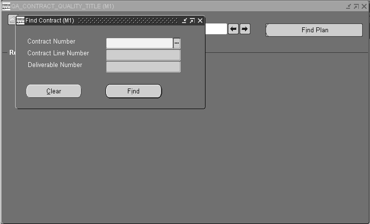

Oracle Quality's integration with Oracle Project Contracts is accomplished through other manufacturing transactions, including WIP Move, WIP Completion, WIP Work Order-less Completion, Purchasing Receiving, and Purchasing Inspections. Transactional data is collected using Project Number and Task Number Collection Triggers.
You can enter project contract quality results directly. See: Entering Quality Results Directly, and query quality data, based on a Contract, Contract Number, and Deliverable Number combination.

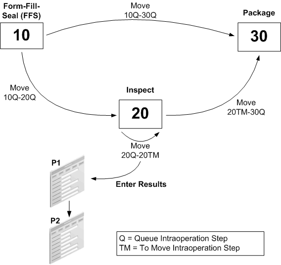

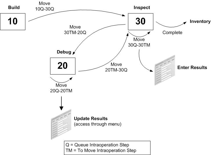

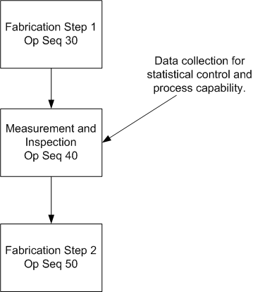

The following are examples of how you might set up your routings to support meaningful integration with Oracle Quality via collection triggers. They are designed to show you how you might address some of the same issues that may arise during the set up process.
If you are performing inspections on 100% of your assemblies at key points in your assembly process, you would likely set up inspection operations as part of your assembly's routing. The Defect Code Pareto Analysis business example for the RF transmitter manufacturer used this kind of approach.
The following diagram illustrates the above text.
The inspection operation needs to be last in the routing because 100% inspection is required. Making the inspection the last operation ensures that all of your assemblies, including those that may need to be reinspected if any debugging or reworking has taken place, are inspected because all assemblies must pass through the To Move step of the last operation before they can be completed. Your debug operation should not be a count point operation, and as such, should not be the last operation on your routing.
Since all of your assemblies must go through the inspection operation, this operation should be a count point operation. Defining the collection trigger as a move into the To Move step of the inspection operation ensures that the results are entered when the inspection work at the operation is done and the assemblies are ready to move on, either into Inventory or to the debug operation. Triggering results collection off a move into the last intraoperation step of the operation helps ensure that the qualified personnel at the inspection operation enters the inspection results. Note that the move that triggers the quality data collection could be an intraoperation move, as shown in the diagram, but could also be an interoperation move straight into To Move of the inspection operation.
You should use the Update Quality Results window to update the results records with appropriate defect and disposition codes. You can access this window through the Oracle Quality menu.

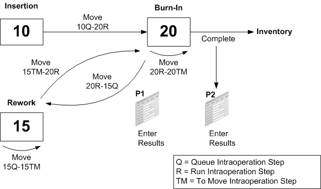

If inspection is part of your standard routing for an assembly, but only a fraction of your assemblies actually go through inspection, you may want to use the routing model illustrated in the following diagram:
The medical compound manufacturer in the Yield Reporting example used this particular model. While this routing contains similar steps as the previous example, the key difference is that not all assemblies are inspected. Therefore neither the inspection nor the disposition operations should be count point operations. This means that if you do a move transaction from operation 10, operation 30 (i.e. the next count point operation) is defaulted as your "to" operation. You should override the default for those assemblies that are to be inspected.
A move into the To Move step of your inspection operation can once again serve as the collection trigger for results entry.

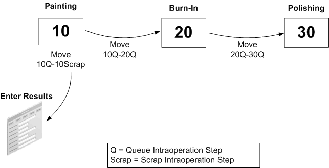

You may want to capture quality information only when there is a quality problem. You may also want to give employees at every point on the routing the authority to report a quality problem, regardless of whether the operation is an inspection operation. The simplest way to support this need would be to use the routing model, illustrated in the following diagram:
In other words, you simply use your regular routing, and define a collection trigger to fire on move into the Scrap intraoperation step. You can make this specific to one or several operations, or use the same trigger to fire whenever a move to Scrap is entered.
Similarly, you could define moves into Reject to be a collection trigger for quality results entry.
The rework operation should not be a count point operation, since you do not expect to be moving all assemblies into the rework operation. The example shows two collection triggers associated with the rework operation, one fires when you move into the Queue of the rework operation from any other operation, the other fires when you do an intraoperation move to the To Move step of the operation. The first collection plan, P1, might have the Employee ID, the operation sequence or resource ID of the machine where the defect was discovered, and a free text description of the problem captured at the source, and it may invoke an action rule to alert the rework center that a failed assembly is on its way. This could be particularly relevant if the rework operation is in another building, or tends to get overloaded. P2 may include more detailed information, i.e. information that becomes available after some analysis has been done at the rework operation.
The advantage of using two collection plans rather than using one and updating it, is that you can invoke both collection plans through collection triggers. If you used one collection plan, as in the previous example, you would have to update it to enter the results of your analysis by accessing the Update Quality Results window through the menu. The advantage of having only one collection plan, on the other hand, is that results are typically displayed by collection plan.
Your process may include inserting resistors into circuit boards. The boards then go through a burn in period so that any early failures can be detected and reworked. Each unit that passes the burn in period is further tested for voltage measurement before it is completed and put into inventory. You are interested in capturing the quantity of units that pass or fail burn in, as well as in ensuring that the test activity is performed and that appropriate test results are captured.
To accomplish this, you have to define two collection plans.
Plan P1 will be associated with the Run intraoperation step of the burn in operation and will capture the quantity of units that pass or fail burn in. This plan will be triggered whenever you move your boards from the Run intraoperation step of the burn in operation. You thus will be able to capture both the quantity of units that pass burn in (20R-20TM), as well as those that fail (20R-15Q) it and have to be reworked. Since only some of your assemblies will undergo rework, the rework operation will not be a count point operation.
Plan P2 will be triggered by the Work in Process Completions transaction to enforce testing and collecting the results. In this plan, if your assemblies are under serial control, you can capture the test voltage pertaining to each serialized assembly. Later on, you may want to query up historical information about the serialized assemblies.

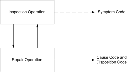

You are the quality manager for a manufacturer of radio frequency (RF) transmitter equipment used in fiber optics communications applications. Your long-term quality goal is to achieve zero-defect manufacturing. However, you realize that small step improvements are required before your long-term goal can be reached. Therefore your immediate short-term goal is zero-defects in one particular area - customer shipments.
To meet this goal you must implement procedures that ensure that every transmitter is tested with a power meter at an Inspection station before it leaves the factory. To ensure a "flat" response over a wide range of frequencies, two samples are taken based on a given frequency input. The resultant output measured in decibels (DB) is an indicator of how well the RF transmitter meets customer requirements. The choice of input frequency used depends on the type of transmitter you are building, i.e. on the item model. For instance, for one model, the RF transmitter model, has output of 20 dB +/- 0.5 at an input frequency of 10 megahertz (Mhz) but has an output of 19.5 dB +/- 1.0 at an input frequency of 500 Mhz.
When a transmitter fails test, a Symptom Code that clearly describes the observed results is assigned and the unit is moved to a repair operation. Based on the Symptom Code, directed analysis in the repair area leads to the assignment of a Cause Code and subsequently a Disposition Code.
You can use inquiries, reports, and Pareto Charts to analyze the most common causes of defects. Appropriate corrective actions can then be taken to ensure that your long-term goal of zero-defect manufacturing is met.
The following diagram illustrates the quality data collection points discussed above:
Based upon the above information, you have determined that you need to create a RF Transmitter collection plan that includes the following collection elements:
Job
Item
Serial Number
Transaction Date
Assembler ID
Symptom Code
Cause Code
Disposition Code
Date of Manufacture
Low Frequency
Low dB Reading
High Frequency
High dB Reading
Quality Control Id (Employee Id of the person performing the analysis
Of the collection elements listed above, six (Assembler ID, Low Frequency, Low dB Reading, High Frequency, High dB Reading, and Quality Control Id) are user-defined. All others are predefined (Symptom Code, Cause Code, and Disposition Code) or context elements (Job, Item, Serial Number, and Transaction Date). See: Defining Collection Elements.
Specifications ensure that products are useable and are typically based upon customer requirements. Therefore the next step is to define an item specification, 'RF Transmitter1', specifically for your Model 1 RF Transmitter. Note that you can define separate specifications for each transmitter model that you manufacture.
Add the Low DB and High DB collection elements to the RF Transmitter1 specification. If the required specification limits for these collection elements, 19.5 dB +/- 1.0 and 20 dB +/- 0.5 respectively, have been defined for the collection element they are automatically copied as you add them to the specification. If they have not been defined, you can define them in the Specification Elements window. See: Defining Specifications and Defining Specification Elements.
Finally, add the Low Frequency and High Frequency collection elements to the specification. If the required target values for these collection elements, 10 megahertz (Mhz) and 500 (Mhz) respectively, have been defined for the collection element they are automatically copied as you add them to the specification. If they have not been defined, you can define them in the Specification Elements window. If you set the QA:Default Specifications Target profile option to Yes, these target values are automatically defaulted when the RF Transmitter collection plan is invoked by a move transaction.
You can define lists of values or SQL validation statements for the required predefined attribute collection elements (Symptom Code, Cause Code, and Disposition Code) and for your user-defined collection elements. Lists of values can be defined at the collection element level and copied to their corresponding collection plan elements. However, you can also define unique lists of values for the collection plan elements. For example, the list of values for the RF Transmitter collection plan elements Symptom Code, Cause Code, and Disposition Code - Okay and Failed, Not Applicable and Assembler Error, and Not Applicable and Scrap respectively - are unique to only this collection plan. See Defining Collection Element Values and See: Defining Collection Plan Element Values.
Important: Upper and Lower Specification Limits are not required for the Low Frequency and High Frequency specification elements since frequency is an input in testing RF transmitters.
Next, create the "RF Transmitter" collection plan and add the above listed collection elements to it. All collection plan elements, except Cause and Disposition Code, should be defined as displayed and mandatory. Cause and Disposition Code should be defined as non-mandatory so that they can be skipped when you enter your initial results. Later, after further results analysis has been done, they can be updated using the Update Quality Results window.
Next, define appropriate actions for each of your collection plan elements. For example, when a Symptom Code results value of 265 (indicating no signal output) is entered, you can send a message to the power meter operator that says "Db reading is too low. Please move this item to the repair station." See: Defining Collection Element Actions.
Next, associate the RF Transmitter collection plan with the WIP move transaction. The move transaction should be made mandatory to ensure that quality data is collected before the move transaction is saved.
Based upon the moves shown in Figure 1 - from Final Assembly operation to Inspection, from Inspection to Repair, from Repair back to Inspection - define the following collection triggers and conditions:
From Operation Sequence Number <= 50 (Inspection)
To Operation Sequence Number > 50 (Inspection)
The above collection triggers and conditions accomplish the following:
Assemblies cannot be completed into inventory from Operation 40 (Final Assembly) without passing through Operation 50 (Inspection)
All moves into Operation 60 (Repair) trigger mandatory data collection
Important: Multiple results entries for a serial number indicate that the item was repaired, perhaps more than once.
Last, assign a default specification type to the collection plan, in this case an item specification. Assigning a default specification type ensures that an appropriate specification can be chosen during quality data collection.
As transmitters are moved into the Inspection operation, the RF Transmitter collection plan is invoked. Because a specification type has been associate with the RF Transmitter collection plan, a specification - in this case the RF Transmitter1 specification - should be selected before data collection can begin.
The inspector is prompted for the serial number of the transmitter and for the assembler's ID (the assembler ID is noted on the routing sheet that the inspector receives along with the transmitter). Low and High Frequency default values, defaulted from the Low and High Frequency specification element target values, are automatically displayed. The inspector tests the transmitter using the suggested frequencies, then enters the corresponding Low DB and High DB results values. If both DB values are within the specification limits defined for the RF transmitter, the inspector enters the "Okay" Symptom Code and "Not Applicable" Cause and Disposition Codes. The tested transmitter can now be completed into inventory.
If however, the Low or High DB value is outside the specification limits, the message action "Item DB is outside specification. Please route item to repair station." is invoked. The inspector selects the failed Symptom Code, but because they are not mandatory, skips data entry for the Cause and Disposition Code. Once quality data collection is complete, the failed transmitter is moved to the Repair operation.
In the Repair operation, a technician determines the exact cause of the problem, fixes it, then updates the Cause and Disposition Code values using the Update Quality Results window. Once the problem is fixed the technician moves the transmitter back to the Inspection operation where the process is repeated until the transmitter passes inspection. Transmitters that pass test can be completed into inventory.
The following diagram illustrates the process operations discussed above:

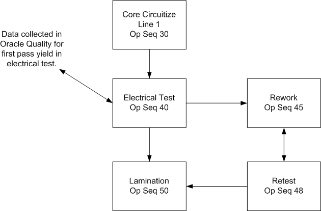

Based upon this business example, you have determined that you need to create two collection plans. The first, First Pass Yield, should include the following collection elements.

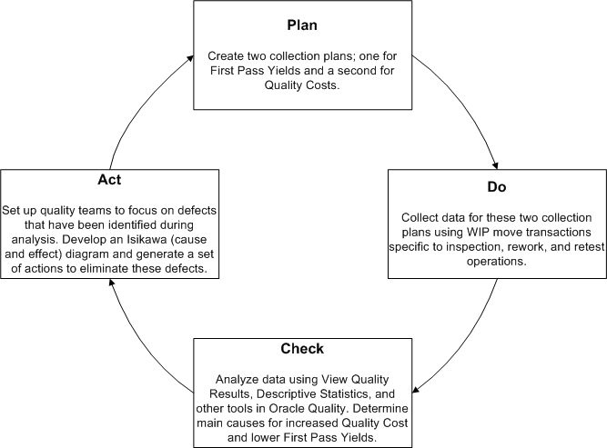

After a few jobs are processed in the Circuitize operation and enough sample data has been collected, the quality team can choose to analyze data either after a given number of jobs have been processed or days have elapsed or after a member of the quality team is notified that the first pass yield has dropped below the threshold level of 70 percent.
The team can then view and chart quality results in a variety of ways. For example:
By item
By product type
By job
Data can be viewed in View Quality Results then exported to a statistics program/package and checked for differences between data sample subgroups. Statistical tests can be performed to determine differences in product types. Histograms can be created for to check for First Pass Yields differences between jobs.
The patterns of defects within subgroups can be further analyzed using Pareto charts. In this example, two important subgroups in such an analysis would be the subgroups resulting from open and short defects. Differences in subgroups should always be investigated since they reveal process anomalies that, once corrected, contribute to the continuous improvement process.
A preliminary data analysis soon reveals that the primary cause of low first pass yields is 'open' defects. The operators performing the rework validated this conclusion when they met with quality team members. Furthermore, these operators stated that open defects occurred more frequently in core items.
Based on results of the quality teams data analysis and real-time observations, you have decided to focus your efforts on investigating the causes of open defects. As part of this investigative process, you have called a meeting with the quality team and performed a cause-and-effect analysis using an Ishikawa diagram. From this brainstorming session a list of the factors that contribute to defects has been drawn. These factors include:
Conveyor speed
Concentration of Etch chemicals
Laminator pressure
Thickness of copper
Your next step is to narrow this list of factors down to just one key factor using statistical tools. First a factorial experiment, an industrial experiment that statistically analyzes the effects of various factors on product quality, is designed and executed. Then the data from this experiment is analyzed using a statistical analysis software package. Analysis reveals that conveyor speed is the major factor influencing first pass yields. Therefore the quality team recommends that conveyor speed be increased by about 20 percen%.
After increasing the conveyor speed there is a noticeable increase in the first pass yield. Thus the team has achieved their first small step towards process improvement. To close the loop in the continuous improvement cycle, an analysis of post-process improvement data is made and plans to further reduce defects are made. This cycle of improvements is consistent with the Deming cycle for continuous improvement.
The following diagram illustrates Deming's Circle For Continuous Improvement:
Using the Descriptive Statistics window, select the Cost of Quality collection plan and generate descriptive statistics using the Total Quality Cost collection plan element as the statistical element. You can generate descriptive statistics based on all or selected subgroups of data. For example, using the search capabilities of the Show Results Where region, you can select and analyze results that are specific to an Item, a Job, or a specific Defect Code. The statistical sums of the various subgroups represent the cost of quality.

You are the general manager for a precision sheet metal job shop specializing in high quality fabricated parts to the computer industry. Customer orders are usually large and are built-to-order by job based on customer specifications. Each part produced has several critical dimensions that should meet customer specifications. In an effort to meet high quality standards, you have implemented a quality improvement program throughout the shop.
Process result for all critical dimensions are collected on the shop floor. For example, one critical dimension is the width of a rear flange that is formed on a press brake. The press brake operator measures the flange width immediately after forming the part. Measurements are randomly taken for four parts produced over the life of the job; for example, the first and last parts produced on the job as well as two from the middle might be measured. The deviation between the specified and actual flange width is calculated by subtracting the actual width from the nominal specification width stated by the specification. Although specifications can vary for each customer, the deviation specification for flange width is 2.0 +/- 0.04 units for all customers.
The immediate goal of your quality improvement program is to maintain a process capability index of at least 1.2. By agreement, process capability is to be estimated only after 40 measurements are recorded. The two Process Capability indices used most often in evaluating the relationship between the process and the customer are Cp and Cpk. They are described mathematically as follows:
| Cp = (upper spec - lower spec) / 6 * Standard Deviation |
| Cpk = min {(Mean - Lower Spec ) / 3 * Standard Deviation, (Upper Spec - Mean)} / 3 * Standard Deviation |
Cp measures how dispersed the data is without regard to whether the data is evenly distributed around the midpoint between the Upper and Lower Specification Limits (usually referred to as the nominal value).
Cpk weights the dispersion of data about the nominal which usually lies as a midpoint between the Upper and Lower Specification Limits. The denominator in the Cpk index indicates how much room is needed on either side of the mean to contain most of the distribution. The numerator measures the amount of room from the mean to the specification on the side where there is less room. For both Cp and Cpk, higher values are better and indicate higher process capability.
Cp depends only on the value of the standard deviation and is not affected by the relative position of the mean with respect to the nominal specification. On the other hand Cpk considers the value of the standard deviation and the mean. However, before estimating process capability the issue of statistical control should be addressed. Without statistical control, process capability estimations may prove erroneous due to the inherent instability of the process. Therefore, statistical control should be established before calculating process capability indices.
When a process is in statistical control - is operating with the minimum amount of variation possible (the variation due to common causes) - it can be expressed mathematically as follows:
| Standard Deviation = s = Rbar / d2 |
Using the above expression it is possible to calculate process capability using the Rbar value from a Xbar and R chart. Establishing statistical control for flange width became a priority action item. A quality team was set up in the sheet metal job shop. They established three objectives which are:
control the process
measure process capability
improve the process
Create collection elements and a collection plan as described below.
Define the user-defined collection elements Flange Width, Deviation and Machine number in collection element setup.
Create a collection plan called "Rear Flange" with the following collection elements:
Item
Job Number
Customer Name
Specification
Employee Name
Machine Number
Flange Width
Deviation
The following diagram illustrates the process flow for the fabricated parts:
Choose the Transactions button in Collection Plan window. Select the move transaction and define the following collection triggers and conditions:
From Operation Sequence Number <= (at most) 40
To Operation Sequence Number > (greater than) 40
Item = (equals) rear flange
Make results entry for the move transaction mandatory using the Mandatory check box.
Associate the collection plan with a customer specification using the Specification button in the Collection Plans window. This ensure that you are prompted to select a customer specification when the collection plan is invoked as you enter move transactions.
The team wants to populate the collection element Specification with the specification value for Flange Width for the customer entered during data entry. This can be achieved by setting the QA:Default Specification Target profile option to Yes. See: Profile Options.
When the default specification value is use, the correct specification for a given customer name is automatically defaulted. The next step is to calculate the deviation of the flange reading from the specification. We use user-defined formula to calculate the deviation. The steps are as follows:

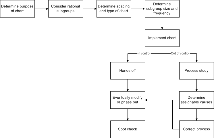

Every customer has a different set of specifications for Flange width. Therefore for every customer a flange width specification is created in Specification setup. There were seven different customers and therefore a similar number of specifications were created. For the sake of convenience the specifications were provided with their respective customer names.
The quality team is interested in examining the control chart after 40 readings have been recorded in the collection plan.
The collection plan is now ready for collecting data. Every job containing Rear Flange triggers a collection plan where the inspector after selecting the customer specification enters readings on flange width. The team uses the View Quality Results window to see whether at least 40 records have been entered in for the Rear Flange collection plan. After two days, they realize that the requisite number of readings is available for analysis.
The team devises a plan for control chart implementation. They realize that certain considerations are paramount in initiation of a control chart including rational sub-grouping, type of chart, frequency and the type of study being conducted. Their initial conclusion is that the chart should be an Xbar and R chart.
An examination of the control charts reveals that the process average is not under control. This implies that the average is affected by assignable causes on several occasions:
Three separate points above Upper control limit: point 10,14,17
Three separate points below Lower control limit: point 7, 11, 15
In addition, there is excessive short term variation represented by:
as discussed previously. Even with an R chart in control, the manufacturing process for flange width is not constructed to meet the desired specifications.
As shown below, the pattern suggests that the process average crept upward then was probably adjusted downward. This adjustment cycle, which was repeated for a total of four cycles, is an observation worth investigating.
The inherent process capability was estimated as follows:
| Standard Deviation = Rbar / d2 = 0.057 / 2.06 = 0.027 |
and 6 times the standard deviation, which is 0.162, and the specification width is 0.08 which means that the inherent variability is twice what is specified.
Two major types of investigations are needed to reduce the process variability to the stated specifications:
What are the important assignable causes producing the shifting process average shown by the X bar control chart?
Once identified, how can improvements be effected? The control chart can be continued and watched by production personnel to learn how to control this average.
What are the possible ways of reducing the inherent variability of the process as measured by the standard deviation?
Sometimes relationships between recorded adjustments made in the process and changes in the Range chart can be helpful. For example there is a suggestion that the process variation increased during point 14 to 18 on the R chart. This suggestion would usually be disregarded in routine production; however in a process capability study (which is an industrial investigation of the ability of a process to manufacture within specification) it would warrant investigation.
These two major investigations can lead to other major studies and with every study a greater understanding of process variation takes place. The quality team turns this knowledge into action items and implement them. These action items result in a predictable measure of statistical process control. With every improvement step a SPC chart is generated and process capability is remeasured and the continuous improvement cycle is repeated.

To query project contract data
You can query quality data for the three Project Contracts collection elements, which include Contract Number, Contract Line Number, and Deliverable Number.
Navigate to the Find Contract form.
Enter a Contract Number.
Optionally, enter the Contract Line Number to view specific information.
Optionally, enter the Deliverable Number of the contract. You can only enter data into this field if you entered a Contract Line Number.
Select Find to view quality information.
