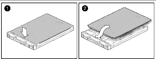

1. Press down on the cover release button and, using the indent for leverage, slide the main cover toward the rear of the chassis approximately 0.5 inch (12 mm). See FIGURE 4-2.
2. Grasp the cover by its rear edge and lift it straight up from the chassis.
FIGURE 4-2 Removing the Main Cover

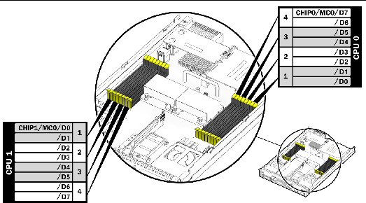

3. Press the fault indicator button on the motherboard to illuminate the LED for the DIMMs that have failed.
FIGURE 4-9 Fault Indicator Button Location

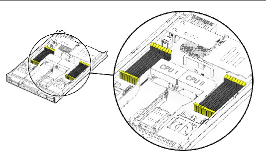

4. Locate the DIMM slot on the motherboard into which you plan to install or replace a DIMM.
The DIMM ejector levers contain LEDs that can indicate a faulty DIMM:
FIGURE 4-10 Sun Blade X6240 Server Module DIMM Slot Numbering and Pairing

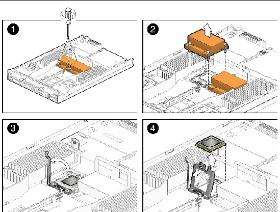

Follow these steps to remove and replace a CPU and its heatsink in a Sun Blade X6240 server module.

5. Remove the CPU and heatsink from the motherboard:
a. Hold down on the top of the heatsink to prevent it from tipping unevenly while you alternately loosen the four spring-loaded mounting screws that secure the heatsink to the motherboard.
Turn the screws 180 degrees at a time, and then remove the screws when they are detached. See FIGURE 4-18.
FIGURE 4-18 Removing the Heatsink and CPU
b. Twist the heatsink slightly to lift it off the board. Turn the heatsink upside down and allow the spring in each of the four mounting holes to fall out into your hand.
Note - Set the heatsink upside down on a clean, flat surface to prevent the thermal grease from contaminating other components. |
6. Pull the CPU socket lever slightly away from the socket.
a. Pivot the lever up, into the fully open position.
b. Open the hinged plate that covers the CPU until it is in the fully open position.
c. Lift the CPU out of the socket, leaving the lever and plate in the open position.
7. Install the new CPU, or reinstall the existing CPU.
FIGURE 4-19 shows how to install the CPU and heatsink.
FIGURE 4-19 Installing the Heatsink and CPU
