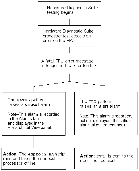

The Hardware Diagnostic Suite uses the Sun Management Center Hardware Diagnostic Suite feature to trigger and display alarm conditions for the host you are testing. By default, every Hardware Diagnostic Suite test session error message triggers a Sun Management Center critical alarm. The alarm is displayed in the Sun Management Center console. Additionally, you can define which Hardware Diagnostic events trigger Sun Management Center alarms, and you can define the actions that take place when an alarm occurs.
Sun Management Center can be configured to send email when certain alarms are triggered, and to execute scripts that perform an action on the system. For example, if the Hardware Diagnostic Suite detects an error on one FPU of a multiprocessor system, the event can raise an alarm that automatically triggers the execution of a script that takes the suspect CPU offline. In the meantime, an email notification is immediately sent to the system administrator. See FIGURE 5-7 for a flow chart of alarm actions.

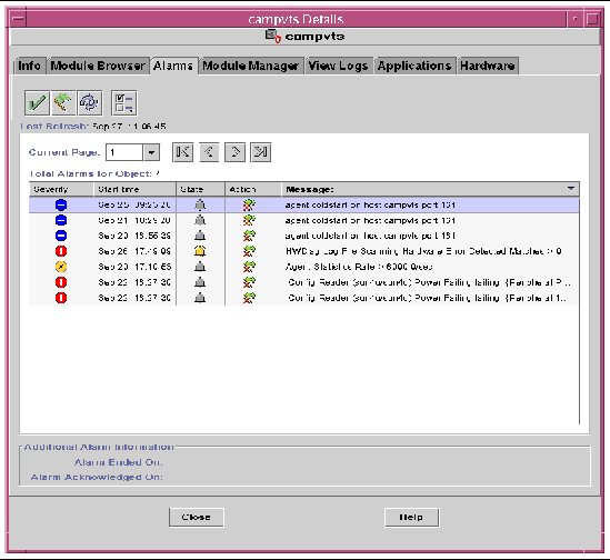

2. If an alarm exists, follow these steps to view and acknowledge the alarm condition:
a. Double-click the host in the main Sun Management Center window to open the Details window.
The Alarms window is displayed (FIGURE 5-1). All alarms for this host are displayed.
3. To acknowledge an alarm, select the alarm and click the check button
The alarm is marked acknowledged in the Alarms tab list. Acknowledged alarms are not displayed in other Sun Management Center windows.

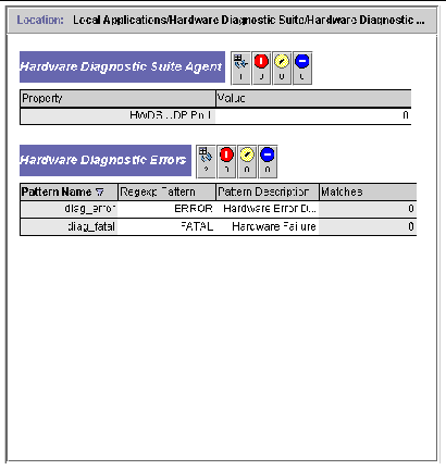

The Hardware Diagnostic Suite Agent properties are displayed (FIGURE 5-2).
TABLE 5-4 describes these properties.
Used for communication between Hardware Diagnostics agent and server. |
Specifies the Pattern Name property. Pattern Name is the index key for this table and must be unique. Default Hardware Diagnostic Suite Error pattern names are: |
Specifies a description for the regexp patterns. Hardware Diagnostic Suite descriptions are: |
Defines the pattern that generates the alarm. The default Hardware Diagnostic Suite patterns are: ERROR--When this pattern occurs in the Hardware Diagnostic Suite log file, this indicates that a hardware error that requires intervention occurred. It might be due to missing media, a loose cable, or a disconnection. FATAL--When this pattern occurs, it is an indication that the hardware failure was unrecoverable. The Hardware Diagnostic Suite test might have detected a data miscompare or a hardware error. See TABLE 4-3 for descriptions of Hardware Diagnostic Suite error types. |
Displays the number of pattern matches that have occurred. When this number matches the alarm threshold, an alarm is triggered. This table cell is also used to define the alarm thresholds as described in Step 6 through Step 9. |

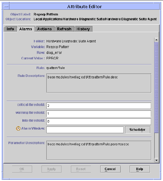

6. Select either the ERROR or FATAL data property by clicking on the Regexp Pattern table cell. (See TABLE 4-1 for error type descriptions.)
7. Open the Attribute Editor by doing one of the following:
The initial Attribute Editor panel shows information about the attribute. You cannot edit the properties for alarms in this panel.
8. Select the Alarms tab in the Attribute Editor.
The alarms panel is displayed (FIGURE 5-3). This panel enables you to set alarm thresholds.
[ D ]
9. Define the desired alarm thresholds by entering the appropriate numbers in the alarm threshold fields.
The alarm threshold determines the type of alarm to generate based on the number of pattern matches that occur (TABLE 5-5).
For example, you select the attribute editor for the FATAL pattern Regexp column. You enter values of 3, 2, and 1 for critical-threshold, warning-threshold, and info-threshold respectively.
When a Hardware Diagnostic Suite test session logs fatal errors, the type of alarm now displayed would be:
The default thresholds for both diag_error and diag_fatal patterns are:
To reset the thresholds to Hardware Diagnostic Suite default values, enter blanks in the fields.

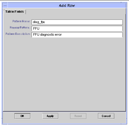

2. To add a new Hardware Diagnostic Suite log file pattern that will generate an alarm condition, perform the following steps:
a. Right-click anywhere on the Hardware Diagnostic Errors Table and select New Row from the pop-up menu.
The Add Row dialog box appears (FIGURE 5-4).
b. Enter information in the fields using the descriptions in TABLE 5-6.
Refer to TABLE 5-4 for detailed explanations of these fields.
Specifies the name of the alarm condition that you are creating. |
Specifies the regular expression (pattern) that generates the alarm condition. |
c. Complete one of the following actions:
d. Create the alarm thresholds that define the type of alarm that is triggered.
For instructions on how to do this, see To Edit the Alarm Thresholds for Hardware Diagnostic Suite.
Once you apply your changes, the new row is inserted in the table. If a Hardware Diagnostic Suite test session logs a message that contains the pattern you specified, an alarm is generated for that host.
By default, the Hardware Diagnostic Suite sends email to root when an Error or Fatal error is detected. However, you can customize the alarm action to do something different, such as run a script.

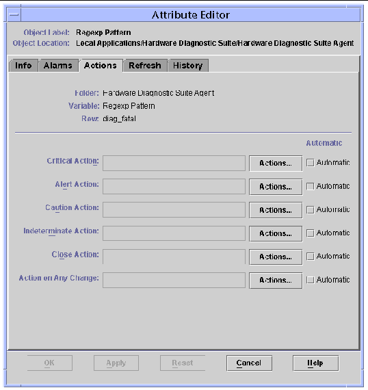

3. Select the Actions Tab in the Attribute Editor.
The Actions menu is displayed as shown in FIGURE 5-5. TABLE 5-7 describes the fields.
[ D ]
4. Add an action to the action fields.
You can only specify one action in an action field. To have more than one action (to send email and run a script, for example), you must specify the actions in separate fields. The following example describes how to do this.

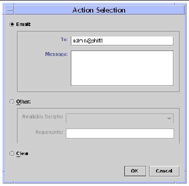

a. Click the Actions button next to the level (Critical, Alert, and so on) of your choice.
The Action Selection window is displayed (FIGURE 5-6).
b. Specify the email recipient.
c. To create an action that runs a script when a critical Hardware Diagnostic Suite alarm is raised, perform the following:
i. Place the script in the /var/opt/SUNWsymon/bin directory, making sure that execute permissions are set.
Note - The script must reside in the /var/opt/SUNWsymon/bin directory before you can select it from the Action Selection pull-down menu. It is run with superuser privileges. |
ii. Select the script from the Available Scripts pull-down menu.
