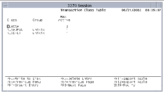

1. Start the region where you want to define transaction classes.
2. Type CTBL on a blank transaction screen to start Table Manager.
3. Press PF5 to display the Extended Tables menu.
4. Press PF1 to open the Transaction Class Table (TXC) shown in FIGURE 4-1.
[ D ]
5. Press PF4 to add a transaction class.
You can define a maximum of 62 transaction classes.
6. Type values in the following fields:
a. In the Class field, type the name of the transaction class; up to eight characters.
b. If you are using groups, type a group name in the Group field; up to eight characters.
c. In the Max Active field, specify the maximum number of transactions in this class that can be running at one time.
This is also the number of transaction processors that are assigned to this class. Values can be 0 - 1024. If you specify zero, any message arriving for this class will be queued and stay queued until a transaction processor is assigned to the class by CEMT SET TRANCLASS or the EXEC CICS SET TRANCLASS command.
7. When you finish adding transaction classes, press Enter to add the entries to the table.
8. Press PF3 to return to the TXC main screen.
9. Press PF2 to write your changes to disk.
10. Press PF3 twice to return to the Table Manager main menu.

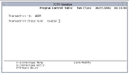

You assign transactions to classes in the region's PCT. If you do not explicitly assign a class, the transaction is assigned to the KIXDFLT class.
1. On the Table Manager menu, press PF4 to display the Standard Tables menu.
3. Select a transaction and press PF9 to display the transaction class screen.
[ D ]
4. Type the name of the class to which to assign the transaction.
You can use the PF7 and PF8 keys to find other transactions to assign.
5. Press Enter to accept the changes and return to the PCT main screen.
6. Press PF2 to write your changes to disk.
7. Press PF3 twice to return to the Table Manager main menu.

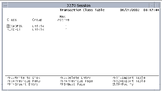

Before deleting a transaction class, change every entry in the PCT that is assigned to that class. This section contains two procedures: one to use if you only have a few transactions to change, and one to use if you have a large number of transactions to change.
3. For each transaction whose class you are deleting, you must select the transaction and press PF9 to display the transaction class screen.
4. Change the name of the class to which the transaction is assigned.
On the transaction class screen, you can use the PF7 and PF8 keys to find other transactions to change.
5. Press Enter to accept the change(s) and return to the PCT main screen.
8. Press PF5 to display the Extended Tables menu.
9. Press PF1 to open the Transaction Class Table.
10. Select the transaction class to delete and press PF5.
When the confirmation prompt is displayed, press Enter to delete the class.
11. Press PF2 to save your changes to disk.
13. You must shut down and restart the region for your changes to take effect.

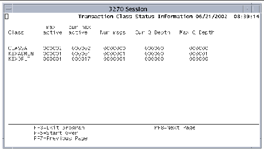

There are three methods for monitoring transaction classes:
The kixdump -St command produces a report that shows the following statistics, as well as other statistics that are designed to assist technical support engineers:
The following example shows the output of the kixdump -St command.
In the sample output, notice that CLASS_2 has two transaction processors assigned (Max active value). It is showing a current queue depth of 6, which indicates that 6 transactions are waiting to execute. All other classes show a current queue depth of 0. To balance performance, determine which transactions are assigned to CLASS_2 and decide whether to move one or more of them to another class or whether to assign more transaction processors to CLASS_2.
The CEMT INQ transaction enables you to view information about one class or all classes.
Execute the following transaction:
The screen shown in the following figure reports a subset of the kixdump -St information: Class, max active, current max active, number of messages, current queue depth, and maximum queue depth.
