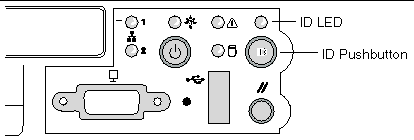

6.4 System ID LEDs
A pair of blue LEDs, one at the rear of the server, and one on the front panel, can be used to easily identify the server when it is part of a large stack of servers. A single blue LED located at the back edge of the server board is visible through the rear panel. The two LEDs mirror each other and can be illuminated by the Baseboard Management Controller (BMC) either by pressing a button on the chassis front panel or through server-management software. When the button is pressed on the front panel, both LEDs illuminate and stay illuminated until the button is pushed again. If the LED is illuminated through a remote System Identify command, the LED turns off after a timeout period. See FIGURE 6-3 for the location of the rear Main Board LED. The front panel ID LED and the ID activation button are shown in FIGURE 6-4.
FIGURE 6-4 Location of Front-Panel ID Pushbutton and LED
