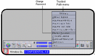

  1. Select Change Password from the Trusted Path menu (see figure below).
    You access the Trusted Path menu by holding down the right mouse button while the pointer is over the switch area in the Front Panel.
    Figure 4-10 Selecting Change Password from the Trusted Path Menu

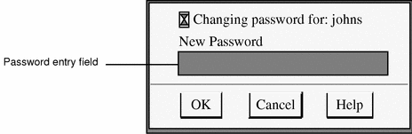

  4. Type the new password in the Change Password Confirmation dialog box and click OK.
    Figure 4-12 Change Password Confirmation Dialog Box

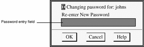

  5. Type the new password in the Change Password Reconfirmation dialog box and click OK.
    Figure 4-13 Change Password Reconfirmation Dialog Box
    Graphic
    This step confirms your choice.
