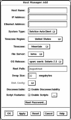

  4. Fill in the system information for the AutoClient system.
  5. After entering the required information, click on OK.

Example of a Completed Add Window
The following example shows a completed Add window for the Solstice AutoClient system type.

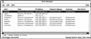

Verification
To verify that all the systems have been added, make sure the status line at the bottom of the main window says "All changes successful."
